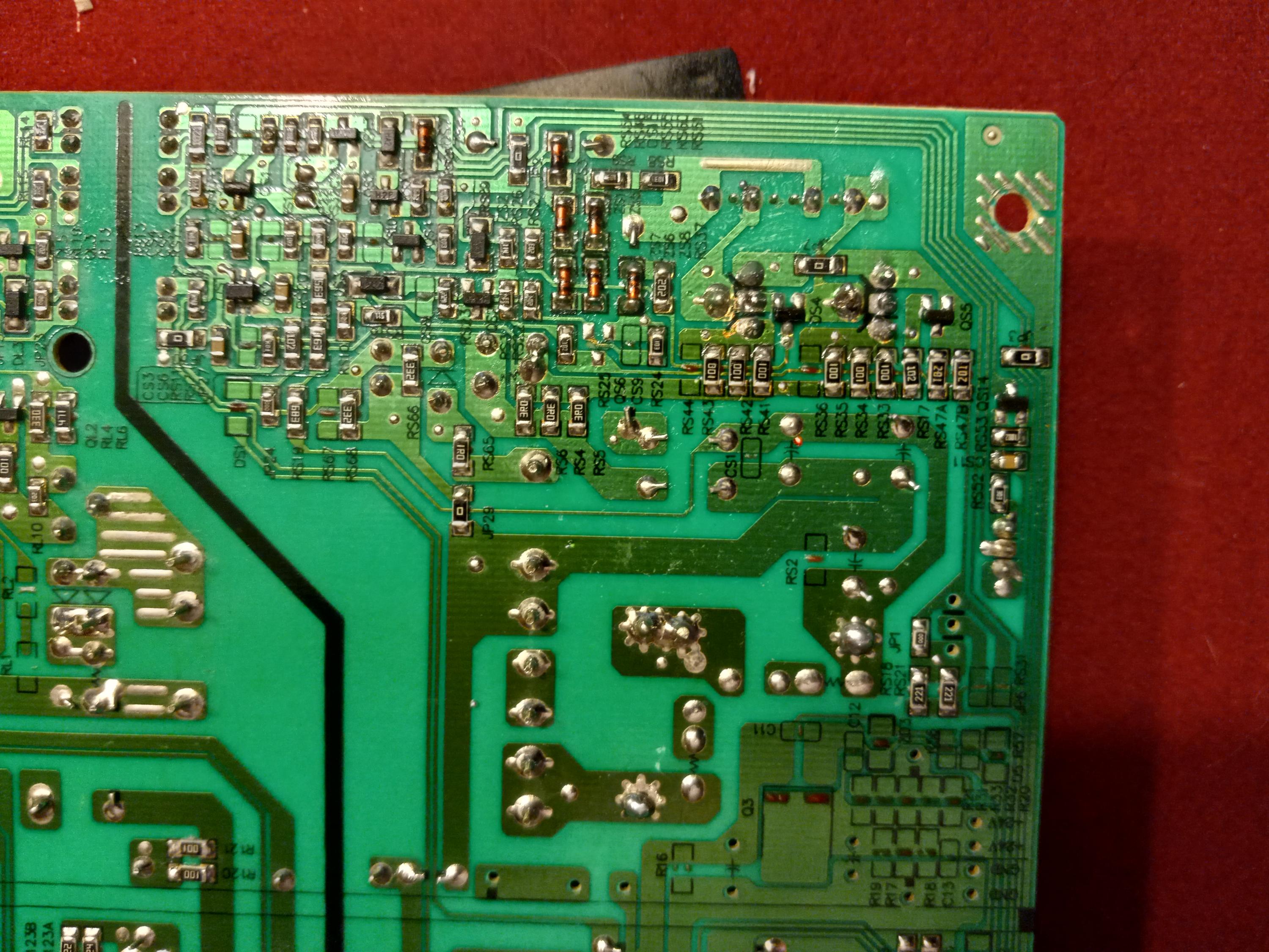

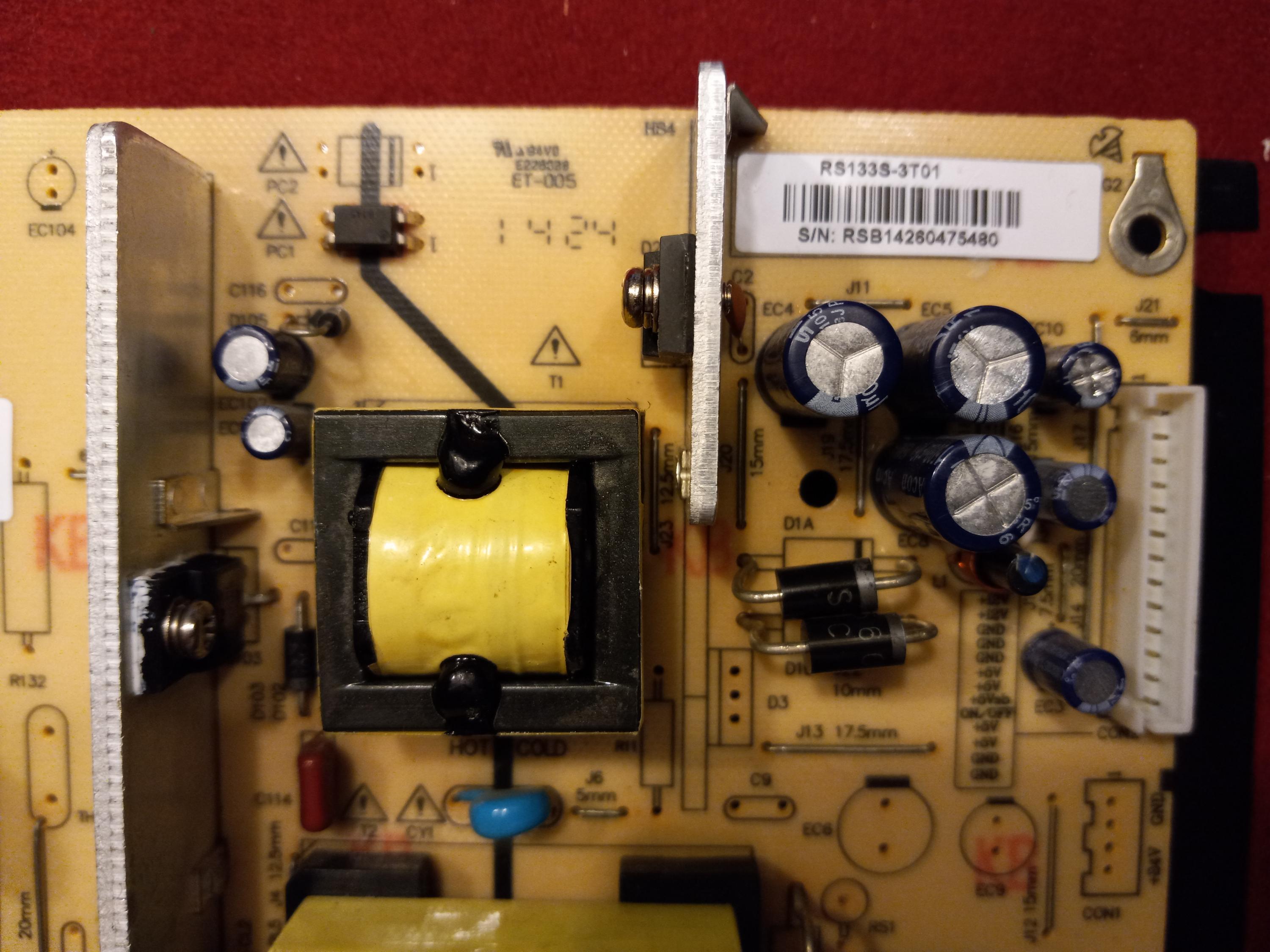

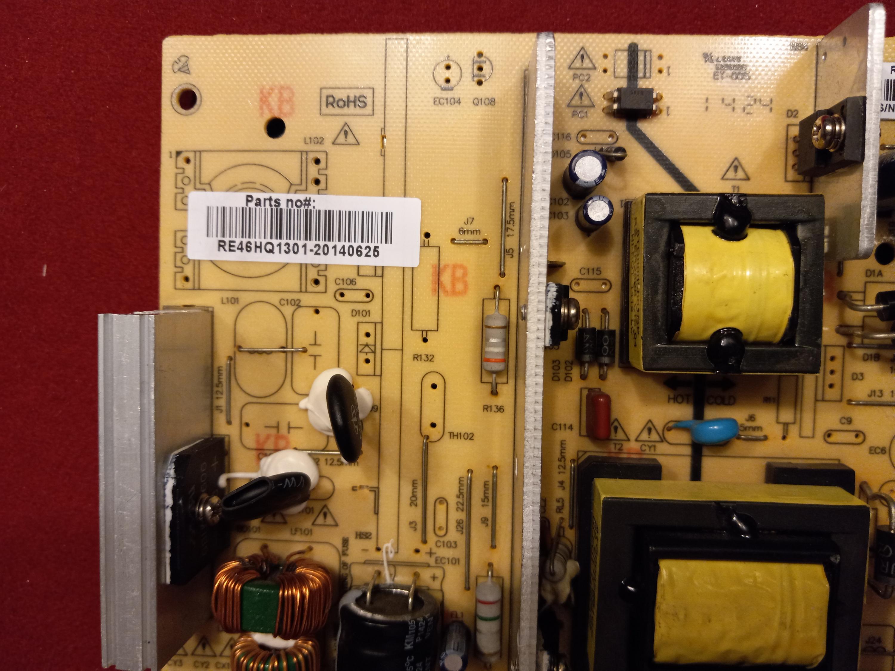

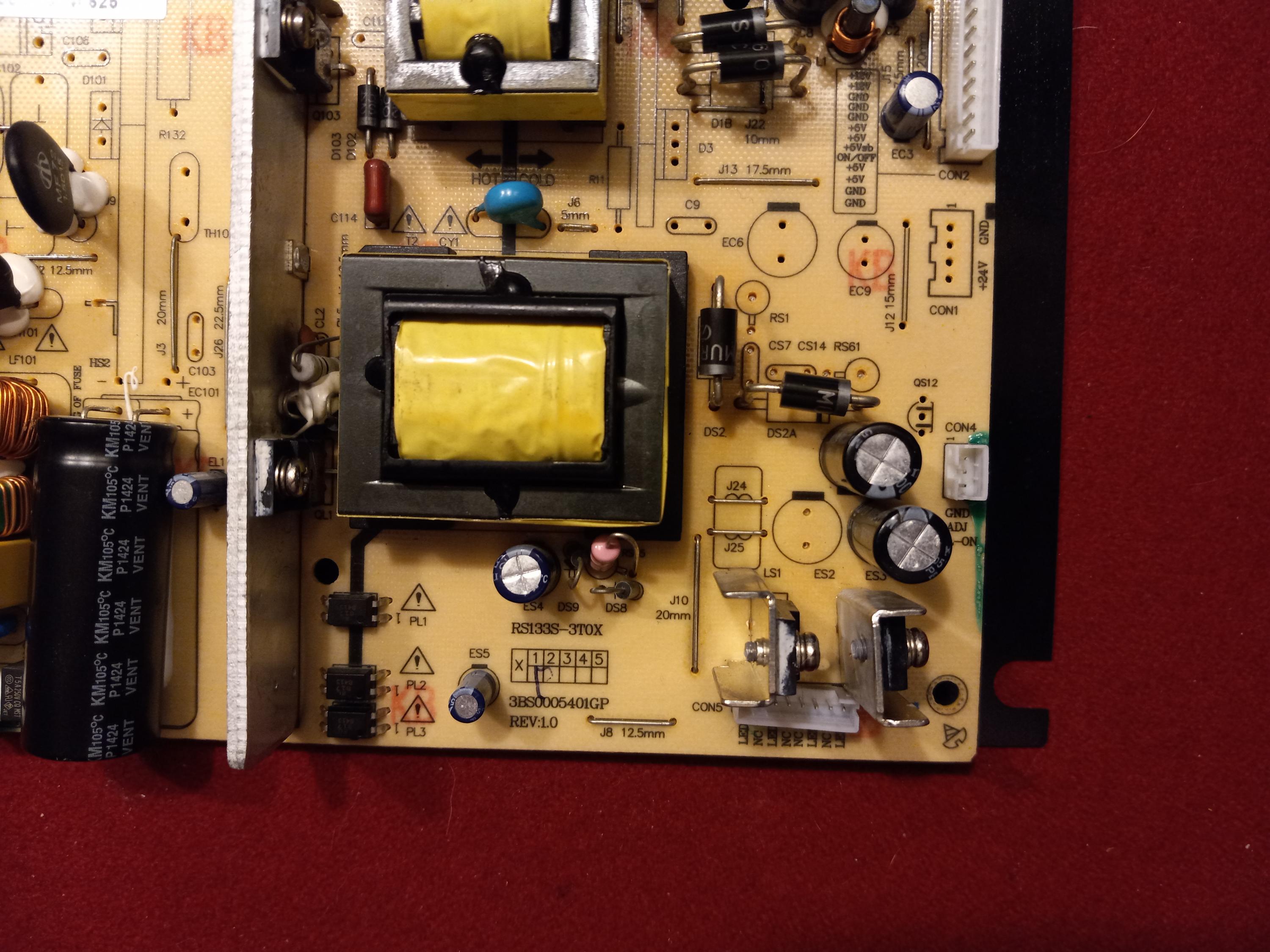

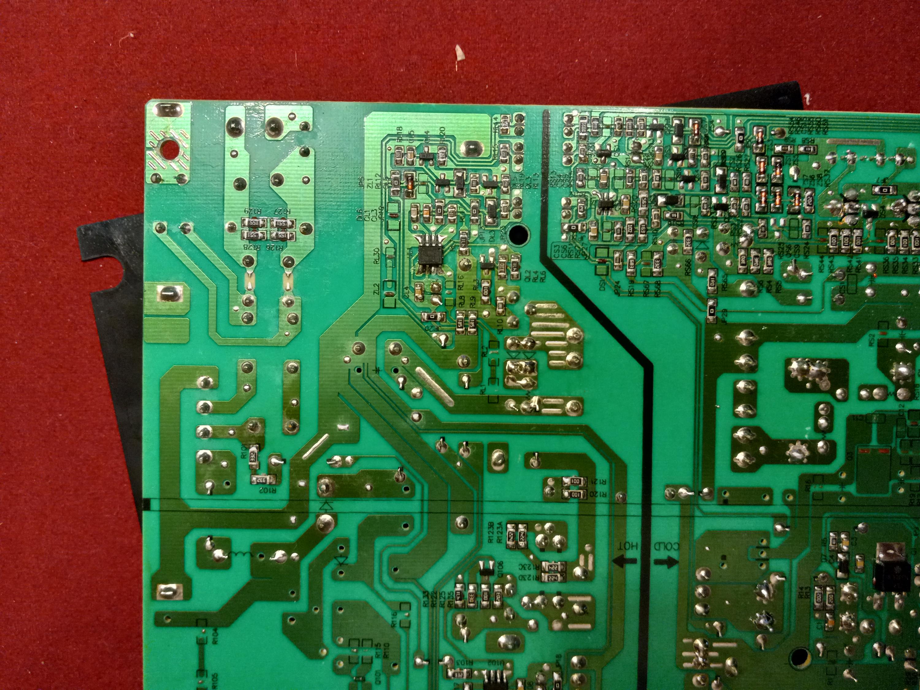

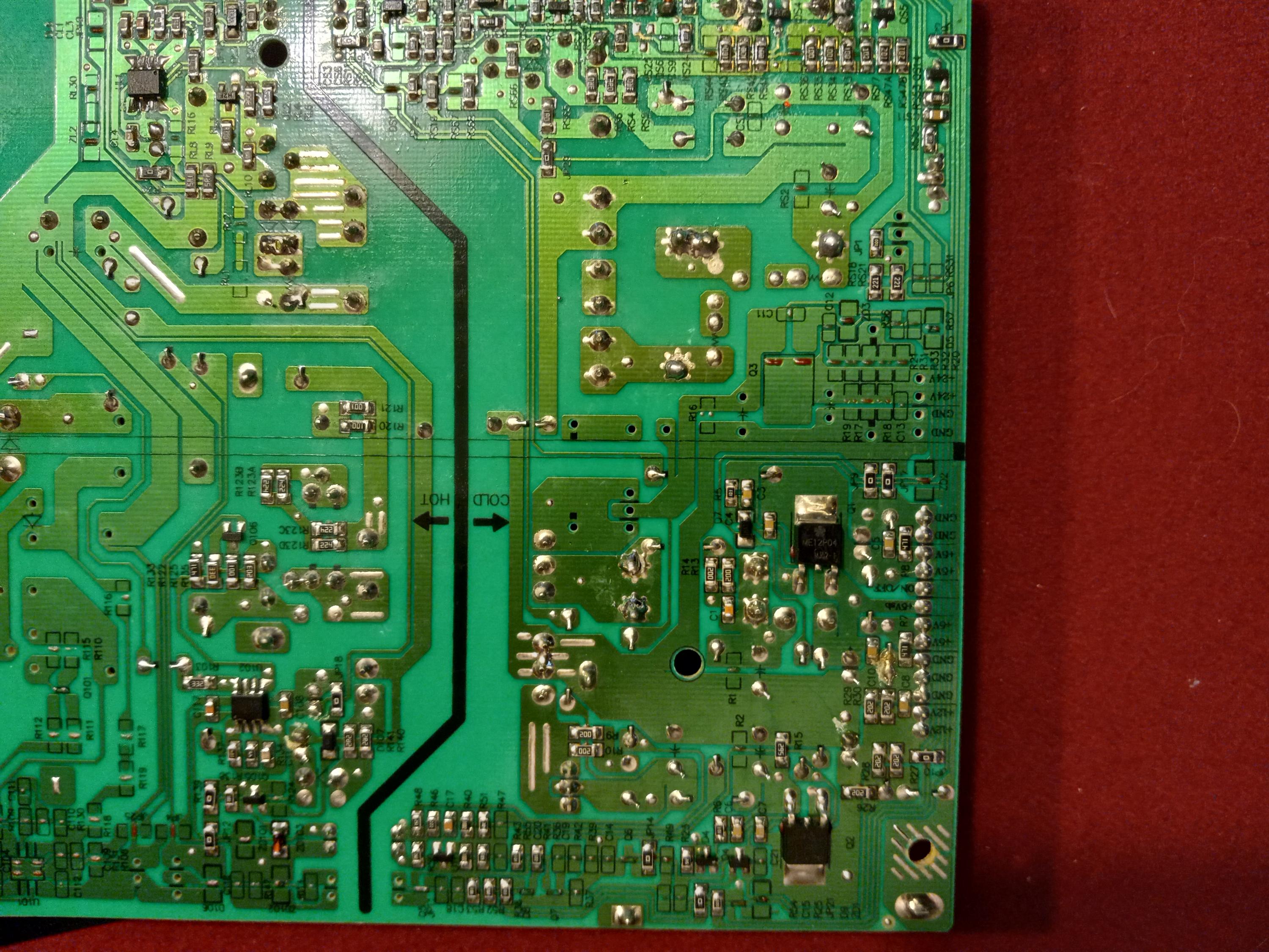

              • dskall
                • Oct 2016
                • 2905
                • usa

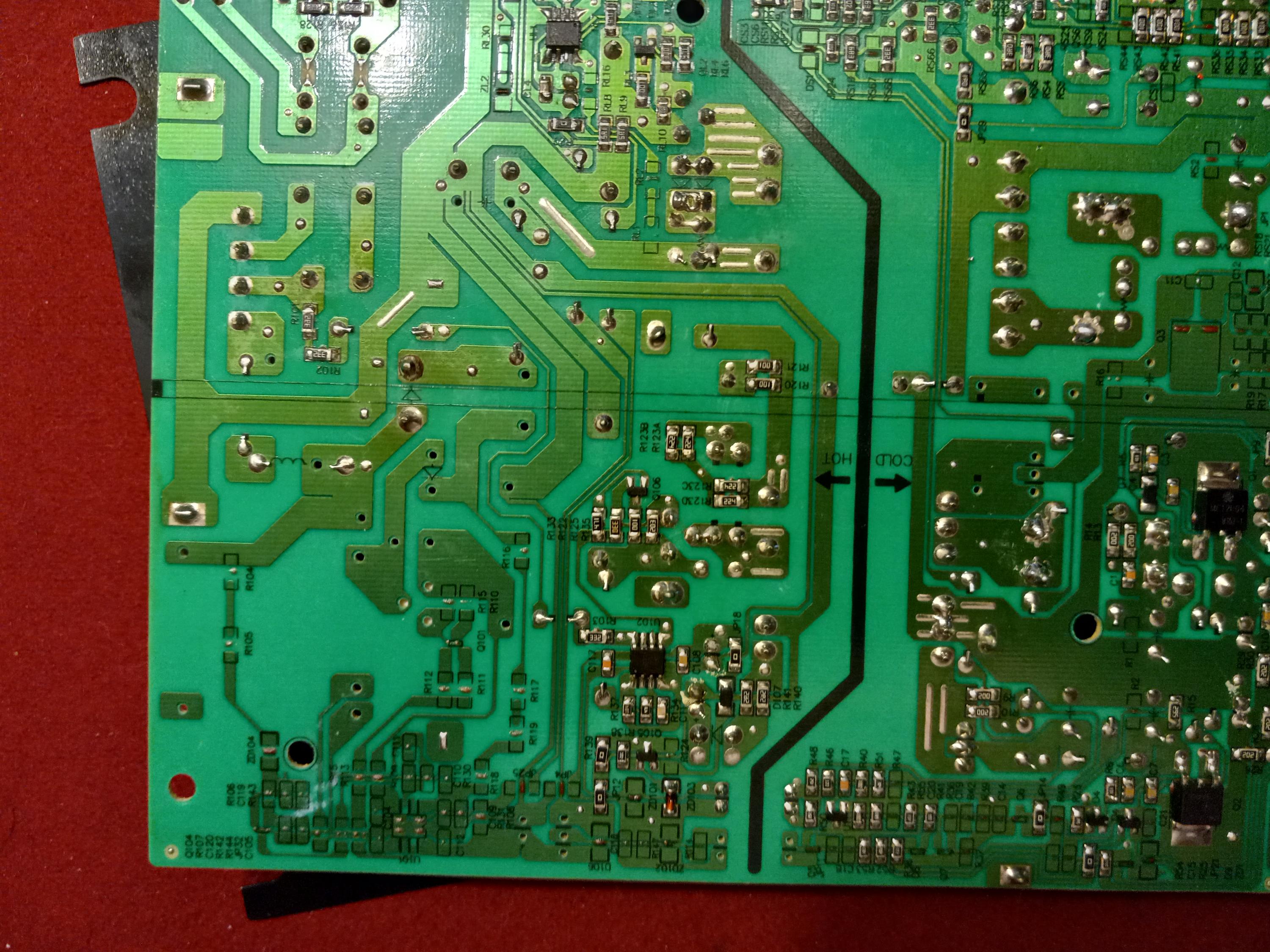

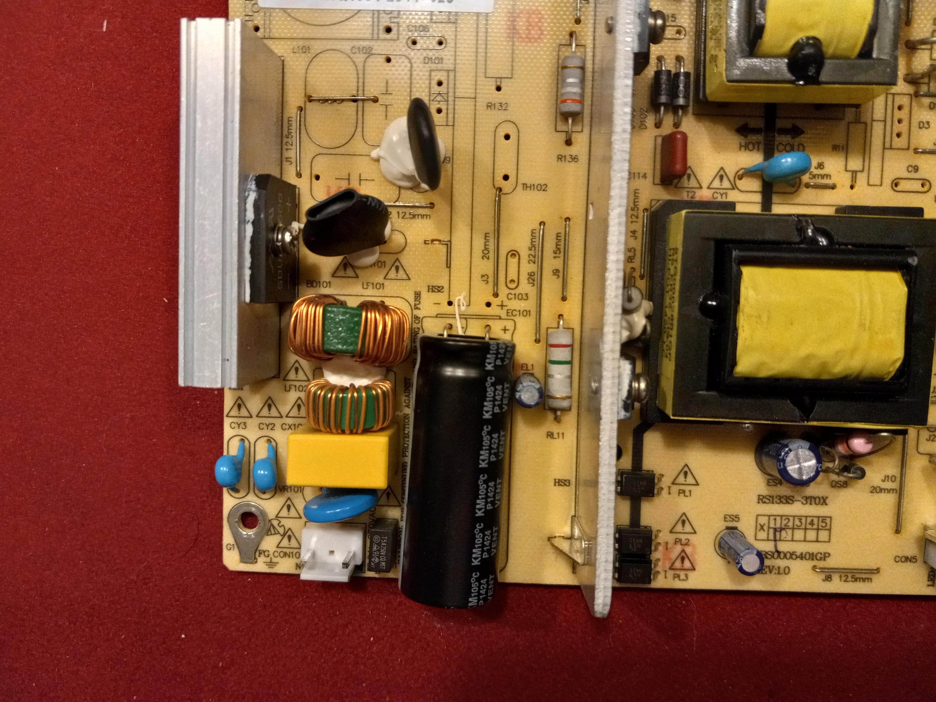

                Re: RCA LED46C45RQ,Sound but no Back lights
                Need good pictures of boards.
                • tennno`
                  • Nov 2013
                  • 37
                  • usa
                  Hope this helps
                  • dskall
                    • Oct 2016
                    • 2905
                    • usa
                    And you are getting your BL_ON voltage? Need to check ds2 and ds2a for shorts. Also need one good picture of whole back of board.
                    https://www.shopjimmy.com/rca-re46hq...ply-led-board/
                    • tennno`
                      • Nov 2013
                      • 37
                      • usa
                      Took ds 2 and ds 2a out of circuit , checked good also Qs7&9
