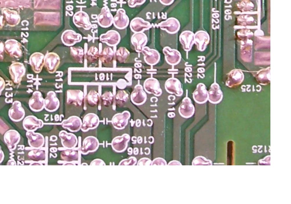

                              #74
                              Re: HP no backlight
                              Any way, this is the resistance reading of the OZ9930 with the help of lestr:
                              https://www.badcaps.net/forum/showth...771#post280771
                              So I am not sure which reading is correct, yours or lestr.
                              I have rechecked the resistance on I101 using a fluke meter and they are more in line with lestr
                              pin 1 - 5.54m
                              pin 2 - 5.57m
                              pin 3 - GRN
                              pin 4 - 5.08m
                              pin 5 - 5.08m
                              pin 6 - 138 ohm (stable)
                              pin 7 - 123 ohm
                              pin 8 - 1.36m
                              Any concerns in these readings?
                                #75
                                Re: HP no backlight
                                Pin 7 is the big suspect right now since there is no any low resistance circuit connected to this pin at all (lestr was getting about 900K Ohms).
                                It can be c110 (.01uf) may be bad or internal IC at pin 7 is bad. Try removing C110 first, see if it is surface mounted or not? You can try lifting pin7 but that may be difficult to do.
                                  #76
                                  Re: HP no backlight
                                  Thanks budm I am not sure I understand your request with respect to C110? C110 is not surface mounted and if I remove it do I try the board without it in place??
                                    #77
                                    Re: HP no backlight
                                    Cant second guess that but have been looking at the pics. I am not sure
                                    which is pin 7 but if you start at bottom left or bottom right in the attached as pin1then can you check that pin6 and pin7 are not conducting at the solder joints.
                                    Clean the flux off if it is only flux.
                                      #78
                                      Re: HP no backlight
                                      Thanks Selldoor that is pin 6 & 7 it was some flux and I cleaned it up still no difference
                                        #79
                                        Re: HP no backlight
                                        There is something at pin 7 to make it show real low resistance (123 Ohms) at that pin, you can remove the cap C110 or lift pin 7 off the trace and measure the pin7 solder pad to see if you still get low resistance reading. We are trying to find out what is causing this low resistance reading since there is no component with that low value resistance connected to that pin7.
                                          #80
                                          Re: HP no backlight
                                          Thanks budm with C110 removed pin 7 is still reading 123.9 ohms so should I try lifting pin 7?
