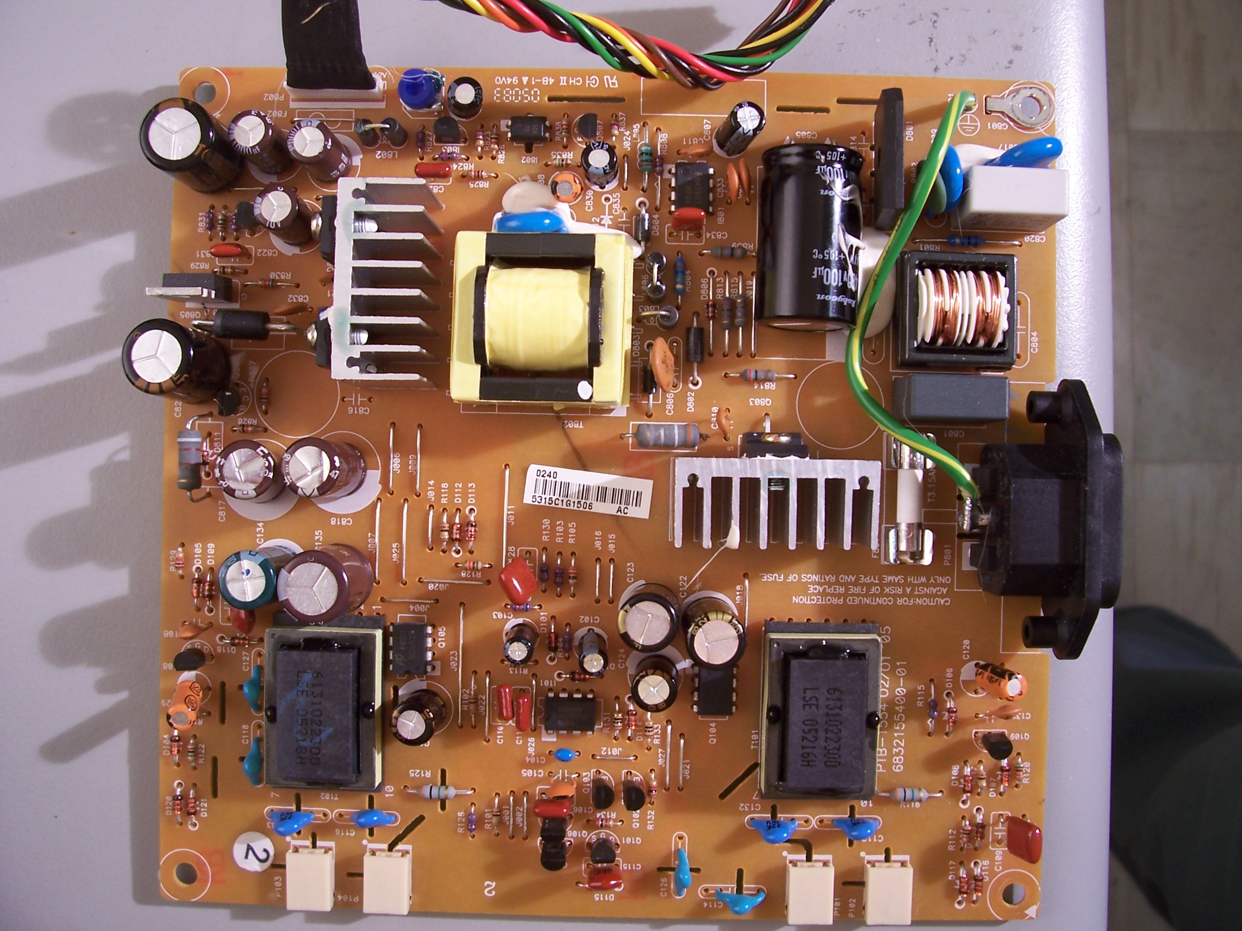

    This is a 19 " HP which powers on OK but the backlights will not light. I tested these lights and they test OK I replaced all the cap on the power board with same results. I am looking at retiredcaps sticky and am thinking that it may be a transistor but I am rather intimidated by these because I am not sure how to identify them for example how can one determine the start/stop transistor? The signalling transistors? etc. This board has quite a number components with the Q designation but look different. Some has E,C,B and some has S,G,D and than there are some with 8 contacts like the 2 (P607 BD5A18)

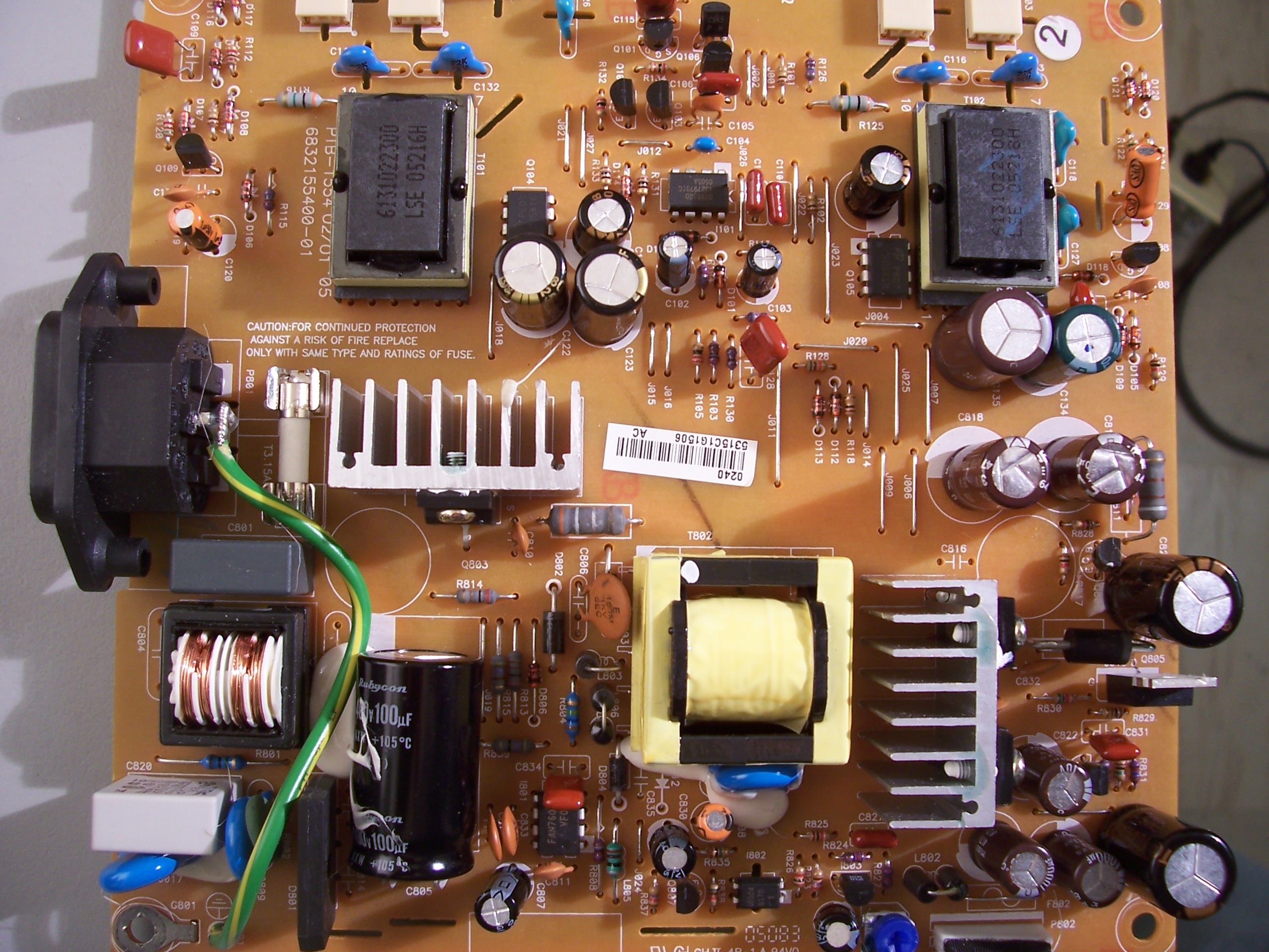

            What is the model number of this HP? Can you zoom out a little bit so I can see the whole board, both sides? By the way, do you see the lights even flash on at all?

                The model # is HP-VS17 I will upload pictures in the morning. I have it apart now but I can't be sure if it flashes or not but if it does its quicker than the eye. When plugged in the blue power light comes on than goes to amber. I don;t see any flash of the backlights but I can see the image with a bright light.

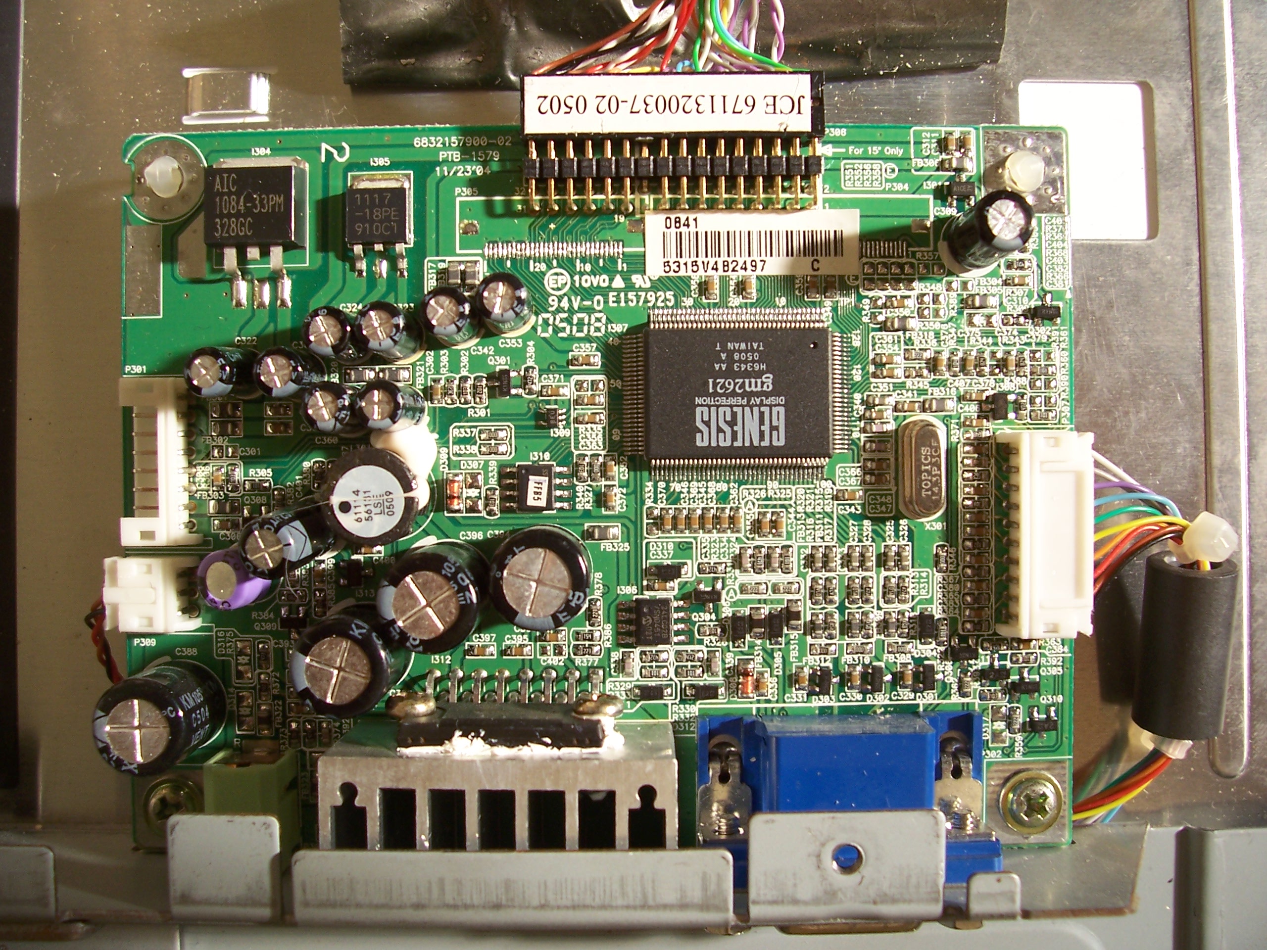

                      Post a picture of the main board as well.

                            Here are the pictures that budm requested and with the unit attached to a pc the blue light stays blue but there is no flash of the backlights at all. I am hearing a humming sound on the power board when everything is hooked up. Is this normal? I have to do some reading before I start testing the regulators.

                              The readings on the two regulators I304 and I305 are as follows:

                                  Your voltage regulator readings look good. Here's what I think the problem is:
                                  On your photo of the logic board, what is the part number for I308? It's the 3 terminal device right above the 10-wire wiring harness. If it's something like MAX809/810, then it's a reset controller. If yes, with power off, use your soldering iron to lift the VCC and RESET pins off the circuit board. Power up the monitor to see if you get an image. Note: failure of this controller has caused the same problem on various acer models.
                                    Re: HP no backlight
                                    Thanks jetadm123 The best I can tell the markings on that I308 is ARNQ4 but it is so small it's a job to tell.?
