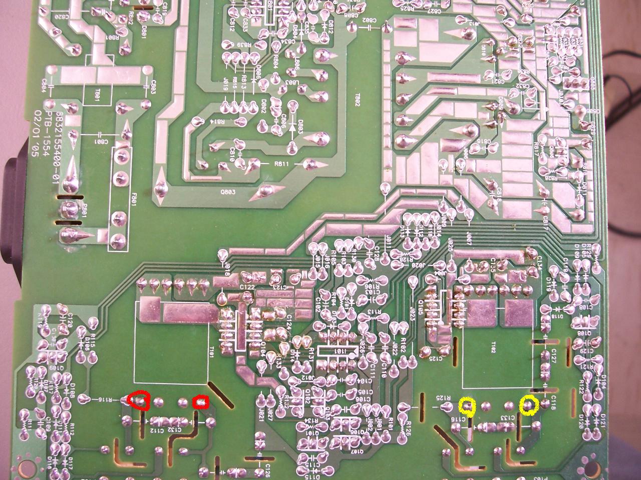

    Ah, I misunderstood your initial voltage readings for on/off. Looks like the main board is sending the correct 3.24V to turn on the backlights. Disregard my initial comments regarding I308.
    Going back to Q104 and Q105. What voltage readings are you getting when you measure pin 3 (S1) on Q104 and Q105?
      Re: HP no backlight
      Thanks jetadm123 Pin 3 (S1) Q104-Q105 both read 26.2v Black lead on ground screw red lead on pin 3, connected to running PC
        Re: HP no backlight
        Good. At least we know those transistors have access to power to perform their switching actions.
        In the top middle of your power supply photo:
        With power off and monitor unplugged, try checking transistors Q106 and Q107.
        With your meter set to 200 ohms, place your meter probes across:
        E-B
        B-C
        E-C
        Reverse your leads and perform the same checks again.
        You may have to set your meter to a higher resistance setting to see a valid reading.
          Re: HP no backlight
          Q106 reading EB 51.7 k BC 151k EC 99k both ways Q107 EB 99.4k BC 16m EC 16m reversed EB 99.4k BC 16.5M EC 16m (meter set to auto)
            Re: HP no backlight
            Doesn't look like anything is shorted. Looks like we will have to move on to the ccfl controller, I101. Fortunately, it's only 8-pin. Measure the voltage at each pin. What's the part number of I101? Note: I have to run some errands and will be gone several hours.
              Re: HP no backlight
              The markings on (I101) is Line 1- OZ9930D, Line 2- 43279731G Line 3- 0505A The voltage readings are as follows: With the indicator mark north and pin 1 immediate left and pin 8 immediate right Pin 1- 2.4v pin 2- 0.08v pin 3- 0.01v pin 4- 0.01v pin 5- 0.01 pin 6- 3.8 pin 7- 1.9v pin 8- 0.05v

                          According to that drawing It would appear I should have 5v on pin 7 and I am recording 1.9? or is something else in that circuit effecting that voltage?
                            #33
                            Re: HP no backlight
                            VDDA, in other OZ9 datasheets, is typically 5V DC. If it is low, then it could be that the OZ9 pwm is some sort of protection mode (over voltage, open lamp protection).
                            I suggest measuring the secondary windings (in red and yellow) on the inverter transformers to see if open is open. Post your resistance measures for both colors.

                                Thanks retiredcaps these two points are reading .458k and .454k

                                      Thanks jetadm123 I have been away but will get some readings as soon as I get back on track. Question on the trouble shooting page check voltage on pin C112 is that across the cap c112?

                                        I see what you mean. Since they say "pin", it sounds more like a test point, but I'm not sure. However, I think most members agree it's an inverter problem and I would go on to the next step, checking pin 6 of I101. You read 3.8V versus the suggested 5V (I don't know what the min VDD is for the OZ9930). The flowchart says to check R105 and C112. I think it's a typo and they meant C102 instead of C112, since C112 is not part of the VDD circuit.
