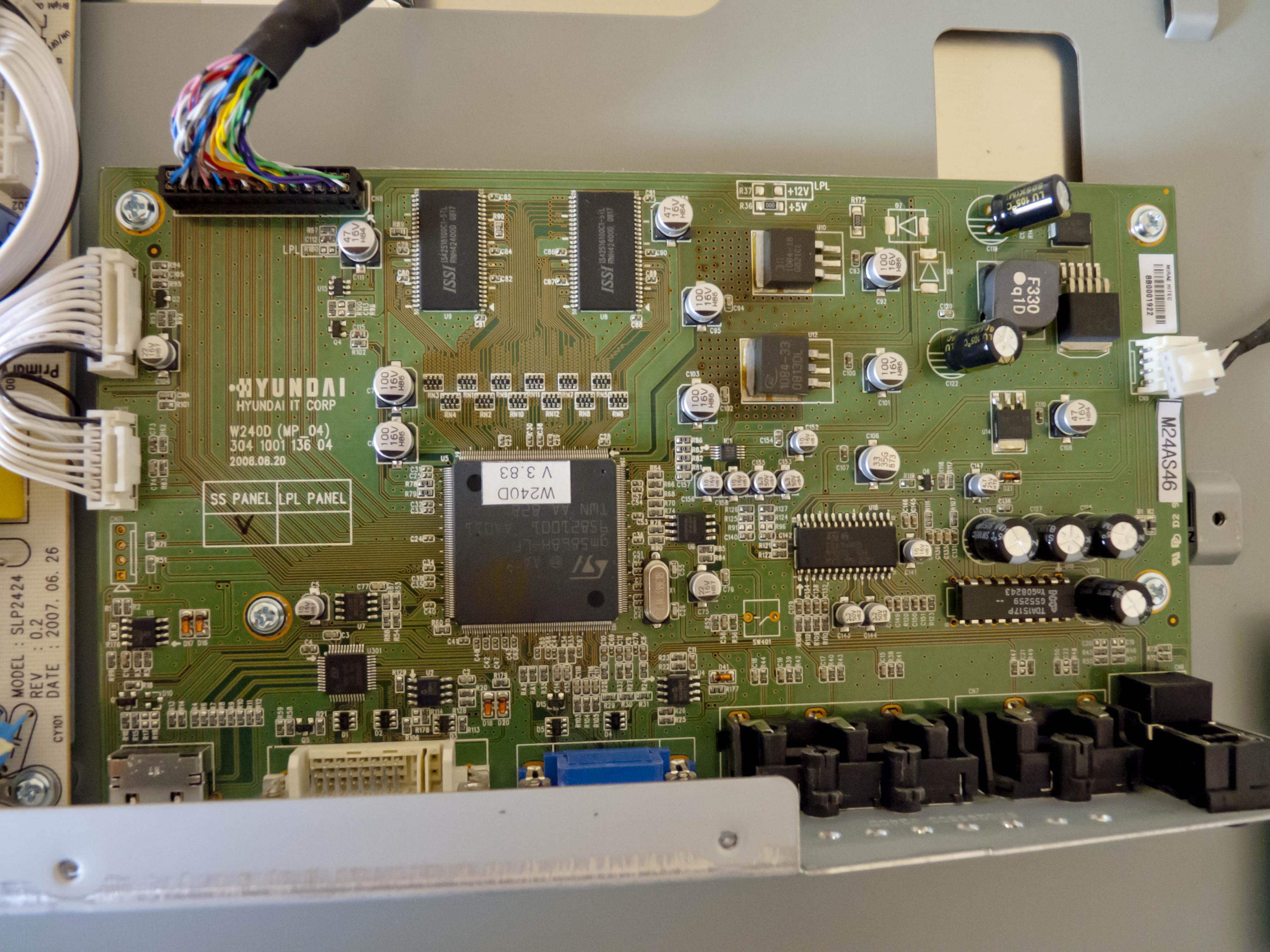

    I got the same problem like in this video
    http://www.youtube.com/watch?v=YN12vGegYmY
    Its the gm5868H-LF processor on the motherboard, which runs hot.
    I already renewed all caps on the PSU.
    Uploaded with *************
    Seems a lot got the same problem, but i don´t think its a solution to install a fan, cuz i think the problem is getting worse-
    Maybe someone know that issue and can help me here.
    Greetings from Austria.

    It's interesting to see that Hyundai changed the imaging processor in the latest revision which I own (EV3.84, see photo).
    Are you really sure that the above mentioned processor runs hot? I would rather expect one of the power transistors to run too hot.
    Maybe a few heat sinks would solve the problem.
    By the way, which capacitors did you use to replace the old "JH" (Jianghai) capacitors?

      instead of the JH i actually use YAGEO.
      yep i am sure it is the imaging processor.
      i seperated the PSU from the MoBo and blow against the IP.
      actually i put a heatsink on the chip which also "solved" the problem.
      of course the power transistor gets hot, but the image processor too
      did u also got problems with your hyundai screen?
      till now i don´t know whats the difference between the 241D and the 240W?

          Looking at the video board, it looks like the two regulator ICs (they have 3 legs with big tab on one side) have been running hot, you can see the board in that area has brownish color. You should check the value & ESR of those 3 caps to the left and two caps to the right of those two regulators.
          Also take the reading of each pin of the regulator, black probe on the chassis and red probe on each pin and report the readings. If the caps do not filter out the AC ripple properly and let it running through the circuits, it can cause over heating problem.

            @budm: thanks, but as u can see the video board from nname got the same brownish color near the regulator IC´s... but i´ll check that.
            @nname: did u changed the caps on your video board? as i wrote in the first post i already changed the caps on the psu, but i guess i should do the same with the 6 caps on the video board. (i just saw that one domed at the bottom... could that be the problem!?)

                  In your pic of the logic ("video") board, the G-Luxon capacitor with the bung pushed out is likely bad. Replace that and see what happens.

                    already changed them with caps with more capacity and volt...
                    problem is the same...
                    could it be a other component part ?
                    just curious but could it be the t-con board that the lcd processor run´s hot?
                    its such a common problem but i am puzzled there is no solution.
                    and i think it´s not a real fix to put a heatsink on the chip ...
                    i am not sure but i think the flickering is getting lower when i turn the brightness and contrast down...
                    could it be the big cap on the PSU (i never saw a instruction to change it just on purpose)

                      If the big capacitor was faulty, the whole monitor wouldn't work — it should be all right.
                      So if you already replaced all G-Luxon caps on the video board, maybe the ESR of the new caps is still too high for the circuit?
                      Please compare the data sheet of the original capacitors with that of your replacements.

                                I dont think said which series of Yageo caps you bought as replacements so we cant check them on the datasheet.
                                You never posted the results of the test Budm suggested on the Voltage regulators.
                                If the caps are not good enough the voltage at the regulators may be incorrect causing them to overheat.
                                If the voltage at the regulators is incorrect the voltage supplied to the main processor may be incorrect causing it to overheat.

                                      Hello, i had a problem with my W240D V2, problem shown here:
                                      http://www.youtube.com/watch?v=8gdDYlKLzVQ
                                      i changed the LDO (shown on this image):
                                      http://www.hostingpicture.fr/upload/...99ba2ed30a.jpg
                                      http://www.hostingpicture.fr/upload/...ad2f55f55c.jpg
                                      My W240D V2 works fine for 1 month now.
                                      Hope i help you in any way.

                                        I think i made a mistake, the components that i replaced are voltage regulators not LDO. Right?
