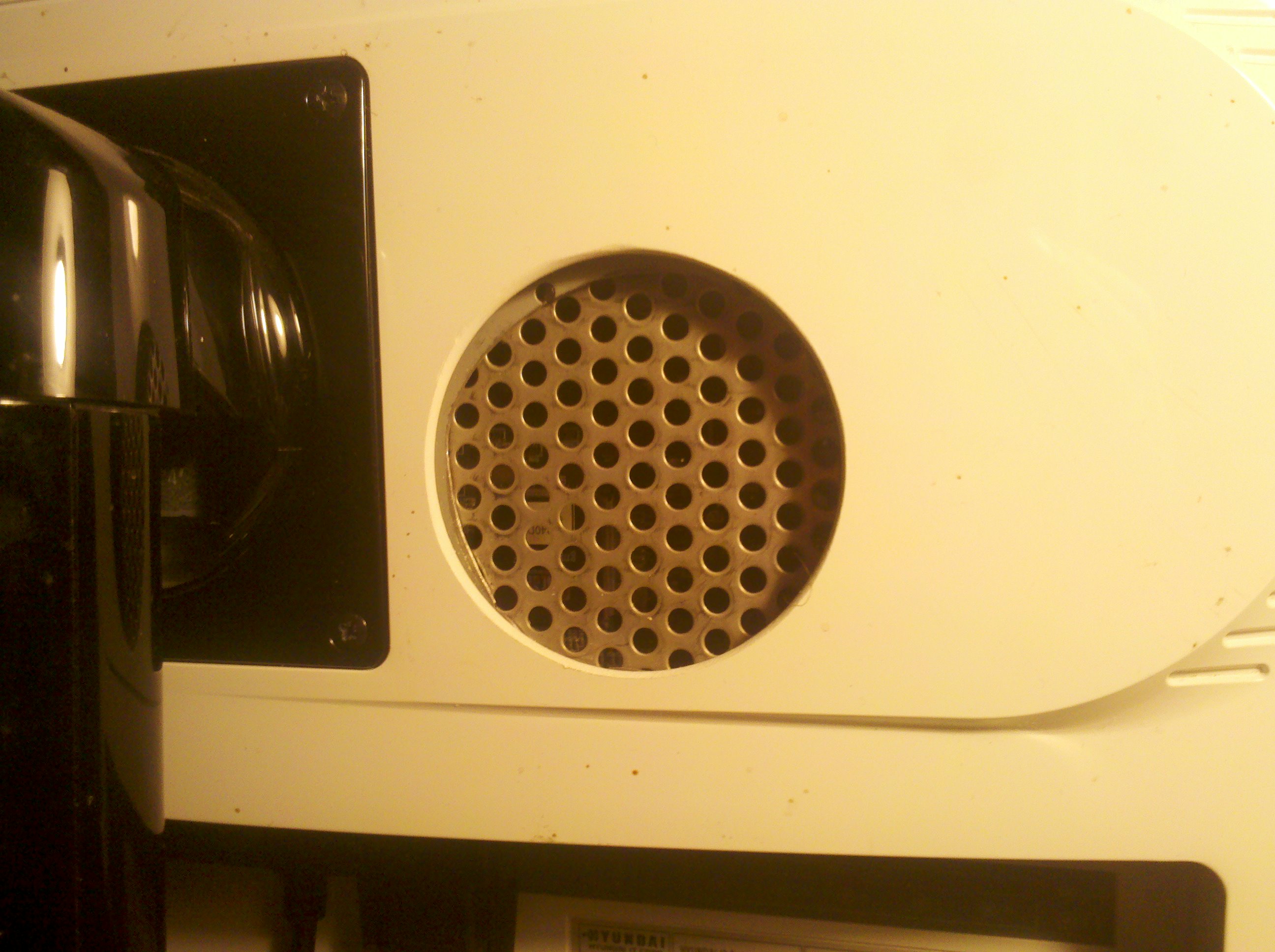

    Originally posted by StealthyMonk
    Yes I too have it in front of window. When the sun shines in and it gets hot, flickering sometime resumes. I would love to permanently repair it, as it is a nice monitor, I can only set resolution to 1024x768, any higher and it flickers constantly unless it is really cold.
    Replacing the two 100uF/16V SMD capacitors marked by red circles in Leontius' post earlier on this page solved the problem for me, after having gone through some earlier, partly successful (but in retrospect probably futile) steps.
    I measured the capacitance and ESR for those caps I removed. One measured at 76uF/7 ohm, the other was 82uF/13 ohm - in other words, they were past due. As I did not have any 100uF capacitors handy I replaced each by two 47uF/25V (axial electrolytic) in parallel. The ESR for the replacements (in parallel) was 0.07 ohm.
    I now run the monitor without the fan I built in the back. The hole behind which the fan lived is still there (with a grating in front to protect the inner workings) so passive cooling is improved over the original.
    https://www.badcaps.net/forum/attach...1&d=1453656621
    The thing has not flickered yet, not even when displaying 10 terminal windows crammed with small-font content. While this would work initially, it soon required the fan to be stable. Lately it jumped around even with the fan at maximum speed. Now, it just works... or should that be 'for now...' - time will tell. There are sure to be other bad capacitors on the board, they just don't have as visible an effect on the workings of the monitor.
    For those interested in installing a fan in this monitor, you can get 12V from the power supply, just look at the unpopulated connector for which lines to use.

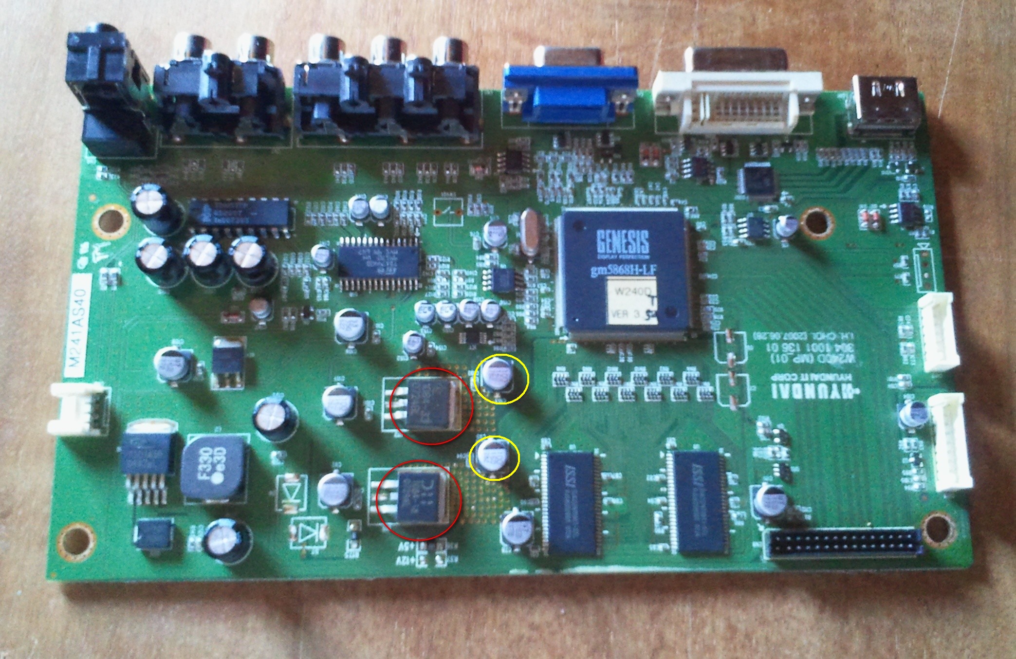

        I had the flickering from the bottom issue, replaced the 2 caps by the 2 regulators shown in Leontius' post and the monitor has been flicker free for several days, thanks.

          Originally posted by Leontius
          Try replacing the two capacitors marked with yellow circles on this picture:
          http://i60.tinypic.com/acei54.jpg
          They can be replaced with electrolytic ones. Worked for me.
          I can't edit my post anymore, and Tinypic has removed the picture, so I am uploading it again, because after 6 years the problems have reappeared. Fortunately, we know the solution now
          • Stefan Payne
            • 1267
            #65
            Re: W241D (W240D) flickering Problem
            Use through hole Caps and bend the legs, solder them.
            I did that with mine and "accedentally" used Polymer Caps.
            Might be worth a try.

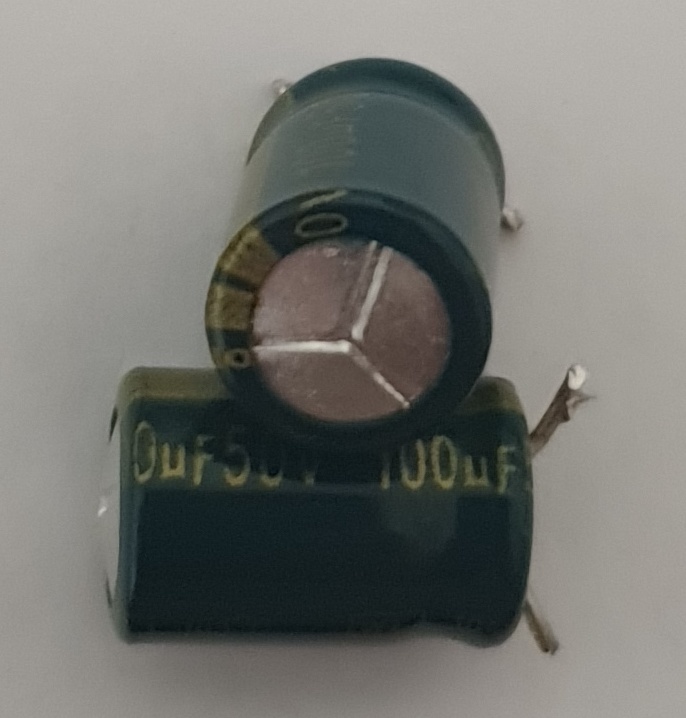

                This is how the Jamicon 216C2(M) 105 ℃ 100 μF 50 V capacitors I mentioned in this post look like after 6 years of everyday usage for about 10-12 hours per day. As you can see, they are clearly bulging, but exchanging them with fresh ones solved the problem once again.
                Originally posted by Stefan Payne
                I myself haven't used the W241D much in recent years. Just because I got better, more modern Options...
                I am still using it, because after 12 years it still works perfectly.

                  I found this austrian thread (in German) about the issue, where some guys reported to have replaced caps, added cooling devices etc., all that already years ago.
                  And then recently (in 2020) another person discovered the voltage regulator in question (the upper one of the two LM1024 on the main board) is missing any HF blocking capacitor. With him I share the experience that in quite some cases the internal inductance of typical dielectric capacitors of e.g. 10uF is too high to keep such regulators from oscillating. And even small amplitude parasite oscillations are heating the semiconductors up much more than a pure DC operation !
                  I added a small, ceramic capacitor of 1nf between input and mass (those are the two pins on the frontside).
                  And now I'm using the monitor for hours now on full resolution, including 2 hours video, and no flickering showed up !
