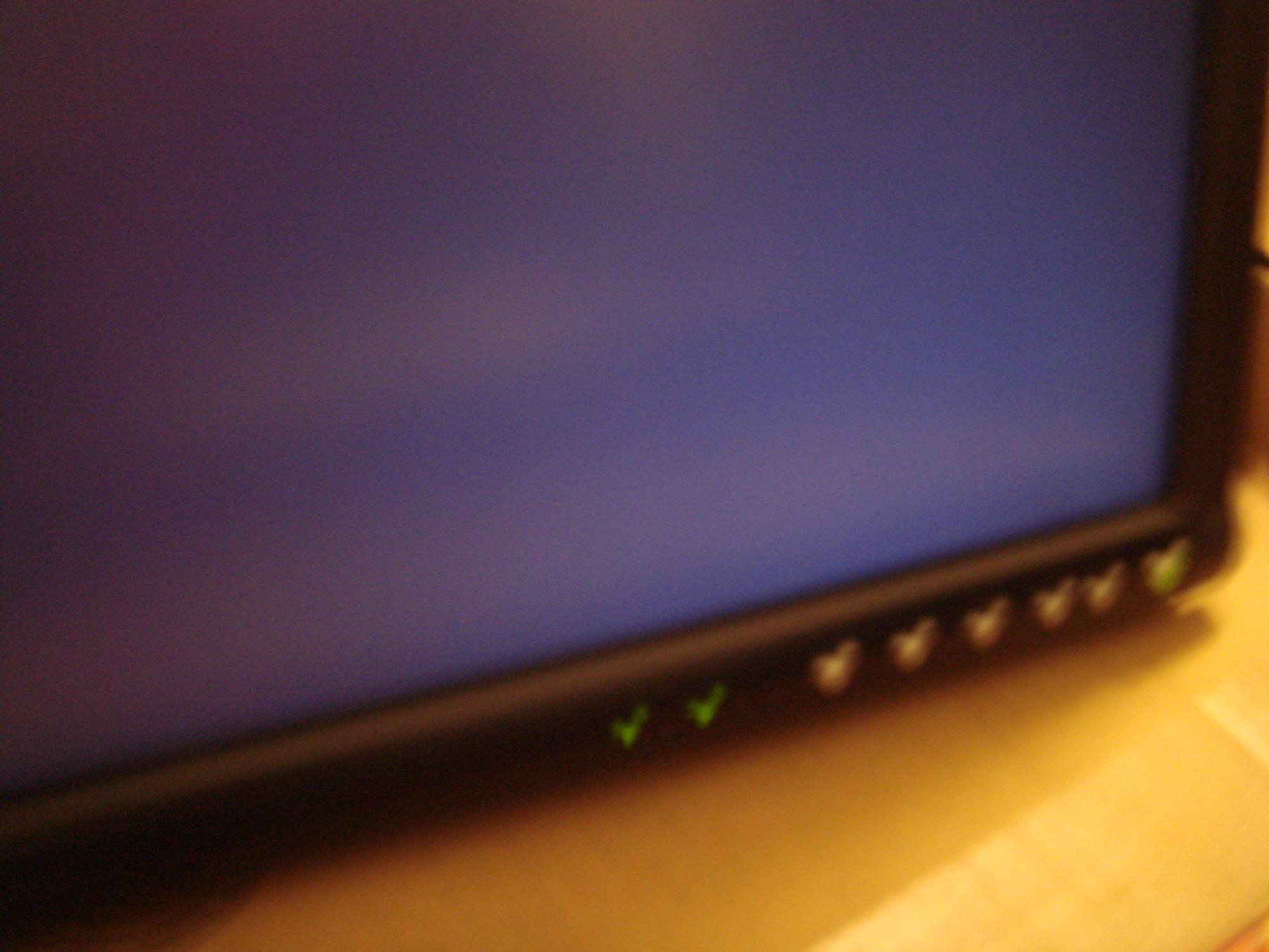

                    #29
                    Re: DELL 2405fpw
                    Originally posted by retiredcaps View Post
                    1) Does your laptop wallpaper show up on the lcd?
                    2) If not, is the screen just white?
                    Nothing shows on the LCD. The screen is a greyish black, the backlight is on because I can see the ccfl lit. Here is a pic of the monitor, its hard to see ( I was holding it up) but it shows the lights and buttons working at the bottom and the screen backlight on.

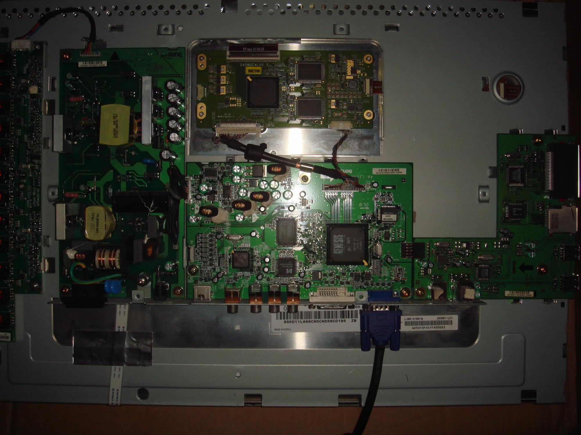

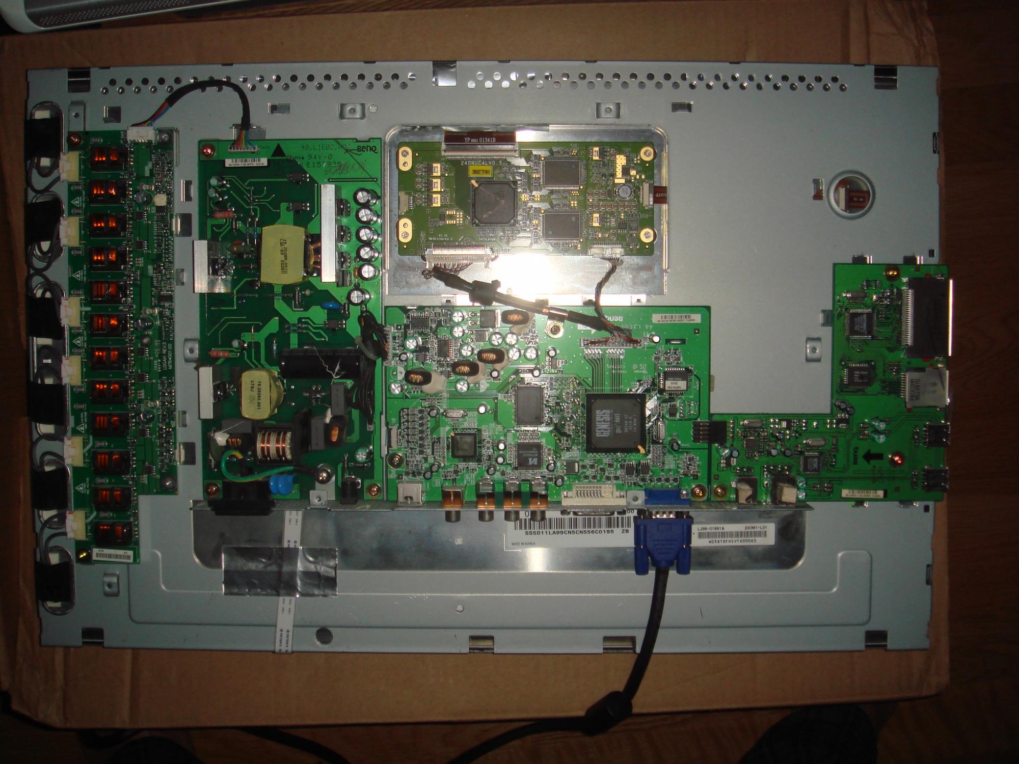

                          #32
                          Re: DELL 2405fpw
                          Originally posted by Mirage00 View Post
                          I have a second 2405fpw and the OSM displays when you press the menu button regardless of it receiving a video signal (computer off)
                          Not all monitors have that feature which is why we always ask for a computer to be hooked up.
                          Can we get an overall backside shot of the lcd? I can't quite tell the relationship of all the boards with the different orientations. I would like to see how all the boards are connected to each other.
                          --- begin sig file ---
                          --- end sig file ---
                            #33
                            Re: DELL 2405fpw
                            Here ya go
                              #34
                              Re: DELL 2405fpw
                              Hi - in each corner of the main board there is a F1 to F4 designation are there any fuses there or is it just a fixing point? Also on the Power Supply there is an Orange pico torpedo fuse - has that been checked. I dont know much about circuits so its just a case of see a fuse check it. There are also 2 on the inverter board. Can you do a close up pic of the L shaped board - just for completeness.
                              EDIT
                              Also can you do a pic of the back of the main board if there are any component on it.

                                  #36
                                  Re: DELL 2405fpw
                                  BTW is this considered a white screen? Only the backlight is on.
