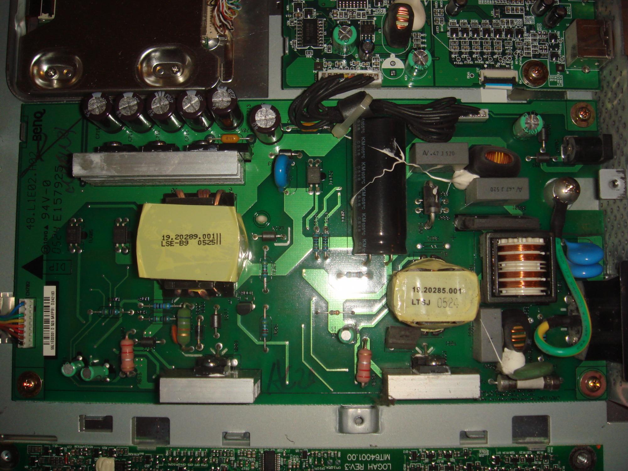

    My Dell 2405fpw stopped displaying anything on the screen. The power goes on and all controls work (front lit green buttons all work). The backlight is working when connected to a computer. I run my finger against the screen and see the white light. The Dell self test menu does not display nor does the On Screen Menu. I have taken off the back cover and can't see any obvious issues with CAPS so I will need to start testing. Does this sound like a LOGIC board issue? Where do I start testing ? Thanks in advance, this is a great forum!!!!

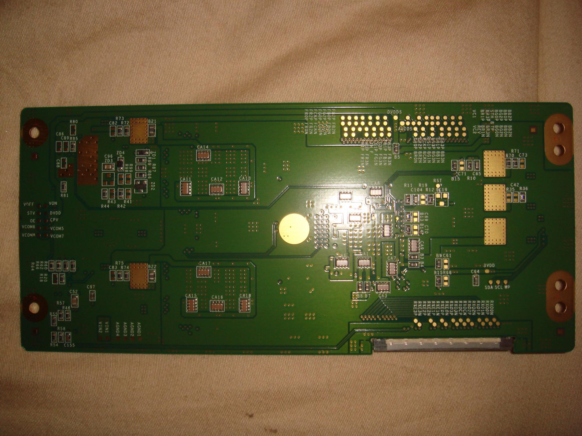

    It sounds like the T-CON board (Board is under the metal shield) is not getting the voltage from the main board, or it has blown fuse on the T-CON. You need to check that board.
      Re: DELL 2405fpw
      I just lifted the metal shield enough to test the fuse with the DMM and it was fine. What do I test next?

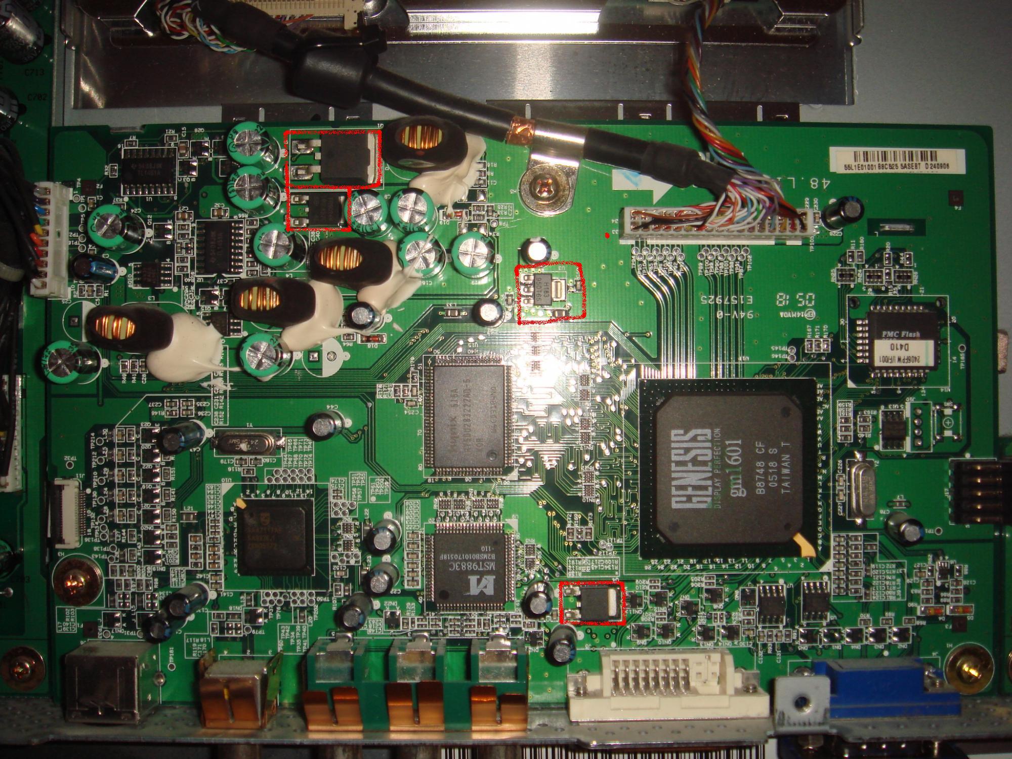

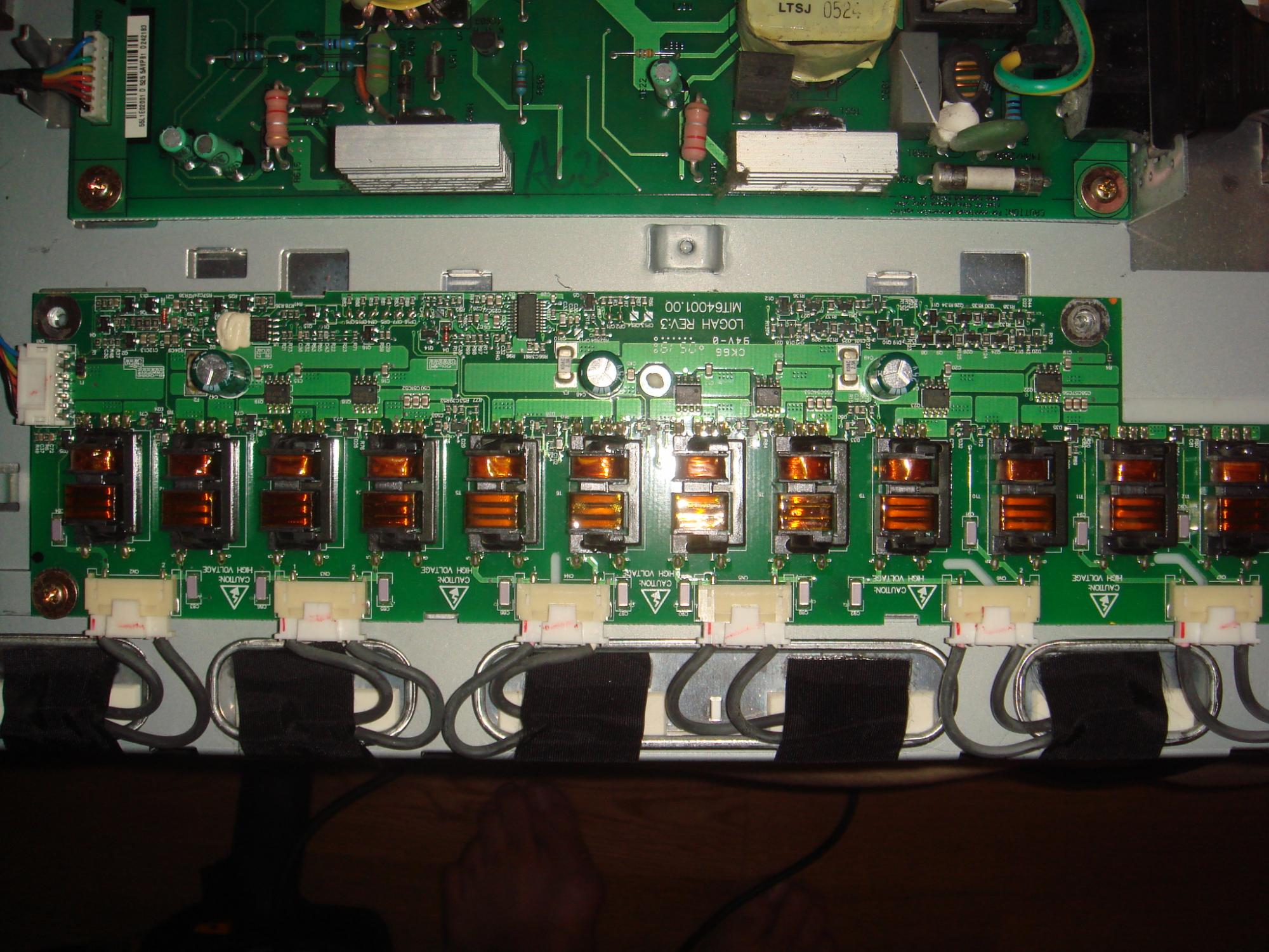

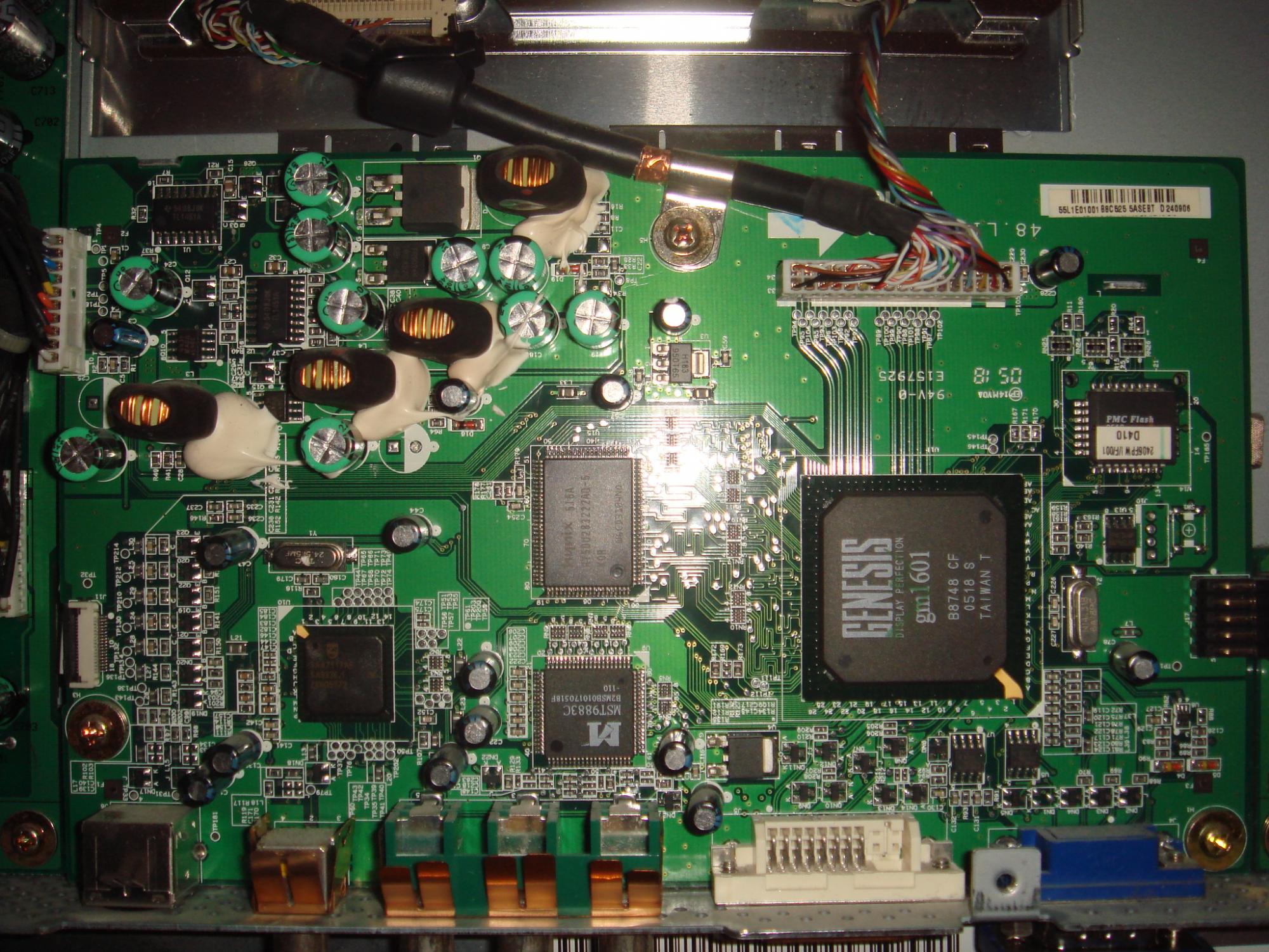

      Also, here are the pics from the panel board

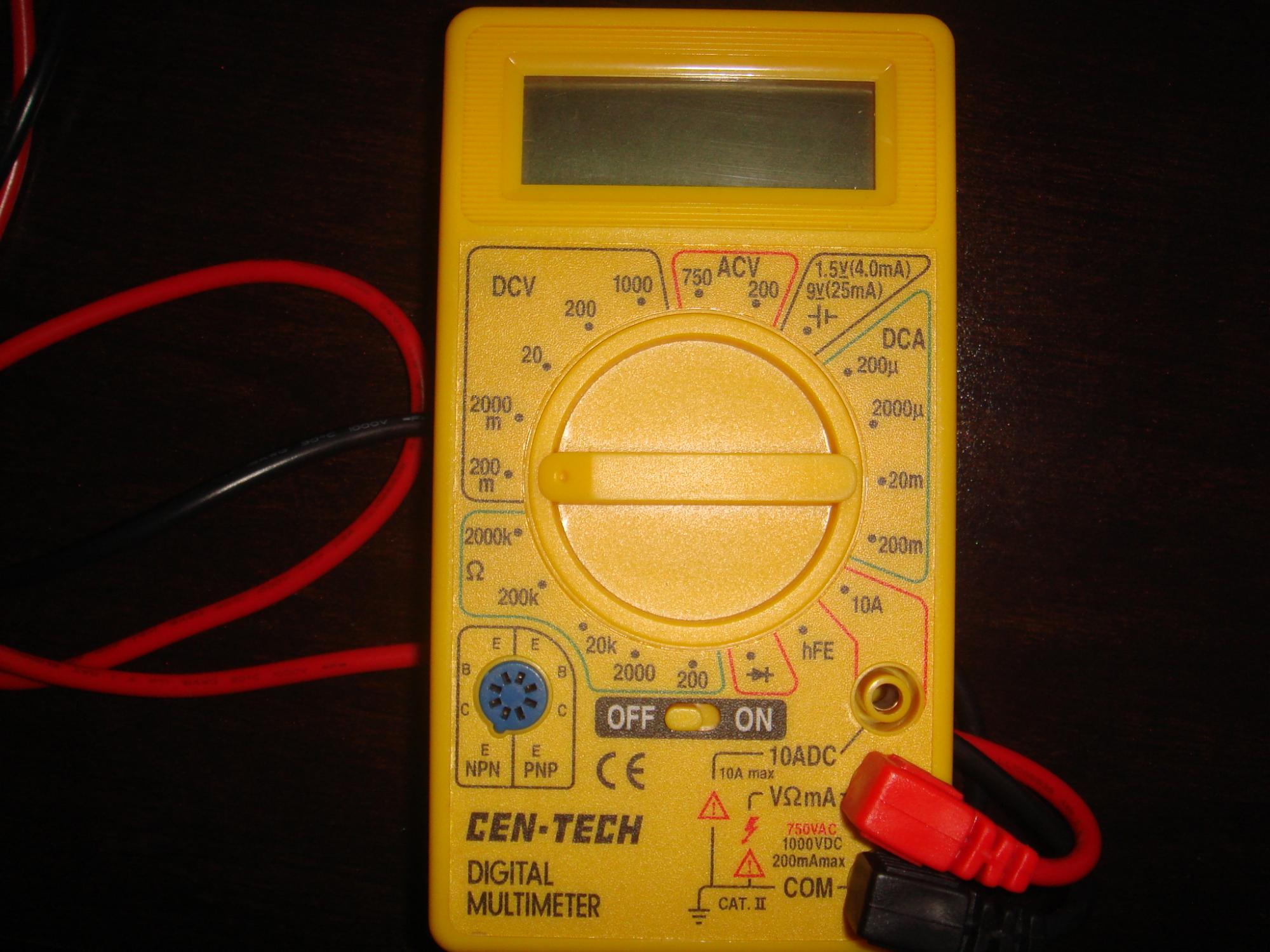

          Not exactly sure how to do that. I have the multimeter set to DCV at 200m and when i touch a ground point (screw hole) on the card and each end of the fuse I get .5 on both sides. Did I do it correctly? BTW this is my DMM I am using

            1) You get one retiredcaps' bonus point for a picture of your multimeter. I have never seen the Harbour Freight special in yellow, just red.
            2) You want it set on 20V DC because the voltages on the t-con are either typically 5V or 12V DC. However, since you are gett 0.5 on each side, it sounds like there is no power being sent. If the t-con fuse is good, then that suggests something might be wrong on the logic board.
            3) There are 4 voltage regulators that I can see. I circled them in red.
            4) Put your multimeter on 20V DC. Put your black probe on a ground screw on the logic board. Leave it there for all readings. This is your ground.
            5) Put your red probe on each pin including the "cut" pins, but ignore the "fat tab". The "fat tab" is north. Number the pins left to right.
            6) List all your readings like so for each regulator.
