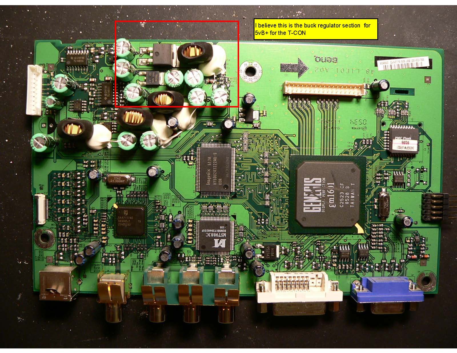

    I am still trying to locate D19? Can you tell me which board it is on?
    OK, I see it now.

      Re: DELL 2405fpw
      Logic board. Upper left by the Capacitors. In the area that was marked by a square in a prior post. It's to the left of the screw holding the rubber wire on the board

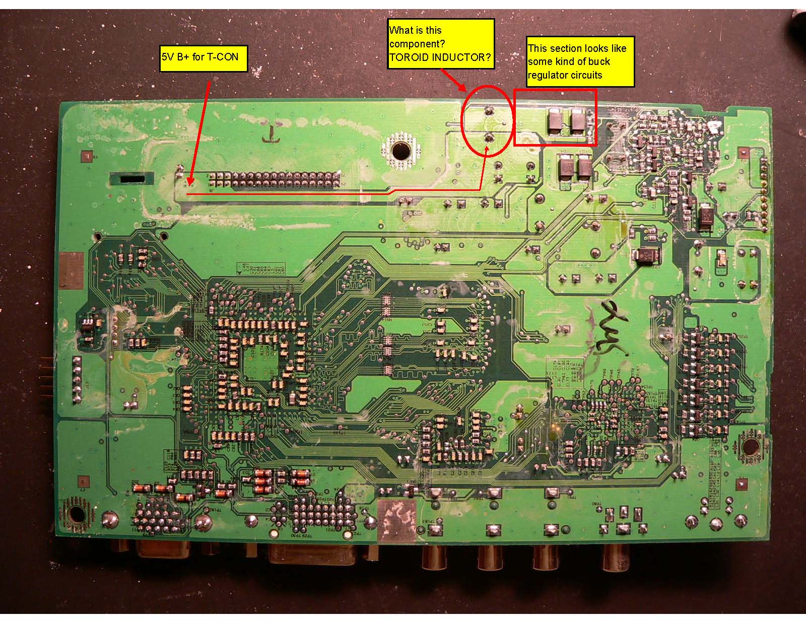

          On the bottom side of the board, there is one component that I circled, what is that part?

            So I went back to that URL again, I can see now they were talking about circuits in the main board around the area I circled, if that the case, do you get short circuit on that Q1 (F5305S)? You already found out that D19 Zener is shorted out. If that Zener is for the Gate protection, I would expect it to be in 12~15V range.
            So it looks like you are working at the right area.

              Its the component covered in black rubber. It's had sticker on it that read
              19-40
              229-011
              LSE
