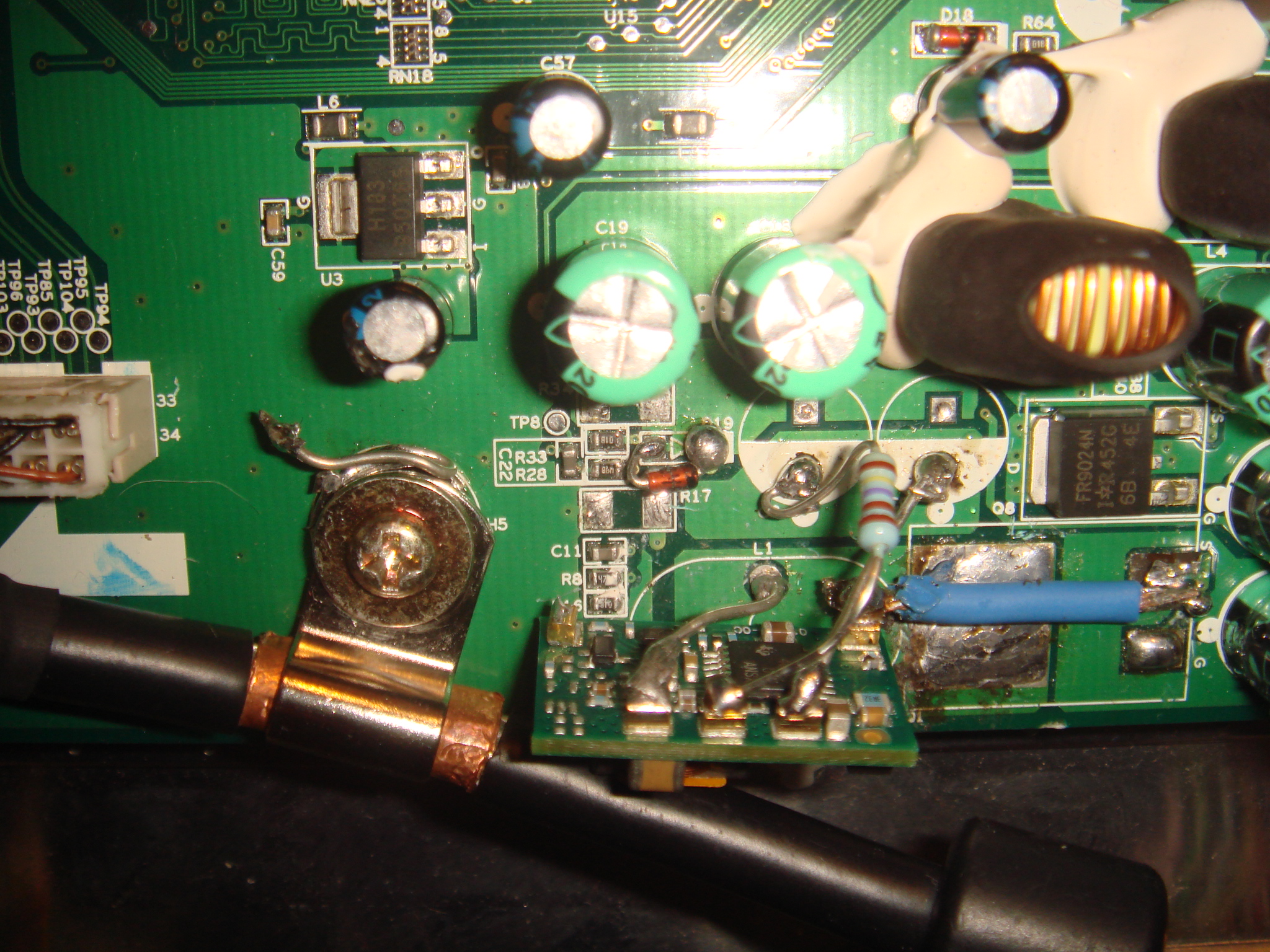

      Re: DELL 2405fpw
      Please see the picture.

            Re: DELL 2405fpw
            Ok no good Installed MOSFET and D19 DIODE and left the T-CON disconnected... Took a voltage reading of the DRAIN and it was 0 again. Both gate and source where 18.8 where they were last time. So I guess the gate logic is bad?
              #106
              Re: DELL 2405fpw
              That is too bad, the Gate voltage is not being switching on and off, so the buck converter IC and other components may be damaged.

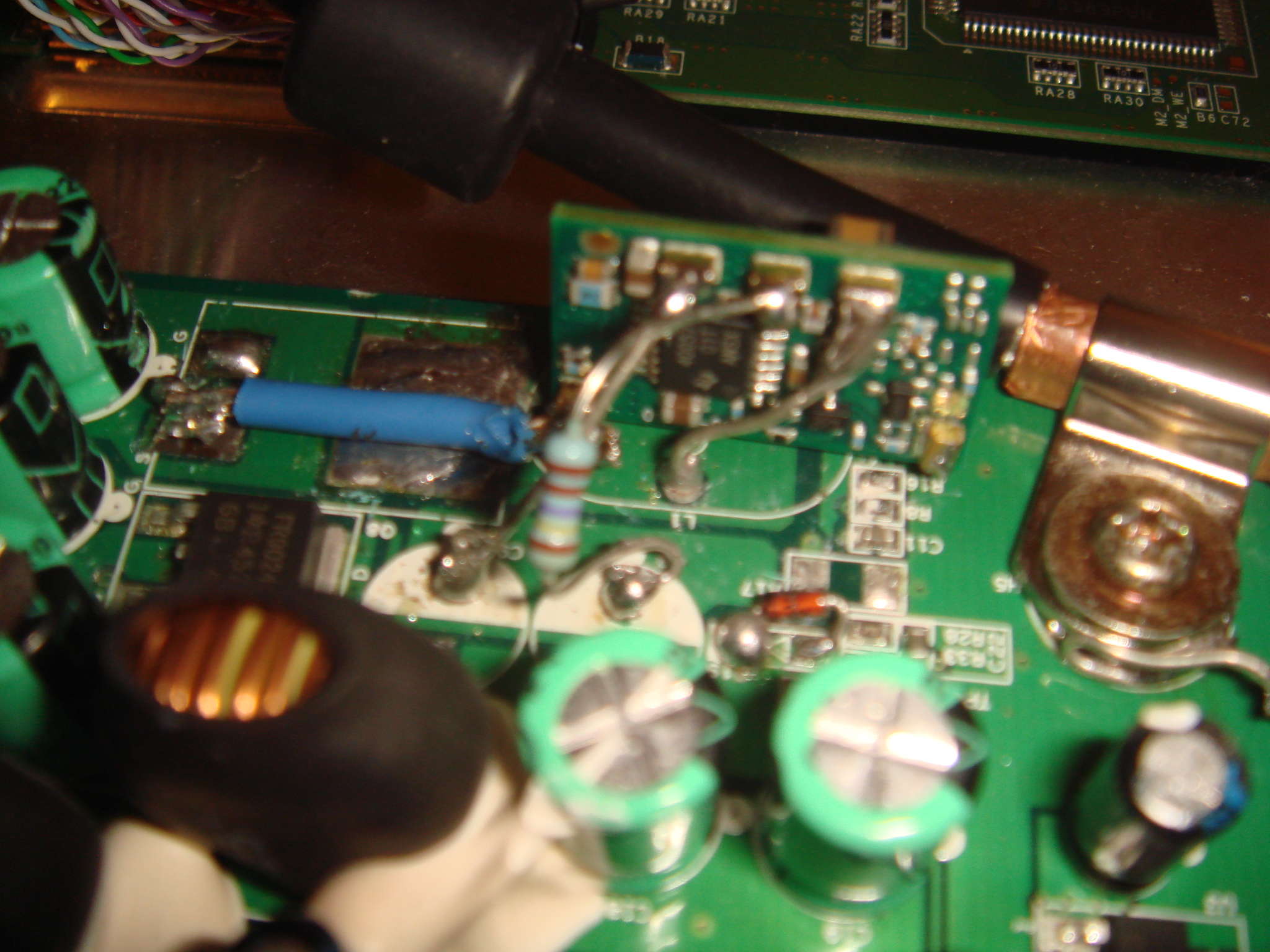

                    Re: DELL 2405fpw
                    OK here is my latest update. I replaced the 5v power circuit on the PCB according the link I posted above. The screen actually works now BUT I have white lines through the whole thing. I can see the computer screen through the white lines so somthing is working right. Not sure what to look at now. I attached pics of the modification and the monitor.

                      #110
                      Re: DELL 2405fpw
                      Update... it looks like the new power board is output 11v instead of 5v. Would over voltage to the t-con board cause white lines like that?
                        #111
                        Re: DELL 2405fpw
                        That will damage the components and circuits on the T-CON, way too much voltage! It has to be 5V. That is one reason I suggested to use a resistor as a load so you can verify the voltage before hooking it up to the T-CON board.

                            #113
                            Re: DELL 2405fpw
                            Good News!! I disconnected the DC-DC converter I installed (since it was putting out 11v) for some reason and connected an old computer SMPS 5v line to the L1 connector to the T-CON board and TA-DA! The monitor worked perfectly After further research I realized I purchased a negative polarity version of the DC-DC converter board.

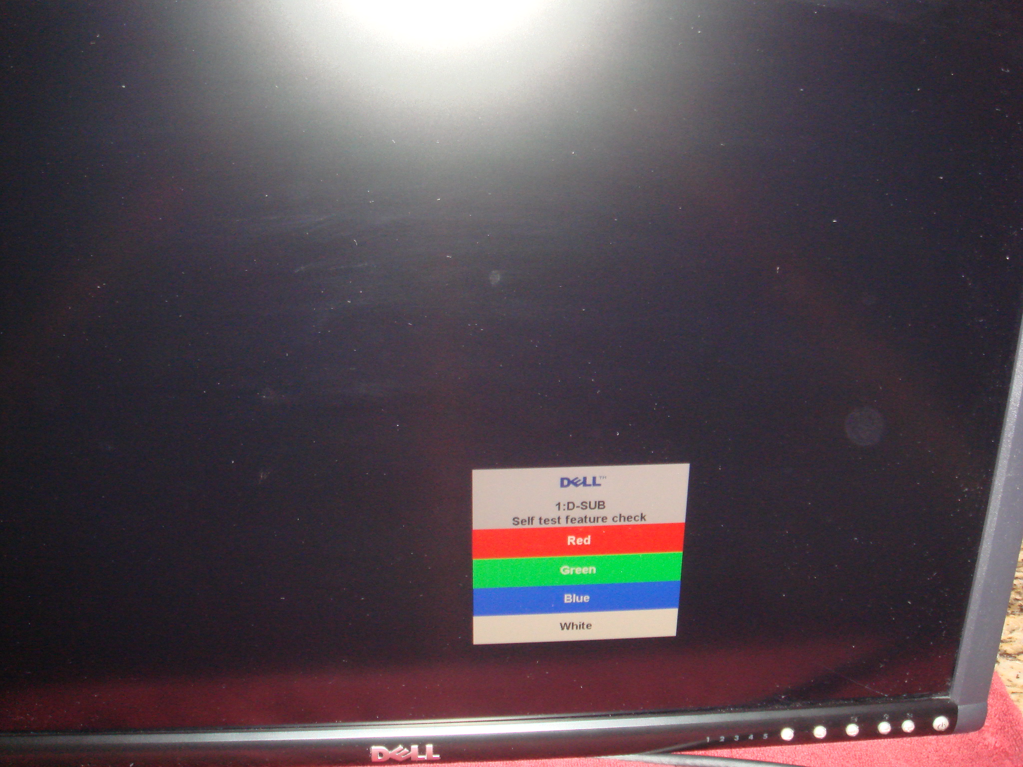

                                  #116
                                  Re: DELL 2405fpw
                                  Ahh my final post with pictures of the repair and a working monitor. I would like to thank everyone once again for their help!
                                    #117
                                    Re: DELL 2405fpw
                                    That's great, thank you for the follow-up and great job.

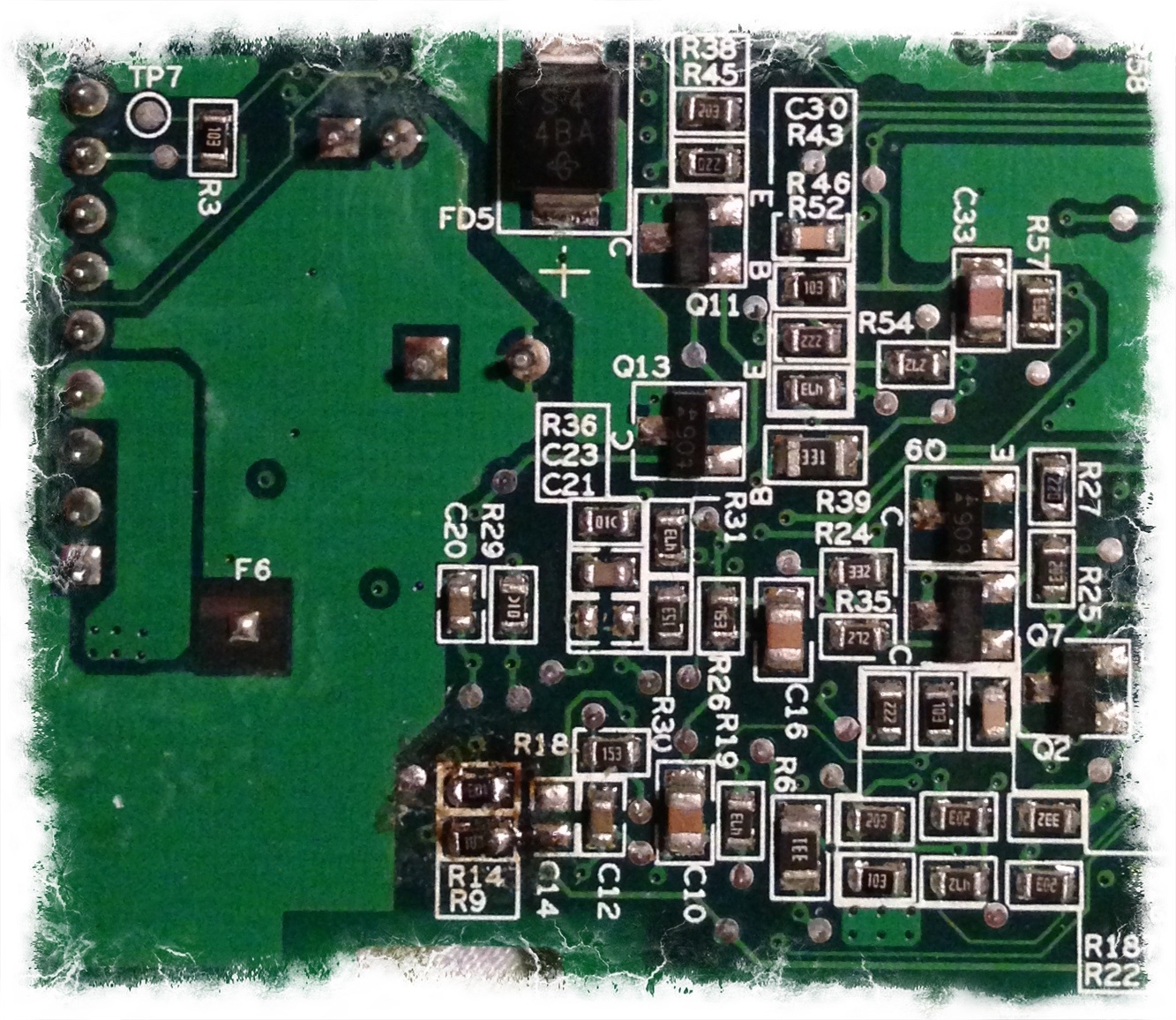

                                        Hello everyone!
                                        Before I give the solution to this problem please allow me to introduce myself.
                                        My name is Dan, I've join this forum for some short time now, however this is my first post. I wan't thank everyone that blogs to provide their expertise over the internet from just looking at some pictures (amazing) and reading some symptoms, also I want to thank everyone else for posting their problems (broken electronics) because without them, this site would not be possible. Im truly grateful for this forum. It has helped me numerous times when I'm lost.
                                        So I am honored to be able to provide a solution to this problem today.
                                        Here it is,
                                        If your MOSFET shorted out, it most likely will take out your Z-Duode also. If that's the case, replace both. If your MOSFET is dead but open (my situation), your diode should be fine, just replace the MOSFET.
                                        But you're not done yet. The reason that it still doesn't work is because the controller chip (U1 pin 13) on the main board is not getting its input voltage of 1.4v. The reason is because a 10K surface mount resistor (R14) on the back is also burned out leaving the circuit open.
                                        1. Make sure the monitor is in the ON position and that you can see the back light is lit before proceeding.
                                        2. Unplug the power cable from the monitor (while its still on).
                                        3. Take the main board out, unplug everything except the connector from the power supply.
                                        4. With the main board in your hands still hooked up to only the power supply, plug the power cable back to the monitor. It should come back on and the back light lit up.
                                        5. Use an ohm meter to test the voltage from Ground to the resistor R14 on the back of the main board (just under the MOSFET at the corner of the board). One side should read about 2.5V the other side (goes to pin 13 of U1) should be about 1.4v. If you don't get the 1.4V, replace that 10k resistor and that should solve all your problem under $5.
