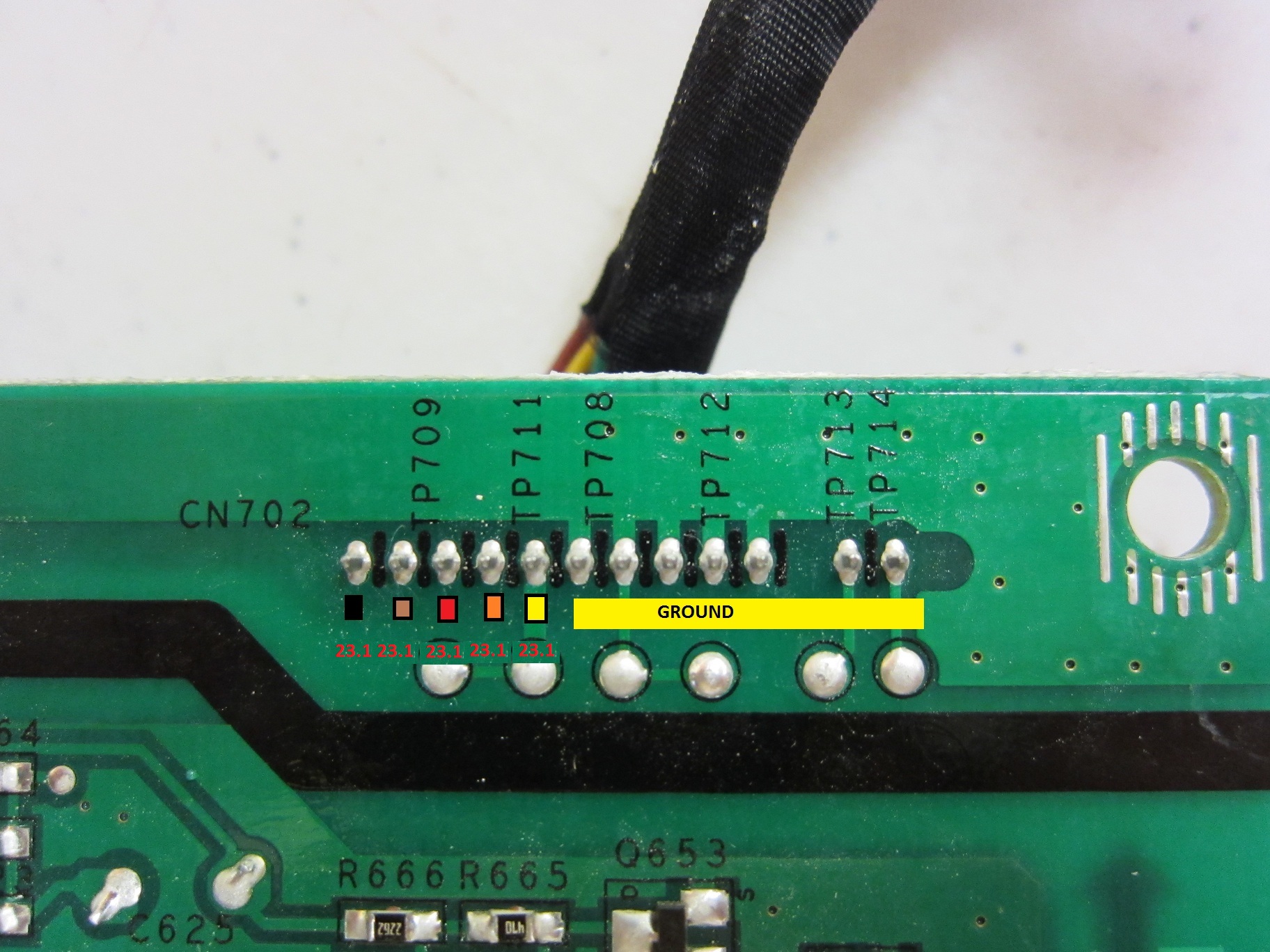

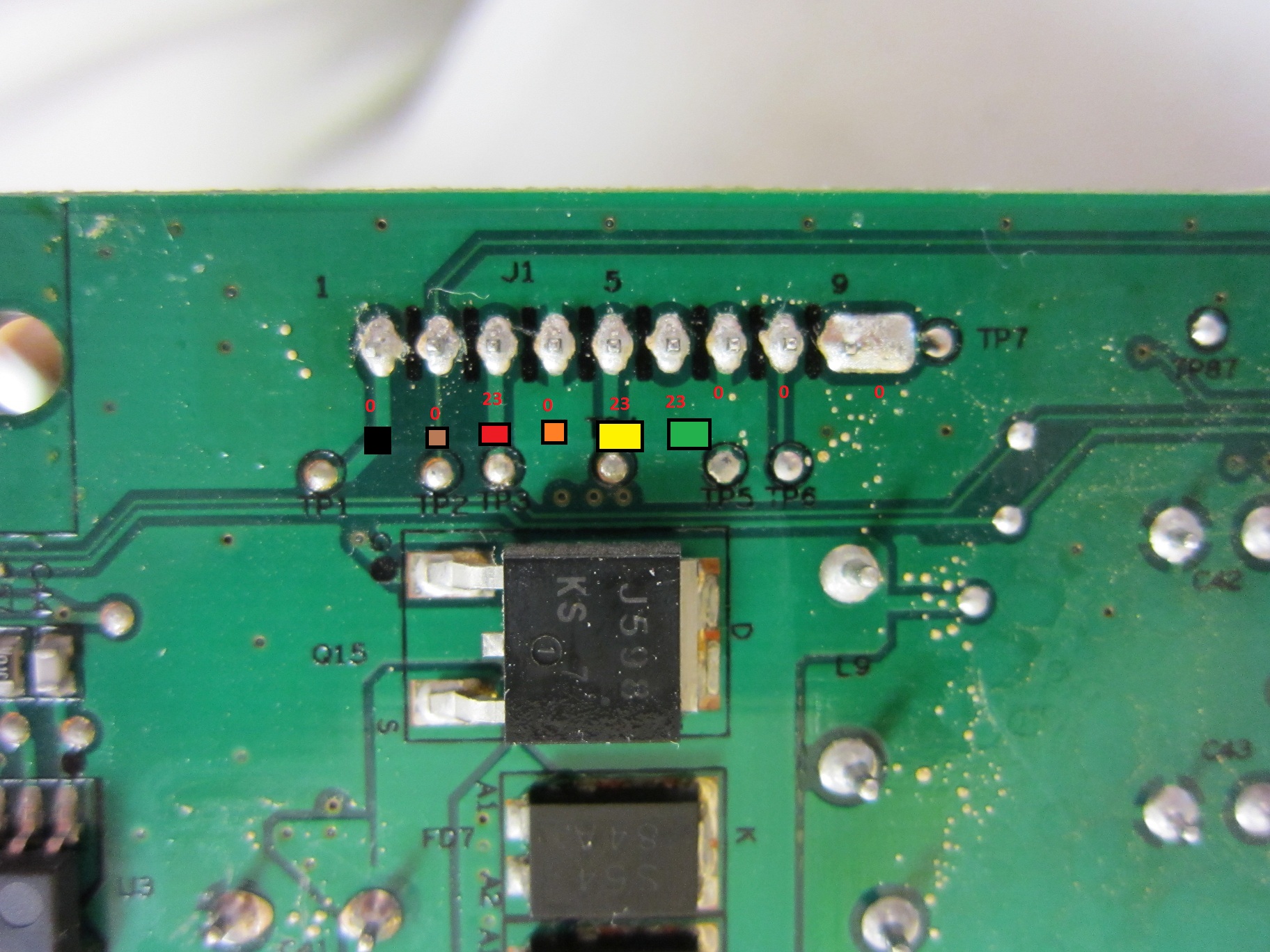

    Were the volatages taken with it all connected up?
    In pic 4 down the right hand side there are the 4 bigger components with 2 and a half legs
    bottom one might be Q30 - Can you read the part numbers on them(may be all the same)

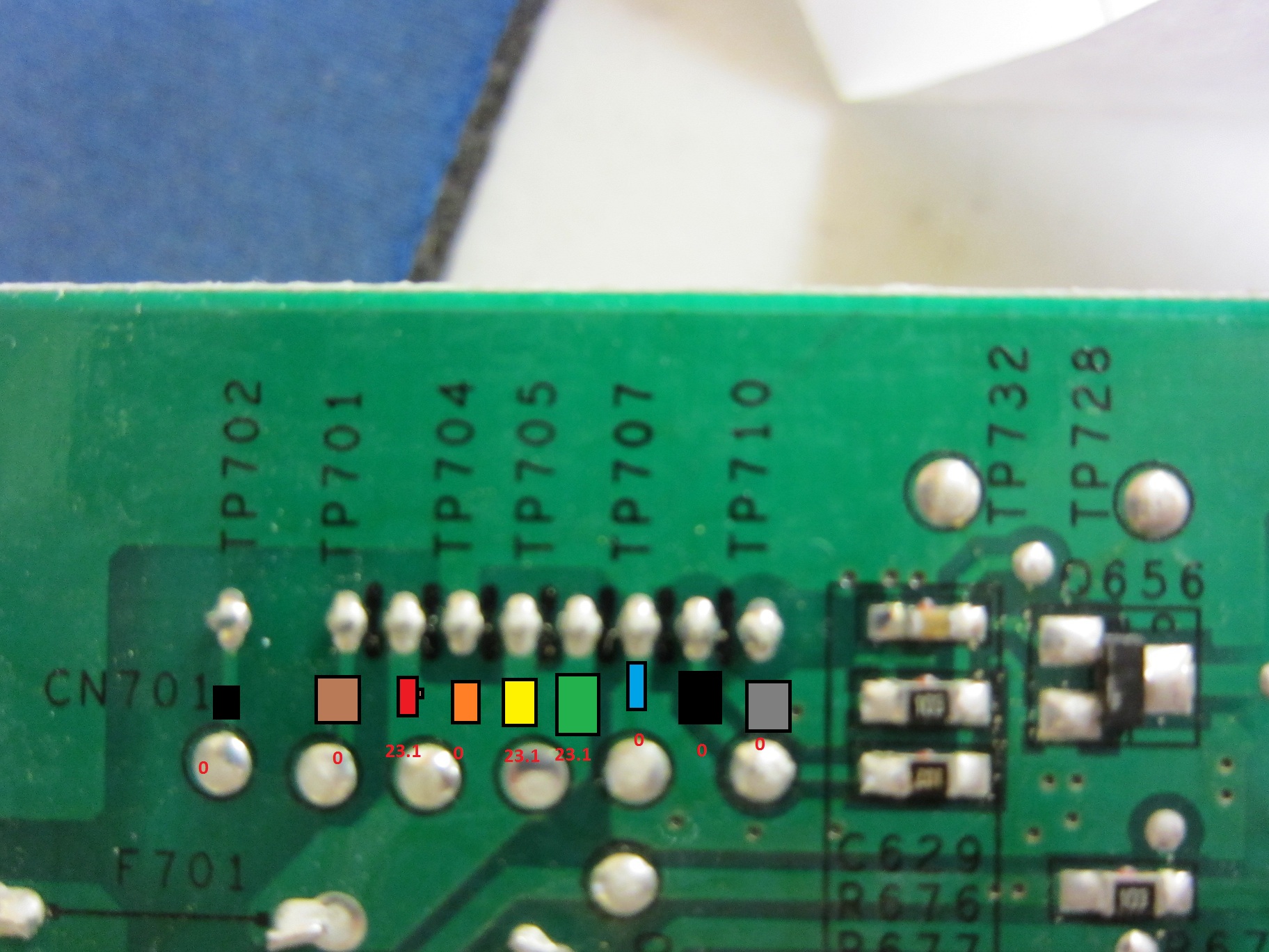

            Re: Dell 2408wfpb
            23.1V for all. All boards were connected
            #'s are 4h.oct02.a00/5E0CT02001 Power
            4h.oct01.a02/5edcoct01001

              Re: Dell 2408wfpb
              The 4 components are mosfets Pn j598 ks 7

                Even though the boards are different, they apear to be made by the same company. Using the 2407 as a reference, it looks like the standby voltage is not 5v. The question now is your video card sending the PS/ON and BL/ON commands?
                Have you tried measuring the voltages of the power/video board wiring harness when you press the on/off power button? Hopefully you will see one of the wires that's now reading 0v rise to ~3.5-5v
                  Re: Dell 2408wfpb
                  It looks like it works the same as the 2407 I just took apart, if he is getting the 23Vdc (the 2407 uses 19V always on power supply) then the power supply is working, the lower voltages are on the logic board and are done by the LDO regulator and buck converter regulators.
                  Start checking those voltages, it should have some 3.3V, 1.8V LDO on the logic board.

                        Re: Dell 2408wfpb
                        So your power supply is OK then since you are getting the 23V. Just start checking the voltage regulator on the main board next.
