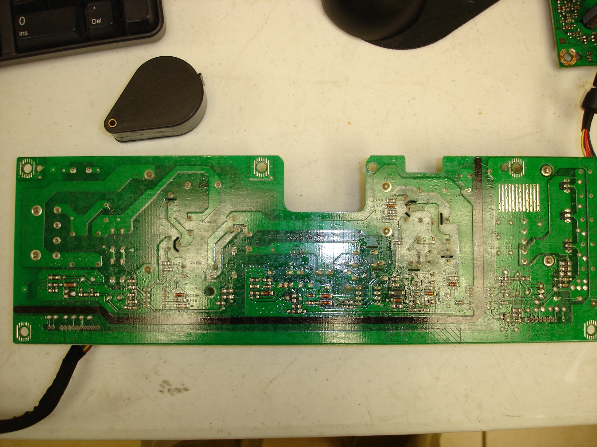

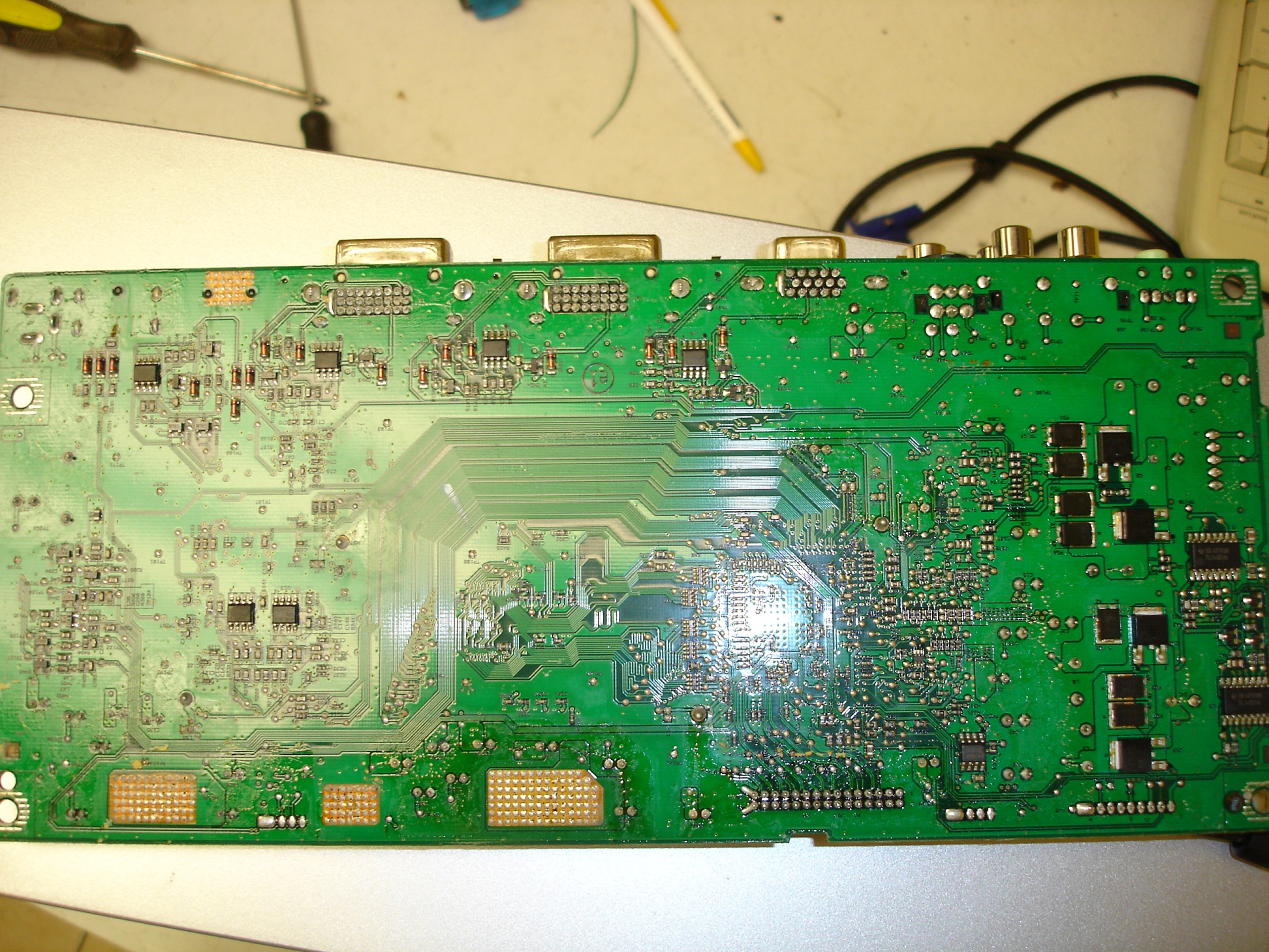

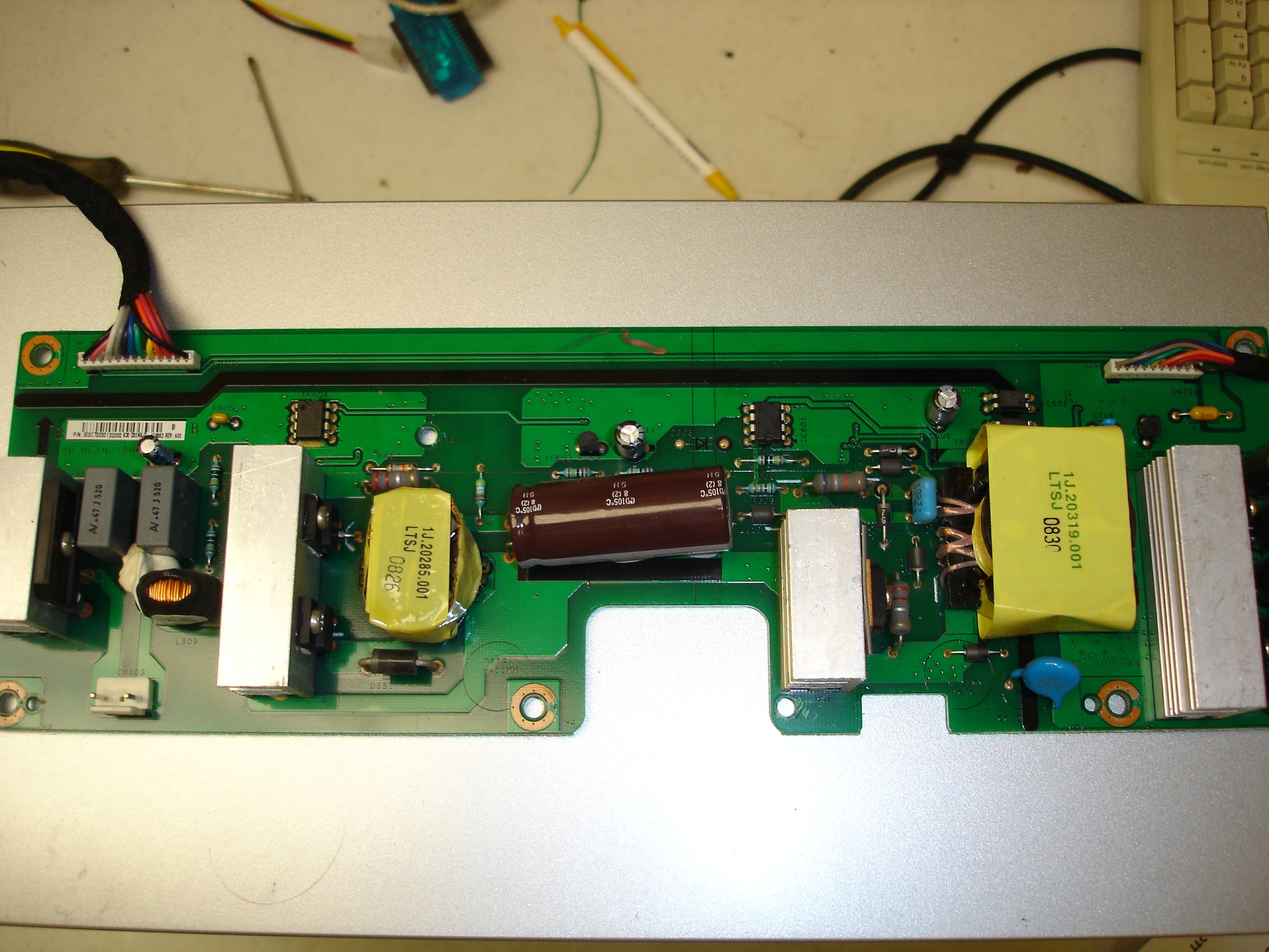

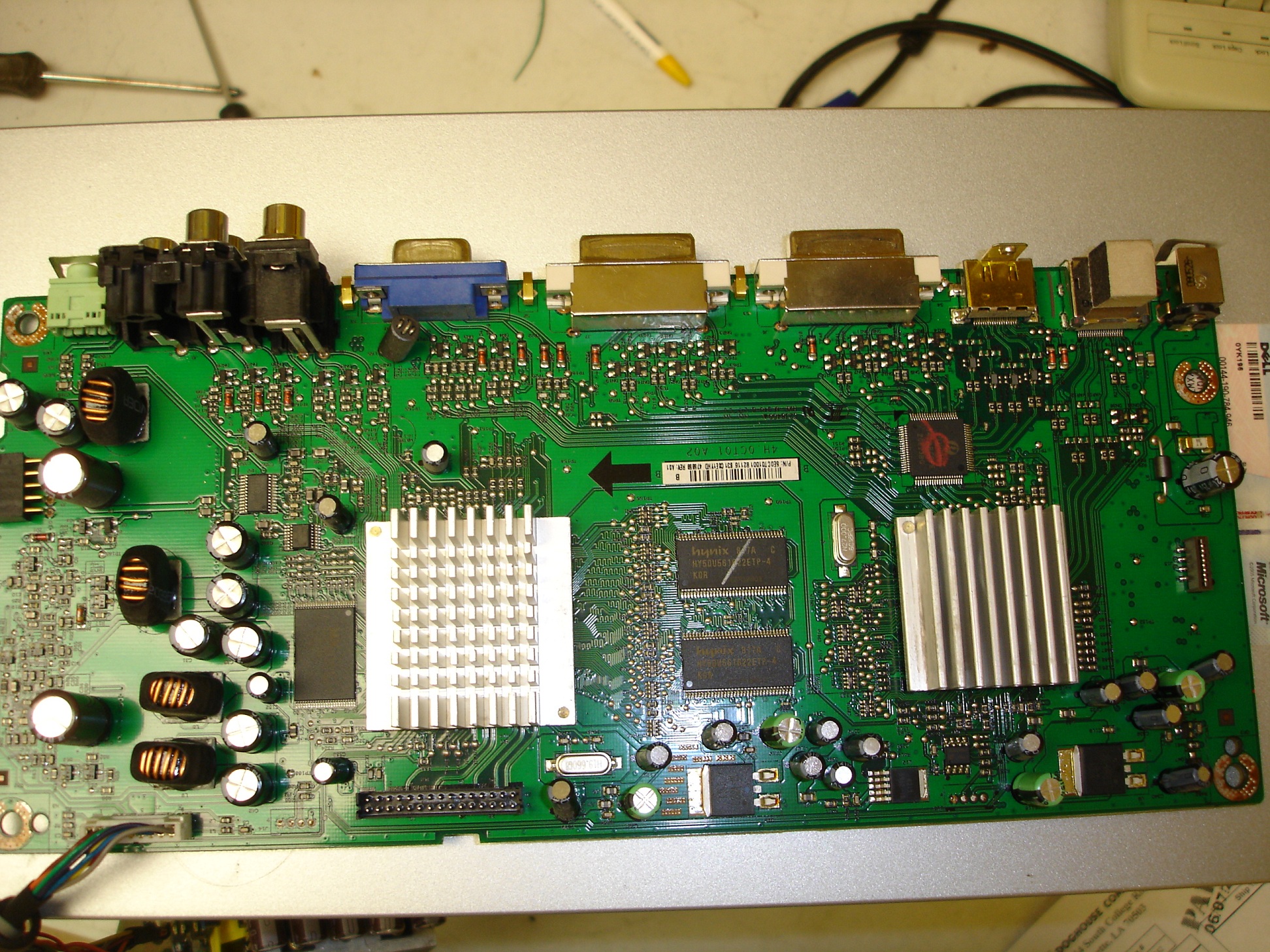

    Dell 2408wfpb shows no signs of power. No lights on power button, screen backlight doesn't fire.
    I have tested power coming into the board. Main filter cap rated at 150Uf @450 tests at 140 ~ 1.4X120v. IC601, which i assume is smps has voltage going to VCC it and is stable. I cant find a schematic to show what the output voltages should be to the video board. Any suggestions?
    Also, sorry for the blurry pictures.

    Picture 1 top right corner is an orange torpedo - is it a fuse - can you test it?
    There is another on on pic 3 a white rectangle right hand side next to the cap.

      If you're reading 140VDC across the main cap, that's way too low. 120VAC x 1.414 = 170VDC. Have you tried checking the AC voltage at your outlet? It should be ~ 115-120VAC. Be careful, as it's high voltage.

            I agree with jetadm123, 120Vac input and you only getting 140Vdc at the main DC filter cap. Try measuring a new 1.5V batteries and see what you get, if it is OK, then put the meter in AC mode and measure the AC ripple on that main DC cap and tell us the reading.
            By the way, this power supply has PFC circuits, so when the monitor is on the voltage on that big cap should be about 400Vdc.

              .....Also use working equipment, 1st meter was an el cheapo that was bad. I measure 165 across main filter. Ac with correct polarity on cap measures 370v.
                Re: Dell 2408wfpb
                OK, when the unit is off, you should have about 165Vdc and when you turn on, it should have about 400Vdc as the PFC circuits kick in. That is what you are getting?

                    What I am trying to find out if that voltage on the that cap goes up to 400Vdc or not when you hit the power switch, that will tell me if the PS_ON circuit is working or not, the Monitor may show dead screen, but the PS_ON may be working.

                      No when I hit the power button, voltage does not change.

                            Hi - What voltages do you get on the connector to the main board?.
                            Measure with meter on 200v DC to start then reduce if none are over 20v for more accuracy - use a ground screw for black probe. All boards should be connected for the test
                            Can you quote the board numbers- both boards- cant read them
                            Was the writing anything useful BLON PSON PWR and so on that might give us a clue.

                                    I recommend you follow selldoor's suggestion in post #14 and measure the connector voltages. There's a 5V standby voltage that should be on at all times.

                                      Power going to inverter board
                                      1 BL 23
                                      2 BR 23
                                      3 R 23
                                      4 O 23
                                      5 Y 23
                                      6-10 Ground
                                      Going to Video Board
                                      Bl 0
                                      NC 0
                                      BR 23
                                      R 0
                                      O 23
                                      Y 23
                                      G 0
                                      Blue 0
                                      Black 0
                                      Gray 0

                                        Were they exactly 23.00 or 23.99 or 23.01
                                        I think were aiming for 24v so the rest of the decimals is important
                                        Now to find the 5v
                                        Have you got the board part numbers as requested
                                        And what does the black writing say on the board edge
