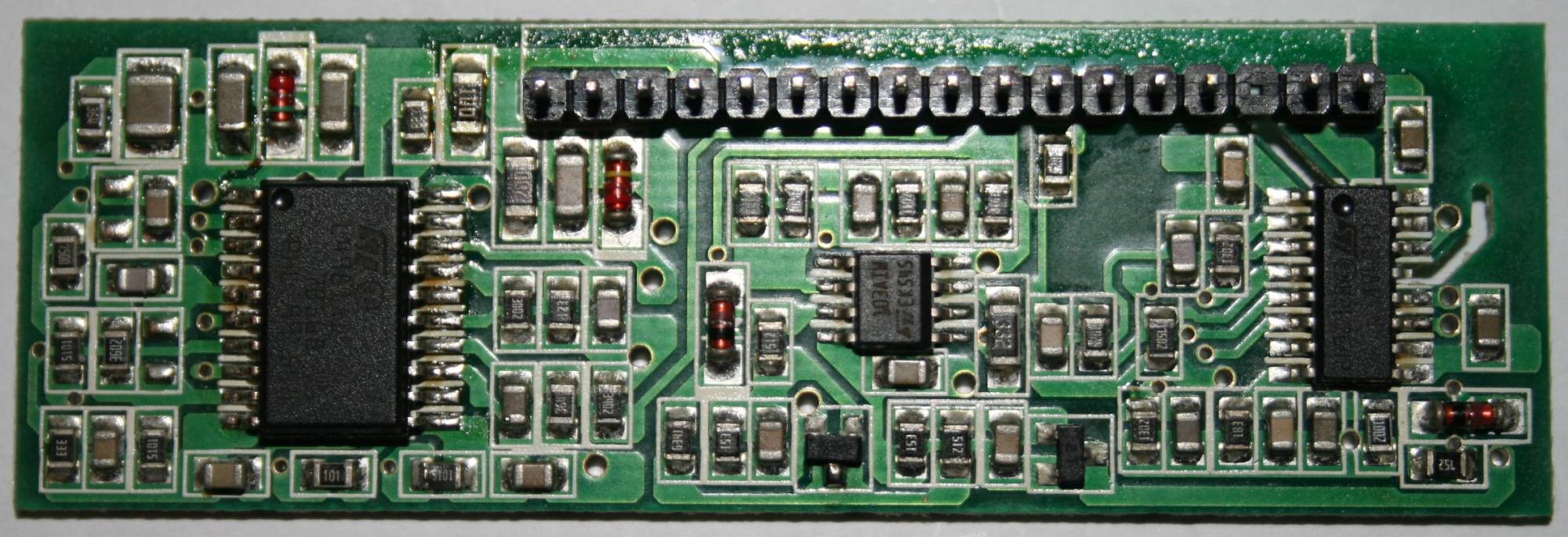

                    I decided to take off the sub board today to see if it was the cause of the problem.
                    There are 3 ic's on it.....
                    L4981AD
                    http://www.st.com/internet/com/TECHN...CD00000085.pdf
                    L6598D
                    http://www.alldatasheet.com/datashee...ICS/L6598.html
                    I'm really struggling to get the model off the 3rd ic though.

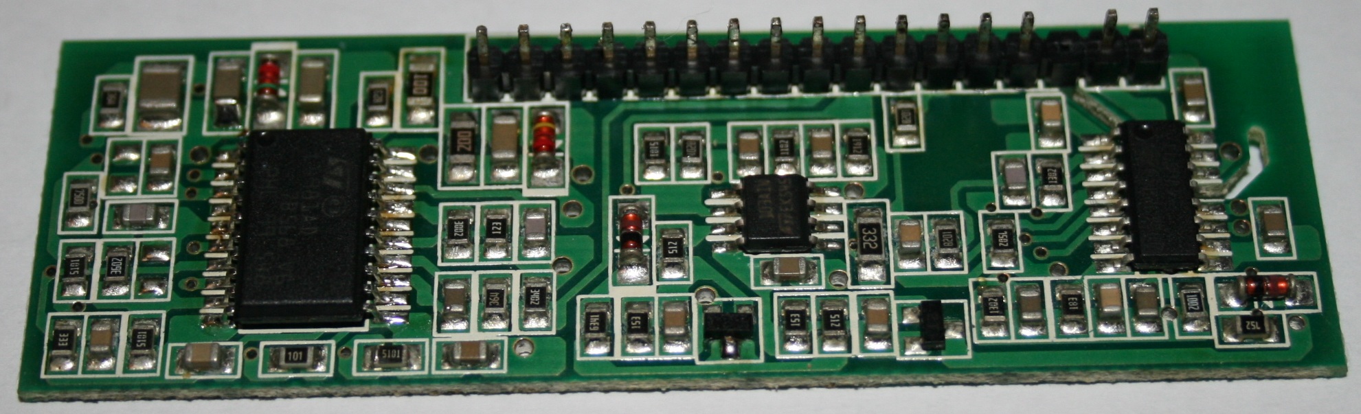

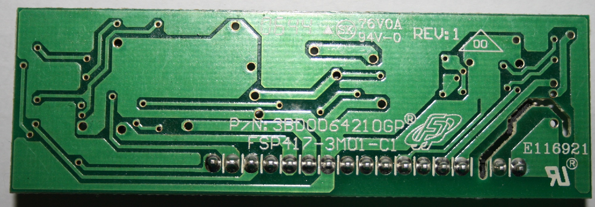

                      #130
                      Re: Barco LCN-42 No Power
                      Pics of the Sub Board.

                        #131
                        It looks like pin #4 (Count from the left) on picture #3 is where the VCC is generated. Do you have a chance to find out what those three ICs are? One of them must be for the PFC circuits.

                          #132
                          L4981AD
                          L6598D
                          I can find those 2 but the one in the middle is more difficult it looks like 103AIW but the alldatasheet data for that number tells me that it cant be that number.
                          That pin does however connect to either pin 4 or pin 8 of that Ic
