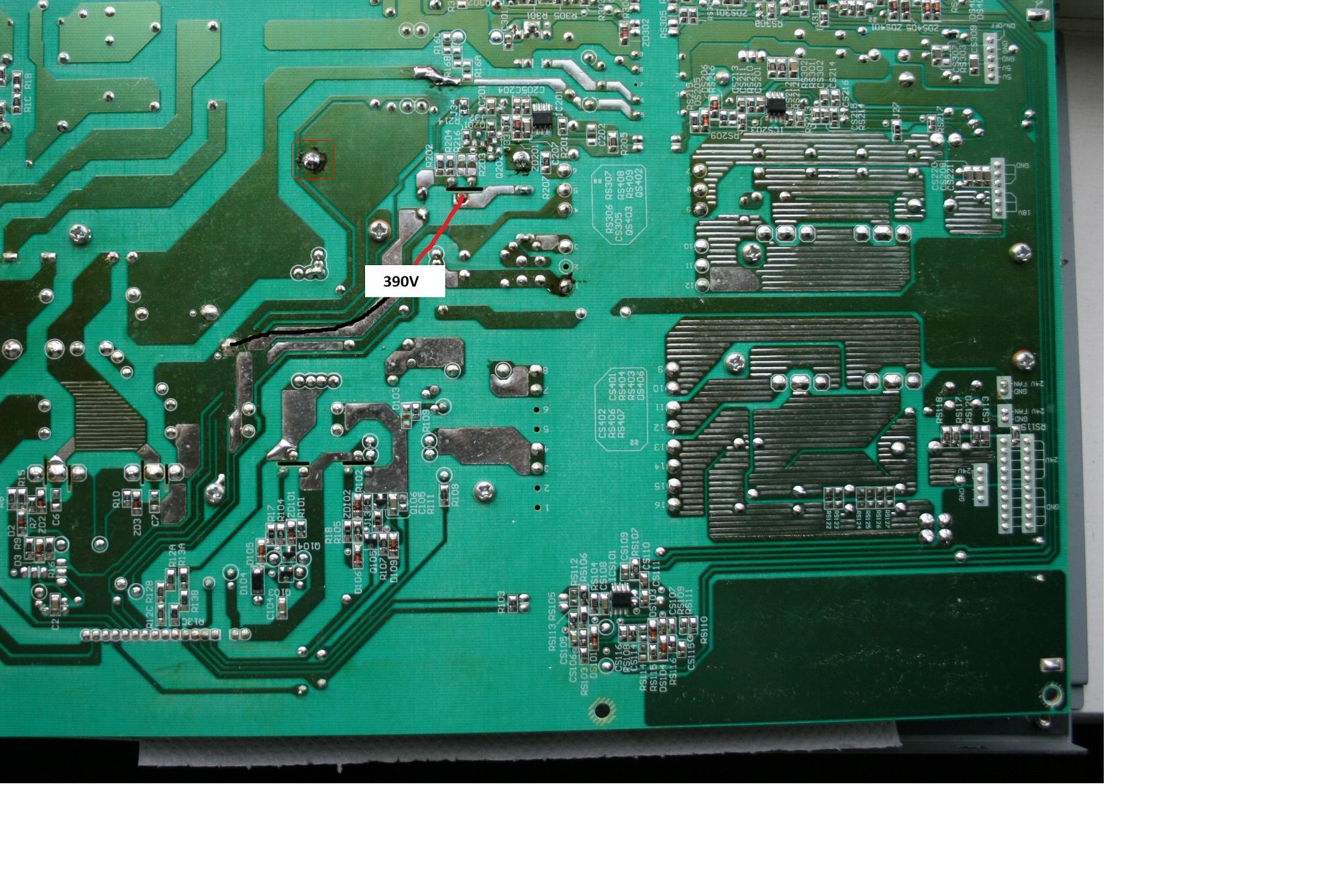

                        #111
                        Re: Barco LCN-42 No Power
                        So are you still getting the VCC at pin 6? R202 is the current sensing the voltage drop on the Source resistor of the MOSFET, if voltage drop on the Source resistor is too high due to too much current draw by the MOSFET, it will shutdown the output of the SMPS IC.
                        I think we need to get the 24vdc running again first, you have no 24vdc with the PS_ON applied, right?
                        Please see the PDF, if you do not have that voltage, then it may explain why the 24vdc PS is dead also.
                        By the way, do you remember the DC reading on the main cap without PS_ON and with PS_ON applied?

                          #112
                          Ok going to have a little look at these voltages....
                          330V across the big cap with the 5v jumper on.
                          330v across the big cap without the 5v jumper in place.
                          8.53v on those test points on your picture. It seems to be creeping up slightly every couple of seconds.
                          I have no 12v with PS_ON applied.
                          I am thinking of soldering another resistor in but leaving out the mosfet to see if that brings back the 12v supply.

                            #113
                            We should have about 13vdc at those two points instead of 8.53, we were getting the 13v after you replaced the MOSTFET and the SAMPS FOR THE 18VDC power supply section. This low voltage of 8.53vdc may explain why the 24vdc power supply stops working. We need to trace that trace out teo see where it goes to.
                            By the way, your power supply only has 24vdc, 18vdc and 5vdc outputs. Which 12vdc out put are you referring to?

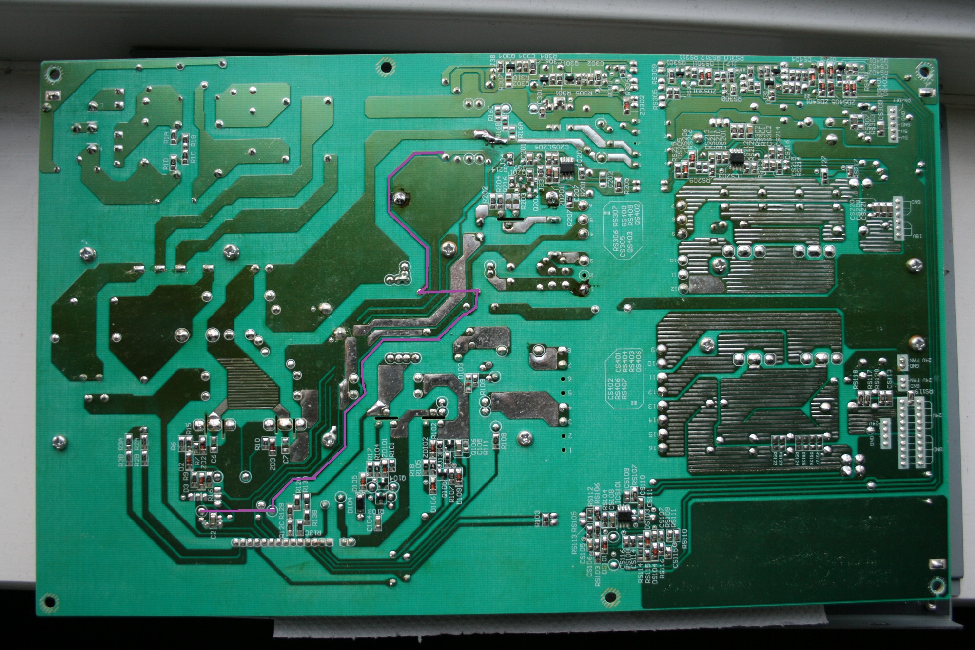

                                  #116
                                  Here is the trace it goes back to two transistors.

                                    #117
                                    Originally posted by budm
                                    By the way that trace should go directly to the VCC pin of the SMPC IC you had replaced, please verify that for me, an at the Vcc pin, there is a ZENER diode connected to it also, ZD201.
                                    Yes that test point goes back to VCC on Pin 6 and it goes through the zener diode. It tested at about 12 Ohms between the test point and the VCC pin.

                                      #118

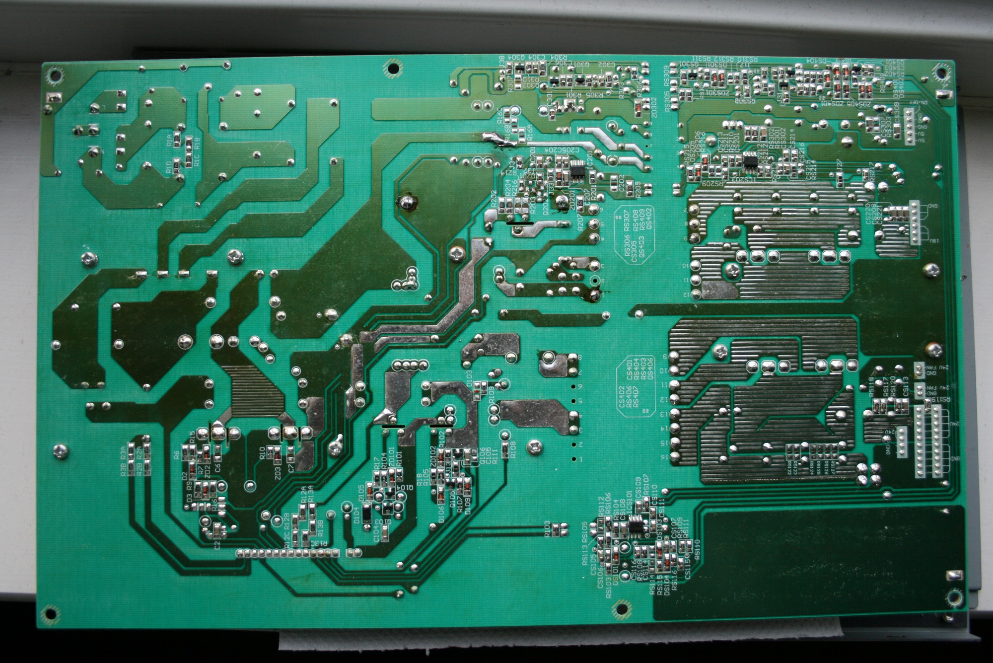

                                      Can you please send me the same picture without the marking? by the way , you are getting good at taking the pictures.
                                          Here is the picture without the markings.
                                          Yeah I managed to get my proper camera back. Makes a big difference taking pictures in the day light too.
