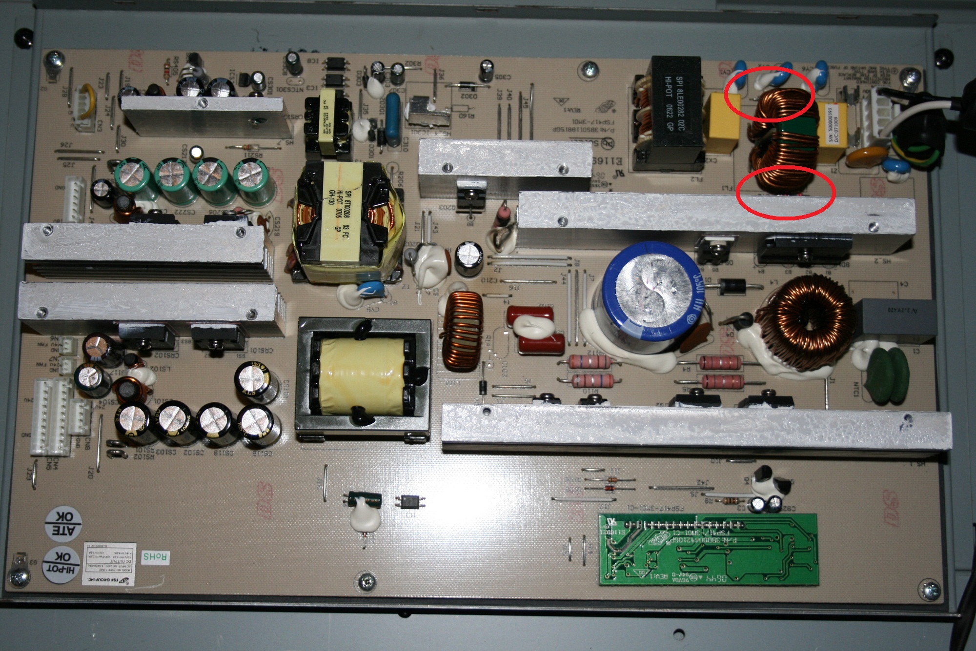

            Noticed something else...
            GT1 + GT2 which are near the main fuse flash when I turn the power on. They look like Zener Diodes im guessing they are not supposed to flash?
            Fixed so far : 1 Home cinema system, 16 LCD Monitors, 4 LCD TV's
            How to resize your pictures guide click HERE
            Retiredcaps Ideal post example click HERE
              #86
              Re: Barco LCN-42 No Power
              I think they are Gas Discharge tubes for surge protection (I do not see then on the top view of the power supply board picture), they should not flash (Conduct)unless there are surges, they should be rated at about 400v or more.
              Can I see the pictures?

                #87
                You cannot see the gas discharge components as they are just hidden in this picture.
                See the big grey component on C1 I think this is where the noise is coming from.
                I will take a proper picture of where the flashes are coming from and I will check that the SMPS ic has power and the Mosfet that I changed.

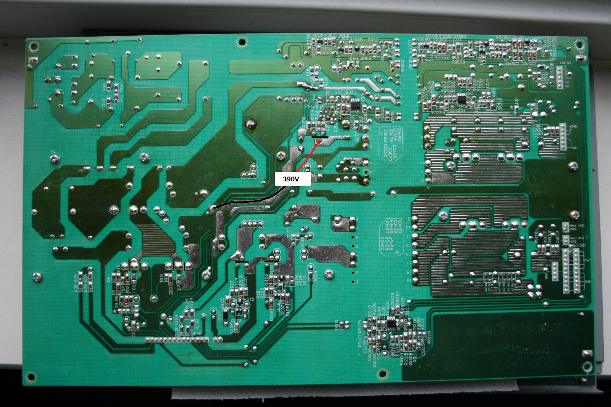

                  #88
                  Ok checked the VCC of the SMPS IC and it is showing 13.4v. This seems to be right. I will check the Mosfet now.
                  Ok 390v On the mosfet I have included a pic of the whole bottom of the board and how I measured it.

                    #89
                    Can you take a reading of R207 one end is connected to the transfomer pin6, it is close to the IC SMPS you just replace? We have everything but it is not driving the gate of the MOSTFET.
                    Also set the volt meter to AC at about 20VAC scale AND CHECK PIN 5 to see if anything is coming out of that IC.
