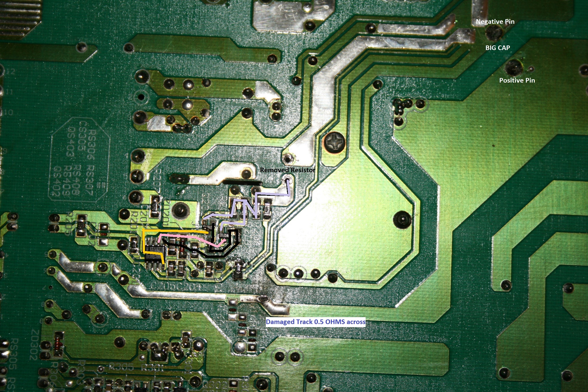

                  #48
                  Re: Barco LCN-42 No Power
                  Originally posted by budm
                  I use the white heat sink compound for the power devices. Not sure if the CPU paste is electrical conductive or not, I will not use it if it is.
                  One way to find out if the transistor is NPN or PNP is to trace out the Emitter and Collector to see how B+ is connected to the Emitter or Collector, I can try tracing out the traces in the pictures but it will be real time consuming. I would still try the 0.20 Ohm for that Source resistor.
                  The Emitter of the Q202 is connected to a small value resistor (R203) which is Connected to the Gate of the shorted MOSFET, so the Gate to Drain may have shorted out and take out the Q202, I would be surprise if the Gate resistor is not damaged, a lot of current must have flown through Q202 from Collector through Emitter, through R203 to Gate.
                  If you look at the middle pin (Collector) of that transistor, the trace goes under the IC, you need to find out which pin or where it go to.
                  The middle pin of the transistor goes to pin number 4 and then on to the negative bin of the big capacitor which is GND?
                  Does the attached picture with the lines make sense?
                  Those resistors do look burnt on the top too. I can replace them again I can only read one of them which says 303.

                    #49
                    OK, that is what I figure from the picture, the Collector is attached to Ground and the Emitter is connected to the resistor then to the Gate, the Gate needs Positive drive voltage so that means this Q202 is PNP type. So any PNP with Vceo rating of 100v and 100 ma IC or more should be OK, beta to be around 50-200 in this typical rating transistor.
                    30K resistor.
                    You should also check the Q201 and the other Gate resistor as well since they are hooked up almost the same way as Q202.
                    I will be surprised if the output pin 5 is OK if the Q202 blown its top, and Q201 and the resistor is OK, I hope they are OK.

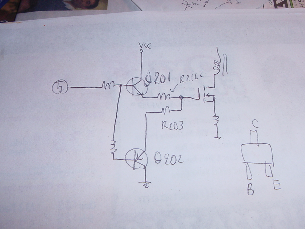

                        #51
                        Collector to Emitter should show open circuits (either NPN or NPN).
                        Base and Emitter should read like diode.
                        Base and Collector should read like diode.
                        I think this is how the drive circuits are hooked up.

                                        #59
                                        This what I do when I do not have the surface mounted transistor (or to lazy to order them). This is from Viewsonic TV power supply board.
                                        By the way, the function of that Q202 is to discharge the Gate capacitor (inside the MOSFET) when the SMPS IC output goes low.
                                        • Jasgriff
                                          • Feb 2012
                                          • 578
                                          #60
                                          Yeah I thought of doing that if I broke the pads when I took the old one off. It looks ok just needs a clean.
                                          I have been reading your diagrams for a while today. It seems that most power supply's work in a very similar way?
                                          I take it that when the SMPS IC goes low then the transistor connects the mosfets gate to ground which cuts off the power supply?
