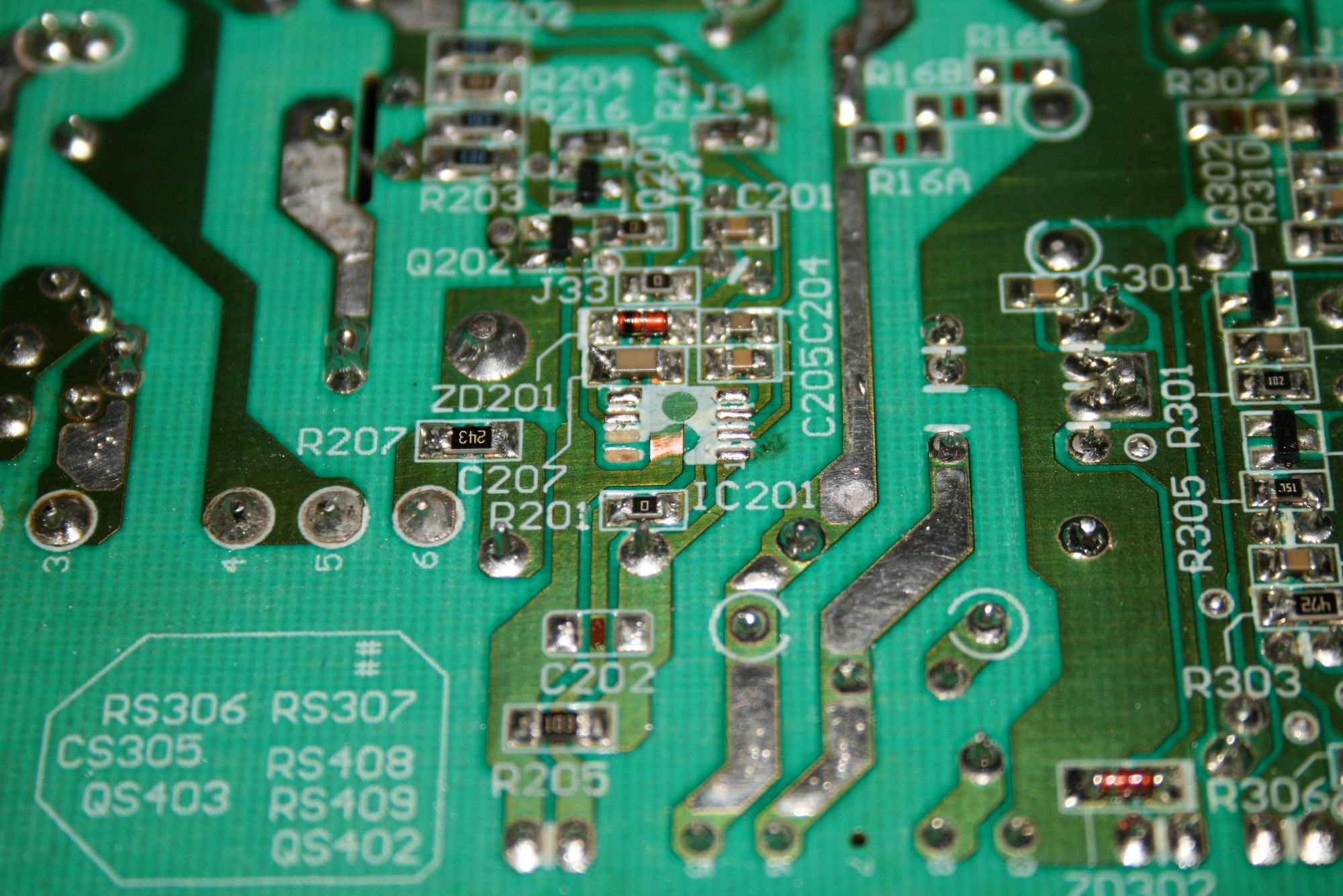

        Re: Barco LCN-42 No Power
        Originally posted by Jasgriff
        Retired caps,
        Can you put a circle around where you think pin 8 is connected please I can't see which resistor you mean.
        I'm looking at the datasheet which recommends using a resistor in series. I have found that the "typical application" listed in the datasheet is a good proxy for the real board. However, that is not always the case.
        If pin 8 (HV) has continuity to the positive leg of the large capacitor, then there is no resistor. If pin 8 has no continuity, then that suggests there is a resistor in series.
        The most likely candidates for this resistor in series with pin 8 (HV) would be on the front side. Mabye R4, R5, R110, R112. Unless there is a SMD resistor on the backside that says 683?
        PS. Regulars will know I'm still weak at reading schematics so I could also be way off?
          when I get home I will have another look. I just remember looking at that pin when there was no chip there thinking why is the hv pin not connected.
            Hmm, I had another look once I got multiple windows open and every photo rotated properly. It is a long way from pin 8 to those top side resistors I mentioned earlier.
            What is covered underneath the glue around the J43 area?
              And I see R206 in that same area, but the angle of the picture blocks the color band.

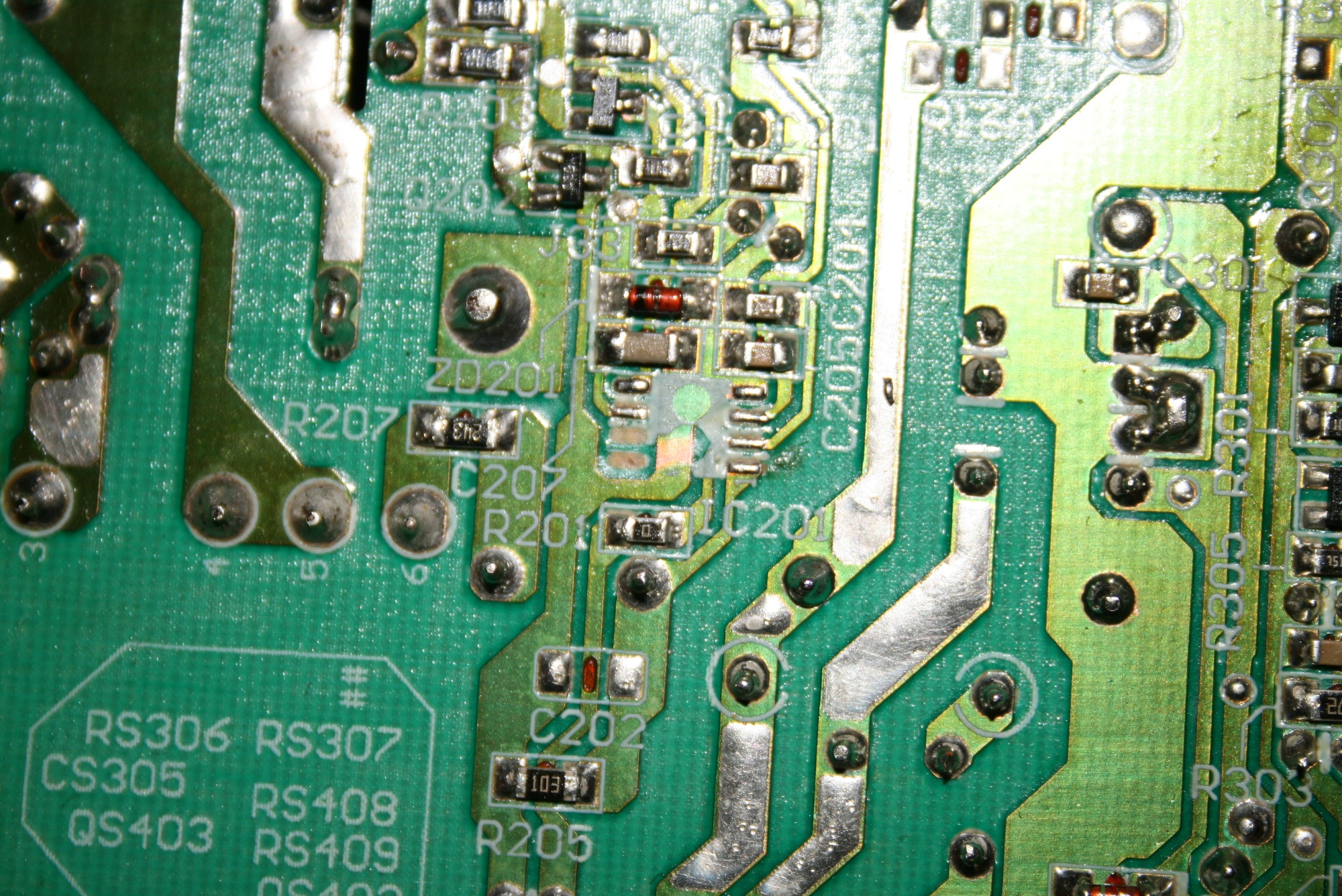

                Right,
                I decided to take the IC off again and this time it removed pad 8.
                I have taken away the top coat to try and see exactly where Pin 8 connected to and it looks like it was not connected in any way?
                So it looks like pin 7 and pin 8 were not used at all.
