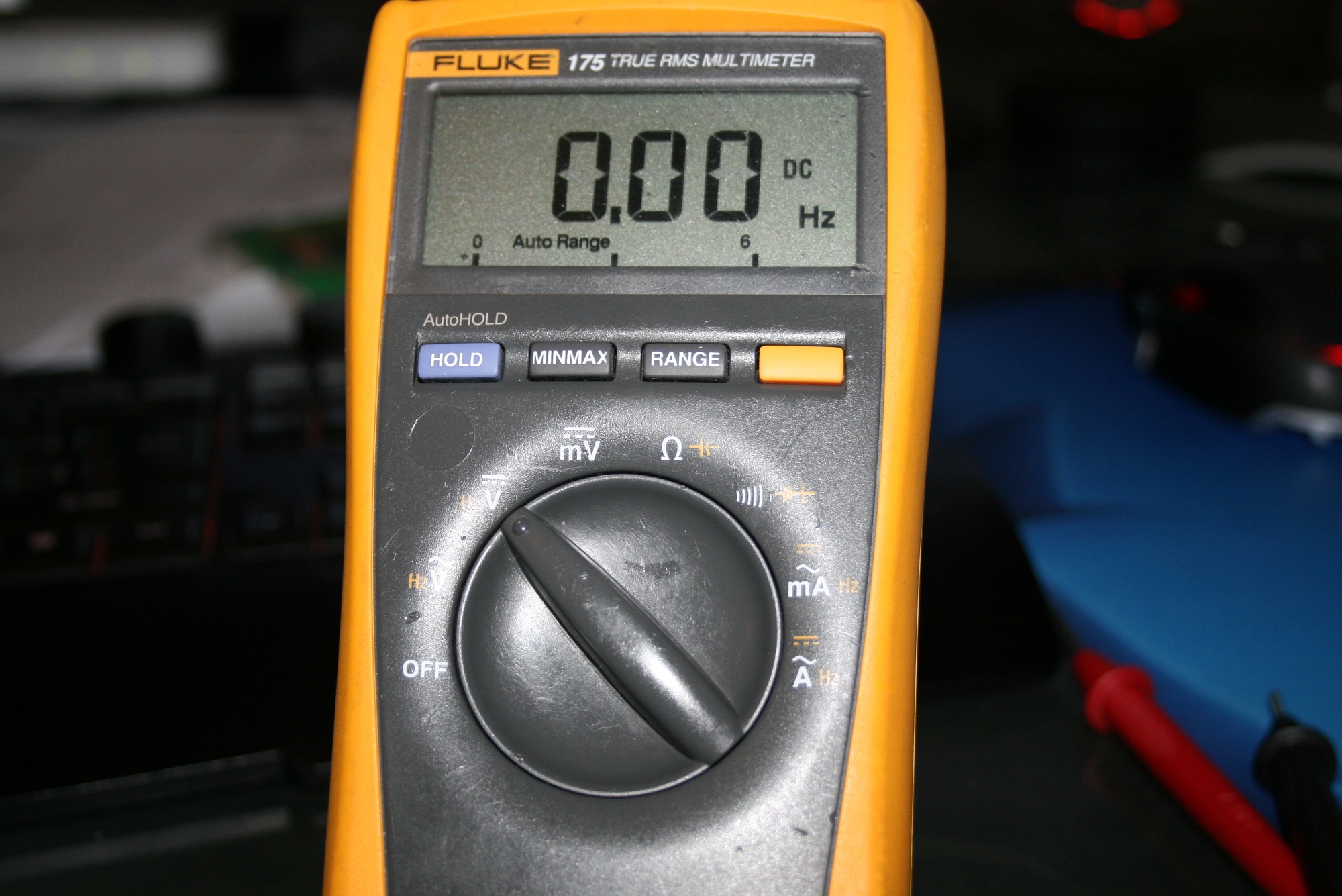

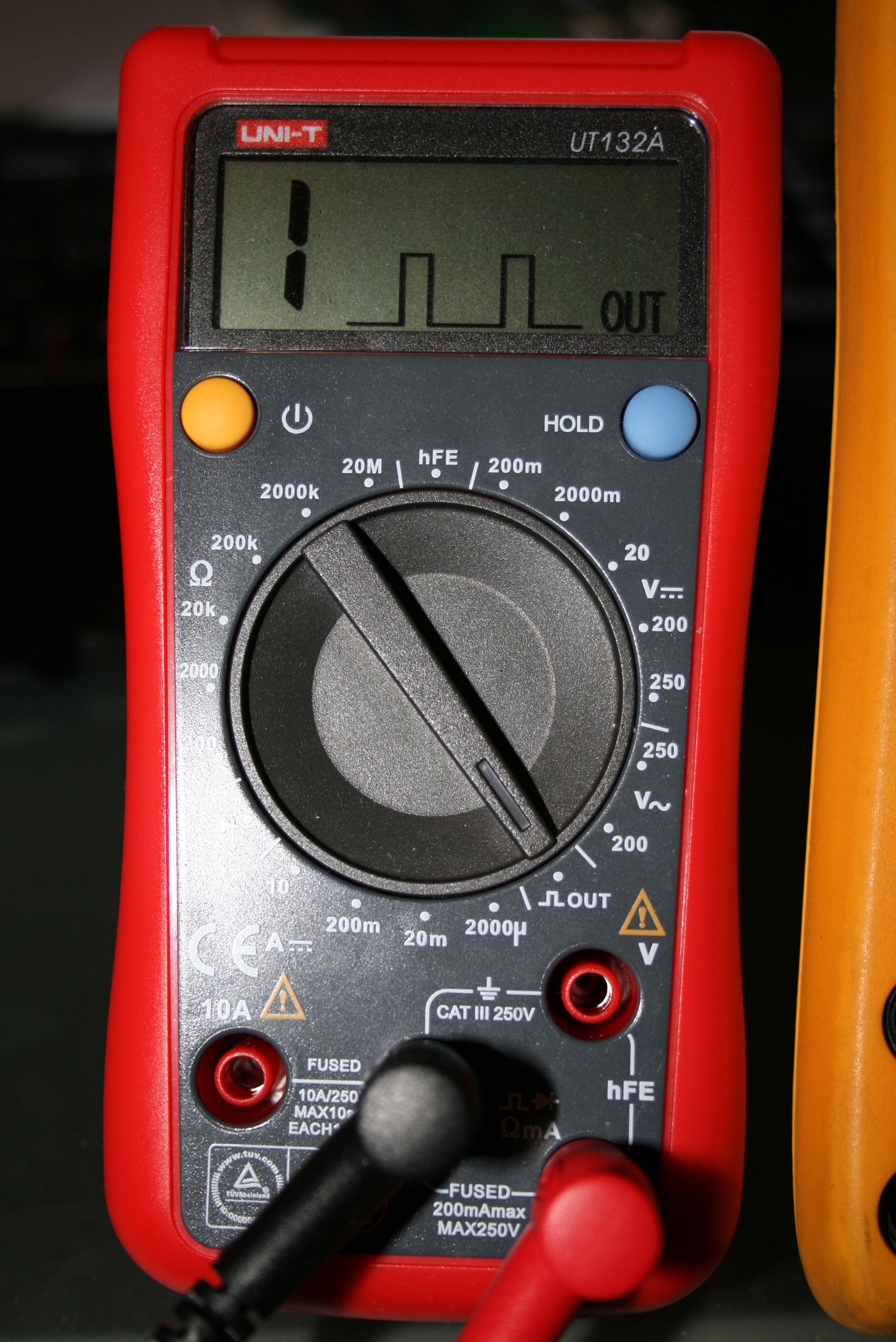

That is too low, that why I keep my 87 for poor man scope (I do have 4 scopes).Never stop learning
http://www.badcaps.net/forum/showthread.php?t=24809Comment
Re: Barco LCN-42 No Power
You meter AC frequency bandwidth is too lo for it to measure any AC in the 30~50KHz range.Never stop learning

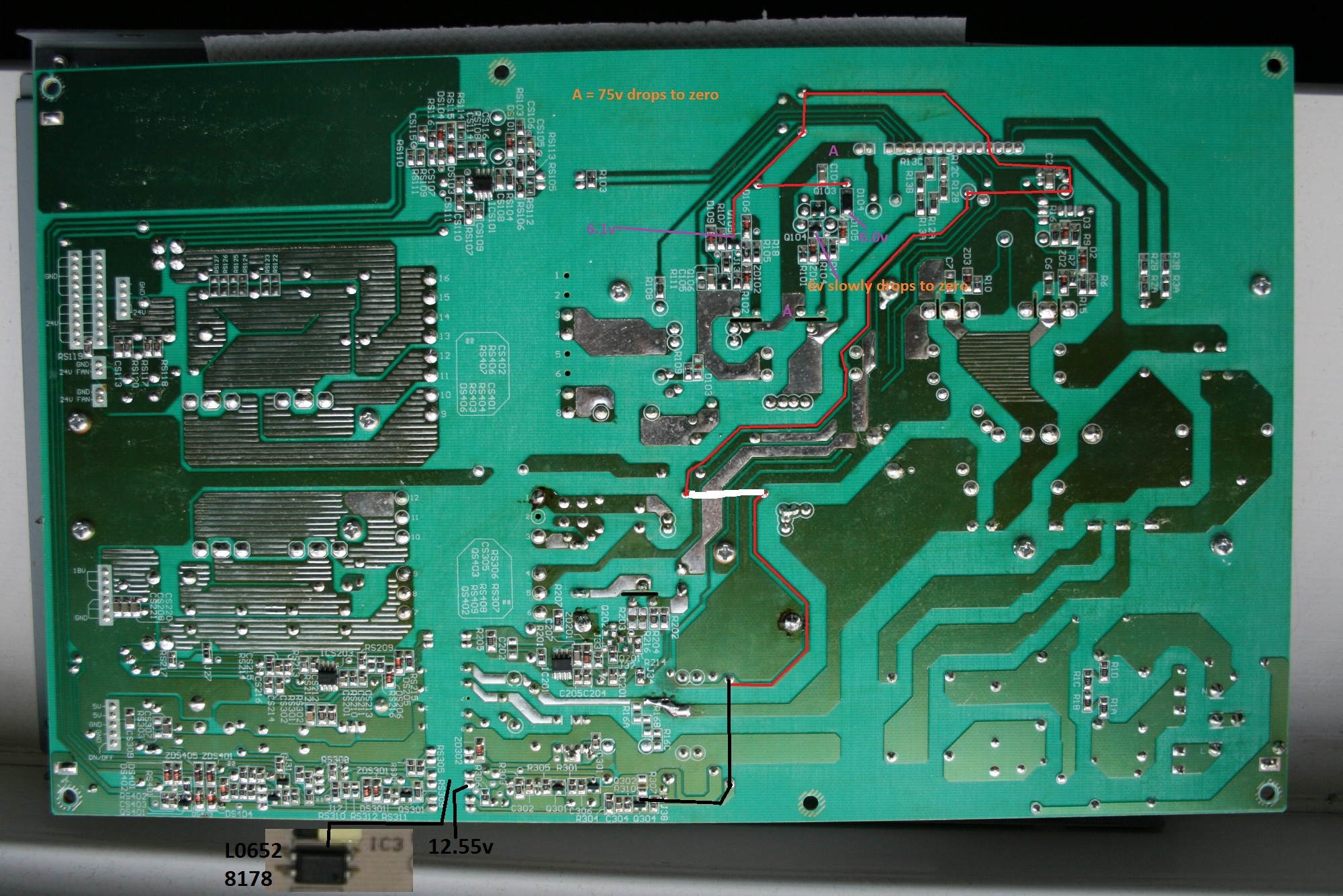

Just done a little more testing to try and work out whats going on.
It seems when I turn it on some power is supplied to the mosfet that I have marked with the letter A. This starts off at 75v or so but then quickly drops down to nothing. The same happened to the transistor which I think might be driving it? That transistor starts off at just short of 6v but then slowly drops down under 1 vault.Comment

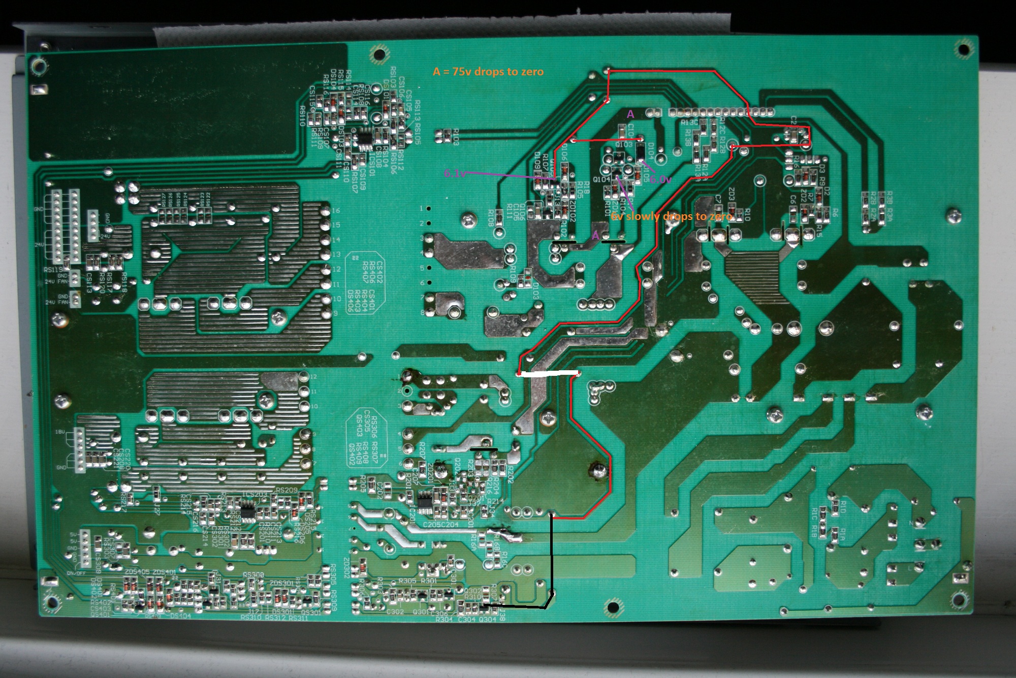

I would like to try this to see if the 18v power supply section is loading down the 13VCC LINE, there is jumper wire in the middle of the picture shown with red line, lift one end up and see if the 13vdc comes back.Never stop learning
I have disconnected the left hand side of the jumper and now I have 0v on the left hand track that goes back to the sub board but 6.2v on the right hand side that leads back to the replaced chip?
Maybe the vcc comes from somewhere else and that feeds back up to the sub board?Comment

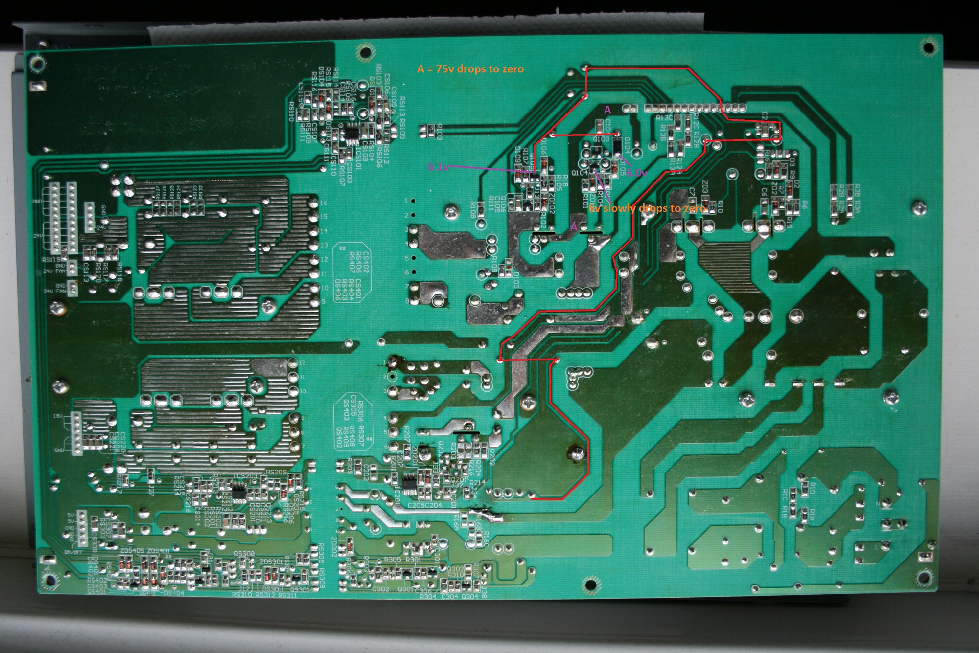

I have attached a pic to show the jumper that I removed and the black line shows where the vcc is coming from im getting about 8v over the black line.
If you can see C304 at the bottom there is 12v there so it seems that this is where the 13v should be coming from.Last edited by Jasgriff; 04-12-2012, 07:31 PM.Comment
Boy that is strange, you may be right that the VCC is coming from somewhere else. It is usually generated by the winding of the always on power supply then it will be fed to switched transistor to be turn on when it receives the PS_ON signal.
Right now we know that the 18v, 24v are not working so it can not be generated by those two transformer. You may have to trace the line, it should end at the Cathode of the Diode and DC filter cap some where.Never stop learning
Right trying to trace back where this 13v should be coming from. I cannot work out from the number what IC3 is or what it does. There doesn't seem to be any significant voltage going into it to give 12.55v out on the marked pin?
Does anybody know what it is so I can continue to trace?Comment
Right,
I found out what it was!
The new IC that I replaced became shorted on the DRV pin and the VCC pin one I disconnected that part of the circuit I get 14 volts back and then the 24v line was up and running!
I have now replaced the IC but left out the mosfet so I am going to test the IC to see what voltages I have going across it then I might throw in another mosfet to see how we get on.
P.s I have replaced the CS resistor that was previously blown. I am thinking that did not help with the operation of the IC and I am really hoping that by replacing that the IC will do its job and drive the mosfet.Comment
