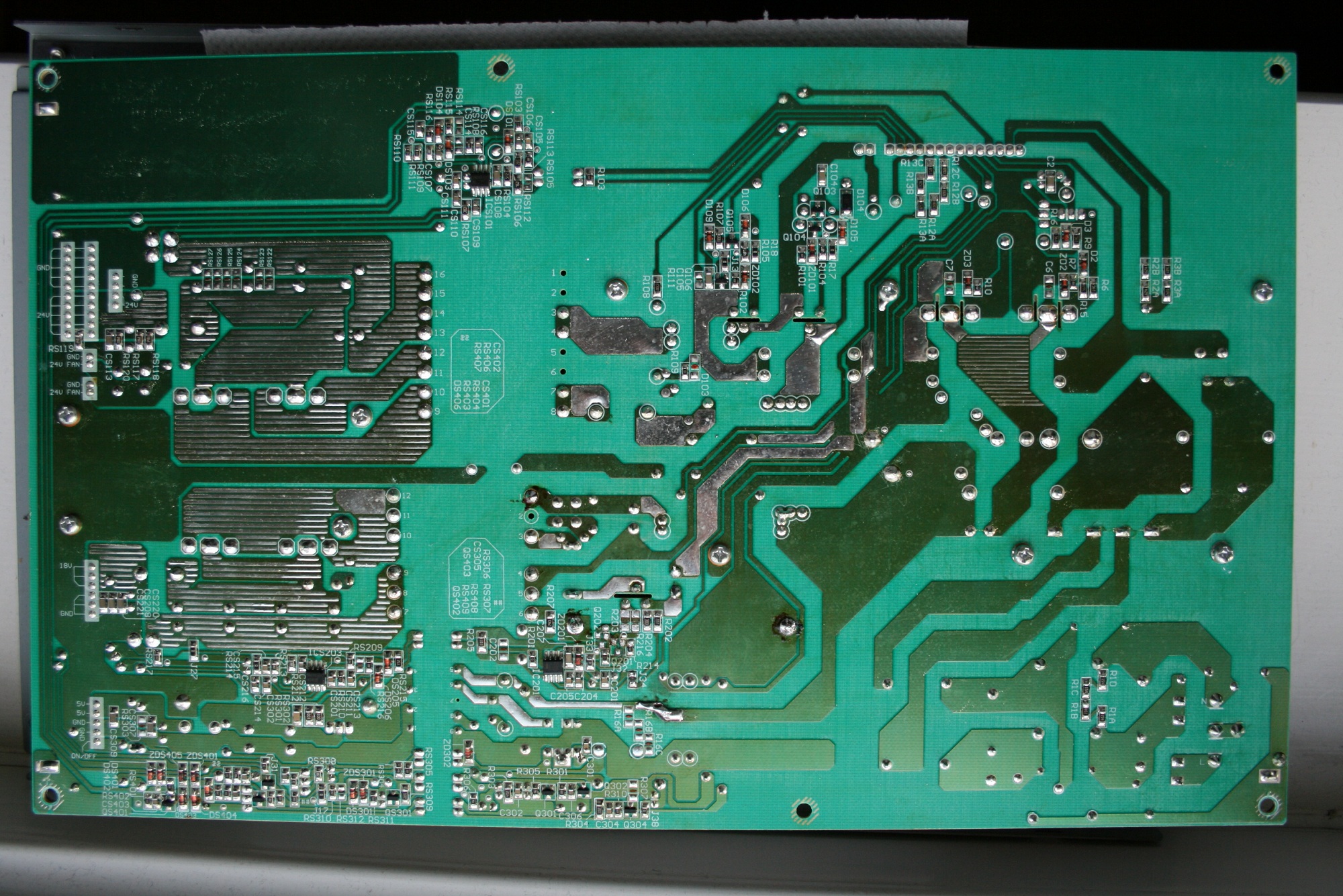

    I have found some PNP transistors with 100 Vceo but i'm struggling to find a 100ma one?
    Farnell.co.uk
    Would one of these do? Looking at your diagram I will need 1 NPN and 1 PNP.

        The NPN Q201 check OK right? What is the current rating? Higher rating is OK.
          Ahh i was worried that the rating was the draw? but its just the maximum that it can with stand.
          Both Transistors are broken.
          How about these 2?
          http://www.diodes.com/zetex/_pdfs/3.0/pdf/FMMT593.pdf
          http://www.farnell.com/datasheets/302332.pdf

            They will be fine, just make sure to not mix up the PNP, NPN when you install them.

                  Originally posted by Jasgriff
                  Quick update on where I am at with this one.
                  Ordered some 1 Watt 0.22 OHM metal film resistors and 3 Watt 0.22 OHM wire wound resistors. 1 to replace the blown and the others for spares.
                  Ordered a batch of T8AH fuses in case the board blows another.
                  Ordered the replacement Power Mosfet 11N80C3
                  Ordered some 33k SMD resistors to replace the 2 blown ones that connect to the transistors.
                  Ordered a bottle of Isopropyl Alcohol for getting rid of the flux and gunk.
                  Quick update....
                  The 3 Watt resistors came before the 1 Watt ones so I fitted one of those.
                  The power Mosfet has arrived and been fitted.
                  The Fuses have arrived
                  The Isopropyl Alcohol arrived and I gave the connections a good clean all around.
                  The transistors have been ordered today along with some caps to start replacing those too.
                  I'm going to go over those poor solder joints not to make sure that they dont cause any issue.

                    I still have a feeling that the SMPS IC may be damaged also due the fact that the resistors and the transistors are damaged also.
                      Will it cause any more damage if I try?

                        If the SMPS IC is not putting the pulses to switch the MOSFET on and off but stuck with steady High output, the MOSFET will be fully on, and that can damage the MOSFET and the transformer.
                          #72
                          Re: Barco LCN-42 No Power
                          It will also blow the fuse and could damage the PFC diode and bridge rectifier in rare circumstances.
                            So you would both change the IC rather than giving it a try?
                            I knew what your answers would have been so I have removed that IC also.
                            I did lift the pad on pin 7 this pin is not used luckily! It also looks like Pin 8 HV is not connected to anything, not sure if its an optional thing?
                            http://www.datasheetcatalog.org/data...swapill4cy.pdf
                            Ok had to order them from the US so I guess I will have to wait a few extra days to see if it fires up

                              Yes I would have replaced it than taking a chance of blowing up new parts and caused more damages.

                                  Crossing my fingers that I got the digram correct per what I could see from the pictures, long distant troubleshooting is not easy, that is why real good pictures come in to play.

                                    Well I have ordered 4 mosfets 3 chips 10 resistors and seven fuses so I have a few spares to try out.
                                    I can imagine its difficult working things out when its not in front of you.
                                    Here is another one of the board that I took to show you which parts provide which voltages.
