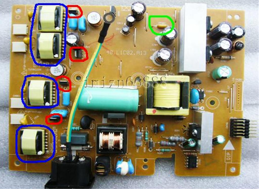

    My BenQ FP71G seems to work perfectly, that is,when not connected to PC, green light up and after a few moments turns to amber EXCEPT that the panel remains totally black. I can sometimes detect a very faint white ghost when the light goes from green to amber. When I connect the monitor to the PC, same behaviour; my PC log (I am using Linux) tells me that the PC recognizes the monitor and no video errors afterwards.
    I opened the back panel and I realized that I have the 48.L8302.A30 board. I disconnected the connectors, four of them, to the backlights and when I power on the monitor, my voltmeter gives me 0 V DC or AC on these connectors. So it seems that it is an inverter problem. Now, I inspected carefully the board, there is no sign of damaged components.
    What would I have check to point me to the real source of this problem.

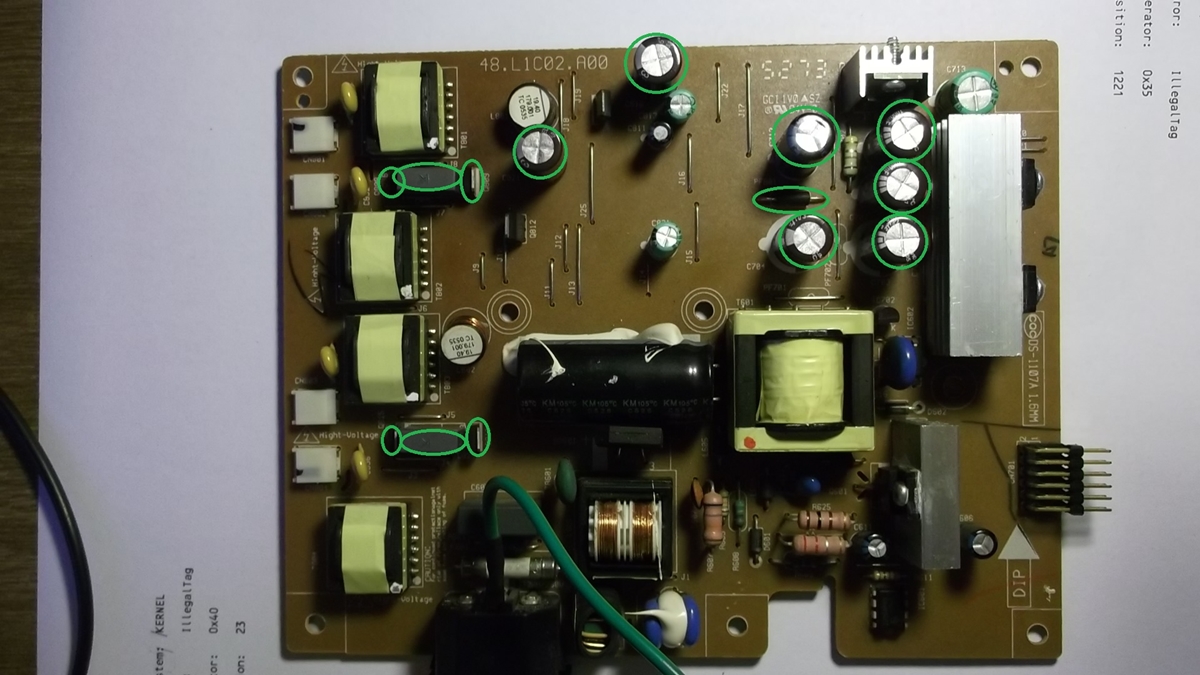

    Re: BenQ FP71G+ inverter problem (possibly).
    Transistors in RED check for shorts
    Transformers in BLUE resolder all legs on all 4
    Pico fuse in GREEN check and replace
    Then retry your board
    But you should upload picture of your board back and front so others can see it as there maybe something else wrong that can be spotted

      The "very faint white ghost" may indicate the inverter is starting up, then shutting down due to an error condition - possibly a broken wire to a CCFL. Or there could be other causes.
      Also, it is not recommended you try to measure the voltage out of the inverter. It can run well over 1000 volts at about 40 Khz. While the current is low enough it probably won't kill you, the DMM may not be so lucky.

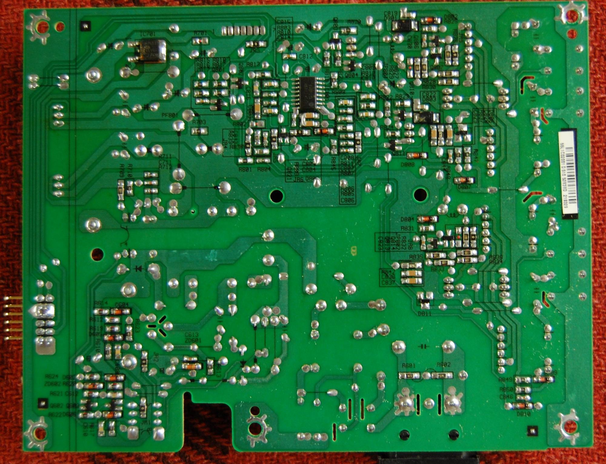

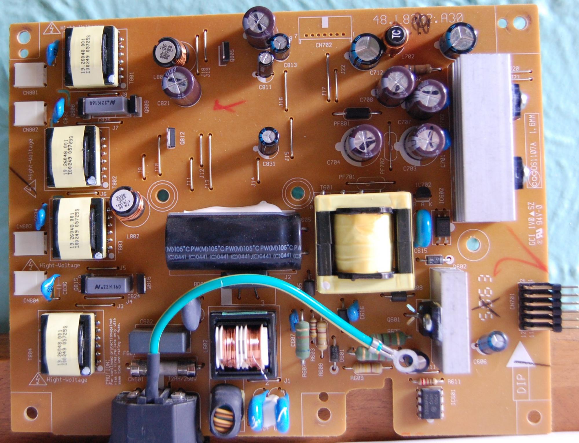

        Sorry, I am new on the site, forgive me. I uploaded the two pics of the board.
        This morning I checked again in a black room, and now for a very brief moment I see the BenQ logo when powering up the monitor. If I power down the monitor with the switch (LED green/amber), and at once power on, I cannot discern the logo. But if I wait some time (20 seconds and more), I see the logo again.
        To check for the transistors, do I have to desolder them from the board ? Some with the pico fuse ( I guess that it is the PF801 on my board.)

              sabre504 is absolutly correct, but i would just like to add if the fuse at pf801 is blown thats usually because one or both the fet's are shorted located at q805 & q812 they must be replaced as a pair even if one is ok as with the 2sc5707 transistors you must replace all four, you can get the full kit including the fuse for about $6 USD (plus postage) on ebay, I live in Australia but have my parts sent from the U.S (cheaper) I can post a link to the kit on ebay if you want. Also this problem can sometimes be caused by secondary caps but only in about 10% of cases (they can also be purchased as a kit)
                The pf801 is indeed blown. I can't detect shorts for the Q805 and Q812. But both the Q808 and Q809 are shorted (between BE and CE); Q815 and Q816 seem to test good, that is no shorts.
                So sabre504 I think I would need your ebay link, if you don't mind.
                Helios

                        Just received the kit from coreweave; 7$ CND with free shipping. Replaced the transistors and the fuse, and all is just fine now!
                        Thanks a lot guys!

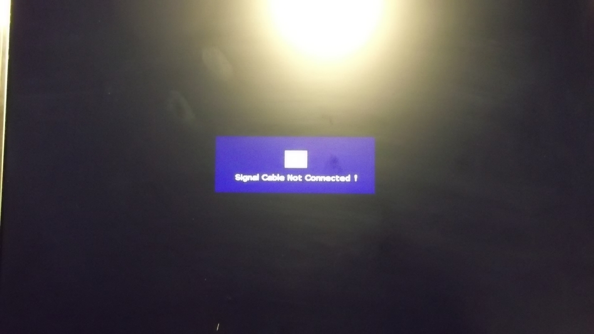

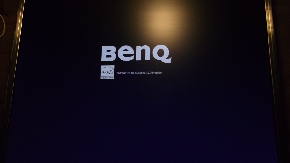

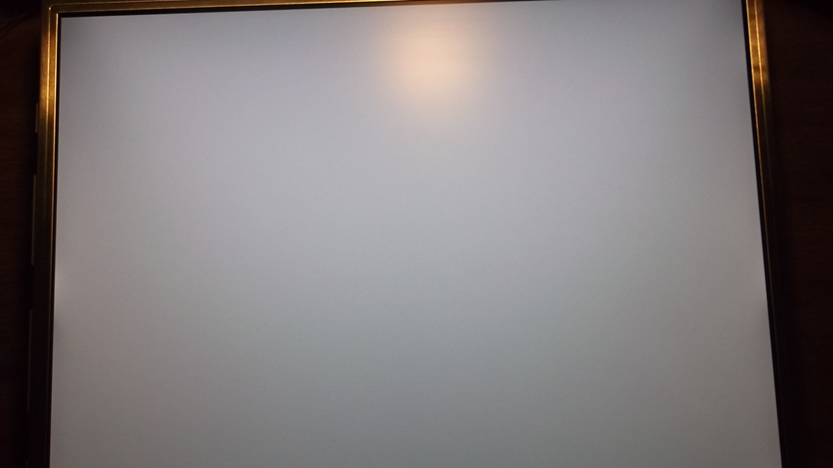

                          Hello everyone!
                          I'm new guy here.
                          I have a problem with this kind of model (Benq FP71G+)
                          My problem it was: the green led (button ON/OFF) it was ON but the image nothing.
                          Ok, I open it and I saw 4 swollen capacitors and 2 transistors C5707 are shorted.
                          I changed:
                          4 Transistors C5707
                          2 Capacitors 0.22nF/120V
                          all electrolytic capacitors from the board
                          and the fuse 3A
                          My problem is:
                          when i plug the cable supply, my display remain white, after that when I push the power button i see the logo benq and check the signal....
                          what i must check for the first stage (with the white display)
                          I hope to give me some advice.
                          Thanks!
                                There are 2 other transistors which physically look the same as the 5707's, they are probably FUs ??,the one associated with the failed 5707's you replaced, has probably gone short cct as well.
                                  Basically your inverter does not turn off anymore hence the white screen when you plug it in. I know someone with the exact same problem. You'll have to trace the power on signal going to the inverter. Do you have the service manual?
                                  A working TV? How boring!
                                    He has implied that after the white screen,pressing on button brings normal operation... so will probably be the mostfet indicated, it is a common fault occuring quite regularly when eiher pair of 5705s has to be changed.
                                      There are two MOSFET's that supply the variable DC (depends on the brightness) to the Royer Oscillator output circuits, I can see one of them as Q812, another one I can not see (it is on the top center of the board), they are driven by the PWM IC. check those two MOSFET's to see if they are shorted which will cause the Output drive circuits to be on all the time.
                                        Are you sure the ribbon cable is well connected? I mean, are you sure that's the way and it's not connected the other way about it?
