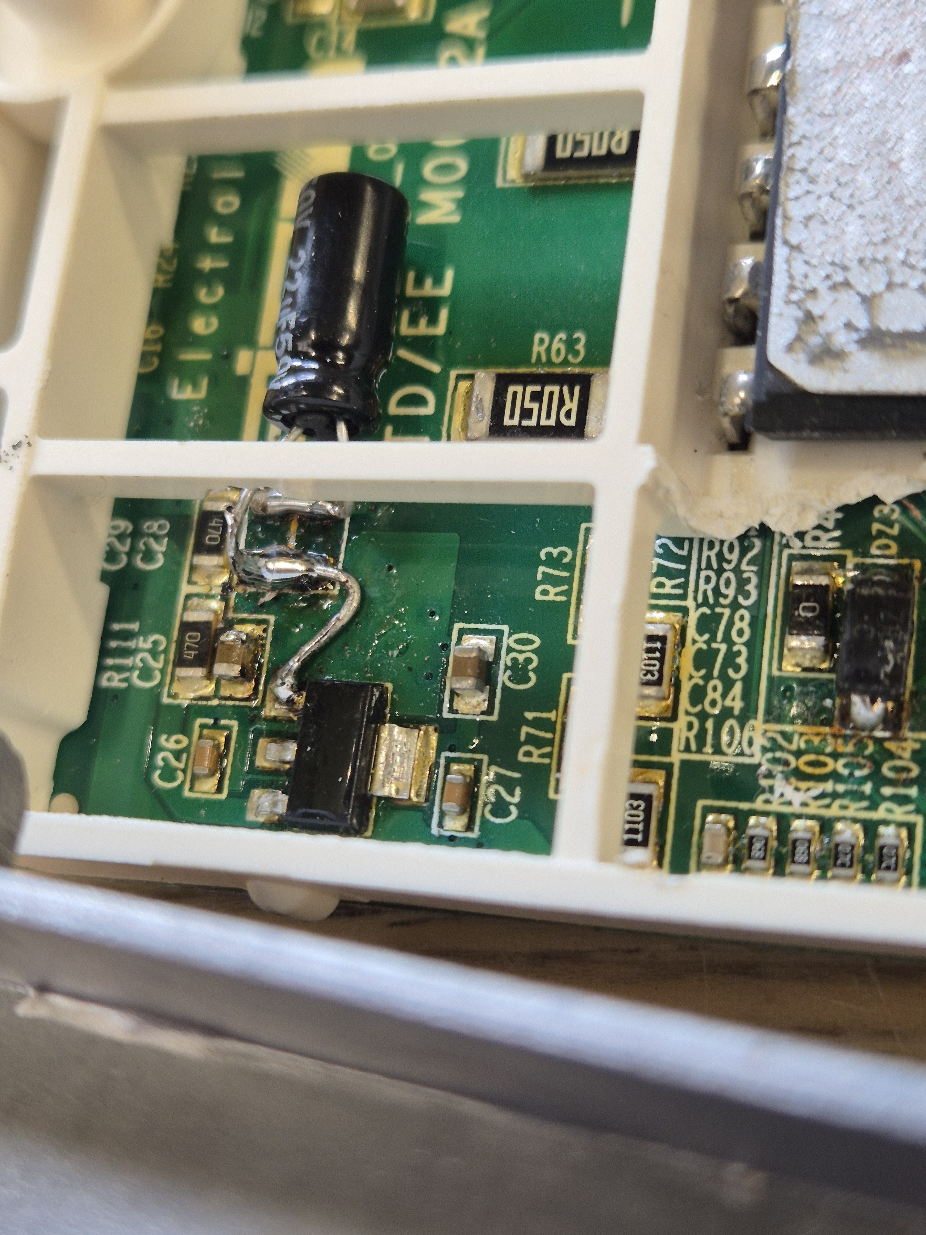

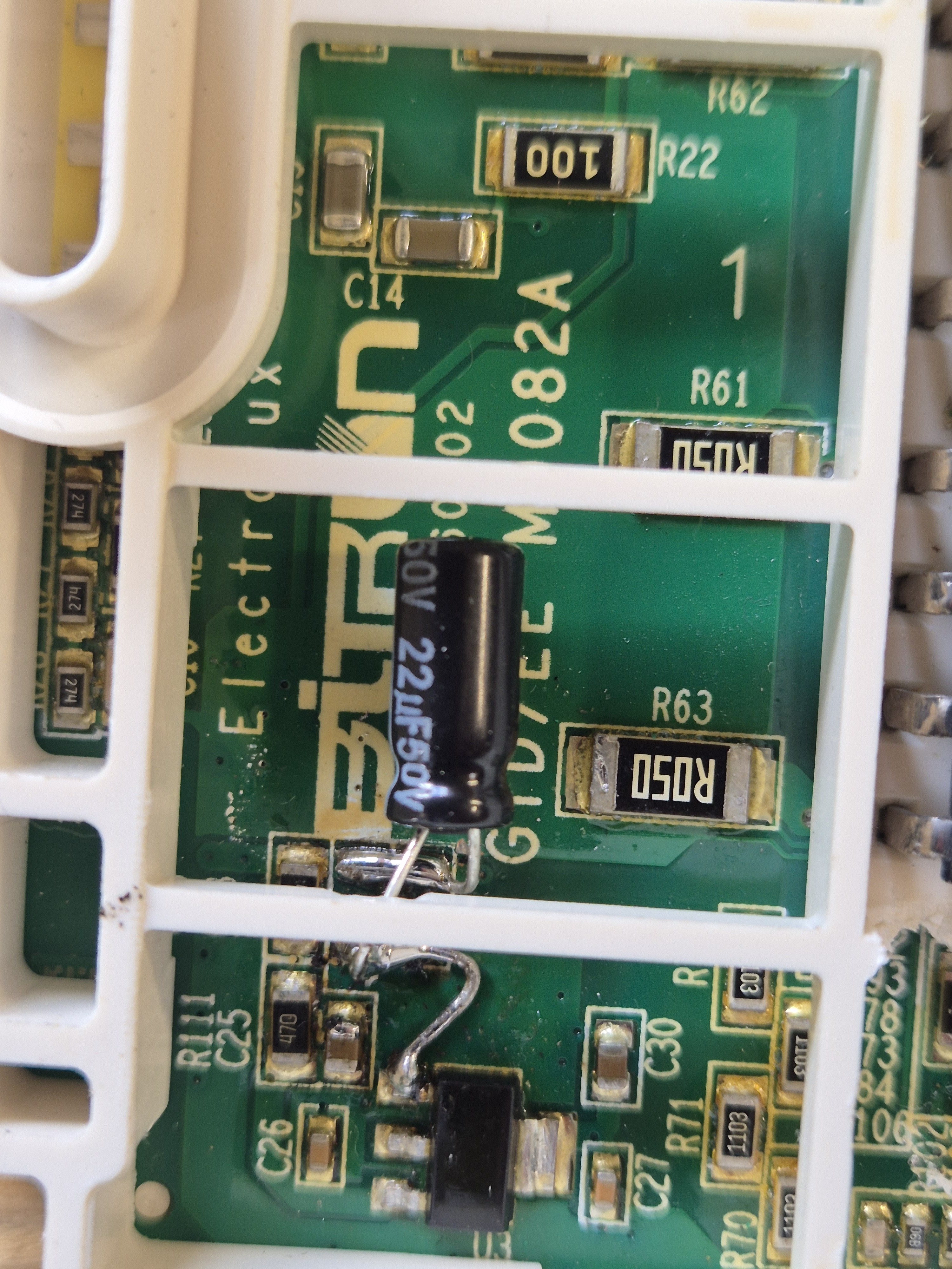

                          Just thought to add to this as I had a similar problem. I also had a short in the board somewhere. Mine was a short at C29. C28 when unsoldered was fine and tested at 10uf. I replaced both with a 22uf 50V 105 degree Panasonic cap as I didn't have any ceramic caps on hand. I had a different inverter chip. I also replaced the inverter chip -STGIPS10K60A.
                          All works well now.
                          This was on a Electrolux washer/dryer.
                          The inverter was a Bitron M0091C EMC14EV0.

                              Just to follow up on this again for anyone with this inverter. I did two loads with the machine and it failed again. It failed with what I thought was ESA, but was actually E5A, an over temp error of the inverter. I thought maybe the inverter IC I brought was rubbish so replaced it again. Same error. I've attached a pic giving resistor values near the IC. After testing, both R74 and R75 were stuffed. Both 1k resistors. Replacing them worked and the machine is up and running.
                              Hopefully this is of help to someone to keep these machines out of the dump.
