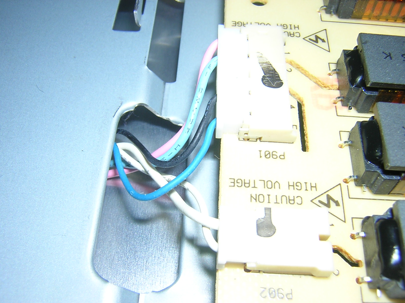

    Normally, I check the bulbs but this unit has an unusual connection scheme. I am hoping someone can tell me how to hook it up so i can test the bulbs.
    Bulbs are located at the top and bottom of the screen as usual.
    Bottom: Has two connectors. One connector has two wires (Both white) and one connector has 4 wires(dark-blue, black, light-blue, pink)
    Top: Has two connectors. One connector has two wires (Both white) and one connector has 4 wires(dark-blue, black, light-blue, pink)
    If i wanted to test the bulbs i need to know which wires go to the individual bulbs and i am not sure which wire goes where..........
    can someone help?

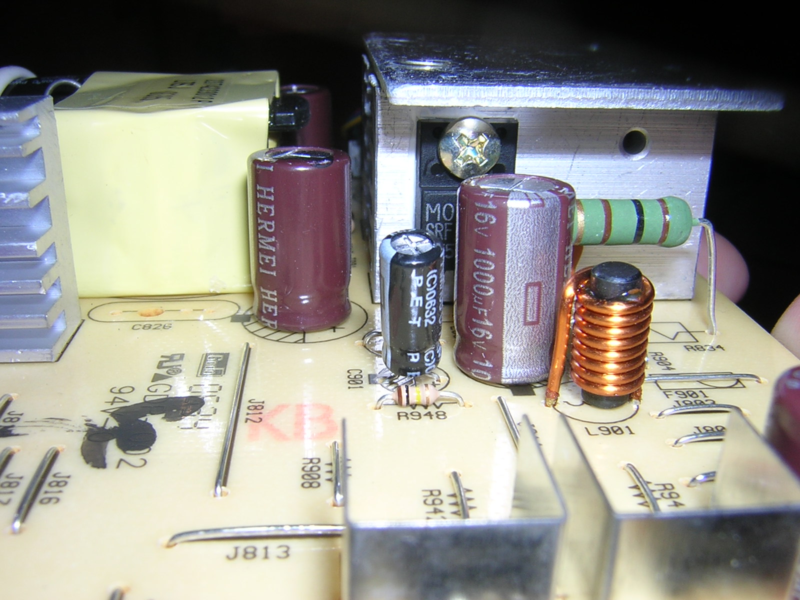

    Get rid of those Hermei and Elite caps I see there on the PCB and replace them with something suitable.

        Trace the outputs from the transformers. On the large connectors it looks like pins 1&2 drive one CCFL and 4&5 drive another. Of course, the small connector drives a third CCFL.

            Update:
            I was able to test all the lamps in the monitor and all seem to be working fine.
            One lamp is the white connector. Note: "Hot" wire is slightly larger in diameter.
            One lamp is using Pink and Black wires. Note: "Hot" wire is slightly larger in diameter.
            One lamp is using Light-blue and Dark-blue wires. Note: "Hot" wire is slightly larger in diameter.
            I tested ALL 6 lamps and ALL seemed to be working fine.

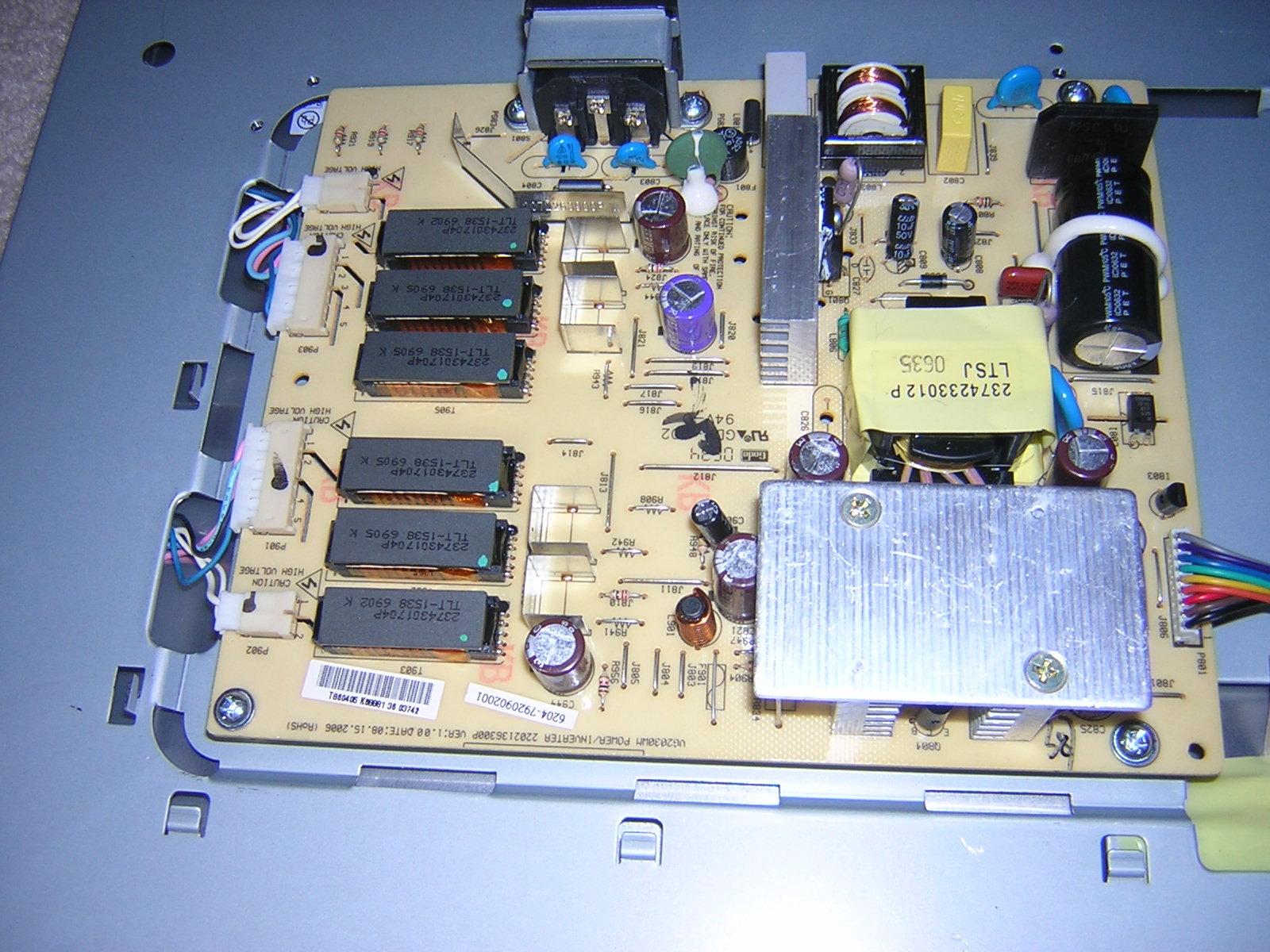

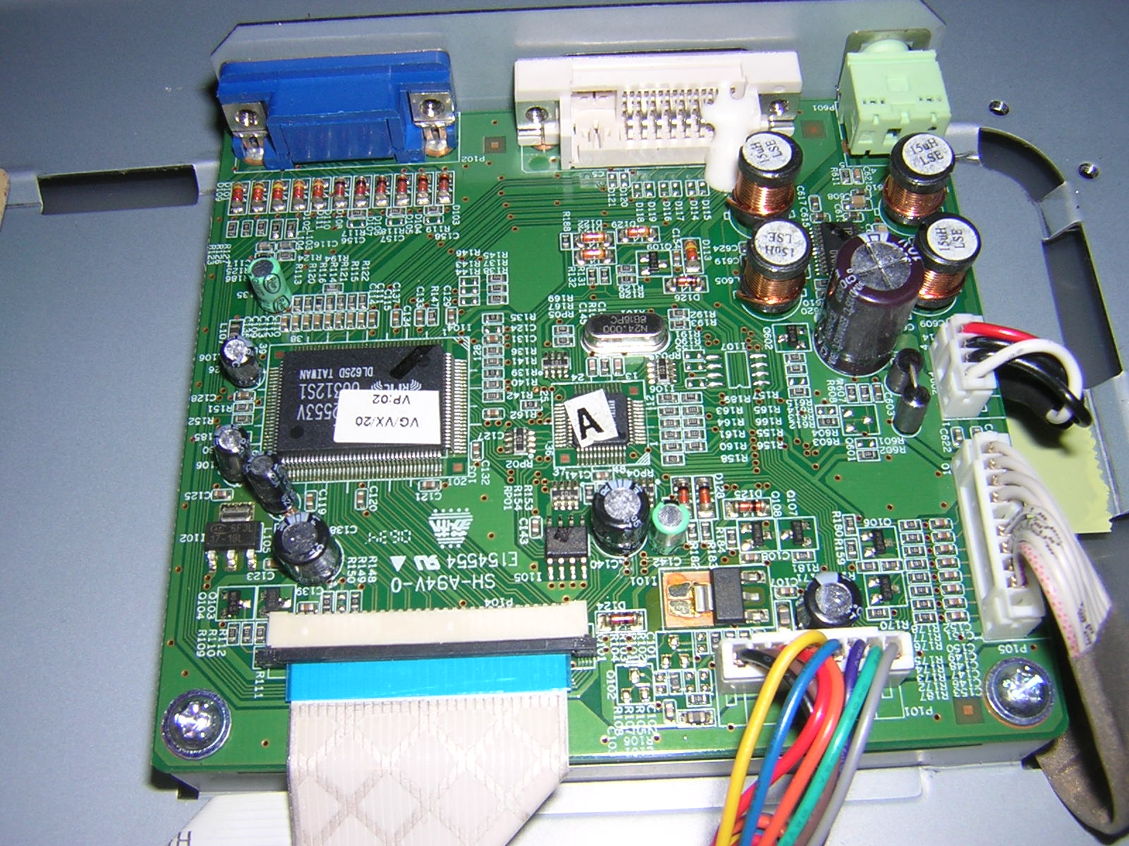

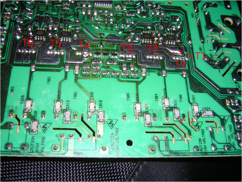

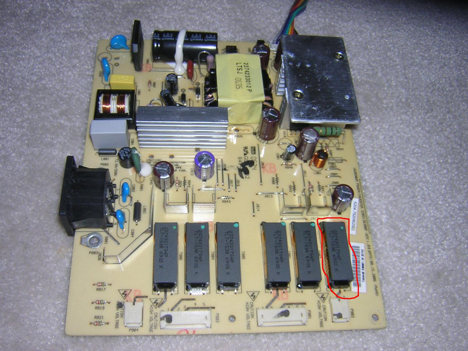

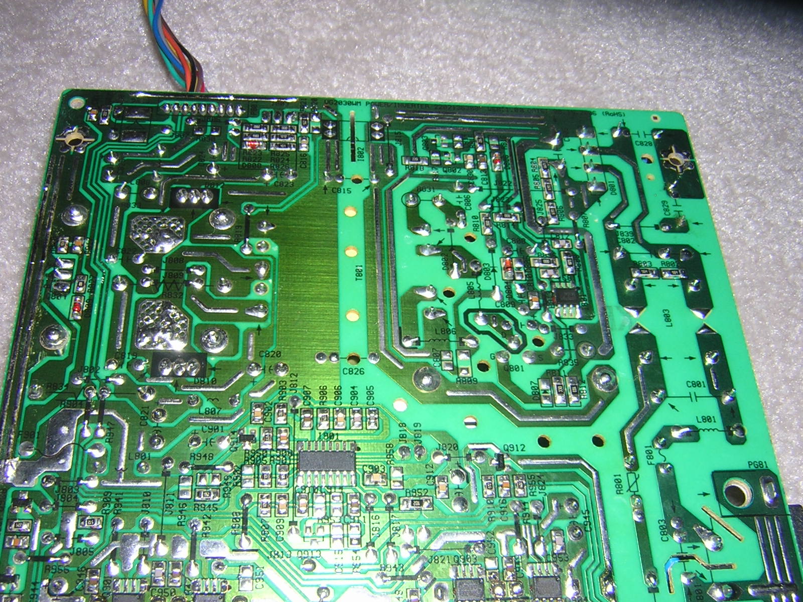

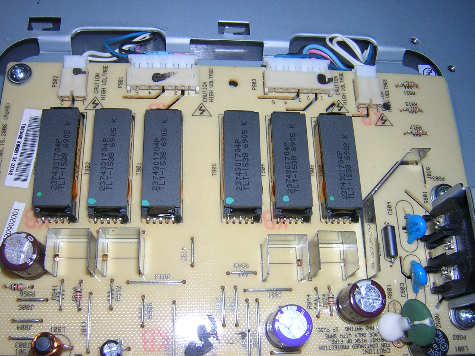

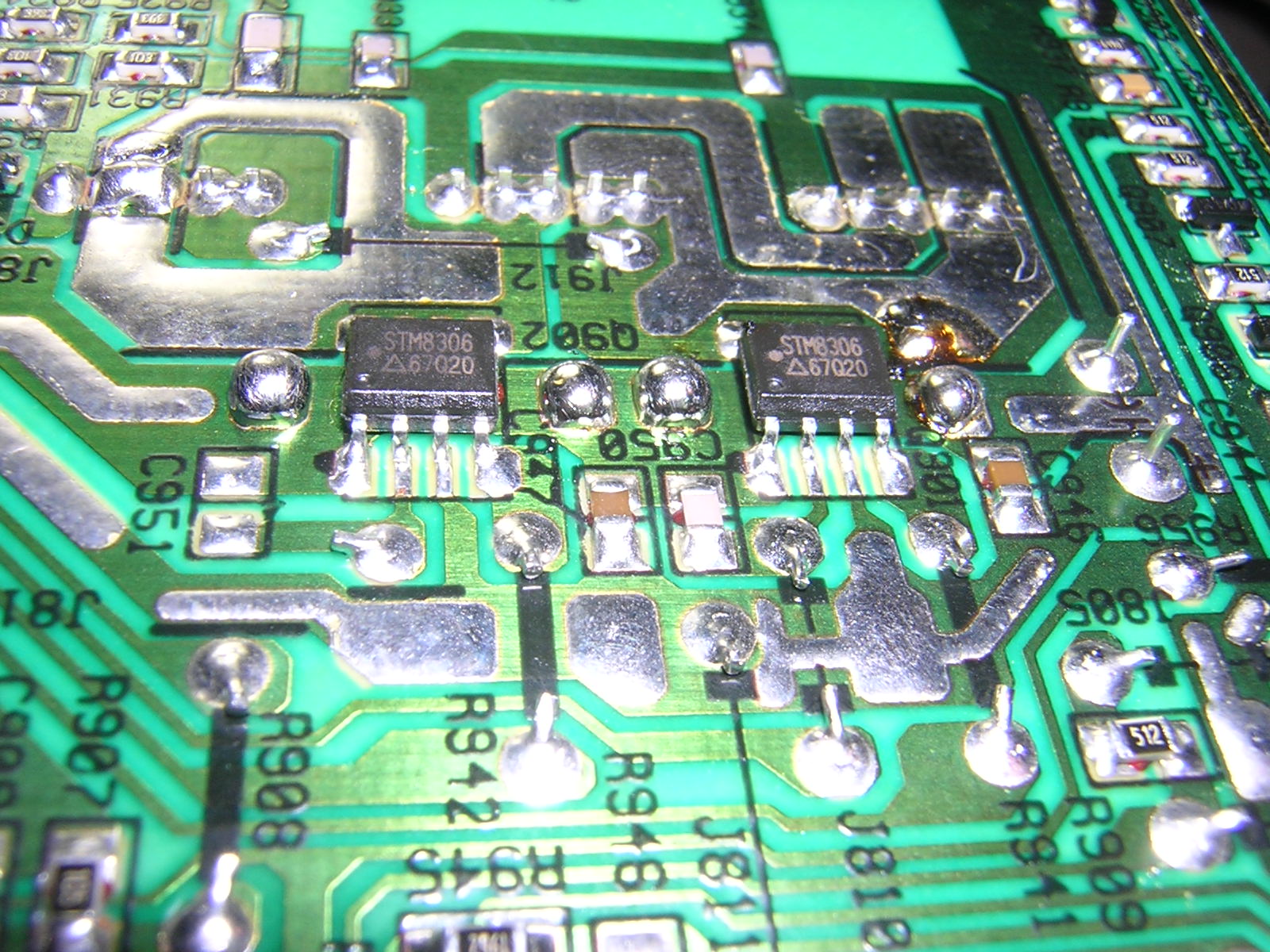

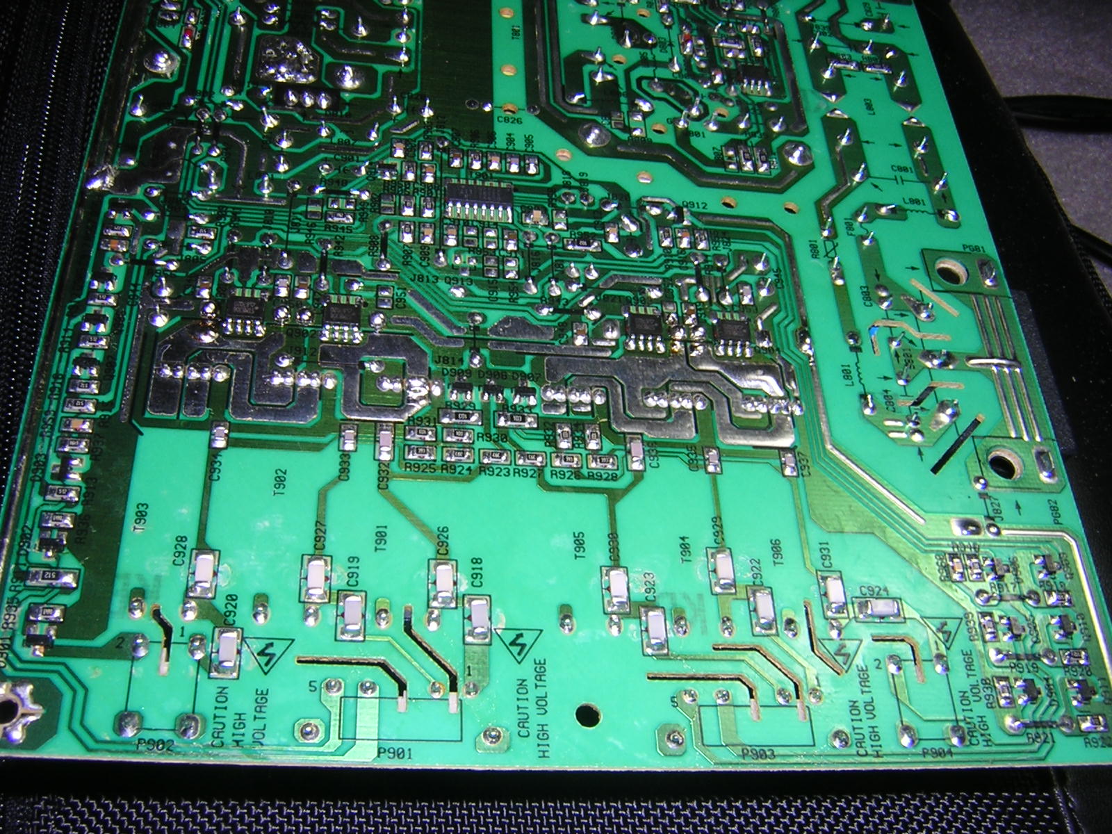

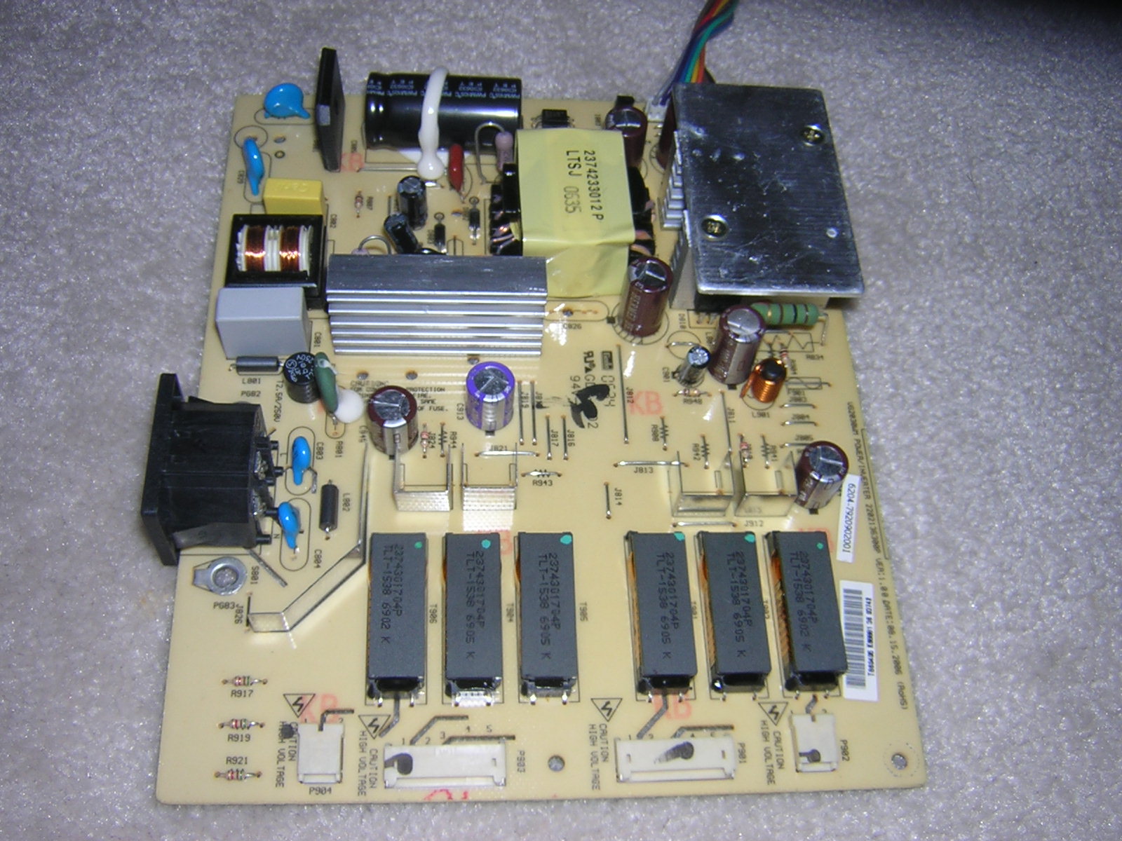

                ok, so i have not had a lot of time to work on this but i found a little time this morning.

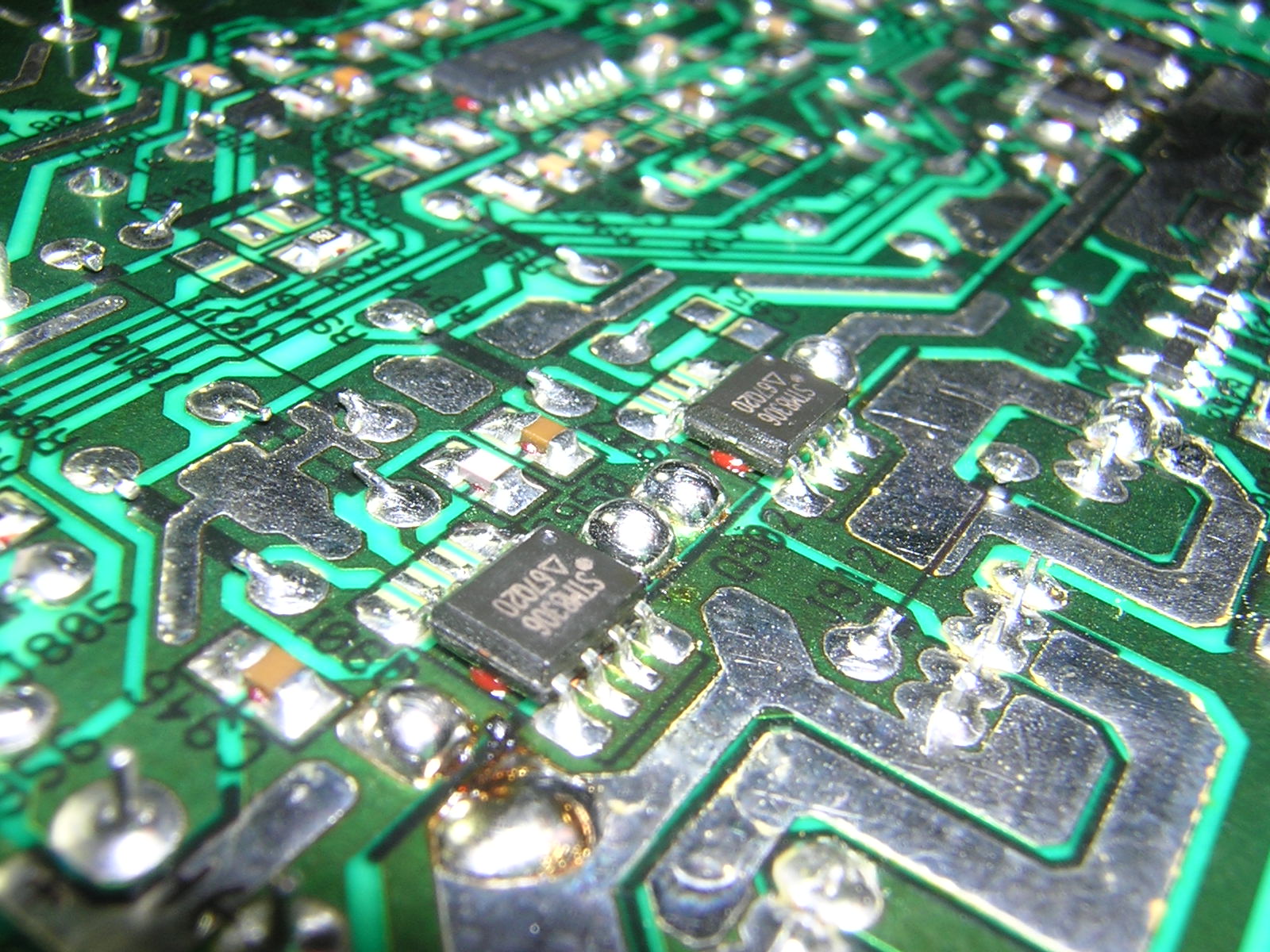

                I checked the transformers and the chips (see enclosed photos). I did not see anything "unusual". I know that does not mean they are good........i need to report the actual measured values and i will....once i remeasure again and record data.

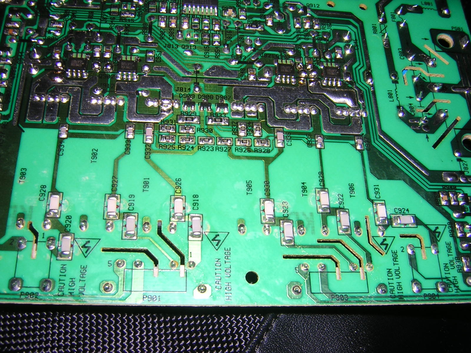

                I am enclosing pics of the back of the board in the inverter area.....which is where i think the problem might be............or could be the caps.........have not checked those with a cap meter yet since i have to borrow one from a friend.
                I wanted to get you guys opinion on what i should check next and how.

                    Re: Viewsonic VX2035WM Turns on for a few seconds then goes black
                    I finally got around to posting the measurements on the transformers. They ALL measured the same so either they are ALL bad or ALL good........i think.
                    See enclosed pic to see pin identifications.
                    For all transformers (T1 - T6):

                    • sabre504
                      • May 2010
                      • 449
                      • United Kingdom
                      Transformers seem ok (couldnt see your pic)
                      Caps would be the next thing
                      • sabre504
                        • May 2010
                        • 449
                        • United Kingdom

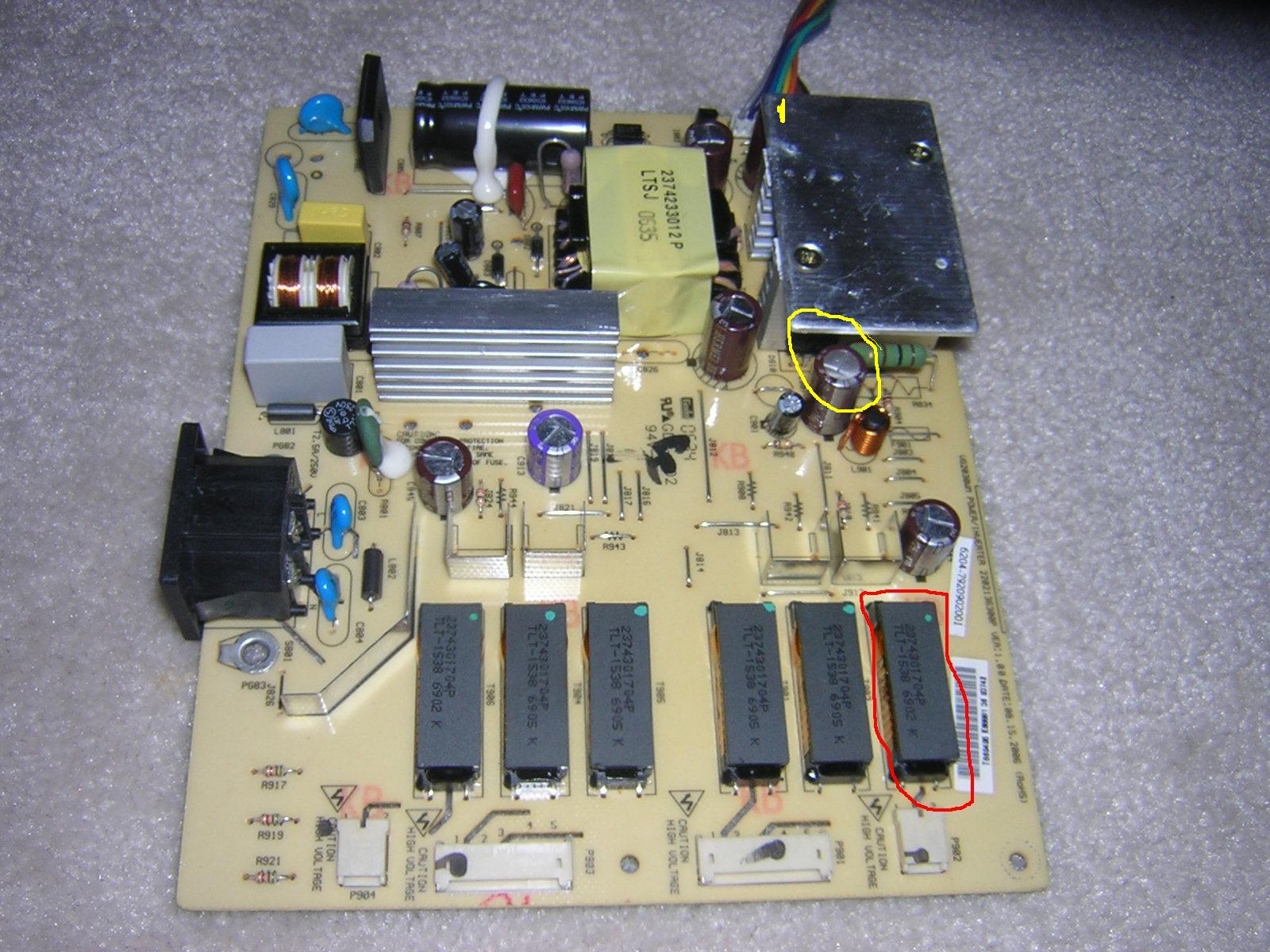

                        Could be the angle or trick of the light but the cap i have ringed seems slighty bulged .
                        Are there any under the heatsink plate ?

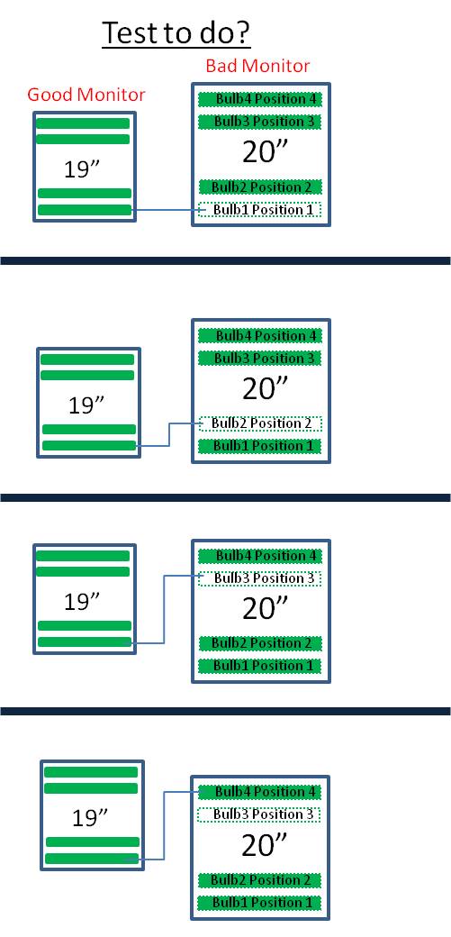

                          Welchs, I don’t know where you are with your monitor, but it sounds like 2 sec to black.
                          I think I would also replace the capacitors to take one more thing out of the equation. Also
                          If you haven’t done this, try it.
                          Find a good CCFL from a 17” monitor, Hook up all but ONE of the CCFLs from your monitor.
                          Place the 17” in the remaining connector, power on the monitor dose the test bulb light or do the CCFLs stay on?
                          Repeat this on all of the other CCFL connectors.
                          This is going to try to identify a particular circuit that may not be working

                            i have not tried any of the suggestion yet........i just realized i did not put the picture in my post this morning. so i am posting it now.
                            • Welchs101
                              • Sep 2008
                              • 979
                              i am posting a mag pic of the cap sabre504 thought was bulging. I think it was just the bad lighting. I am enclosing another pic........looks ok to me.

                              • alexanna
                                • Mar 2010
                                • 1346
                                Don't you have an LCD with a damaged or broken screen? You do enough monitors, they will come in really helpful in the future, Just remove the bulbs

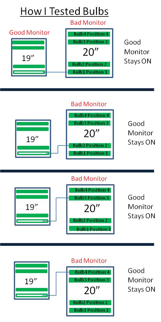

                                    In trying to hook up external bulb to monitor i am tyring to fix:
                                    1) Recall that for this monitor there are 4 connectors. Two of the connectors look like what i would call the "two" wire standard connection. The other two are more "non-standard". For the standard two wire connections i can plug my other bulb into the non-working monitor. However, for the "non-standard" connector..........not sure how to handle these.
                                      If you look at the end of the CCFL conector, where it plugs in to the inverter you will notice a square slot and on the top of it is a rectangular slot.
                                      Push the lead of a small capacitor into the rectangular slot, this will release a tab on the metal connector and allow you to remove the wiring pigtail from the plastic connector. You can then install the wiring pig tail into the plastic connector your monitor is using. Just remember the orientation of the Hot and Return wires.
                                        Had a little time this morning. THought i would try the last suggestion about replacing bulbs. Then i started to think about what it was i was doing and well i am not sure why i am doing.
                                        I already tested the bulbs of the broken MOnitor. To see how i did this see enclosed picture. "Test already done"
                                        It is proposed that i switchout the bulbs one at a time from the bad monitor to a good bulb/monitor. From what i read, i included a pic of what this test is to do as well. See enclosed pic "Test to do".
                                        What i dont understand is what I will learn from this new test. Seems like i am just testing the "bulb". If this is the case then didnt i already do this.
                                        Just trying to understand this "test to do" a little more because from what i know (which is obviously not much) it seems that i am testing the integrity of the bulbs in both cases.
