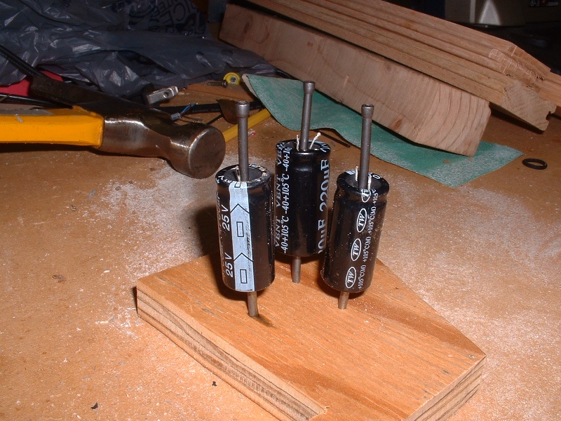

                Those bastard Hermeis really piss me off! They depend on the 'bean counters' doing parts spec'ing going "ooh- it's got the T-vent, it must be a good cap."
                I got your solution right here... in fact, I've nailed the problem.
                Welchs, don't kid yourself by pretending that 'software fixes power supplies.' It's possible that the scan format was changed in that INF reinstall, reverting back to 'less demanding' settings. You then squeezed more time out of it before it acted up again.
