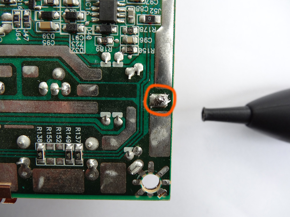

                          Re: Dell 3008wfp faulty power supply
                          Ok. I am trying to remove the heatsink by desoldering the two corners of the heatsink and the two diode´s attached to it.
                          The corner solder circled in red is larger that the desolder gun tip I have.
                          How did other members desolder these joins?

                            #213
                            Have you tried with de solder braid?
                            First add some of your leaded solder - will help.
                            Pre heat the whole area and the heatsink with a hairdrier or very very gently with a hot air gun.
                            If you dont have braid do you have any tv coax or audio coax - try and cut a strip of the braid sheath and coat it with flux -it should then mop up the solder.
                            I think you will need at least a 40watt iron.

                              #214
                              Thanks selldoor for the tip.
                              Would you recommend using braid to desolder the diode pins (see pic) also?
                              My gun does not seem to be all that great, either that or it is me.

                                #215
                                I have never owned a de solder gun so I have always used braid and when I have mislaid it, make my own as mentioned. So yes should be ok to use braid on diode pins again add a little of your lead solder
