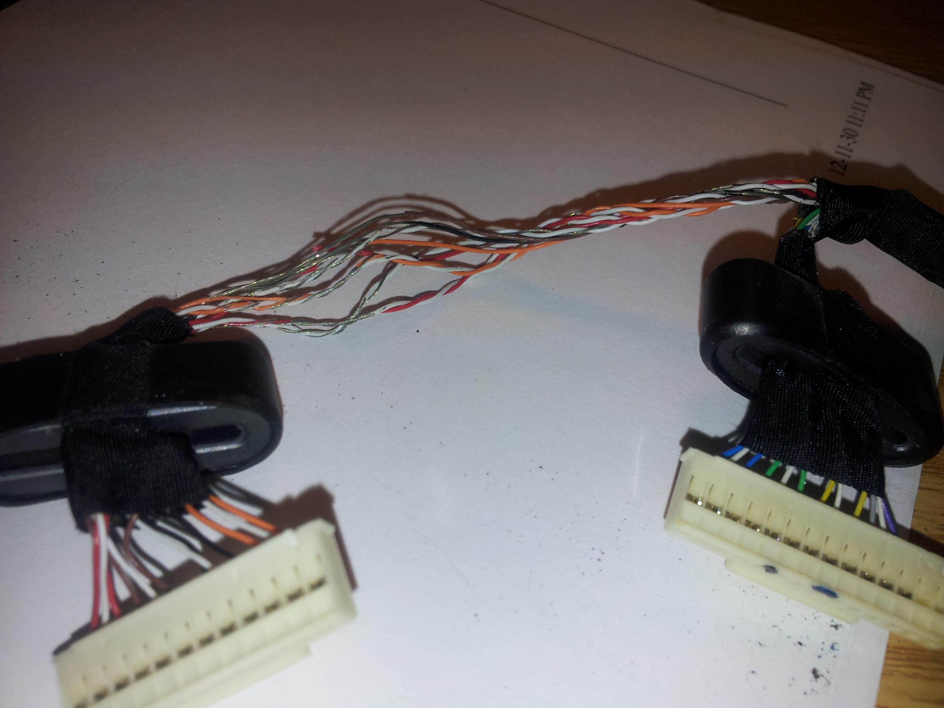

      Re: Dell 3008wfp faulty power supply
      Originally posted by selldoor
      Wow - that is really bad - not seen anything like that on here. Id guess heat and age these are known to run hot. I dont know if you can get replacements. If you try a repire might be easier to cut the wires near the pins and solder rather than trying to solder to the pins with a piece of heatshrink tube over the join, but it might all be just too bulky.

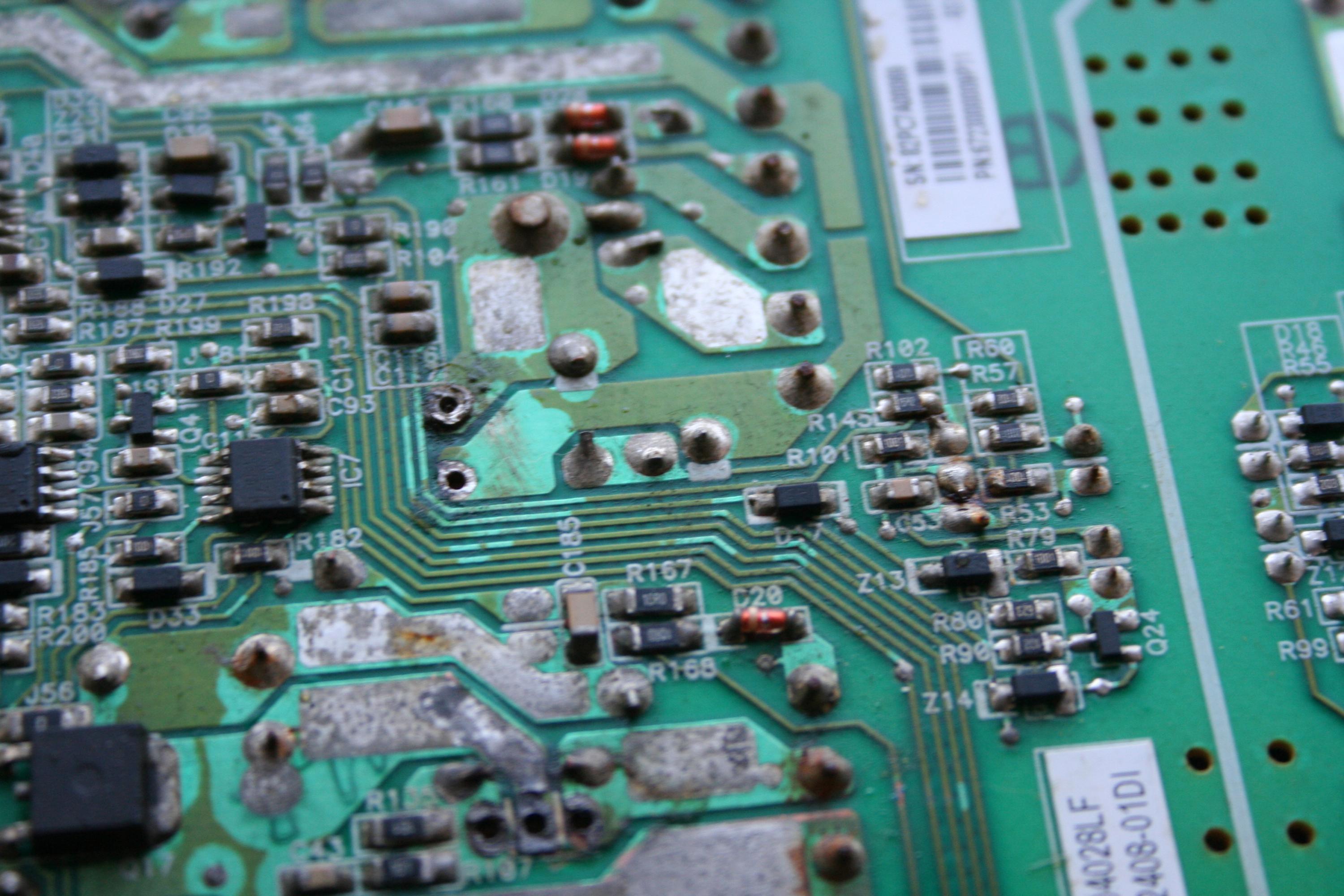

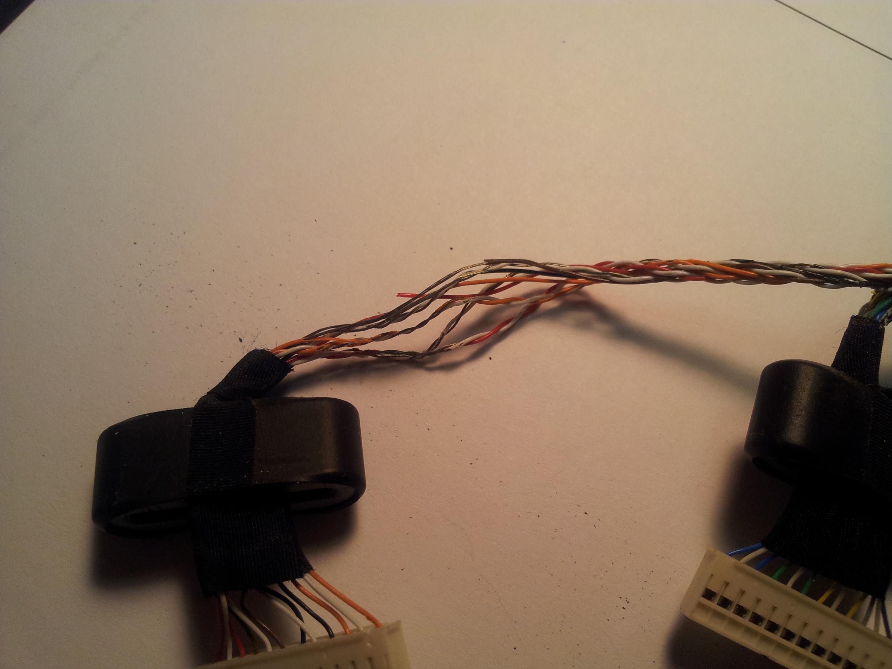

      Looks like fuse was damaged by these unisolated wires. I'll try to solder new wires like you suggested. Wish me good luck and wait for a news
        Yes - good luck with that- I would test each joint with a meter as you go before you cover it up rather than get to the end and not know where to start checking.

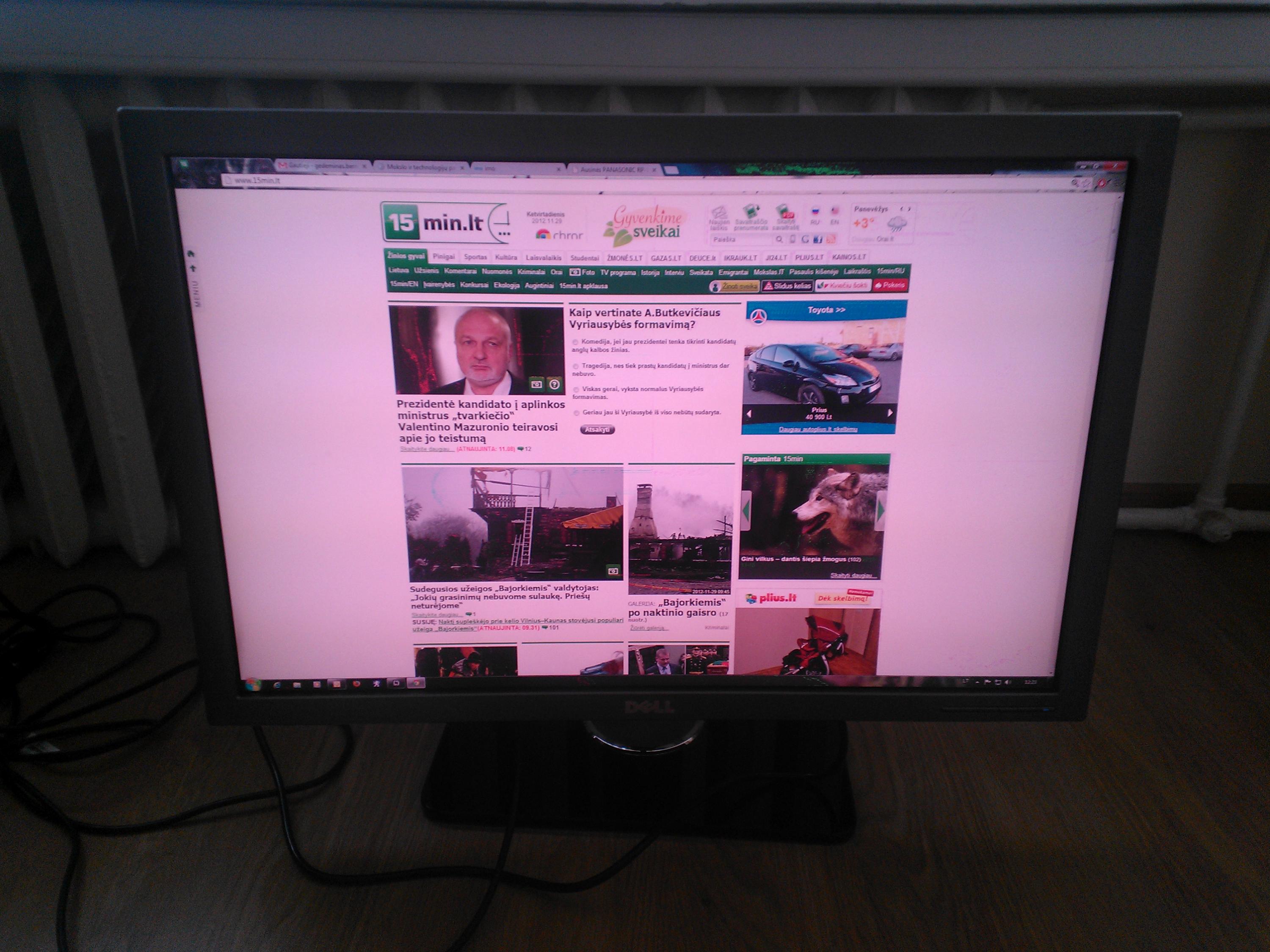

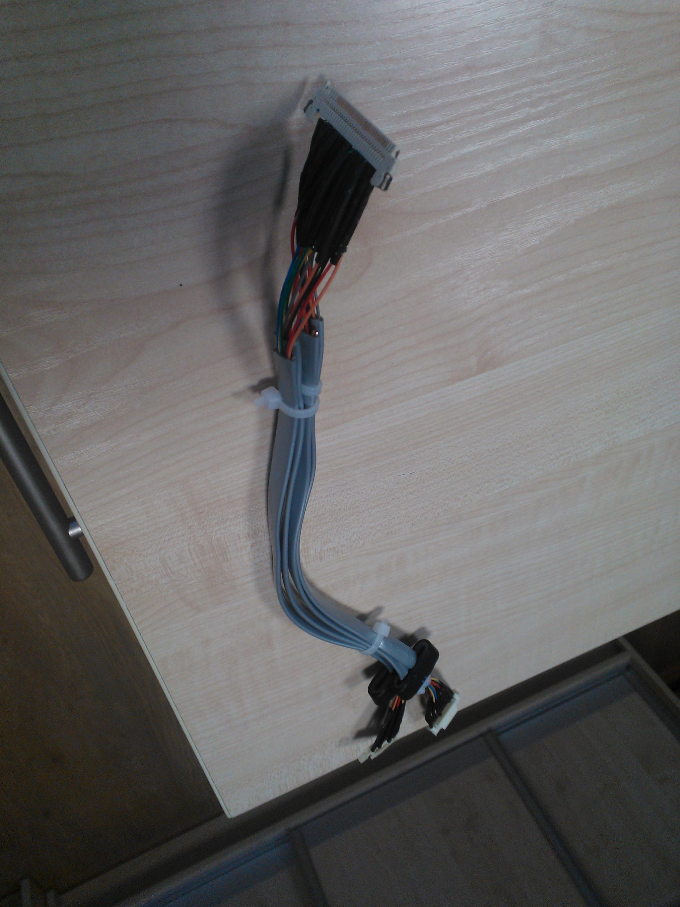

            Here I am again. So I soldered wires, did new cable. It took some hours to do this job. Also changed fuse and as the result the monitor comes back. However as you can see in the pictures there are some blinking points and lines sometimes more and sometimes less. I think it's because soldering causes some suppression. But now I know if I'll buy a new cable it will work fine. I found it on Ebay for about 30 pounds.
              That is very impressive - well done - I hope a new cable makes it as new.
              Perhaps wait a while to see if anyone has any other ideas before buying.
              Have you cleaned the flat plug carefully and make sure it did not just move during re assembly

                        WOW! I have the same issue!
                        Hey guys,
                        BTW, I was able to fix 2 supplies and got one monitor working...YOU GUYS ROCK!
                        HOWEVER, in trying to troubleshoot the monitor that won't work, I did test the panel, and swapped out the supply, but it didn't work. Long story short, I isolated the issue to the logic board, but I noticed something disturbing.
                        On the non-working monitor, I saw EXACTLY what kazkasneaiskaus was referring to, as all of the cabling was melted to the BARE wires!
                        On the working one, it looked fine, but was also getting to the point of melting, as I can see that the cables sheathing was crumbling literally in my fingers.
                        And I will attribute it to HEAT, as there is a heatsink literally inches away from that cabling. It really needs a heatshield for that cabling.
                        So for those of you who have issues with lights on, but no display, check out that cable for starters. Might give you something to go on...but what a NASTY design! If any of you guys use these in a 7/24/365 environment, I hope you invested in an extended warranty.
                        Good luck, and THANKS TO the original finder of this issue. It saved one of my monitors, and I just have to figure out the 2nd one's logic board issues after I replace the video cable.

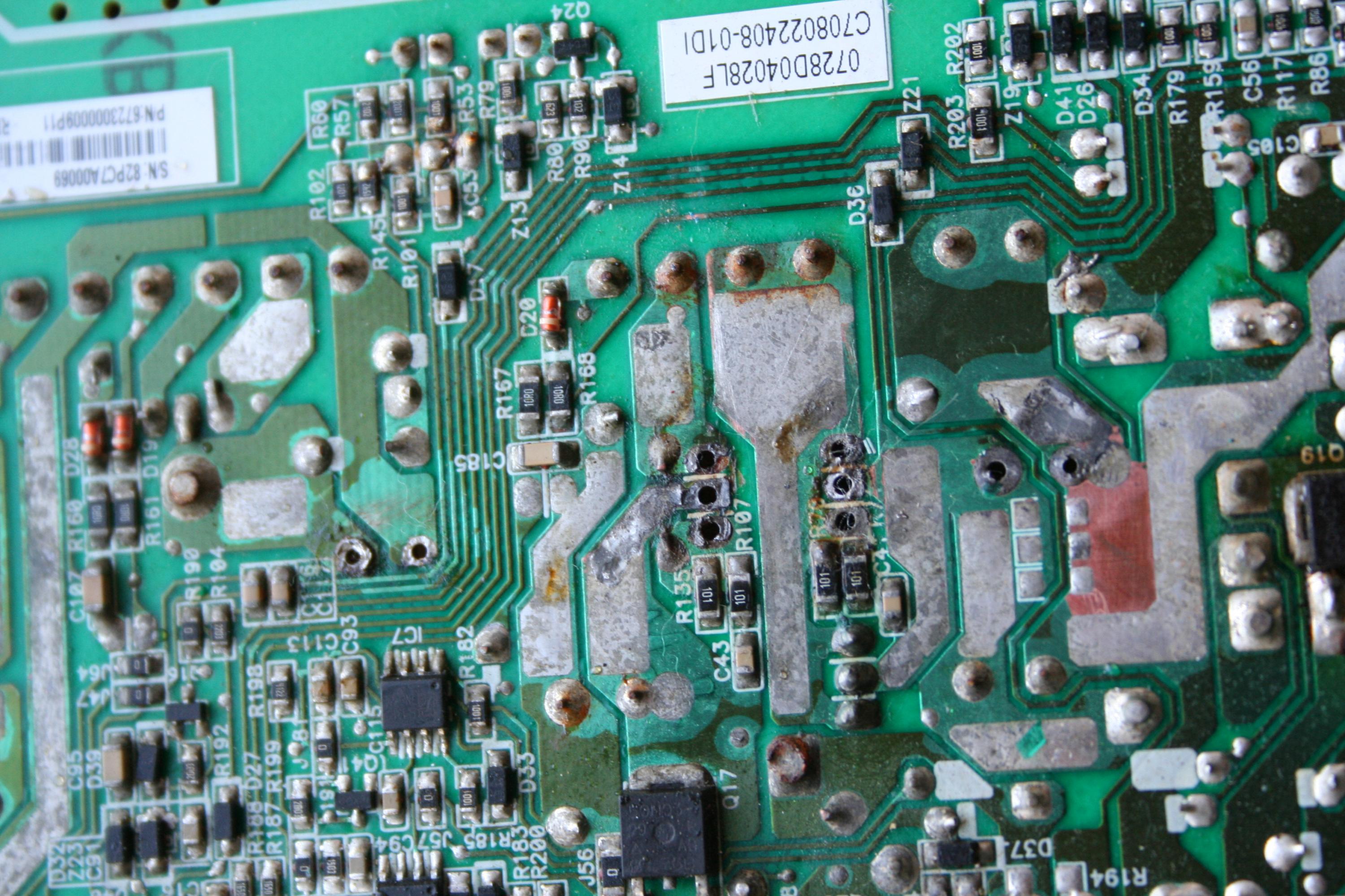

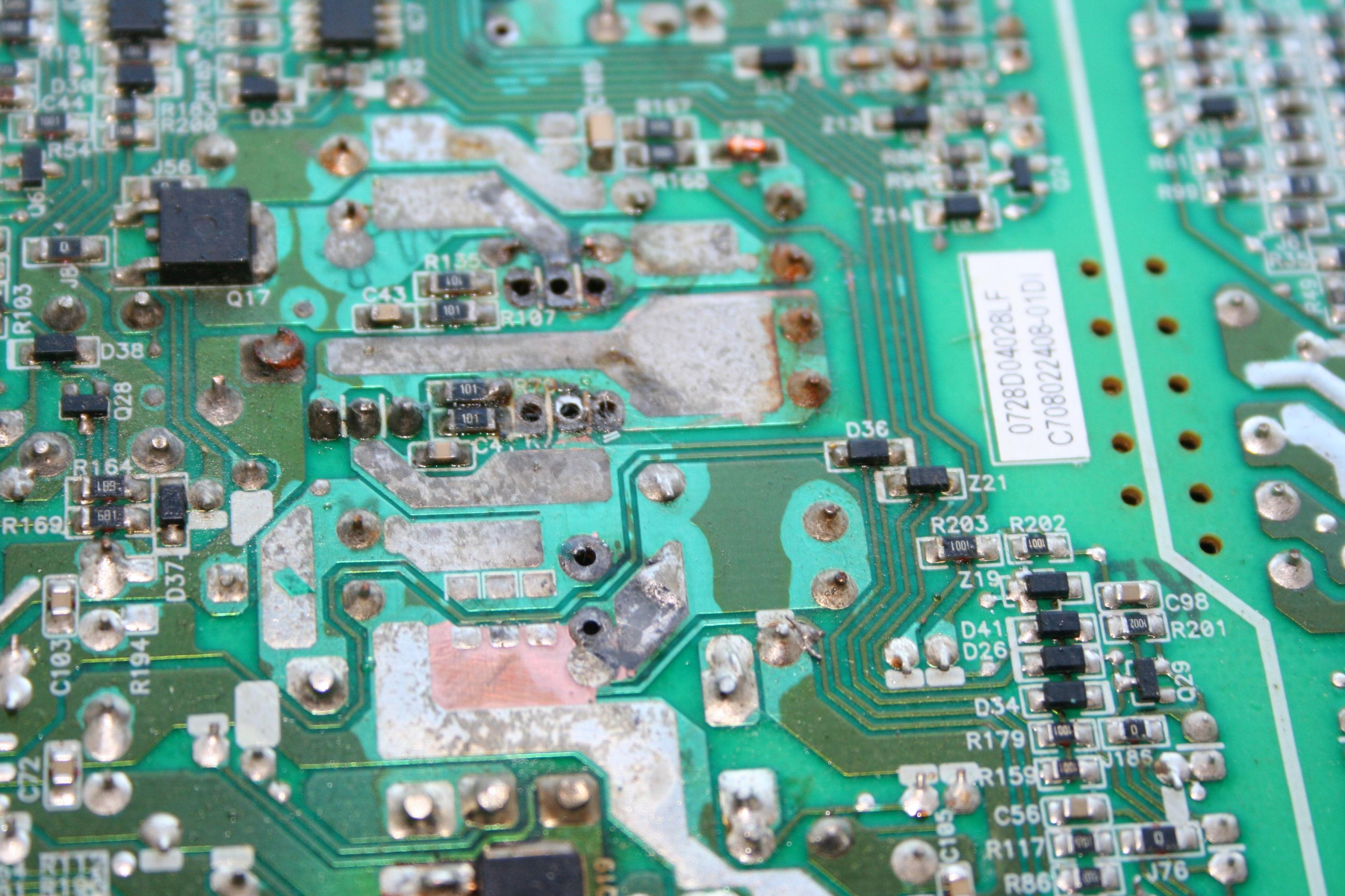

                                  An update on my situation: http://imgur.com/a/k7B0L/all
                                  I've messed up the soldering so badly.
                                  Anyone recommend a cloth to use to remove those areas of browny greasy stuff? It's flux
                                  EDIT: Almost positive I've lifted the pads now. FML.

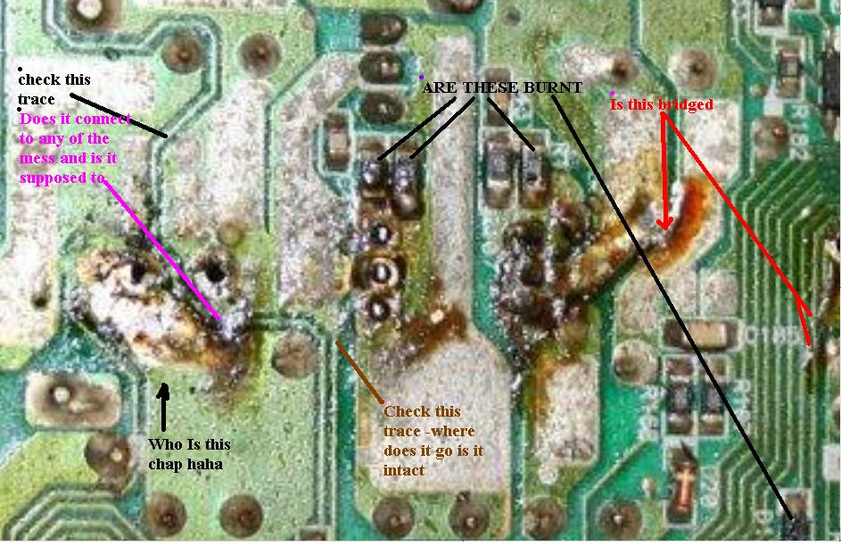

                                        Hmm - Pictures need to be clearer - you should have been
                                        practicing - later ones are a bit better.
                                        Board !! I am sure I have seen worse but not sure when.
                                        Clean it up with isopropyl alcohol and a soft toothbrush
                                        if you have already lifted any pads be extra careful. Mop up alcohol+flux with paper towel then probably do it again.
                                        Try and get good clear pic/s of the main damage areas after cleaning.

                                          #260
                                          Hey Selldoor. I don't think any of the traces or surface mounted components are damaged but feel free to judge again from the pictures now I've cleaned it up!!
