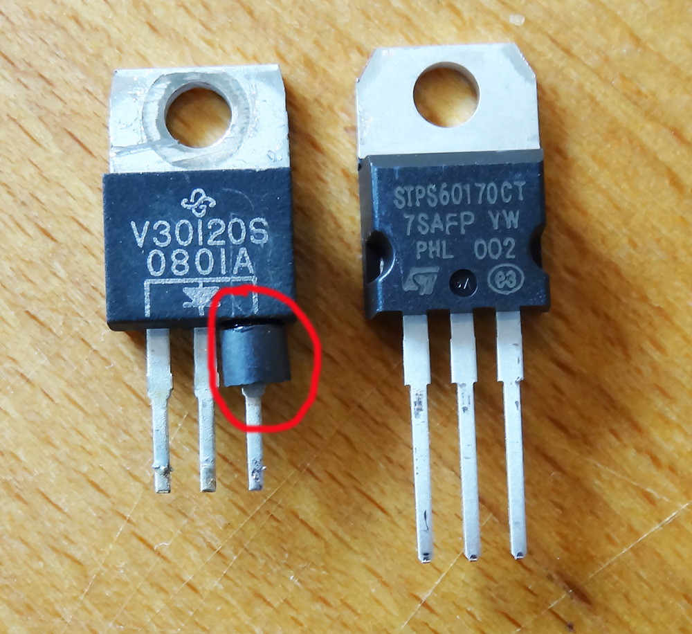

                                    Ok, I have remove the bad diode and am about to put the new D22 diode back in.
                                    I have noticed the old diode has a rubber band round the last connection.
                                    Is this important, should I put it on the new diode, or does it not matter. Please see pic which explains it better than I have.

                                      That appears to be a ferrite bead. And yes its important. I'll quote from an article I read on that......
                                      "Since all Schottkys are not created equal, we must be generally conscious of the dV/dt ratings of Schottky diodes. The final solution here was a small ferrite bead inserted on the leg of the Schottky diode. This smoothened out the wiggle, reduced the EMI dramatically in the bargain."
                                      Good luck! ~L-J-7~
                                        Re: Dell 3008wfp faulty power supply
                                        That is basically a one turn inductor.

                                          Arh I could not wait I put in the replacement STPS60170CT diode without it as it did not come with one.
                                          Did anyone else put one on their STPS60170CT diode?
                                          Anyway all seems to be working, my 3008WFP is repaired and working.
