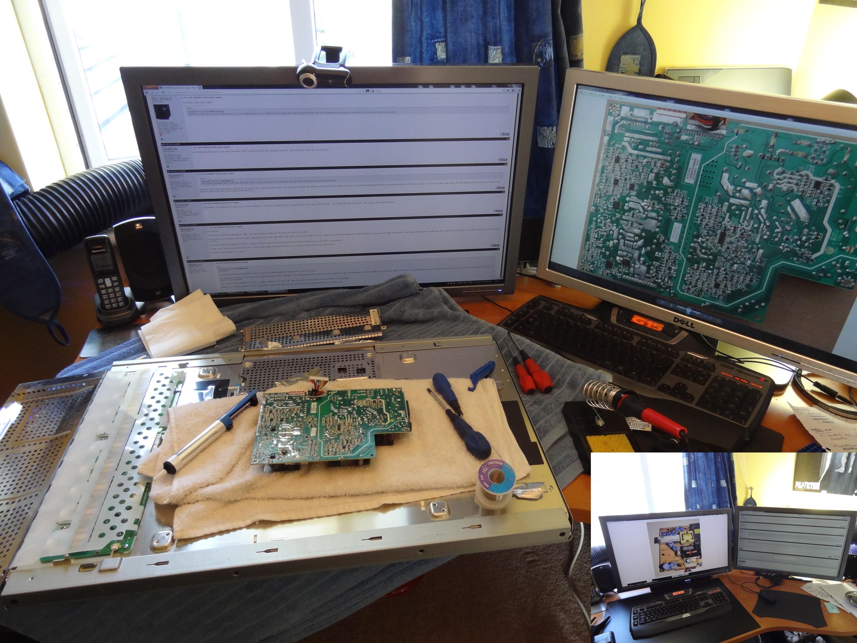

      Ok so I suggest try and get some better photos of the boards so we can have another go at spotting problems. Then put it back together and try it again - do a resume of what happens from when you plug in via switch on to stable fault stage and say what you have done, tested, replaced. so that new readers do not have to piece it all together.
        Re: Dell 3008wfp faulty power supply
        Camera's I have at my disposal are:
        iPhone 3GS
        Canon 350D
        Some point and shoot Canon thingy
        Which would you recommend for this? I can't seem to get any of the cameras to correctly focus on the board..
          Either of the Canons should have a macro mode (icon looks like a flower with two leaves). That will allow close-up focus.
            I would use the canon 350 - instructions here
            https://cdn.badcaps-static.com/pdfs/...d158f29a93.pdf
            You are unlikely to get good pictures at night unless you have a lightbox
            -probably best to wat til daylight tomorrow. Try it on macro - closeup as for flowers/insects - page 43 -46. Do not use flash

                        It would be interesting to see if there are any other factors causing this issue. If you look at the first pages, someone replaced the diode with an identical one, and it failed again shortly. Only when a diode with a higher voltage rating was substituted, did the monitor work good again.
                        Since the monitor worked for years with the original, and then suddenly it blows it up AND also blows up another new diode of the same type, and will only work with a higher rated one, makes me wonder whether there isn't something wrong with the primary.
                        The only factors in the voltage spike atop the PWM waveform are:
                        • The transformer, which is unlikely to shift operating parameters - it either fails catastrophically (very rare occurence), or continues to work at the designed parameters the whole useful life of the device, so we can take that out.
                        • The snubber circuit - snubber resistors are sometimes selected with inadequate power ratings, and with age, they increase value or fail open. That's what i would suspect...
                        Anyway. If the snubber circuit is bad, don't worry about it, since there are quite a number of people that have proven that only the diode on the 24v rail is affected, and nothing else, so swap away with a 170v or 200v diode of the same, or higher current (amps) rating, and keep enjoying your monitor. The STPS60170CT is overkill for this application, but it does help keeping it nice and cool, so use it if you can get it. If this part isn't available in your area, just ask, and we'll help you find one that is.
                        It's just that it would be interesting for someone with an oscilloscope to identify the problem for sure.

                                      Success! Replaced the diode and now I have my screen back!
                                      Again, thank you all so much, there's no way I would have been able to do it without you!
                                        Just wanted to stop by and let everyone here know that I have two of these 3008 WFP monitors and a few weeks ago one stopped working. Dell were, as expected, useless taking over a week to let me know that I'd need to purchase a new one.
                                        I ordered two complete power supplies (in-case my other one died later) from Taobao however just over a week later I got an email saying it was out of stock.
                                        So I purchased a few STPS40170CT Schottky 170V diodes without much hope that replacing them would work but earlier today I installed it and upon powering-up the unit I was elated to find that it worked and has been working with the cover on for several hours!
                                        I can't thank everyone in this forum enough. Dell wanted £1000 for a new monitor, I spent £12.
