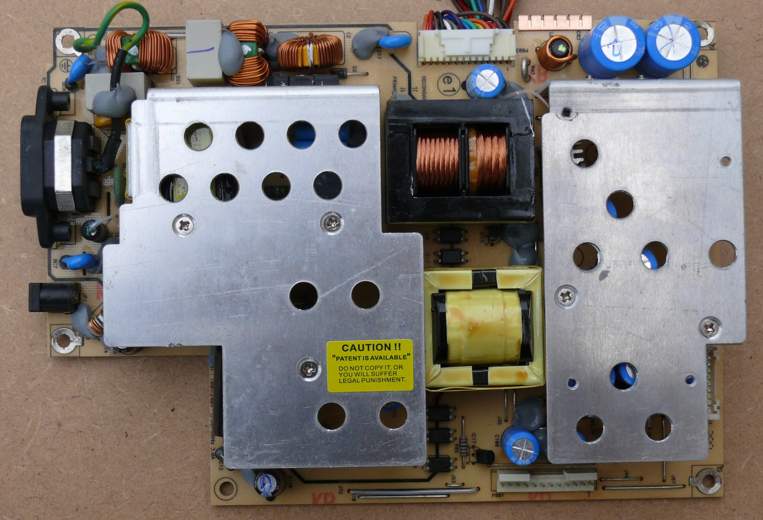

        Images of back and top of Dell 3008WFP SMPS attached. I've had to resixe them to a size allowed by this site. I can take a 22Mp image if needed using my 5DMKII, but it would be 5-6Mb.
        I'll upload another picture of the area of the board under the secondary side heatsink after I've removed it. I don't think I can get at the mounting screws of two other devices to undo them, so will have to desolder those as well to get the top heatsink plate off.

          Unfortunately, two-thirds of your board is covered by those two metal plates. Please retake the photo without them. One thing though, it's a really lousy design because those plates retain heat in the enclosure and cook the caps inside. With the exception of the large 450V cap, you might consider recapping the entire supply.
            Re: Dell 3008wfp faulty power supply
            When re-assembled, the two heatsinks are fixed to the external metal rear housing which totally encloses the PSU and logic board of the monitor, the secondary side using thermal compound, the primary using heat conductive pads. I'm sure the design intends that heat is dissipated by vertical airflow over the vertical rear housing as there are metal grills top and bottom of the enclosing plastic case.
            I will remove however much of the secondary heatsink as needed to replace D22 and post another picture. Even that seems to need 2 additional 3 pin diodes removing as I can't seem to get at the mounting screws via the heatsink side opening. The same would be true for the primary side, so that won't be touched if the D22 diode fixes it on the secondary side.

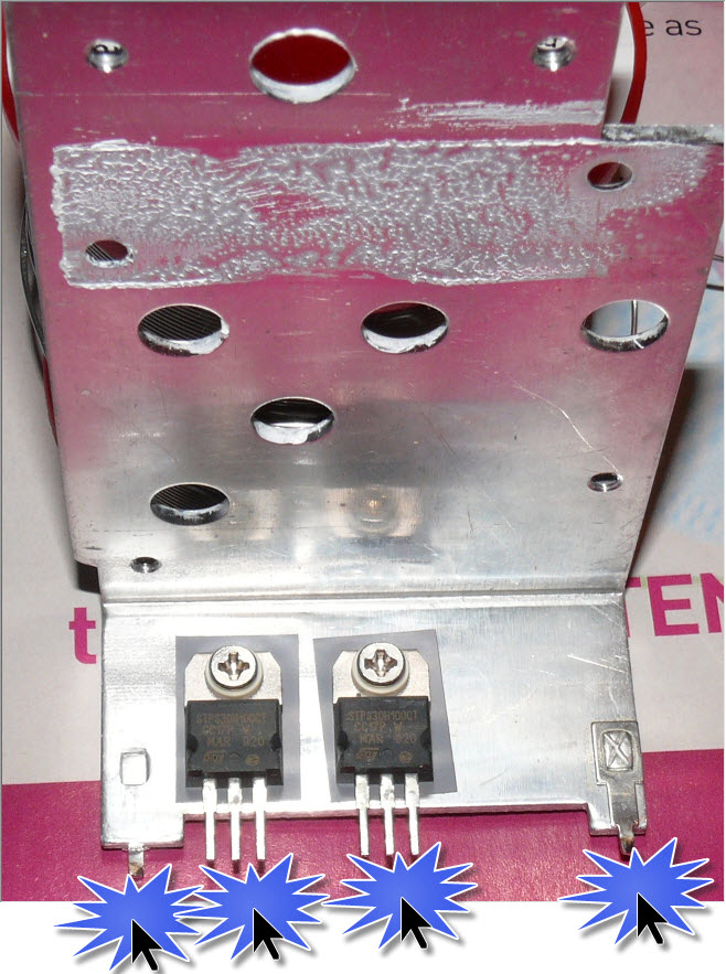

                I just fixed mine using a STPS40170CT device (40A and 170V reverse rating). As you're in Europe, you could purchase from RS Components (rswww.com)as I did. Part number is 624-7586.
                A couple of notes for everyone repairing this particular monitor:-
                1) It's actually the BACK plastic cover that you need to seperate from the front, although you'll have to slightly move the front bezel forward as the actual monitor (made by LG) is held in the rear cover by some plastic clips. There is less than an inch of 'free play' in the cable that attaches to the front panel, so be careful!
                2) I mention this because I could initially only get the 'input source' switch to work when I powered up the repaired monitor (minus back cover), and thought I'd damaged the switch cable. However, it's just that the monitor NEEDS an input source connected before the rest of the buttons will work - strange but true as all the buttons worked after connecting it to my laptop via a VGA lead.
                So, Now all seems to be working. I'm running a 'conditioning cycle' via the menu to give it some heat-soak before refitting the back cover.
                Hope this helps you and others.

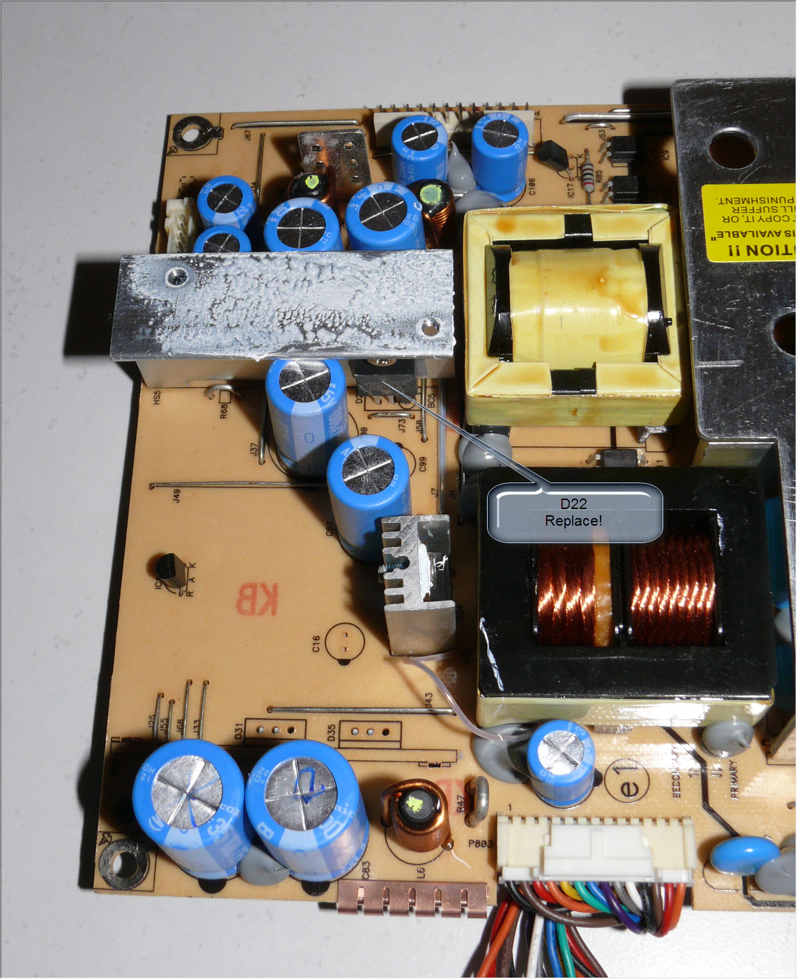

                  Doesn't appear I can update the post with the original pictures in, so here they are.
                  The first shows the points that have to be desoldered to remove the top heatsink plate.
                  The second show the position of D22.
                  Colin

                          Total loss of power. The screen just went blank during use and the blue power light went off.
                          Fortunately, this forum and thread has given me the solution, replacing D22 on the PSU board.
                          I'm wondering if this is a reverse voltage or thermal degradation problem as the monitor worked fine for just over 3 years, albeit it ran much hotter than the replacement U3011.
                          I've ordered a couple of heatsinks to try (will mean cutting a 100mm square hole in the back plastic/metal cover and having the heatsink protruding, but I'm not happy with the current internal metal cover temperature of 50C in the relevant area without the plastic rear cover fitted.
                          Colin
