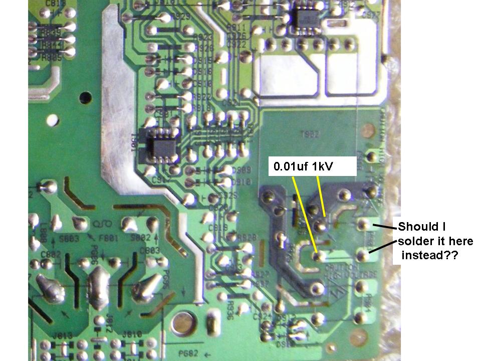

          Inspired by the success of that thread, I went to the local store & bought a few ceramic 0.01uf 1kV caps.
          I had previously bought a faulty HP 1907w monitor (backlight shutting off after 30-40 mins) and found that by substituting a spare CCFL on one of 4 CCFL it will make it work again (only 1 out of the 4 is faulty) without much difference in brightness. So I thought, well, maybe I can just solder the ceramic caps across it as per THAT thread. So I soldered at the bottom as in the photo attached (note that I used another PSU board just as reference). However, it was unsuccessful. The moment I plugged it, it became 2-sec-to-black problem. I swapped the ceramic cap with a 200kohms 2W, but the result is the same.
          Am I soldering at the right location? Or must I solder from the top side (the leads in the socket)?..
          • alexanna
            • Mar 2010
            • 1346
            Re: Faking CCFL inverter
            I really think it depends on the design and how sensitive the safety portion of the CCFL circuitry is.
            After a lot of experimentation I have had better quicker or better results by substituting two lamps at a time.And then check to make sure the lamps stay on before you assemble completely.
            I am not a wagering type of person, But if I was, you're going to find at least one of the CCFL return wires has burned or come loose. And most likely a little solder will fix you problem.
            The hardest thing on the 1907 is getting the case apart.Disassembling the LCD panel is easy.

            • TrippKJ4BKD
              • Nov 2010
              • 19
              It is hard for me to tell from the picture but if I was going to solder directly to the inverter I would make sure it is the two solder pads that are soldered to the two output pins that the lamps plug into. Both of my lamps were bad on the bottom of my HSD190MEN3. The lamps were both broke in half close to the solder points of the input wires.But what I am doing is using the wires from the bad lamps to put my resitors to and then just plug that into the inverter. If I can get this to work and work safely I will post pictures. The Capacitor thing is interesting too and I want to try that as well.
