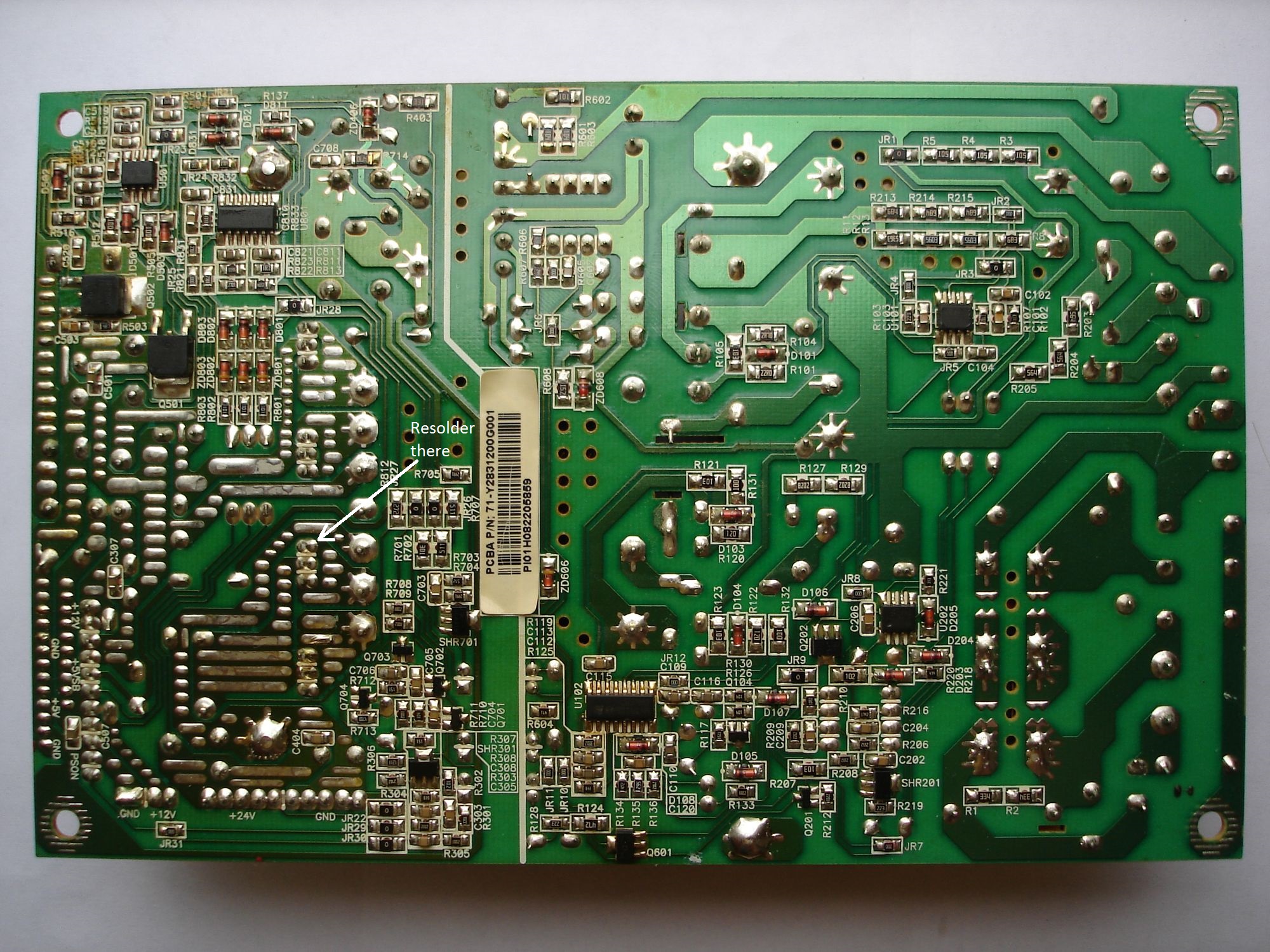

                      #530
                      Re: Hanns-G HG281D, LCD Monitor no power
                      check all the solder joints
                      like there in the pic.
