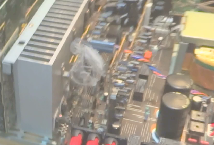

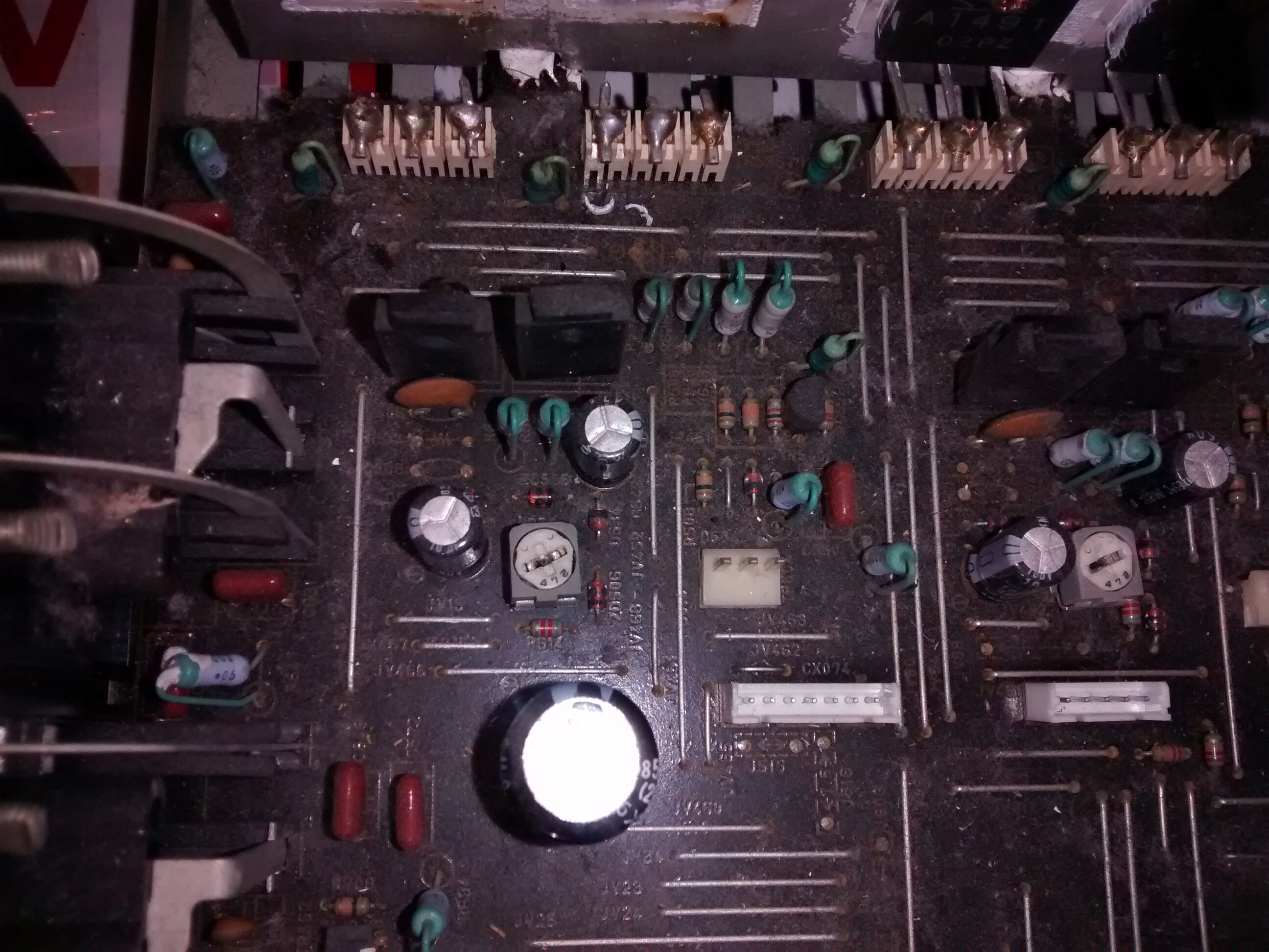

    Howdy everyone.
    I got a non-working denon avr2801 from ebay. Since it was (almost) for free I just changed the fuse, powered it up and I got a pretty good bonfire from one of the "non-burning" resistors . OK, I have another blown amplifier.. cool, change the blown parts and I'm good.. at least that's what I thought back then .
    While I was waiting for the parts, I removed the blown transistors, assembled it and hooked it to my home audio setup... maaan this denon sounds great!
    I got the parts ( the power transistors, the diodes and the zener diodes were all substitutes ). Soldered everything on the pcb, checked it for any visual damage ( after the fire ), crosschecked the resistance of every component with the same on a working channel.. everything was good to go. Powered it up and.... bang! another bonfire from a brand new "non-burning" resistor.
    Removed the new set of blown transistors and just left it for a resident amplifier.
    A week ago I was out of things to repair and decided to finally fix that receiver ( I also wanted to try a new music setup for which I needed one more working channel ).
    Alrighty.. got new transistors, new resistors, new diodes.. well pretty much the standard thing. This time I also thoroughly checked the pre-amp board and the output circuitry for faulty elements. I also tested out of the board TR540 and TR528 together with a set from a working channel.
    This time I was totally sure that everything should be fine... and while I was brushing out the flux residue I noticed that there was something wrong with the path between R614 and ZD506. The path is less than 1mm wide / ~10mm long and was interrupted right in the middle of its length. So I guess this explains the enormous amount of damage the channel had ( indeed this is the first time I'm changing that many elements on a blown channel ). Made a bridge, checked again all paths for interruptions and assembled everything back.
    Power.. bang!... only smoke and a flash from the fuse this time .

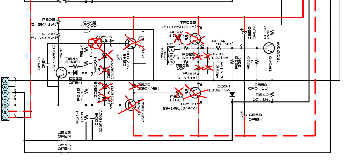

    At first glance, this time, it blew only the power transistors and few resistors ( R622, R620, R624 and most likely the emitter resistors ). The pre-stage ones ( tr534/532 ) seem to be fine and currently the receiver is working with them on the board ( but with removed R620 ).
    So I already purchased the emitter resistors ( turned out those are hard to find ) and in the next days I will also get the power transistors, but... damn, I do not want another fire.. I almost have paid for transistors what I paid for the whole receiver.
    How do you proceed when fixing blown channels?
    Are there any procedures you do before powering up the unit?
    From the damage, do you see an element which might be faulty?
    Any advices are welcome!
    Also, with what standard parts would you substitute ZD506/508 and D534/536?
    The first picture is with the damage after the first repair attempt ( before I discover the broken path b/n r614 and zd506 ) and the second one - after the second ( with fixed path ).

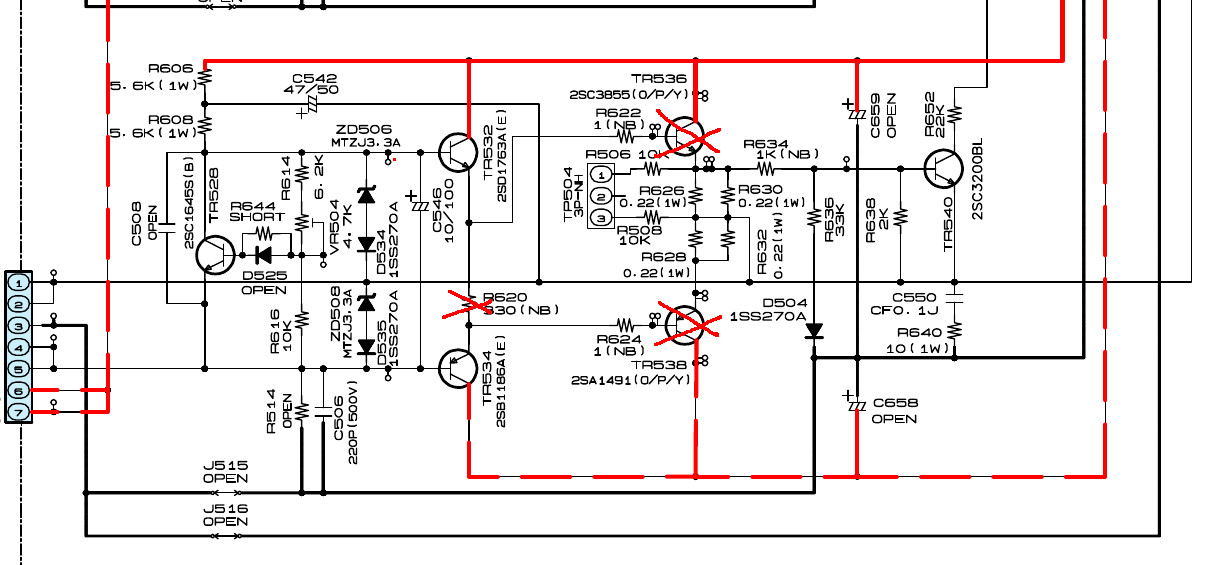

    Are you sure TR536 is a NPN and TR538 is a PNP ? It would seem both transistors are turning on at the same time

      Well... here is the service manual and it says tr532 - 2sd1763a and tr534 - 2sb1186a. Those at least are easy to find, so no replacements here.
      p.s. Oh, you mean the main power transistors.
      The original are TR536 - 2sc3855, TR538 - 2SA1491.. let me see if I can find here ( at the office ) what I got last time as a replacement

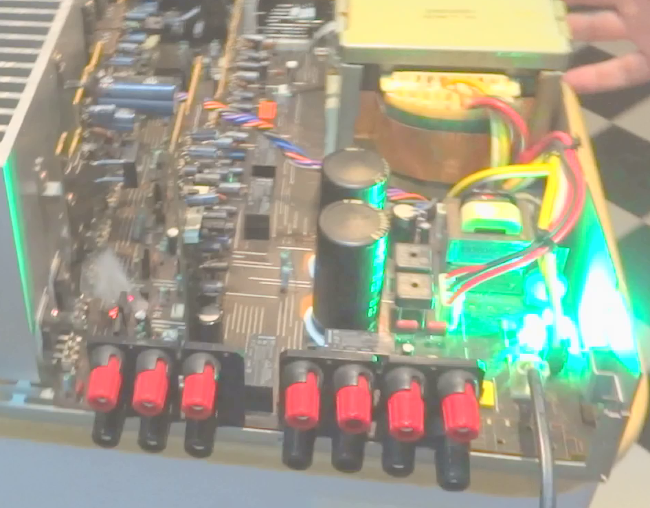

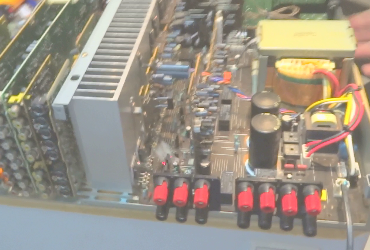

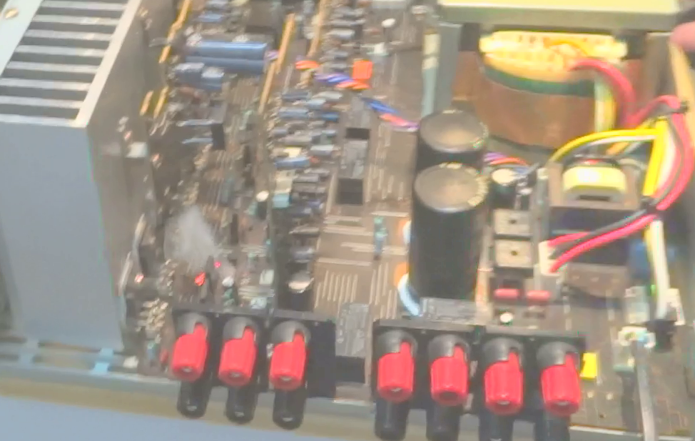

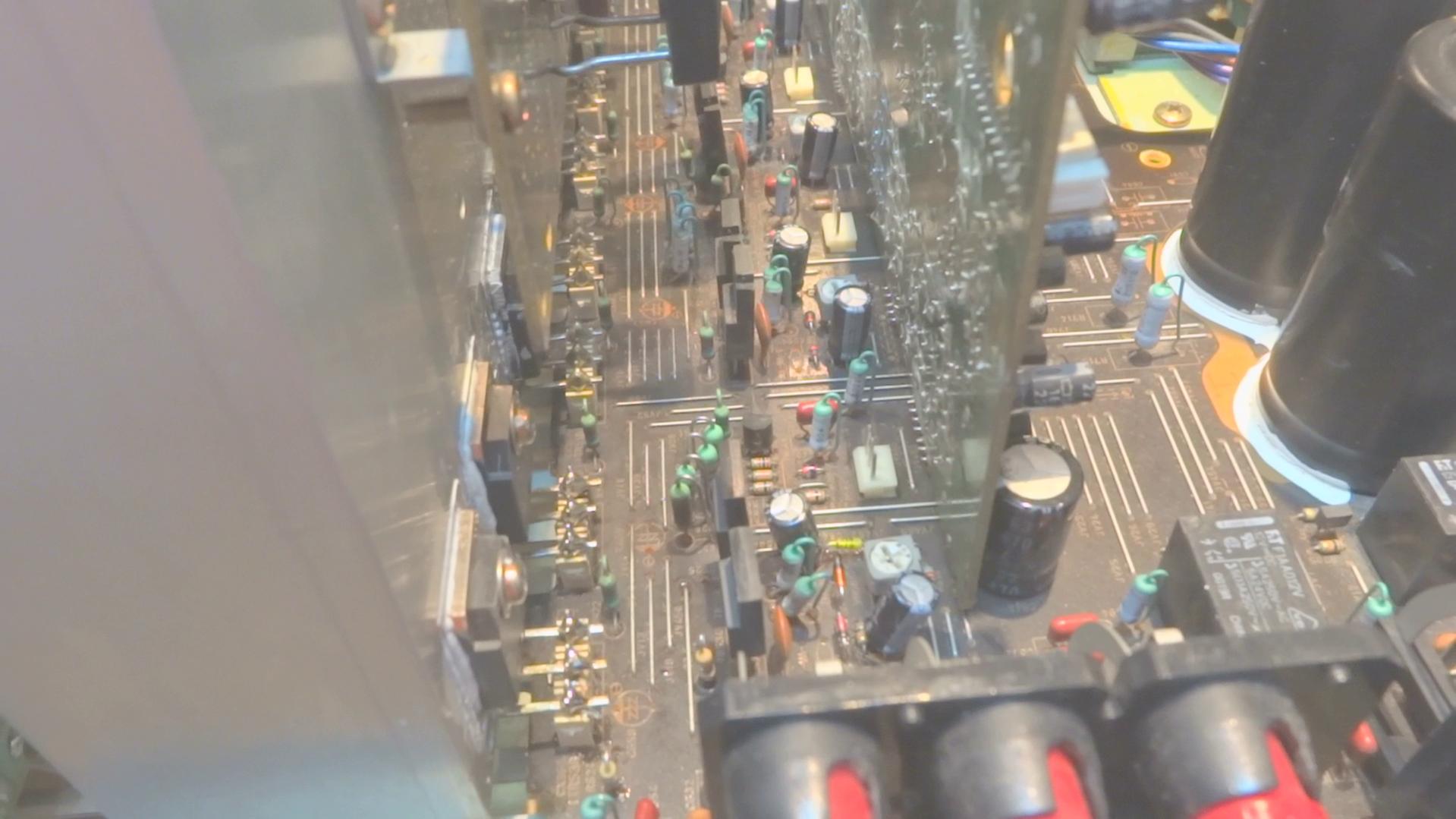

                and here are some good screenshots from the last bonfire
                It looks like this time one of the emitter resistors blew.

                      I would concentrate on were your second picture is. That is the two transistors. To blow both transistors it tells you to much current went through them. They are connected together. One connected to the B+ voltage and one to the B- voltage VR504 as all the VR adjustments need to start fully counter Clockwise. When you measure at TP 504 you then need to bring it up to a very low voltage. If these transistors are fully turned on I only see a 0.22 resistor between them.
                      • keeney123
                        Lauren
                        • Sep 2014
                        • 2536
                        Re: It just keeps blowing...
                        Resistor R620 333 ohms fried. I am not sure what NB means. Yet the two front end transistors did not fry. I am not sure why R 624 or R 622 did not fry unless their wattage is higher then R620. To fry R 620 the current path had to go through TR538 collector/base, R 624, R620, R 622 and TR 536 Base/Collector
                        • madan1
                          • Nov 2016
                          • 691
                          • Bulgaria
                          NB = non-burning ( which seems not to be always the case )
                          R620 - Carbon film 330 ohm 1/4W(NB)
                          R622,624 - Carbon film 1 ohm 1/4W(NB)
                          I have not checked any of the resistors with e multimeter... just the transistors. I checked the resistors only visually and cut R620 so that I can close the hood.
                          When the parts arrive, I will disassemble the boards and test everything.
                          By the way, could faulty emitter resistors cause this damage?
                          Now I remember that I got good ohm readings on them and decided not to change them.

                            So the amount of current needed to fry the 330 1/4 watt resistor would be 27.5 mA at 8.33 volts or any combination of voltage and current that would give 1/4watt. The other 1 ohm resistors must of had less voltage on them and therefore did not get to 1/4 watt.
                            Also, when you get the new transistors very with ohm meter that they are NPN and PNP.
                            On the original PNP the base can take up to 4 amps of current.

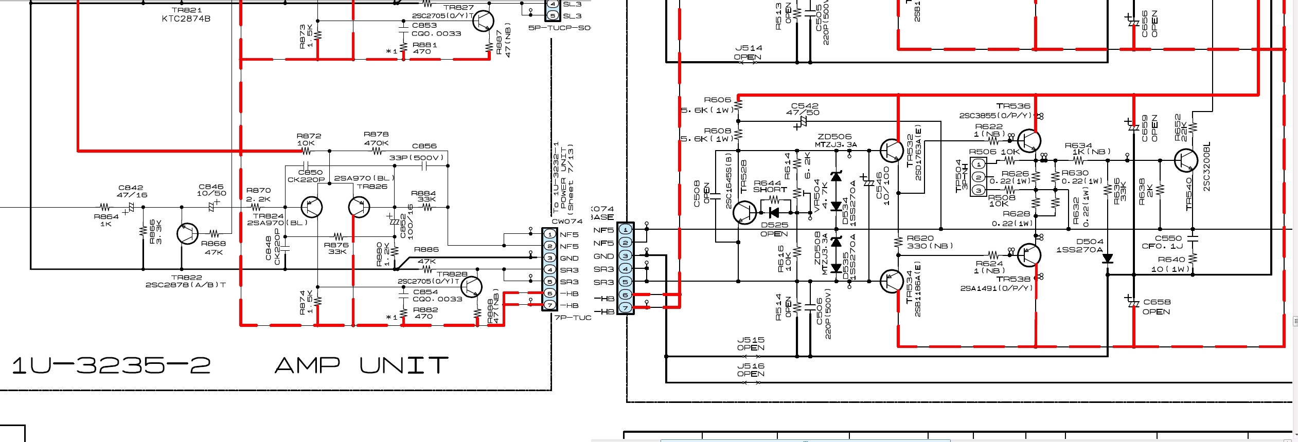

                              If you look at the service manual, you will see for example, the BASE of Q534 goes out to the Collector of the driver Transistor TR828 another section as shown in PDF schematic 6/13 PDF page 91, if that transistor has bad leakage it will bias on Q534 on hard and will cause the direct couple circuit have bad chain effect, so you should check that transistor and the other two differential pair Transistors. All the amps has the same setup, the driver Transistors are on another section.

                                Question wouldn't C506 stop that from happening with just DC?
                                  C506 is just filter cap, if you at the other page of the schematic, you will see that the Base is connected directly to the Collector of the driver circuit.

                                    what is all short open all about ? i never seen that before
                                      The schematic is the master schematic that has all the parts (so the PCB foot-print of all the parts will show in the PCB CAD program) for making PCB, then you stuff the board with parts for the board assembly (PCBA) with the particular function that you need per BOM of the PCBA, so one blank board can be stuffed hundred ways.

                                        Sorry these dyslectic eyes played tricks on me. I had thought C506 was connected to the B+
