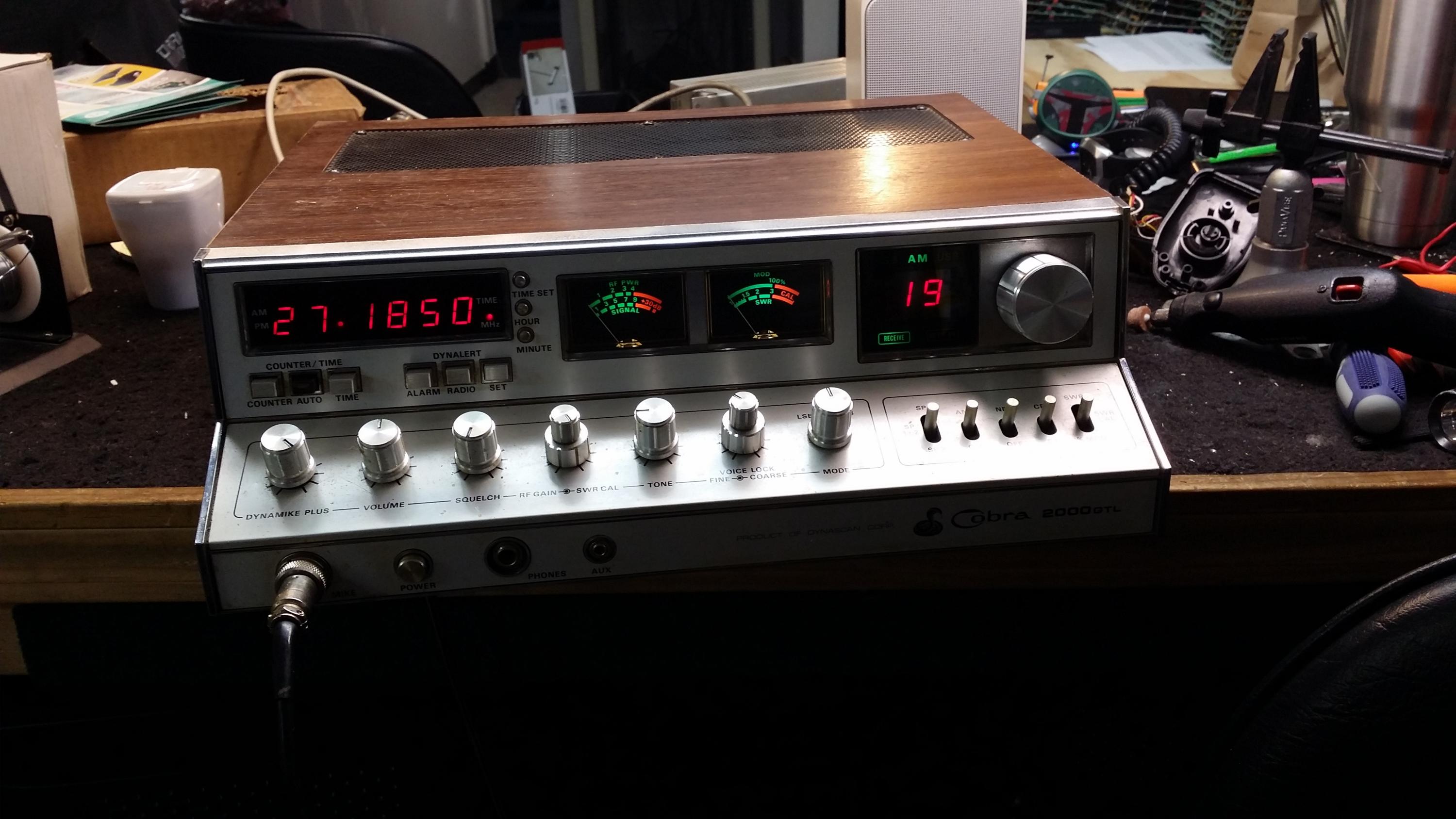

      Re: CB Radio microphones
      seen plenty of the older dynamic elements open.
      back when a cb was something one would pay to have repaired i saw a lot of mic failures.
      cords,plugs,wiring errors,even dirty ptt switch.
      second was idiot "tune ups" and screwdriver drift.
      dont do many cb repairs any more but still get a few.mostly old school quality units like this cobra.

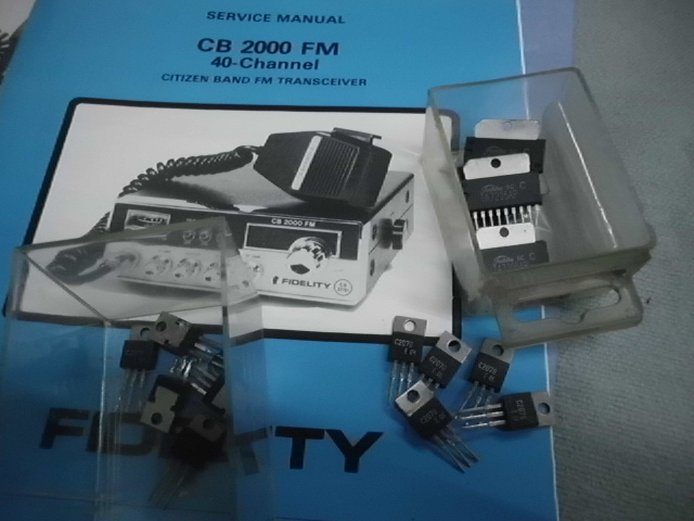

        This post takes me back to the summer of 1979 when I was just 15 , here in the UK some truck driver brought a load of CB radios over from the states and before you knew it all the UK had gone CB radio crazy, in the UK it was of course illegal to transmit on the 27Mhz AM and SSB and thats what made it so exciting doing something illegal, but by the early 1980 we were in the midst of some sort of sunspot and and radio waves , Skip, were coming over to the UK from the states pushing close on S9 so it was easier to hear someone in the states than it was the breakers down the road !
        I got big into repairing CB radios, the demand was massive, the most common problems were the 2SC2078 PA transistor burning out on 4 watt rigs and the audio output chip TA7205AP which also doubled up as the PA stage modulator, I still have all my CB stuff here , Tristar 747 amongst many other rigs, in uk when they legalized CB radio in 1981 it was on FM which meant
        no DX ing so by 1983 CB had died a death.
            This is what more than 40 years of not throwing anything away does for you !
            I have the service manual for the 901 somewhere but cant just lay my hands on it.

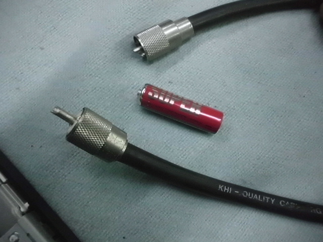

                                  Originally posted by stj
                                  it's a mix of 27MHz and probably illegal stuff and PMR 446MHz handhelds - also usually illegal because people use 5w radio's when the limit is 500mw
                                  500MW ? we power mad running huge linear amps , here is my old patch lead with an double A battery for comparison, the cable is RG8 and somewhere but I cant just lay my hands on it ,I have a newspaper cutting of the first person in my town to be busted for running a linear amp as he lived in a block of flats and when on TX it wiped everybody's TV reception out, the fine was something like £100 which in today's money would be perhaps worth £1,000 .
