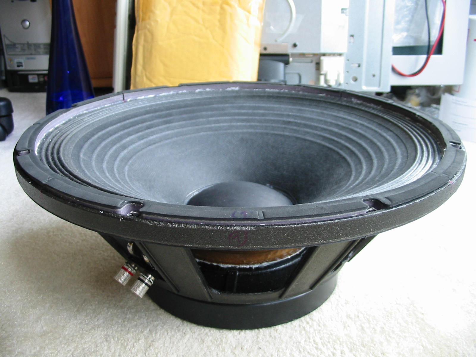

    As usual, I always start with the item in its “as is” condition.
    Overall view:
    Top view:
    https://www.badcaps.net/forum/attach...1&d=1477969159
    (notice how small the GU10 light bulb is compared to the speaker)
    Bottom (sticker) view:
    Terminals and magnet:
    As you can see, it looks alright on the outside. But besides the completely open VC reading that I got, pushing down or pulling up the speaker cone made the VC produce a nasty scratching sound. I could even hear lots of metallic scraping noises, some resembling loose wire. Obviously noises like that are never good, so I started by removing the dust cap to see if there is anything in there that is visually wrong.

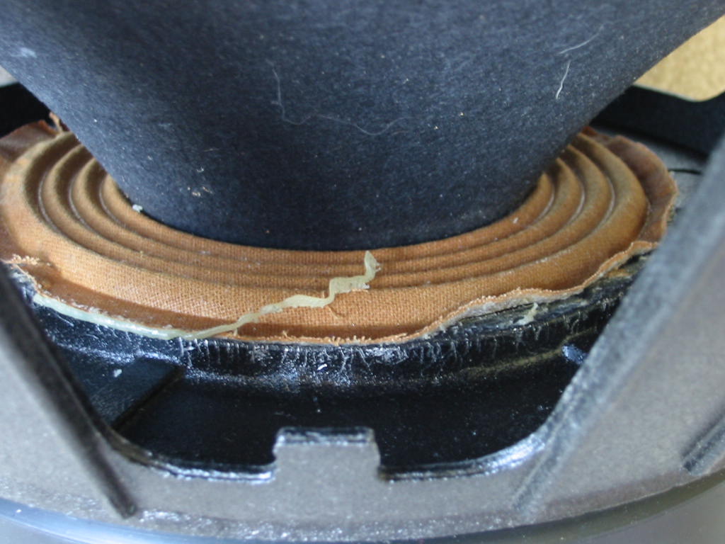

    Thus, I struggled quite a bit to find a way to remove the spider easily and without damage. But to make a long thread a bit shorter, I will just jump straight to the method that I found works best, because I could otherwise type a book here on everything that I did and didn't try.
    So, the method I found was rather simple after all, and without any special tools or supplies…. just needed a flat-head screwdriver, a sharp chisel, a hammer, and needle-nose pliers. To understand what I tried to do next, here is a picture:
    https://www.badcaps.net/forum/attach...1&d=1477969456
    Starting on the left, I first pried up (with the screw driver) on the white silicone that sits right on the edge of the spider, then used the needle-nose plies to pull it off, as seen on the right. Next, I took the chisel, placed it between the spider's edge and the speaker basket, then I gently whacked the chisel's handle with the hammer. Once the spider started to separate from the basket, I held the chisel in a downward angle (towards the basket/magnet area) and continued to hammer/chip away from the spider in a slightly right-ward direction. This helped keep the spider from ripping (though I still managed to put a few small rips on it here and there… but nothing critical.)
    After lots of chipping, the speaker cone was finally ready to go. The final step in the disassembly process was to detach the flexible wires that go between the speaker terminals and speaker cone (they were held with screws, so I didn't need to unsolder anything here). Did that and out came the speaker cone.

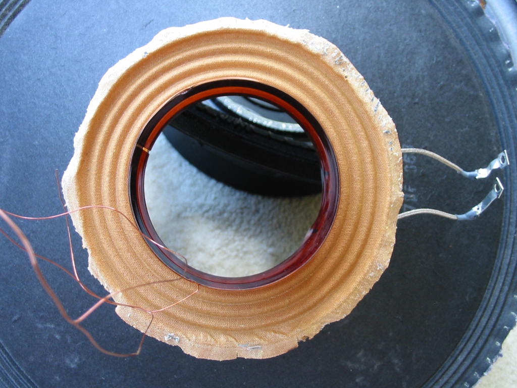

    So let us see what the damage is in more detail, and decide if it is fixable:
    https://www.badcaps.net/forum/attach...1&d=1477970112
    Well, I think we can see why that voice coil went open-circuit. Looks like it was rubbing somewhere in the top plate (outer rim) of the gap, and that's probably what loosened it from the Kapton former. Then, it was just a matter of the wire getting stuck between the plates of the magnetic gap and the moving speaker voice coil hitting it and ripping it. In that first picture above, you can see that the wire broke just a little to the left of where the rubbing was going on. And you can also see the Kapton former is deformed a little where the broken wire is.
    But why did the voice coil rub like that? Perhaps this was a factory defect? Or was the owner of this speaker pushing it too hard, so that the paper cone couldn't handle the power, deformed, and made the VC rub? I still couldn't understand.
    Either way, look at that voice coil again! Aside from the ripped wire and scratched area, the rest of it just seems in excellent condition otherwise! So I though, why not try to fix the broken wire and see how that goes?
    Before doing that, however, I checked the magnet gap for broken wire segments / turns from the voice coil - there were none. So I took the mangled wire of the voice coil and carefully straightened it out. Then, I checked for weak spots in the wire that could have been caused by any sharp bends; again, there were none. Thus, I took the loose wire that I just straightened and carefully rewound it by hand around the VC's Kapton former, just to see if the wire would be long enough to be soldered back together… and it looked like it was. In fact, the wire actually overlapped a bit at the ends (about 4-5 mm overlap.) I think the tension I put on the wire and the way I wound it around the Kapton former was probably a bit different than the factory, so that's most likely the reason why.
    Generally, whenever winding a voice coil, a solid round former for the voice coil's former should always be used – especially when doing a complete rewind. Otherwise, the tension from winding the wire can crush and/or deform the voice coil former into a smaller or irregular shape, thus making it scrape inside the magnetic gap. (Been there, done that on a smaller speaker, so I know better now. ) On the VC of the Eminence speaker, there was no danger of that, since most of the VC was intact, and I only had to put three or four turns total.
    Anyways, I was very gentle with this, so I am pretty sure that I did not deform the voice coil or Kapton former significantly (if at all). Then it just became a matter of stripping the coating off the broken ends on the voice coil and simply soldering them together. But before doing any soldering, however, I took the stripped wire ends and connected them together with an alligator clip, then checked the resistance of the voice coil with my multimeter. It read around 6 Ohms, which is pretty close to what the spec sheet (attached at the end of this post) has listed for the static resistance (5.23 Ohms for Re). Given my multimeter leads and the multimeter accuracy, 6.odd Ohms definitely seemed okay to me.
    So the next step was to really put the voice coil back together. I started by carefully re-winding the turns of wire again, making sure they look as neat as possible. In the process of doing that, I decided to glue the wire to the VC, turn by turn, so that nothing would move around. Of course, I didn't have any special glue, so I had to think for a bit what to use. I've used wood glue before, but it was on a small 4 ½ inch speaker with a tiny 1 inch diameter voice coil (the magnetic forces from that are not too strong). But I didn't feel comfortable with wood glue for this big 3 inch diameter VC. Moreover, it had to be something that could stick somewhat to the Kapton tape former of the VC. My favorite hot (melt) glue was also a no-no, since the VC can heat up when pushed at high power levels, possibly enough to melt the glue (not to mention hot glue can degrade quickly over time and make a mess in the magnetic gap). So then I started thinking more and remembered that I had some old nail lacquer/polish that was discarded by my family a long time ago. Nail lacquer/polish dries quickly and I figured it is the closest thing to varnish used for potting transformers, so that seemed like it would have worked. It was a bit snotty due to being old, but a few drops of Acetone brought it back to life easily.
    After using the nail polish to pot all of the wire turns at the end of the VC, I left it to dry overnight. The next day, I soldered the two wire ends of the ripped VC together. This is the result:
    Yes, that nail lacquer job ended up looking quite ugly. But it held everything nicely and actually stuck to the Kapton former fairly okay (which is surprising, because nothing really sticks to Kapton well.) And here is the even uglier other side of the VC:
    But who cares about how pretty that VC looks. After all, it is going inside that magnetic gap, so I could care less. The only thing that matters is that it doesn't rub and the speaker works at it should. Speaking of which, I checked the resistance of the VC again after the glue dried, and it read the same resistance as before – around 6 Ohms. Thus, I took the now-repaired VC/speaker cone assembly and put it back into the basket to check that the VC didn't rub anywhere in the gap. After some playing around (because without gluing the surround and spider back to the basket, it is difficult to have the VC stay in place for testing), I found that the voice coil did NOT rub anywhere. And then just for giggles, I decided to even do a quick live test by hooking the speaker to an audio source. Of course, with the cone loose in the basket, obviously I didn't hook it to my amp and crank it up. Actually, I just used the headphone output jack on my laptop as the audio source (used a 3.5 mm cable with stripped ends and hooked one channel to the speaker.) The speaker worked!
    (Though, I should note, it wasn't very loud given the output source. )

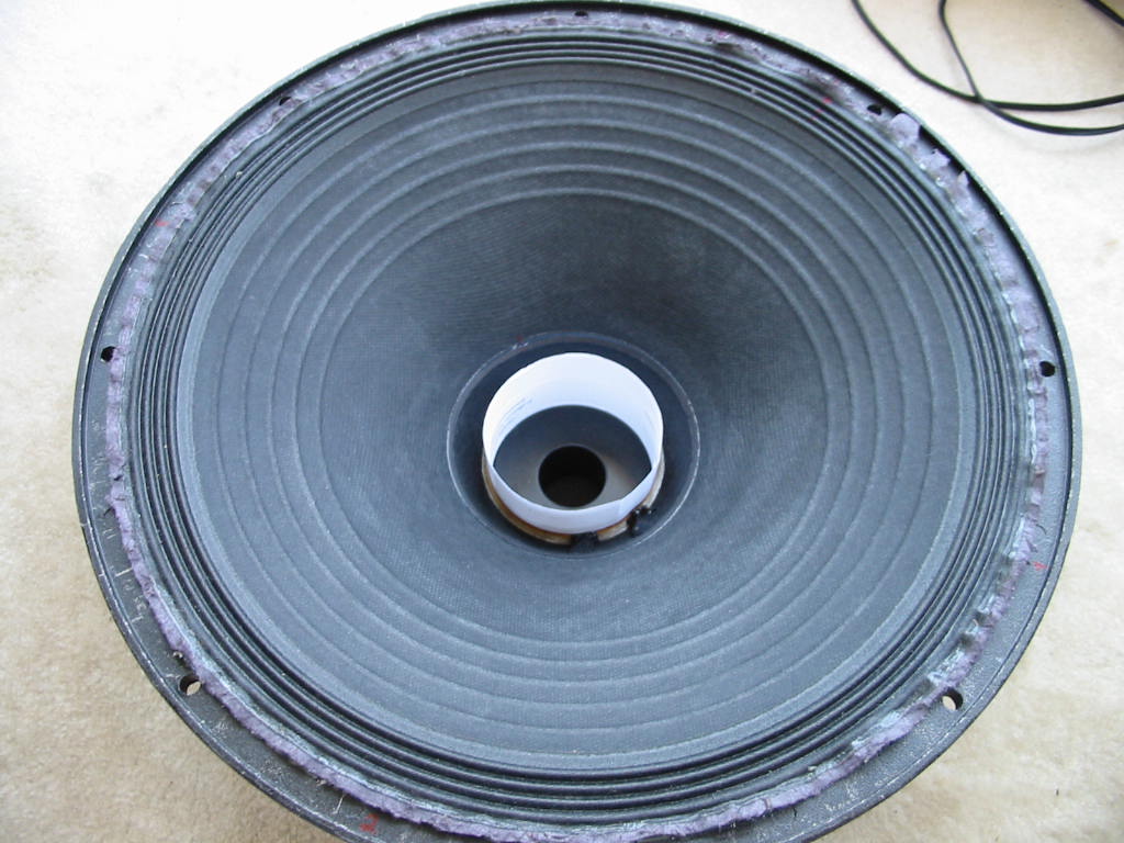

      First part was fitting the cone/VC back into the basket and centering the VC in the magnetic gap so that it doesn't rub anywhere. Now, some YouTube videos might try to make you believe that you need to buy a special shim for your speaker to fit in the voice coil gap. That is nonsense, though! (Or at least, it's just not necessary.) Good old A4 or Letter printer paper will do the trick just fine. Here is the shim I made:
      https://www.badcaps.net/forum/attach...1&d=1477970714
      Basically, I cut four separate pieces of paper, with their length approximately equal to the circumference of the voice coil (3.1416 times the 3” diameter… but just a tiny bit shorter, actually, as we don't want any overlap.) This doesn't have to exact at all, though. As for the width of the paper: a few centimeters / about an inch wider than the voice coil former. This is so that the paper can be stuffed into the gap and later removed easily when everything is glued.
      I ended up using only three of the four pieces of paper I cut for the shim. Basically, after inserting the second piece into the gap, it became really difficult to insert the third one. So a forth piece just wasn't necessary, as the three pieces were more than enough to space the voice coil evenly around the center pole piece. When I tried to wobble the cone sideways, the voice coil stayed firmly in place – an indication that the shim was good. Here is the paper shim from up close:

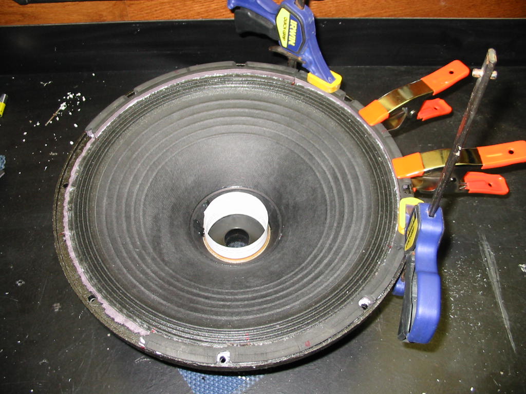

      Next part was gluing the spider back to the speaker basket. Here again, I ran into a dilemma what to use for the glue. After some thinking and short experimentation, I came to the conclusion that regular bathroom silicone / caulk should work fine. And so I started gluing:
      For those of you are wondering what that black cable is used for: it spreads the force from the clamps evenly on the spider. Basically, the cable is placed on top of the spider's outer edge, where the spider is being glued to the basket. That way, the glue (and spider) will be even everywhere. Here is a zoomed out picture that I think will help clear this up:
      And yes, I had to do the spider gluing in sections, because I only had five clamps. Thus, I did half of the spider one day and the second half the next day. Once finished, this is how it looked:
      With the spider done, the speaker cone surround was next item that needed gluing to the basket frame. Again, after a short debate, I decided to use silicone for this as well.
      But if you remember that picture above with the surround and paper gasket unglued, you may have noticed that the surround edge didn't stretch very far onto the basket frame. Eminence was actually using the paper gasket to also help with holding the surround.
      Thus for this particular speaker, I glued both the surround and the paper gasket at the same time. Because I had limited number of clamps and because there were four sections of the paper gasket, I did the gluing one section at a time, in a cross-pattern. Like this:

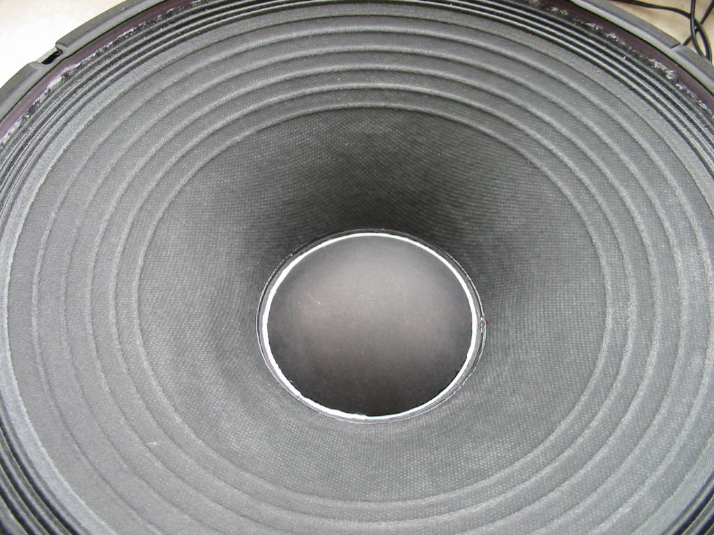

      After this was all set and done, I removed the paper shim from the magnetic gap and checked if the voice coil was still aligned by moving the speaker cone up and down by hand. At first, it appeared that it was all OK. But then, when I pushed the speaker cone to near its Xmax travel distance, the voice coil rubbed on something again. I couldn't tell if the rubbing came from the outer side of the voice coil (i.e. where the wire turns are exposed, like the first time when the VC failed) or the inside (the Kapton former rubbing on the center pole). Either way, I was very surprised because I have shimmed speakers this way before, and I am sure the voice coil was centered properly. So I started thinking about the original failure again.
      The first thing that crossed my mind is perhaps there is a factory defect (same one that caused the voice coil to break in the first place). Looking directly at the damaged voice coil again, we can see that the voice coil former is not perfectly round; there is a slight bump on the inner side of the VC former. In particular, there is an area where the wires for the VC are soldered to two metal terminals that then go out to the flexible wires. Almost directly on the opposite side of that is where the VC got cut and failed originally. Perhaps this deformation is what caused the VC to get misaligned at the factory when it was shimmed in the gap. (If I recall correctly from seeing a YouTube video of an Eminence factory tour, they appeared to be using a thick and fairly rigid shim for gapping the VC, which could have made the centering of the voice coil possibly even worse than my paper shim.) So I definitely think this “bump” could be the reason for the VC getting shimmed off-center (both by me and at the factory).
      Or, perhaps the VC could have gotten off-center (or not going straight in the gap) because the speaker cone is made of really thin paper and easily deforms in any direction. Thus, if/when the speaker is pushed at very high powers, it may be possible that the cone looses shape and slightly alters the axis of the VC relative to that of the magnetic gap, thus making the VC rub near maximum excursion.
      And yet another possibility is if Eminence didn't use enough glue/varnish (or the right type) to hold the voice coil turns to the Kapton former. In that case, the VC at the bottom of the former could have separated at high power levels, thus getting cut in the gap, and then the loose wire changed the path of the VC/former so that it rubbed.
      I'm thinking the first two scenarios are more plausible, though who knows. But getting back to my “repaired” voice coil / speaker… I decided to solder the flexible wires back and then give the speaker a real test before gluing the dust cap back on. This time I used an actual amplifier/receiver: a Denon AVR-3200. With the speaker running *in free air* (no box), I could push maybe around 10-30 Watts at low frequencies (i.e. under 60 Hz) before stretching the cone to its Xmax positions. But once the speaker cone reached the upper Xmax excursion limit, the voice coil started to rub very abruptly accompanied by a nasty grinding noise. But if I turned the volume knob on the amplifier down just a notch, the rubbing disappeared again.
      Of course, it is worth noting that I performed the above test with the speaker in free air. Once I flipped the speaker upside down so that the cone was facing the floor, the paper gasket created a sealed (or nearly so) enclosure with the speaker cone and the floor. As a result of that, I could push much more power through the speaker. I couldn't get the voice coil to rub at all. Thus, it is possible that with a proper speaker box, I can get a good amount of power out of the speaker before the voice coil starts to rub.
      I decided that this repair is good enough for me, at least for now (since I do NOT plan on selling the speaker). So, I proceeded to gluing the dust cap to finish the job. In my case, I was dealing with a paper cone and paper dust cap, so just about any glue could be used here. For paper, I often use wood glue, but this time I used general “all-purpose” stuff, which also works well on paper surfaces.
