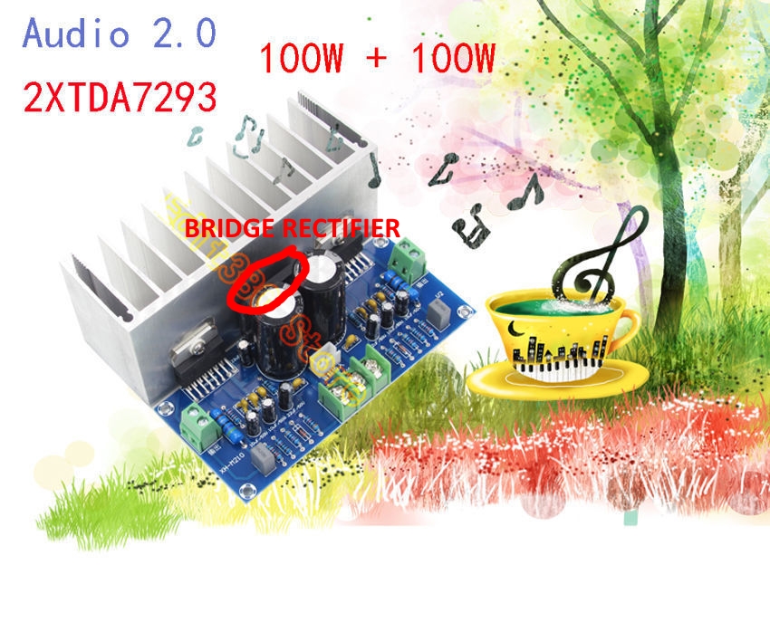

          Re: Need Help with this Circuit Please
          oldskool design.
          http://www.ebay.com/itm/161852896480

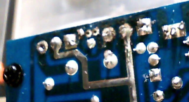

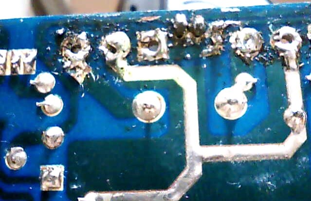

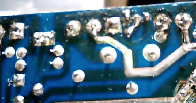

                Looks like I did damage on top of damage when I removed the burnt transistors. Tell me can this be fixed or am I looking at a total rebuild of the board and or circuit.
                Tom
                Computer and Small electronics troubleshooting and repair
                  • 30972
                  tracks look o.k. - just loads of sludgy solder all over them that needs cleaning off.
                  then clean the flux off with IPA and take fresh foto's

                    #29
                    Yeah, get rid of the blobs of solder and clean the board. Go easy on the pads with the heat so they don't pull up but I don't see damage to traces either, if there are they can be repaired on this board.

                      The pads are the parts that I am concerned about because some of them pulled up when I was desoldering the bad power transistors.
                        I would use solder wick to clean the solder up. Just do not let iron stay to long on the braid. You would want to put a little flux on the solder joints and make sure the tip on the solder iron is tinned, place the braid on the solder that you want to pull up, then put the iron on the braid. The heat will transfer down through the braid heating up the solder. The solder will suck up into the braid as the braid becomes full you will need to feed unused braid into the solder. This should happen in one quick motion. Just make sure you have enough braid out so when you fed it in you do not burn your fingers. If it seems like it is taking to long then you will have to let the solder cool down again and try again. You do this to prevent burning of the board or pad.

                            Some of the pads have broken off of the traces
                              fine, use jump wires - those transistors are mounted on a heatsink.

                                can't use that eBay item says that it uses AC power and the only power I have available is DC Power. I appreciate the information.
                                      You just feed the DCV directly to the two main filter caps. Your amp has SMPS power supply or linear power supply?
                                        • 30972
                                        #39
                                        i think ebay add is wrong, i dont see any rectifier diodes in the foto.
                                        even if it had some you could bypass them.
                                        i think the chinese just meant use a split suppy.
                                          #40
                                          The bridge is attached to the heatsink.
