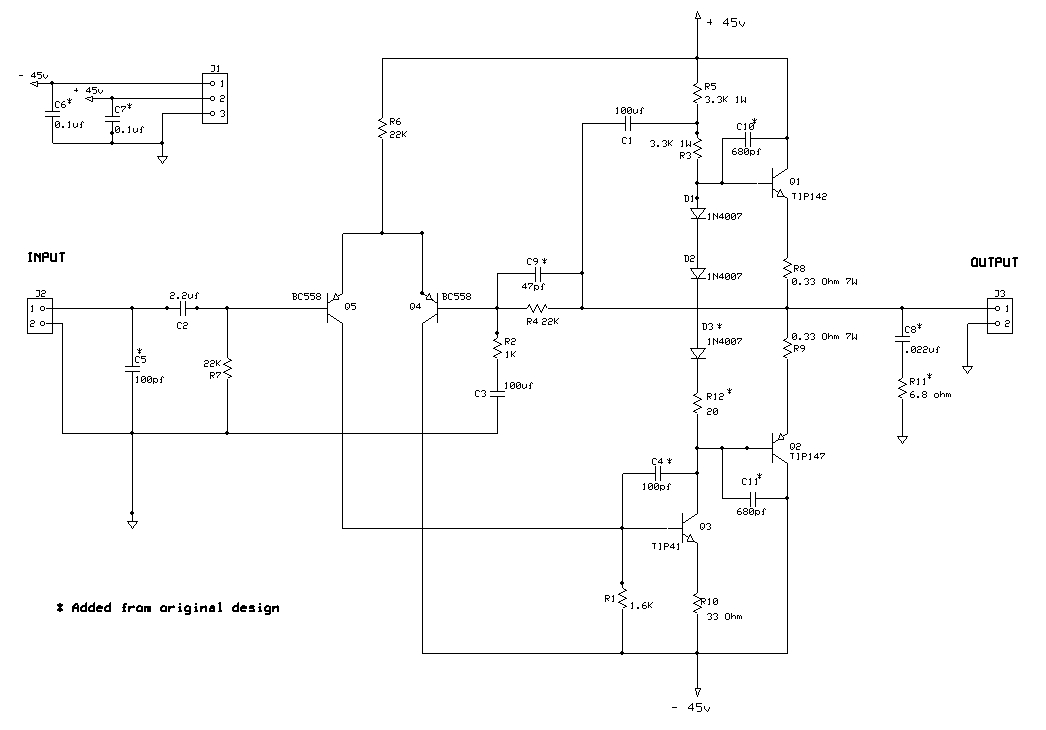

    Dear Forum members,
    I hope that you can help me out with this amp circuit, I cannot get it to work correctly even on +- 12 vdc supply. I end up with 10vdc between the speaker output and ground.
    Tom

    i'm not surprised, it has no bias ajustment or anything.
    it looks like a classroom example of what not to try to build!

        Originally posted by tfs2015
        Dear Forum members,
        Tom
        It's no wonder, there is no output DC decoupling. At least put a cap in series with the speaker before you burn out the voice coil.

          At least in theory, it shouldn't need any, since at least on the schematic, it has +/-45v supplies, so...

            Yes, if the circuit was really balanced but it doesn't look like it at a glance and the circuit is not drawn very well. It's not possible to tell how the transistors are biased without knowing what they are. One could look them up and redraw the diagram but I'm not gonna do it.

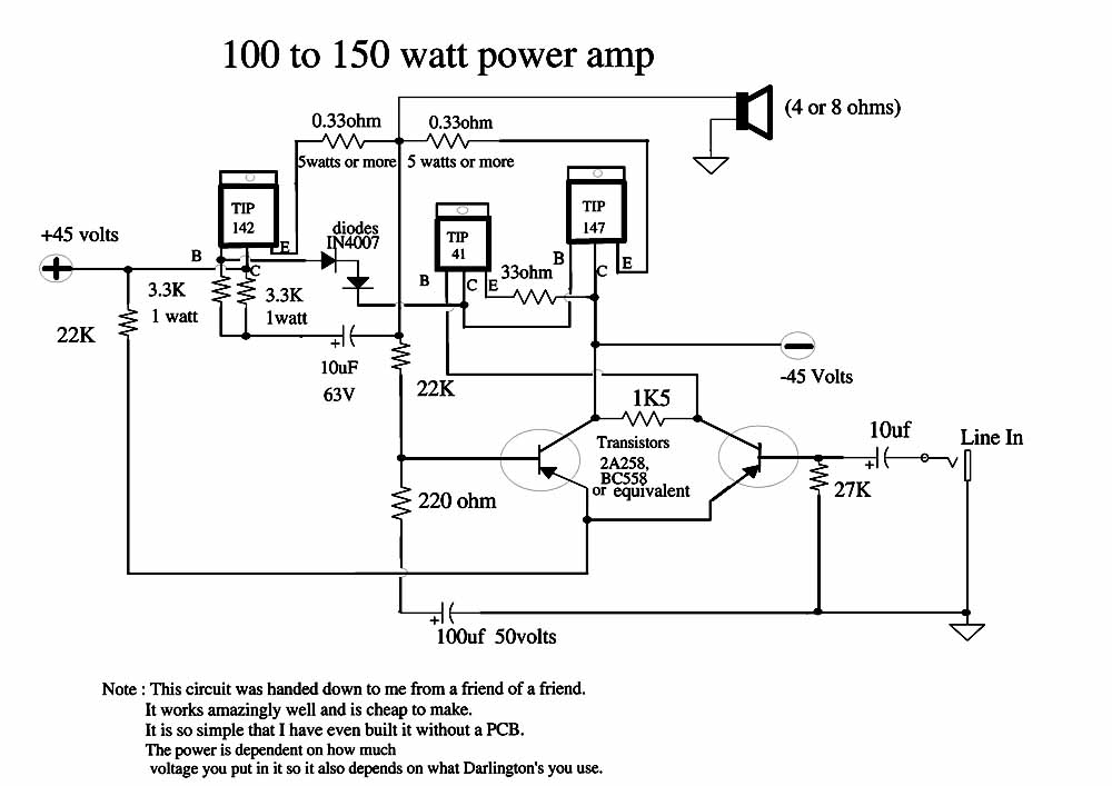

                  Here are a couple I found:
                  http://circuitdiagram.net/150w-power-amplifier.html
                  http://www.circuitdiagramworld.com/a...ram_16729.html

                    The reason I want the link is to fiond out how many people or if the Author actually build the circuit.
                    I see the power supply circuit (http://circuitdiagram.net/150w-power-amplifier.html) suggested to use 35V-0-35V and the filter caps are rated at 50VDC (4500uF 50V), @35V, the DCV on the cap will be about 49VDC if the line Voltage stays still.

                      Re: Need Help with this Circuit Please
                      The alternate schem is easier to read:
                        Originally posted by budm
                        Link to the site where you get this diagram from?
                        I got the schematic from http://electronics-diy.com/electroni...tic.php?id=477
                        I simulated it MultSim and found out that with +- 12vdc power I would get about 10vdc on the + speaker output to ground. If I raised the supply voltage to +- 45vdv the vdc would drop to 950 mv which should not burn out the speaker. When I ordered the components I forgot about the TIP 141 and ended up using a TIP 142 in its place. According to the specs it has 100 watt handling capability where as the TIP 141 has 80 watt. I have a couple of 1200 uF 63v caps laying around, can I use one of those as a decoupling cap on the speaker output? I don't have a lot of money to spend on this project right now so I am hoping I can use what I have on hand.

                            1200uF is a bit much at 8 ohms, that puts the resonant freq center at below 20Hz. Around 20uF at 8 ohms would center close to 1KHz.
