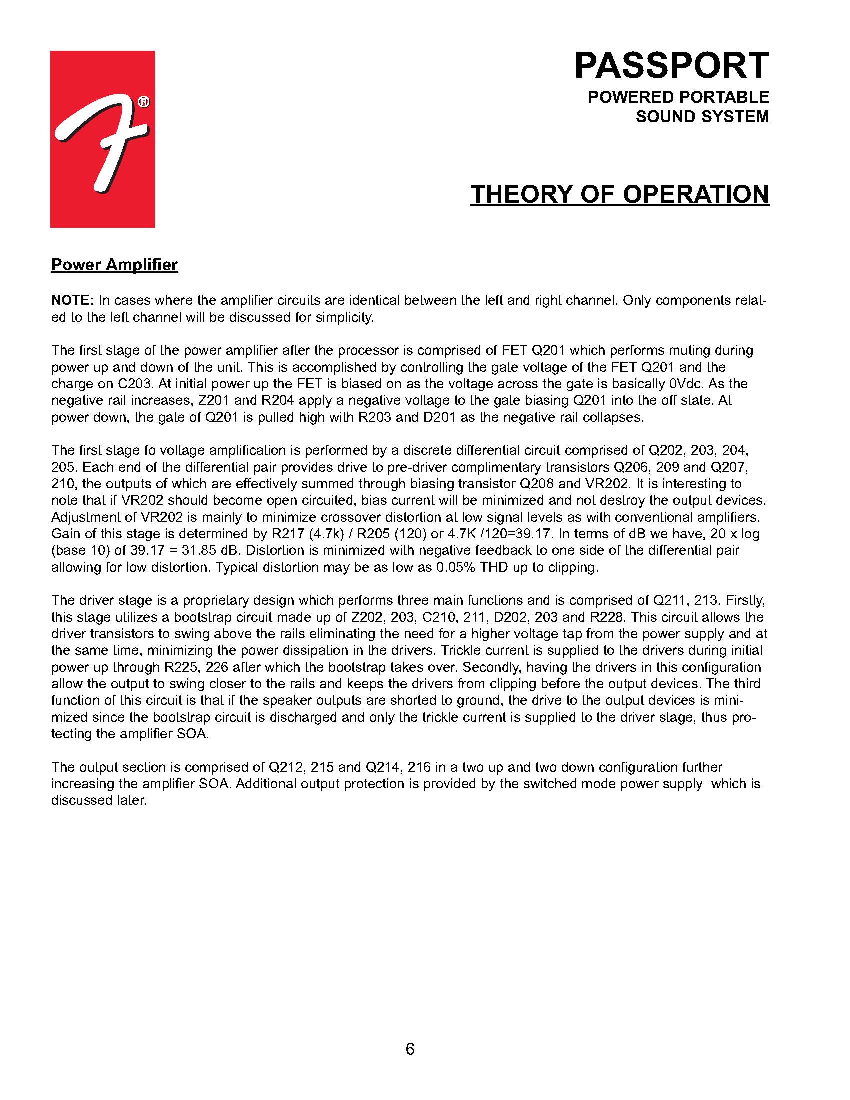

                          OK, I re-read you post 114 again and understand what you said now, I was confused and the thread is getting long.
                          I look at the service manual looking to see if the unit does have some kind of MUTING control, sure enough in the Theory of operation on page 6, there is MUTING FET Q201.
                          So you need to read that page and check out that MUTING circuit.

                                I guess I would first check if these values are in your board. This is on page 7 of manual.
                                Stereo Power Amplifier circuit values for Z201, and R206 have been changed from 4.7V to 6.8V and 10K to 1K
                                respectively after the first 100 sets production. These changes improve turn off transient pop noise. Please update
                                early sets if returned for service.

                                    So lets stay focused on the mute circuit on power up and power down. You most likely do not have and O-scope with storage. We need to start to measure components related to this circuit. I think BudM wanted you to ohm out this circuit. It would be interesting to take a measurement on the zener diode in this circuit to seen if it is dropping 6.8 volts DC across it, you can do this after it is turned on. There is also a 1uf cap that can also get measure. This cap needs to be out of the circuit to measure it. If you had a storage O-scope you could connect to the output of the FET and turn on the power then measure when it is being turned on, that is in reference to time. I will look up the FET to try and figure the best way to test it out. Most likely it is working otherwise the unit would not be on.
