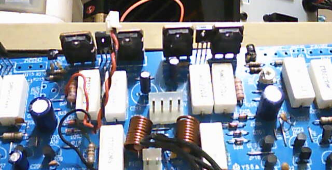

      Re: Need Help with this Circuit Please
      Originally posted by budm
      You just feed the DCV directly to the two main filter caps. Your amp has SMPS power supply or linear power supply?

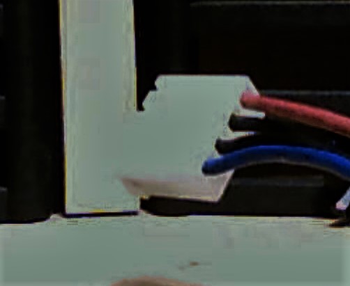

      The whole PA system uses a SMPS Power supply to supply +/- 15vdc to the mixer and +/- 52vdc to the amplifier section. Going into the amplifier section is a Red Wire that is +52vdc and blue wire for -52vdc and two black wires that provide a return(ground) back to the SMPS. The odd thing is once the two black wires are connected to the amplifier section they are electrically connected together to from one 0V ground wire. You can see this on page 25 of the service manual.
      If there was a way I could get this voltage dropped to +/- 40vdc then I could just use a Amp boards from Sure electronics, or one of the other many designs that are available but with +/- 52 vdc I am kind of stuck on what to do.

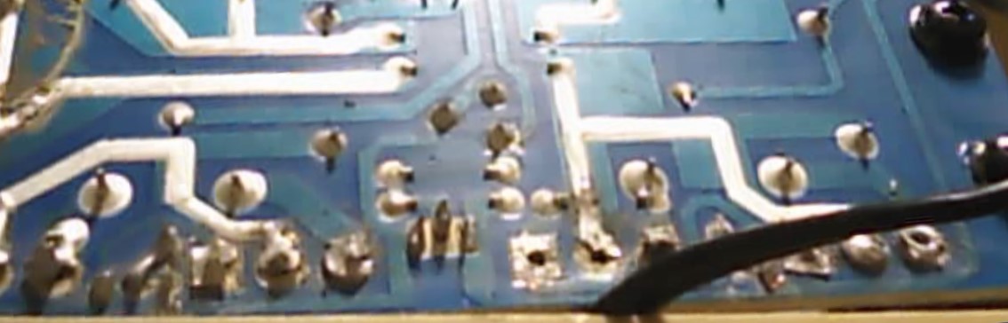

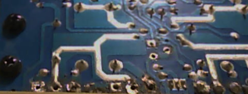

          So After reading all of this information that you posted, am I stuck with trying to repair the board? Btw there is some sort of glue all over the bottom of it. I have up loaded some more pictures of the bottom and top sides of the board.
              ok, maybe not glue, some sort of protective coating I guess.

                you mean the blue coating?
                  #48
                  Blue solder mask?
                    So the blue solder mask will not prevent you from desoldering the solder. It looks like you have plated throw holes for the components to go in. That is the metal of the hole is all the way through the board and there is a solder pad on each side. This is a good thing. If somehow when you pulled up the components you ripped the trace to the solder pad you can gently scrap off the blue solder mask to expose the trace underneath. You would use an X-acto knife to scrap the blue solder mask, but gently. Then if the trace is close to the solder pad you can use a bare wire about the same diameter as the trace/run. Bend the wire to go throw the hole and enough on top to go to the trace/run. If you are using flux core solder you would clean your iron then tin it place it beside the wire and heat everything together and apply solder. Watch carefully as you do this making sure the wire says in place. Sometimes the wire has a tenancy to stick to the iron. You can kind of roll the iron off to one end if that happens or get some hemostats and clamp it in the middle and solder each end separately. I use to use lacquer red nail polish to then cover the exposed run and jumper back up, by not on the solder pad. I do not know what they use now one of these guys will tell you.

                          I would test it by hooking it up to the rest of the PA system and seeing if i get output from the board to the speakers using a input signal from the mixer section. The only thing that I am worried about is burning out the emitter resistors or one of the other components. I can only test the one side because the Left channel bias VR needs to be replaced.

                                          I updated the components that needed to be updated and reinstalled the power transistors on the right side of the amp and went to power it up and when I did power it up the BD140 transistor Q229 went up in smoke but i don't know why, so I need some help to figure this out.
