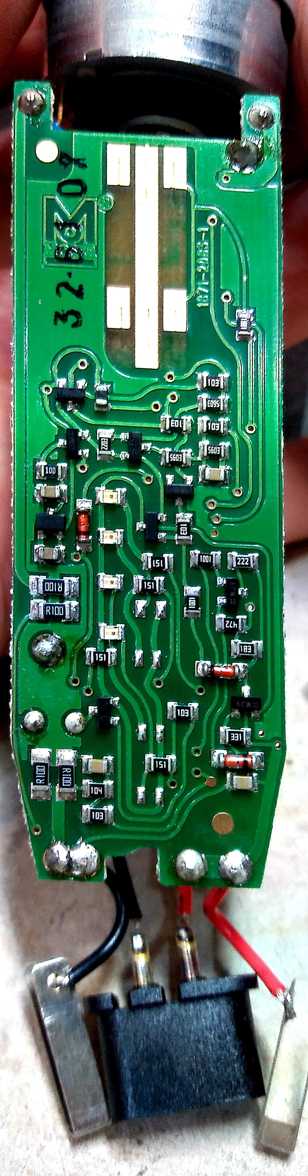

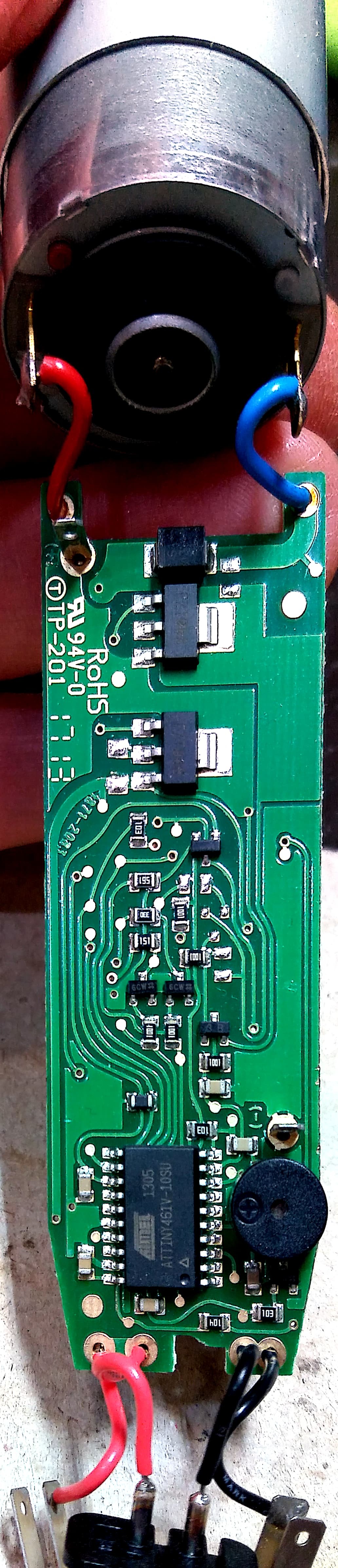

    Hi friends of electronics
    What you see in the video and pictures attached is the circuit for charging the batteries of a DC motor.
    The problem is that this circuit cannot charge the batteries (3 1800mAH NiMH batteries) any more. When the circuit was OK, its green LEDs lit up one at a time to show that the batteries have charged more. But now that the circuit is flawed, LEDs light up as you see in the video and at the same time successive beeps are heard.
    Please help me fix this circuit.

    the charging looks like it's just current limiting and the chip does the leds.
    if the cell capacity is low they will charge faster - very fast if they are killed.
    are they a common size like AA or AAA?
    if they are then go to ikea for some 1900 or 2400mAH re-badged eneloops
    dont use Lidl batteries - they have poor lifespan
    if you put a voltmeter across the cells you can watch the voltage as they charge too - to see if they reach 1.45v

      Where is the video link and where is the picture of the board front and back of it
      If this is controlled by a micro controller it going to be very difficult to troubleshoot this device because you would have to know how each pin of the device works
      But you could use a single cell li-ion BMS board would be easier to work with that is used for cell external battery packs
      1.25 charges up to 1.4 to 1.5 volts. ( 1.4 X 3 = 4.2 ) this might make the NIMH battery pack not 100% charged but if you used a 4.35 volt version of these BMS boards would get you a little closer to being fully charged which would be 1.45 X 3 = 4.35
      They do make HIMH BMS boards but they are hard to find but they are available you just have to do a Google search

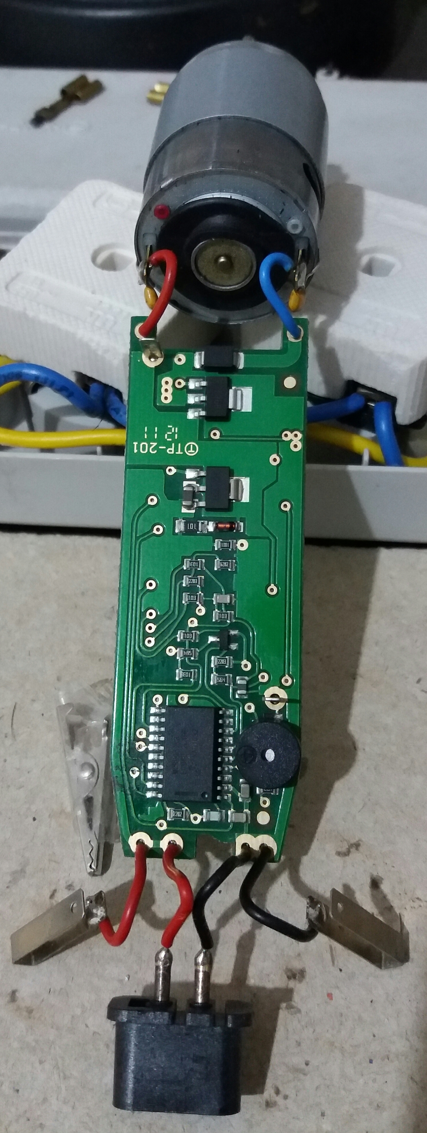

        I had attached all the files but they dissappeared. Again here are the attachments:
        Click image for larger version  Name:	CamScanner 01-22-2025 18.13_1.jpg Views:	0 Size:	939.1 KB ID:	3559251 Click image for larger version  Name:	CamScanner 01-22-2025 18.13_2.jpg Views:	0 Size:	822.0 KB ID:	3559252
        You said: "you would have to know how each pin of the device works". Can not the datasheet of the Attiny 461V-10SU (linked in the first post) help you?

                Bravo stj!
                You hit the mark: The bad battery was the culprit.
                (The battery is 3 1800mAH AA NiMH cells connected in series. I fetched 3 other AA cells and connected them in series: the problem went away. Thank you very much indeed.)

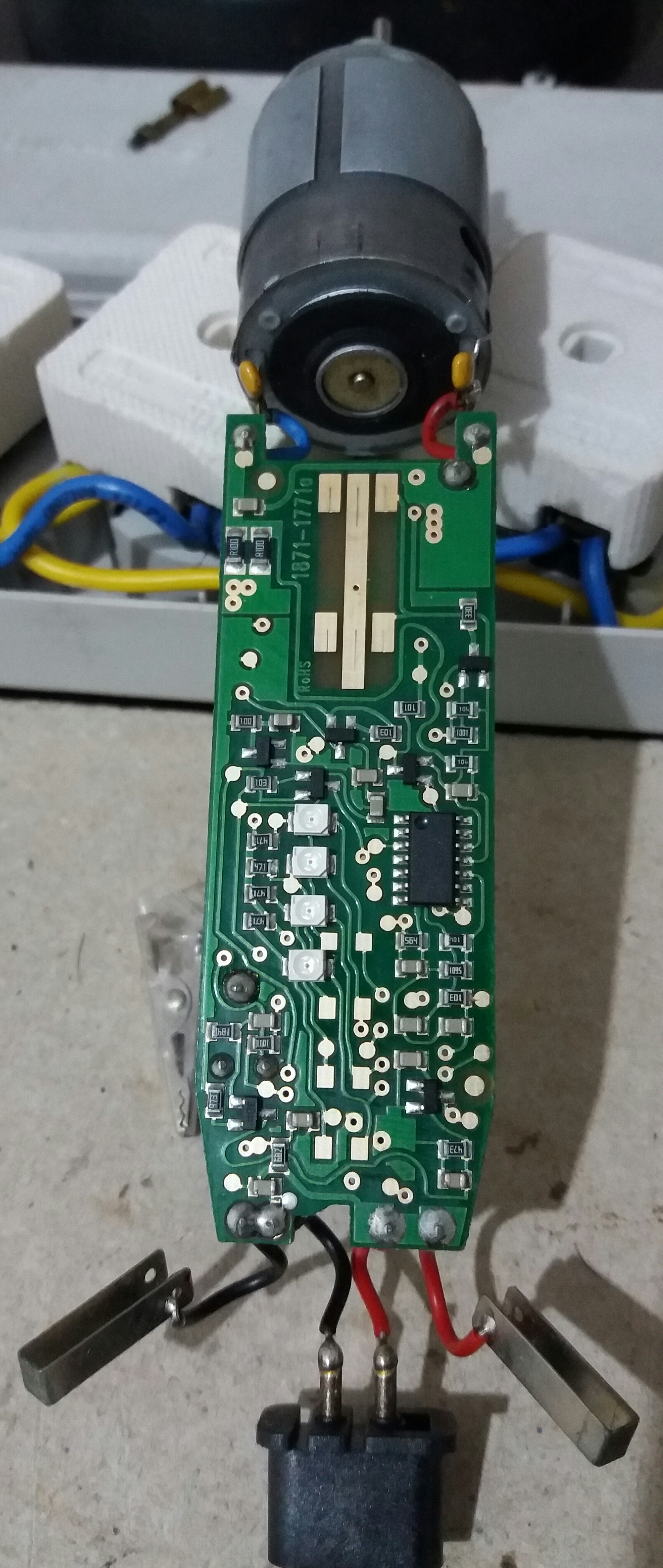

                          I have another circuit (let's call it Circuit No. 2) similar to the circuit I introduced in the posts 1 and 3 (let's call it Circuit No.1), but with some differences for example it has 2 ICs.
                          Unlike the Circuit No. 1, replacing a good battery did not solve the following problems of the Circuit No. 2.
                          When the Circuit No. 2 was OK, its green LEDs lit up one at a time to show that the battery has charged more. But now that the circuit is flawed, LEDs light up as you see in the video: just the intensity of their light increases and decreases. When the light is more intensive, the voltage applied to the battery becomes 5.9, when the light is weaker, the voltage applied to the battery suddenly becomes 4.8 and decreases to 4.3; again the voltage becomes 5.9 and after a couple of seconds becomes 4.8 and decreases to 4.3, and so on and on. (In Circuit No. 1 which now works well, the voltage applied to the battery changes very very rapidly between 4.3 and 5.3 volts so that the digits on the voltmeter are hardly readable).
                          What is wrong with Circuit No. 2?

                            ٰThe video file which I had attached to the previous post is not there any more. I do not know why.
                            I attach it again in this post.
                            By the way, let me point to another problem of the Circuit No. 2: It is unable to run on battery alone (it only runs when the charger is plugged).
