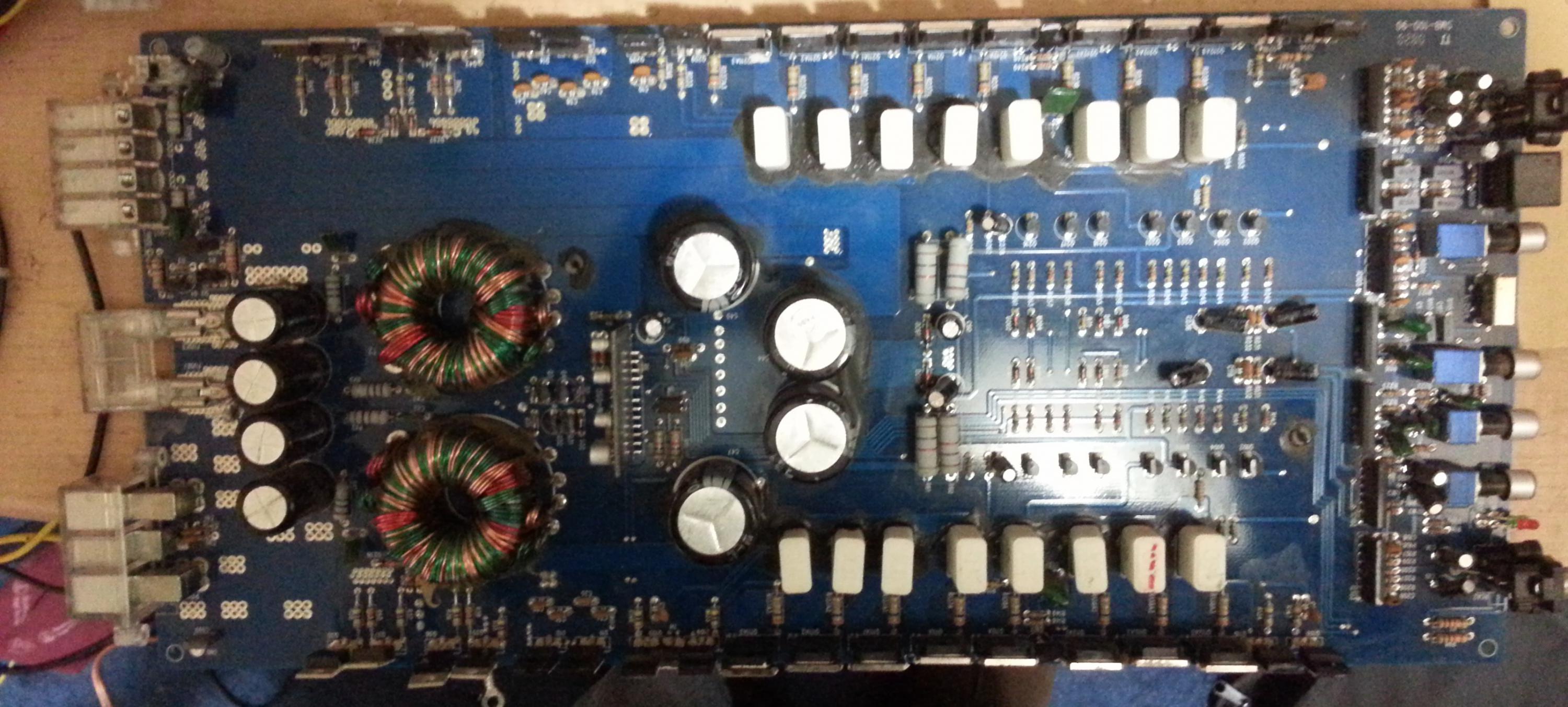

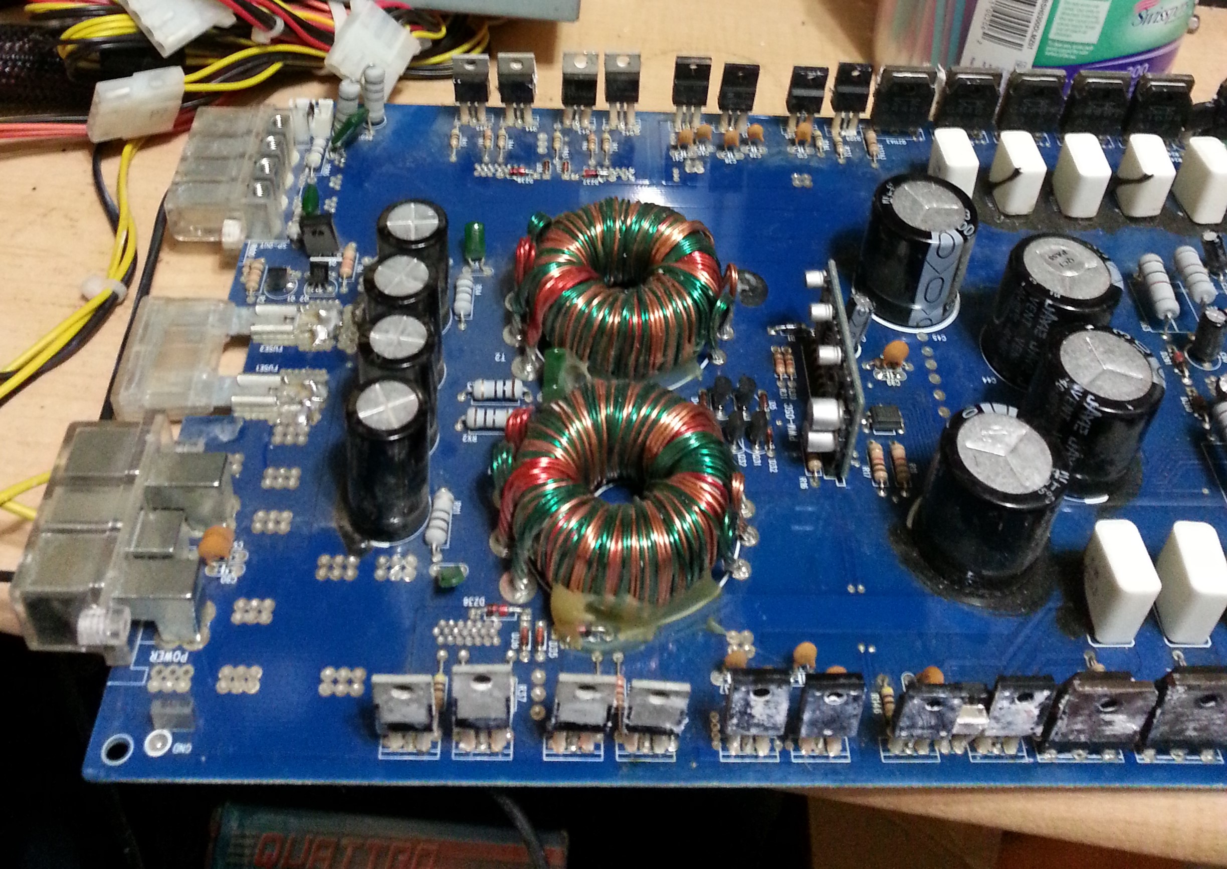

      Re: HIFONICS ZXi 1008 car amp has output on one channel only
      Here are a couple of better pictures to aid with the troubleshooting.
      Computer and Small electronics troubleshooting and repair

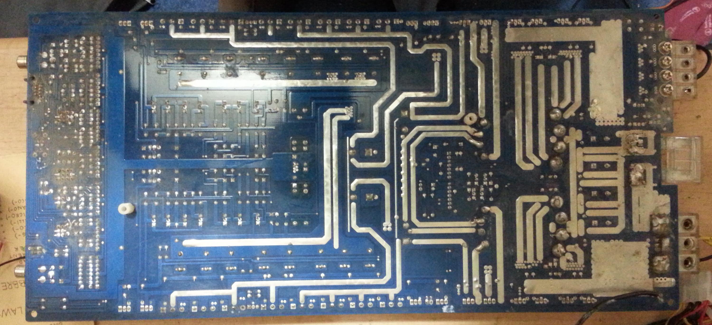

        Can we get straight shot pictures of the whole board top and the bottom side? hard to trace when pictures are in the angle and badly focused.
        If you look at your pictures and cannot read the labels or prints on the board, we cannot read them either.

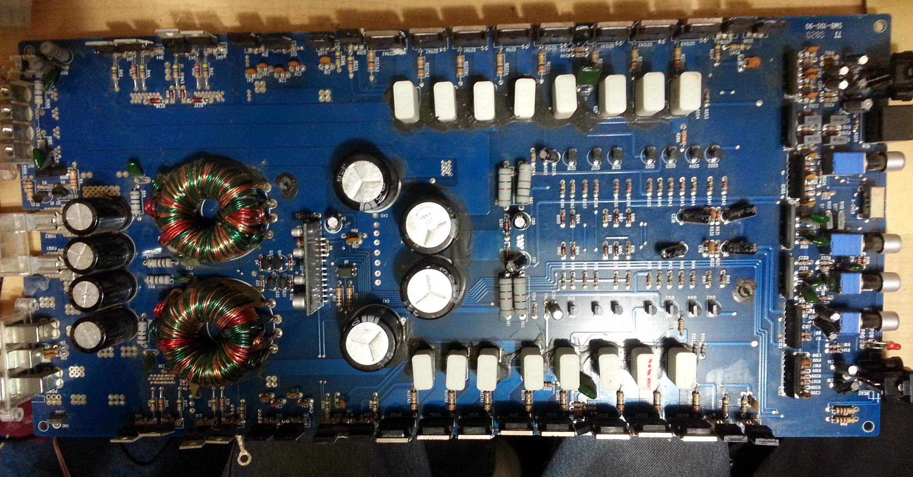

          Hopefully those are a little better if there is specific parts of the board that you want me to take a picture of please let me know. My cell camera is about 4 years old.
          Thank you for the help and being understanding with me while I work the bugs with the pictures.
          Thank you
          Tom S.
            Well the good thing about the board layout is that the designators for the components are easy to know which one for which channel, for example: R100 for channel 1 amplifier has the same value and use for the same function as R200 for Channel 2 amplifier, so you can at least do the resistance comparison reading between the power amp sections to see if if the bad channel has much difference reading than the good channel, same for the Voltage comparison readings.
            Looking at the pictures, I am not if those are dark brown glues being used on the board or not, if they are, they are corrosive (eats up trace and component leads) and conductive.
            BTW, what DCV reading do you get at the speaker terminals of each channel?
                          I have a hard time tracing the board due to the board is double sided (copper traces on both sides of the board).

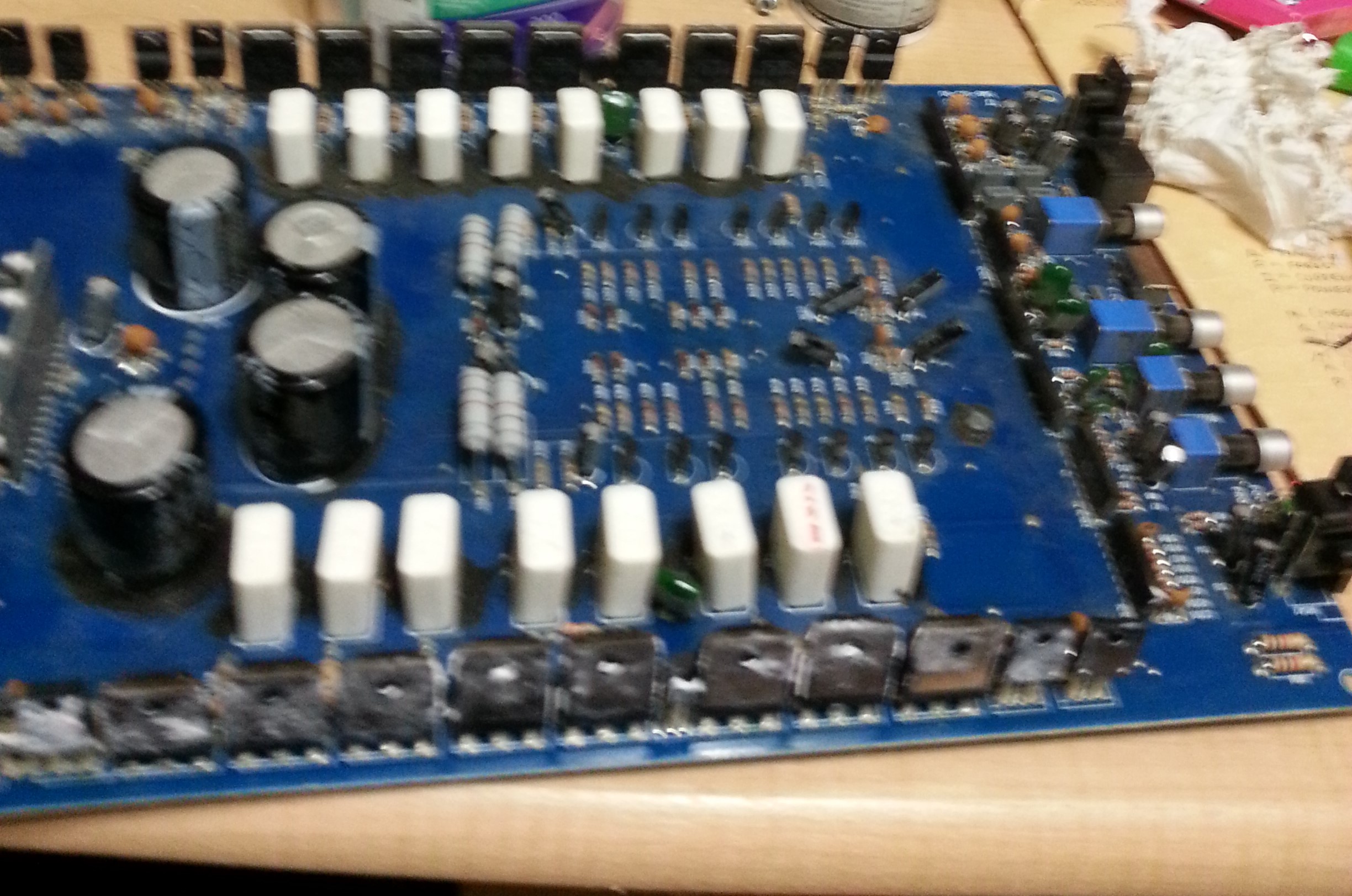

                              Amp is now in protect mode. I have removed all of the power transistors on one of the two channels, but it still has the red protect light on. What should I do now?
                              Tom

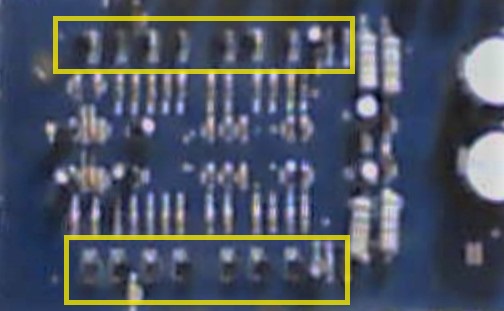

                                Amp is still in protect mode. I have removed the driver transistors, biasing transistors, and output transistors what else do I need to check? All ready verified that I Have 12V going into the transformers of the power supply and it looks like I am getting 12 volts out of it.
                                In the picture, What does the transistors do that I have highlighted?
                                  rectifiers D11, D12, D13, and D14 are removed now along with all of the power and driver transistors and amp is still in protect mode. How would I check for any voltages going into and coming out of power transformers or the power supply section of the amp. Any help in troubleshooting this would be greatly appreciated. By the way this is a class AB amp.
