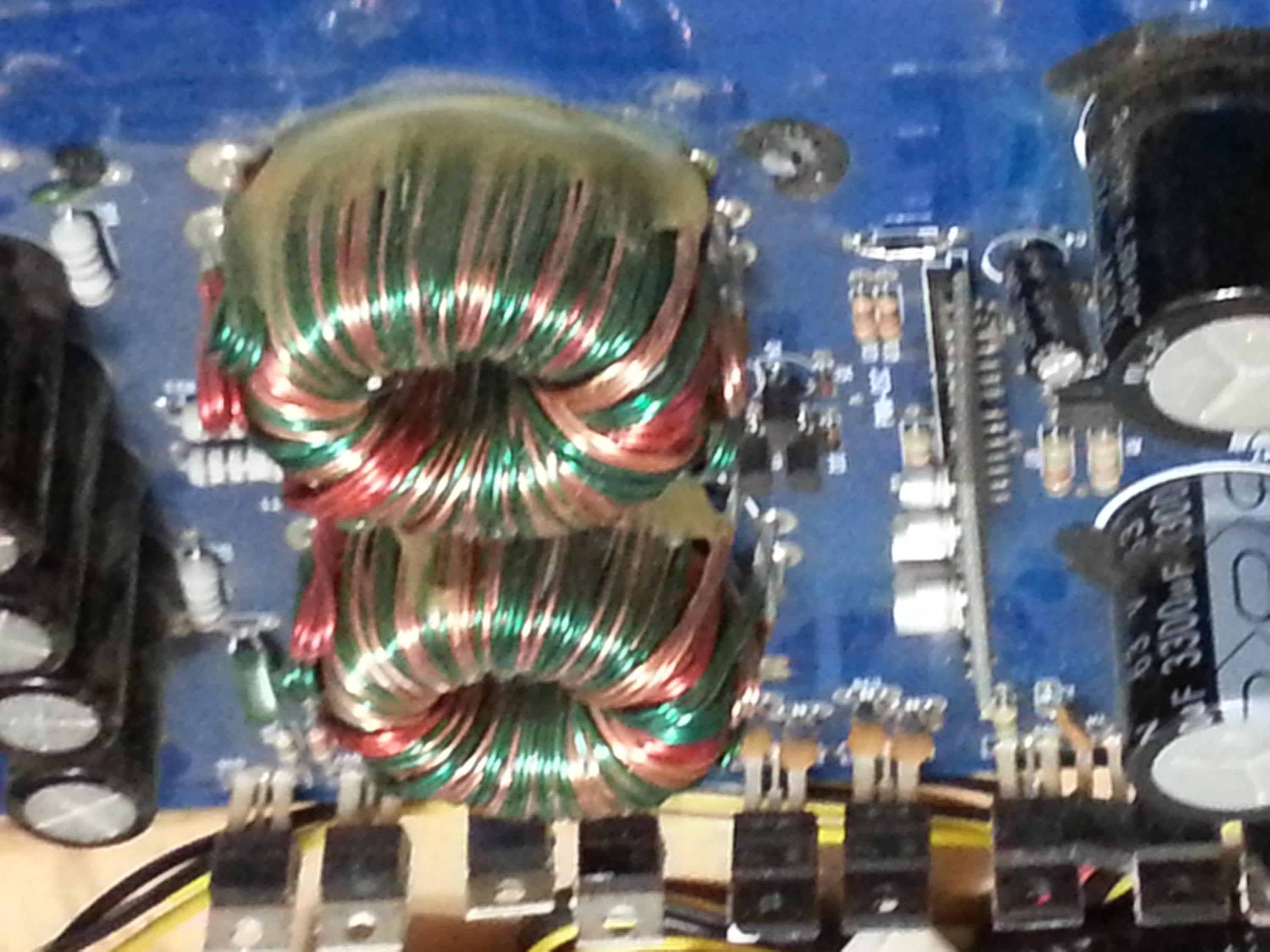

    Dear Forum Members,
    I have the above listed amp that a friend of mine dropped off for me to look at. He said that only one channel of the two had output signal to speakers. I tested the amp and found this to be the case. I don't have a schematic for this amp so I am a little at a loss here.
    Things I have checked so far:
    I Got +40, -40 volts dc on the supply rail to the output transistors which are C4467 and A1694
    The op amps are MJM4588L's. I can't find a pin out for these to tell if any of them are bad.
    If I am understanding the supply rail voltage correctly then the power supply part of the amp is functioning OK.
    Any help would be greatly appreciated.

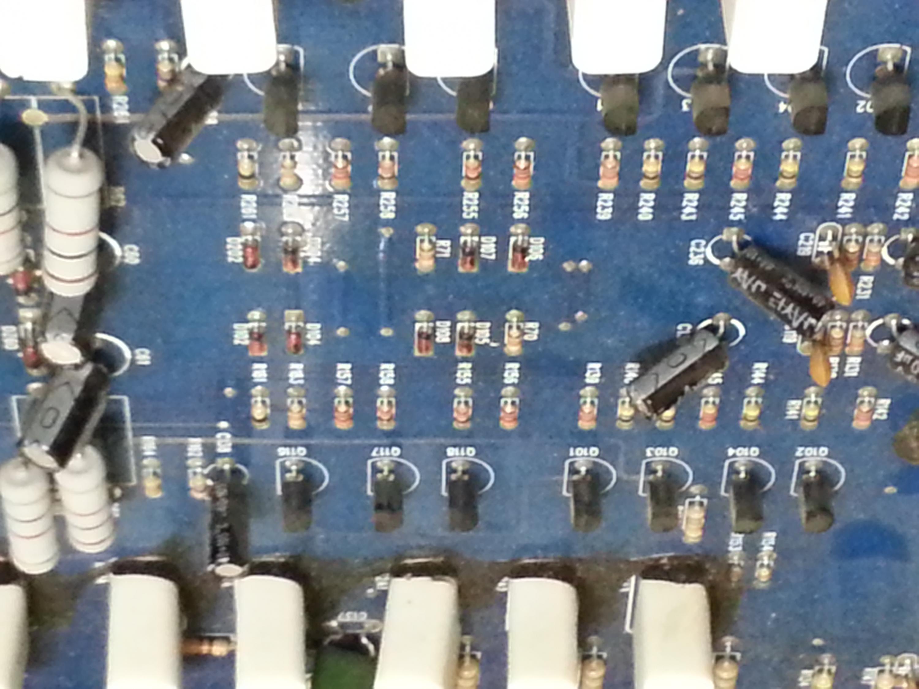

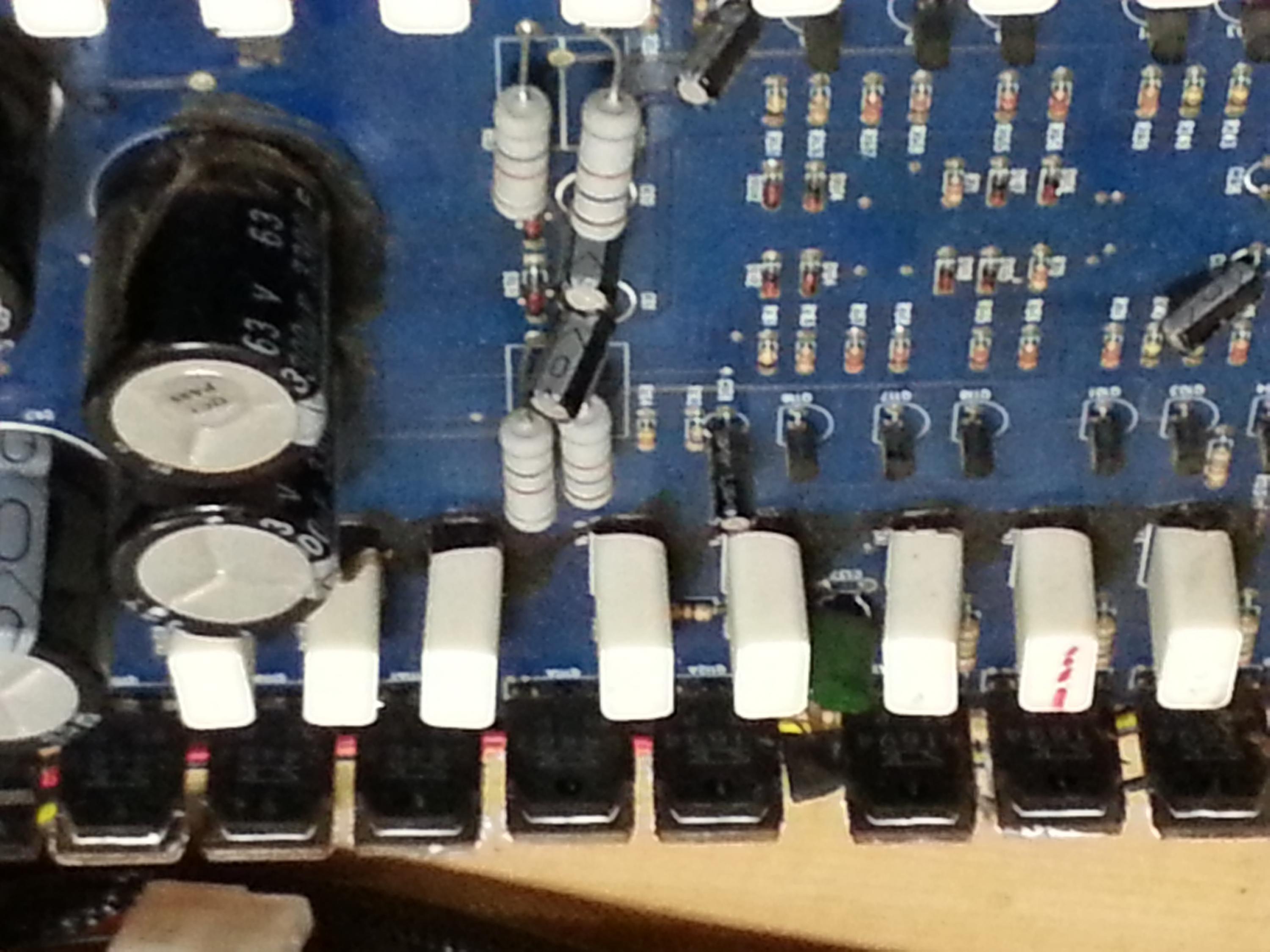

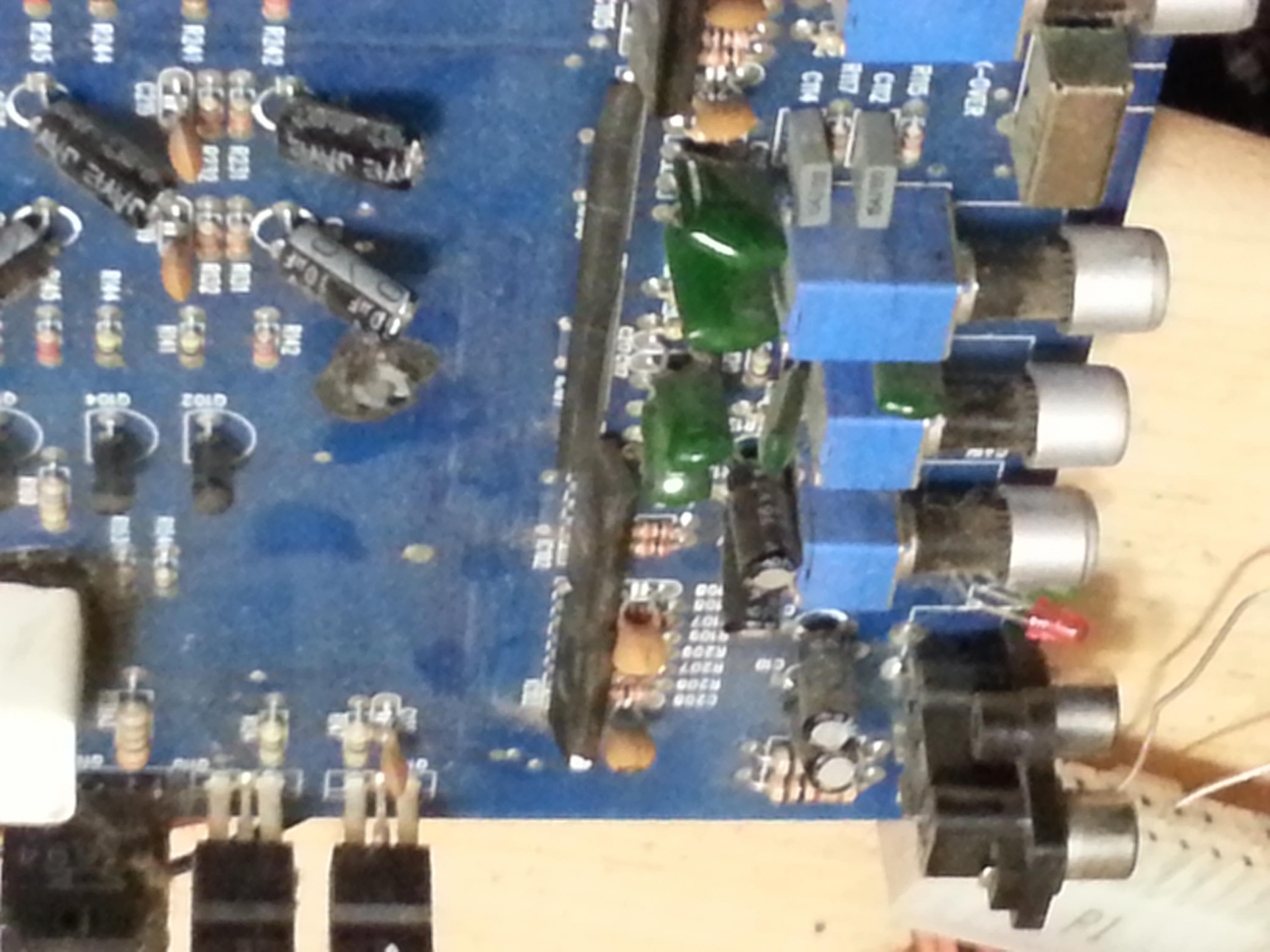

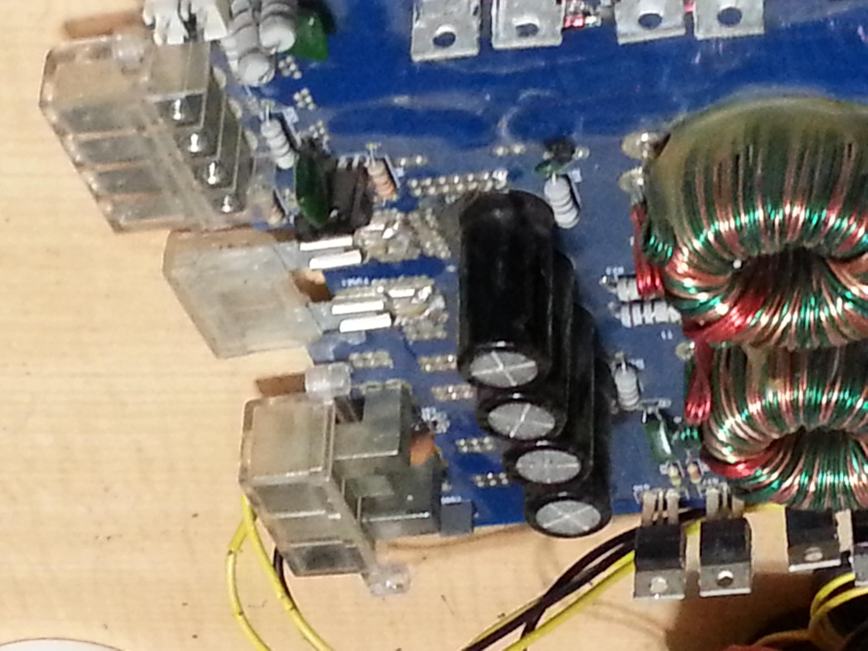

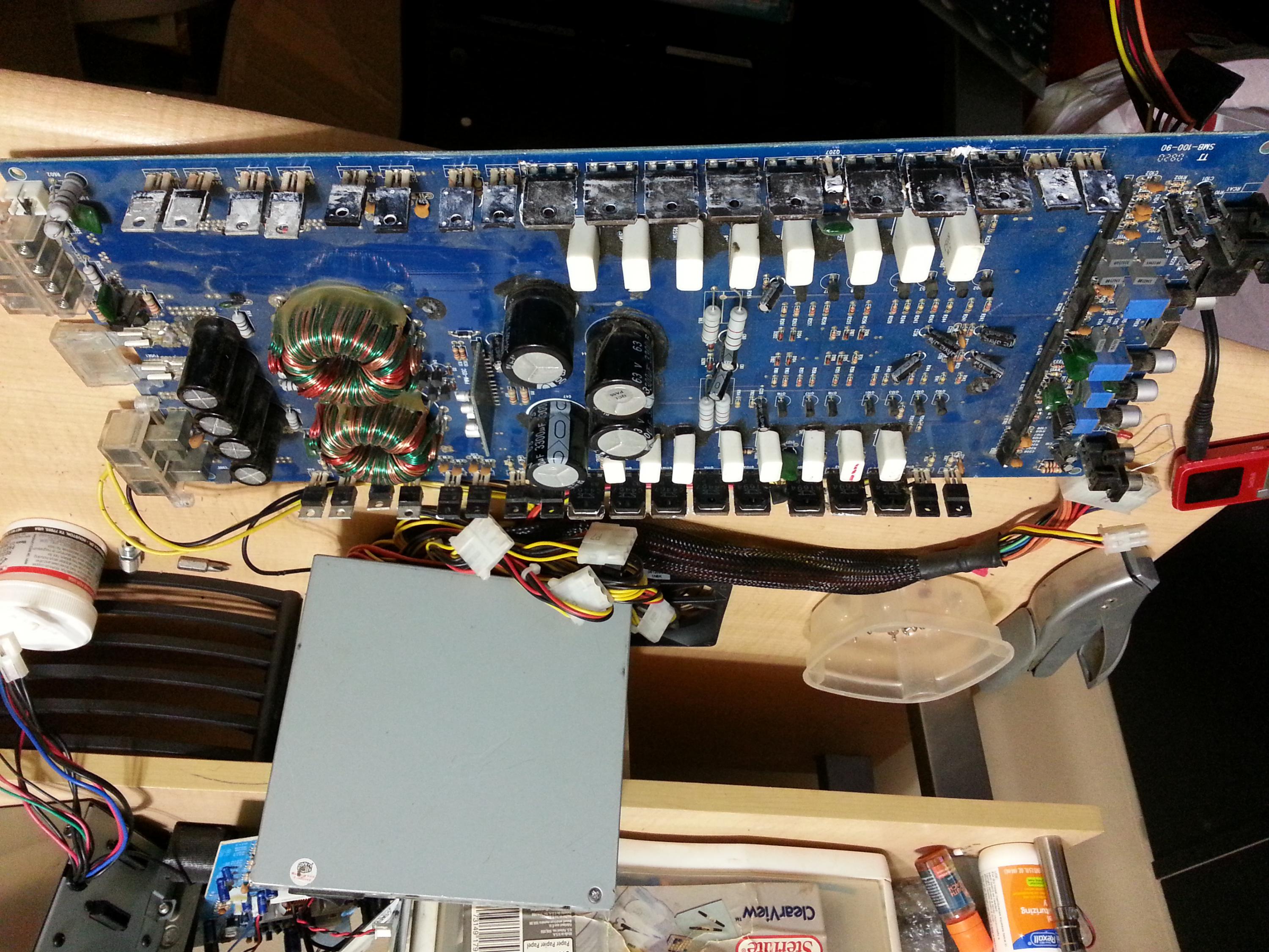

            how about some inside foto's?
            • tfs2015
              • Feb 2015
              • 135
              Re: HIFONICS ZXi 1008 car amp has output on one channel only
              Here are some photos of the component side of the board. looks like the photos got rotated 180 degrees for some reason

                    o.k. car unit - parallel output design.
                    you need to resolder all those big white resistors that burned the board,
                    you need to check all the BIG transistors for shorts between the 3 legs.
                    and you need to check all the gray resistors with a meter.
                    i assume you have a meter & know the colour codes?
                            That black stuff around the resistors is a coating of some kind
                              I can trace the audio signal out of the op amps after that I am not sure where it goes. I wish I knew how to turn my computer into an o scope so that I can see the input and output signals better. I appreciate all the help I can get to get this working for my friend.
                                    All I am able to tell is that there is rail voltage getting to them but I. Am not getting any out from them and no shorts across the legs. Could a bad ground be causing no output from the big white resistors on the board?
