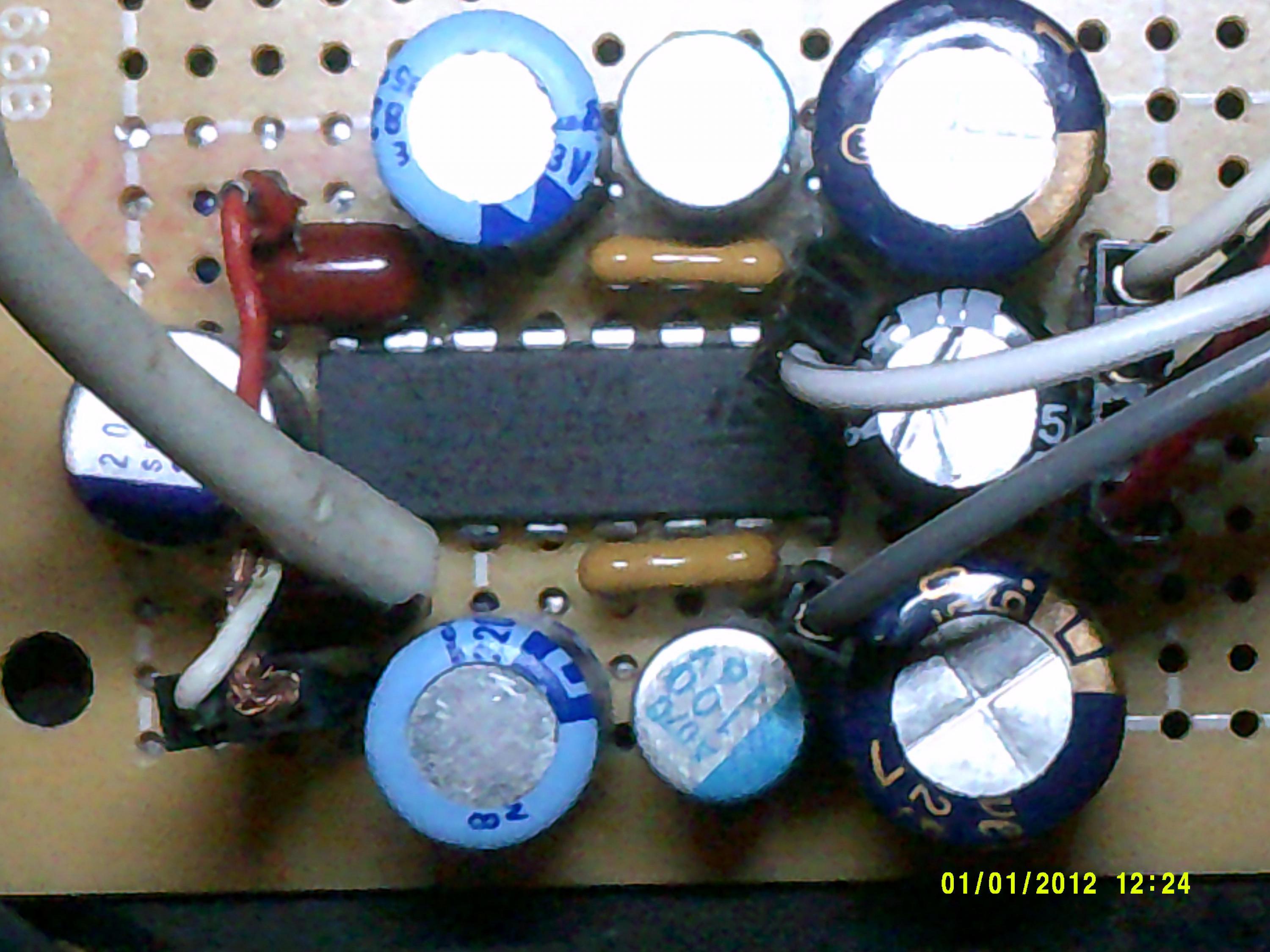

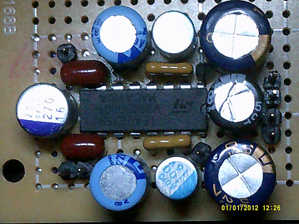

    Just [rebuilt] my small sound amp after practically ruining the layout trying to debug this issue. Normally it works 100% and performs quite admirably when connected to an external source (Old Raidmax ATX-PSU) and is clear. However, when I powered it from the power source in my desktop where it is intended to be placed there is heavy noise from the internals such as the fans.
    Basically in my setup the sound source is a YMF724 also with a TEA2025B but is bypassed for lineout instead. Breakdown as it stands...
    On-board amp:
    - No Noise from power source
    - (test) Interfaces with external TEA2025b.. no noise
    Off-board amp [external power]:
    - No noise when connected to any source [onboard/lineout]
    Off-board amp [internal power - same as source]:
    - Excessive noise.
    - Feedback from fans both power rail and ground
    - Noise remains after disconnecting input ground
    - Noise remains after disconnecting power ground (use input ground)
    - No noise when input positives are disconnected
    Off-board amp [inputs connected-same source power:
    - Noise mostly removed when a 32guage high wind inductor is placed in series... but the voltage subsequently drops from 12v to just under 3v.
    - Noise somewhat lessened with a 100ohm resistor in series. Drops voltage 0.5v
    - Diode in series does nothing to noise
    - Using an LC setup causes noise in full force again with capacitor connected to power ground.
    - Ground and inputs connected only, can hear the power noise.
    The only thing I could figure that may have some effect is using a couple input isolators but that sounds patchy at best (no pun intended). What I simply don't understand is why the same exact amp and schematic when the onboard amp doesn't exhibit this issue but when using the external amp using the same power source and schematic causes this issue.
    It cannot be an EMI issue however that I know of.. the issue doesn't exist inside the computer when connected to an external power source. It's all being sources from the supply lines.
    The amp will be getting a wakefield 650-B aluminum heatsink attached soon once it arrives. I have a wire clamp point allocated for it between two of the jointed solder grounds. The excess traces behind the inputs and ground lines are used for heatsinking purposes as well and have been augmented with flattened 24 gauge solid core wire and the centre with flattened desoldering braid in the very center.

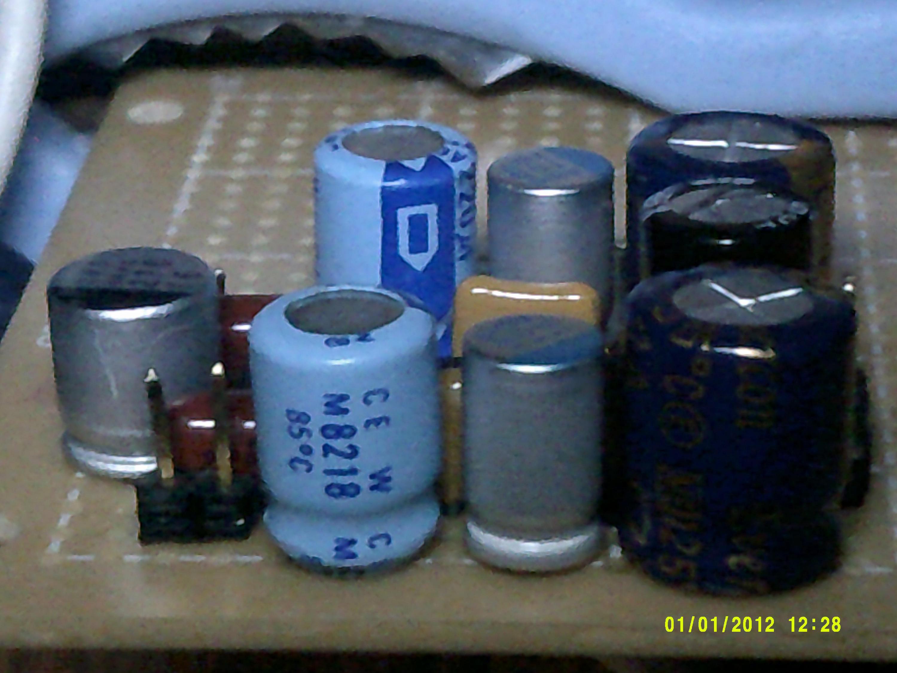

    General Info:
    Code:
    Input voltage: ~12v +/- 5%
    Output resist: 2ohm (2x 4ohm)
    CAPName    Series Temp   C/V    Location
    Evercon   ME  105c  1500uf/ 6.3v Output Decouple
    Pana/OSCon SEPC 105c  270uf/16.0v SVR
    Rubycon   CE-W  85c  220uf/ 6.3v Feedback
    Rubycon   PK   85c  680uf/16.0v Supply
    UCC(?)   A07C? 105c?  100uf/16.0v Bootstrap
    ?MLCC    X7R  ???  0.47uf/50.0v Freq.Stability
    ?Polyester ??  ???  0.22uf/??.?v DC Decouple
    Miscellaneous
    ST    TEA2025B    Class-AB  W990D0001 Malaysia
    Vishay  Resistor-1/8w MetalFilm  1%/50ppm/562ohm
    Ratshack PCB      276-168B  GeneralPurpose

    Re: TEA2025B - Heavy noise over V++
    That could be the main cause, a noisy power supply on your desktop. The rest of the symptoms mentioned pretty much points me to that PSU...
    Have you tried a pi filter? Also measure the resistance of the GND connection wires. Semi-floating ground problems can create a lot of noise...

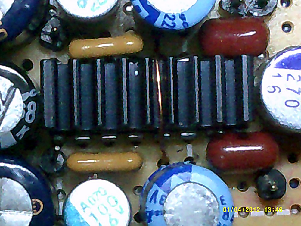

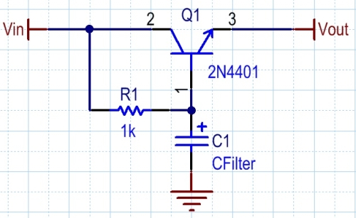

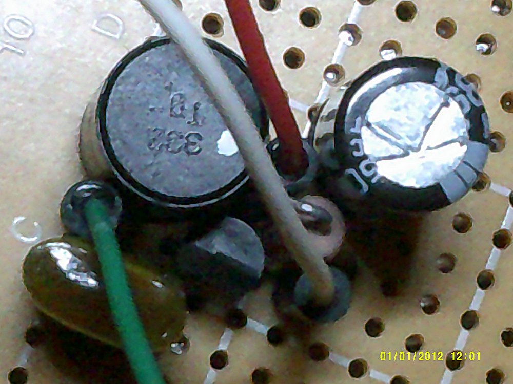

                So while I built it from bread to board... I made a couple more changes...
                -> Replaced the 15ohm resistor with a 10.5ohm enclosed ferrite inductor.
                -> Decoupled the output there with a 0.1uf molded polyester capacitor.
                -> Swapped the MJE3055T with a small TO-92 2SC1213 NPN ~500mA current. Voltage dropped a bit more from that however but its' only a test run for the moment.
                I might make a few more changes later on as I put it through the paces but it's working great thus far. In the end I'll see about reducing its' size to handle only what's needed as I will be needing it for the ST LM358N microphone amp I have wired to the 5v USB at the moment.[/quote]

                Aye, I had a braindead moment when I called it the supply cap. Which while it is a decouple it also acts as a voltage smoother/reservoir cap besides hence my going braindead.
                Ironically I was looking over the SEPF series last night while trying to ID the bootstrap caps I had. Was too late to edit in the changes though. Those were UCC PXA's without the logo on them so wasn't too far off the mark. I have been using an SEPC however on the SVR. I vowed to no longer buy any more parts for this amp however. The only exception were to get parts I wouldn't otherwise come across much if at all such as the vishay resistors and the supply decouple. The rest was purely aimed at being considered the salvage amp.. built from all used or otherwise salvaged parts save for the PCB of course.
                Though I may have to invest in a decent LDO however as all I have on hand are a bunch of mosfets and linear regulators on these half destroyed projection TV boards. Are there any that you would suggest for the task with the highest possible PSRR? Also, as one has probably noticed... I'm a bit biased and prefer products by ST whenever possible.
                (IMG1 Source: http://www.edn.com/electronics-blogs...or-noise-floor )t
                edit: After more testing I might need to revise it for sure. While the voltage output was good when idle I didn't check on load. During load with a bass test to push the heat/power draw.. the voltage is dropping out to between 5-6volts while the inductor is getting quite toasty so might need to reduce the base resistor a small bit to increase current flow and/or swap in the MJE. Seems I might end up going with a low dropout regulator soon afterall if I cannot tweak this a bit more. Then again, would reduce size using a single LDO and couple ceramics in comparison.

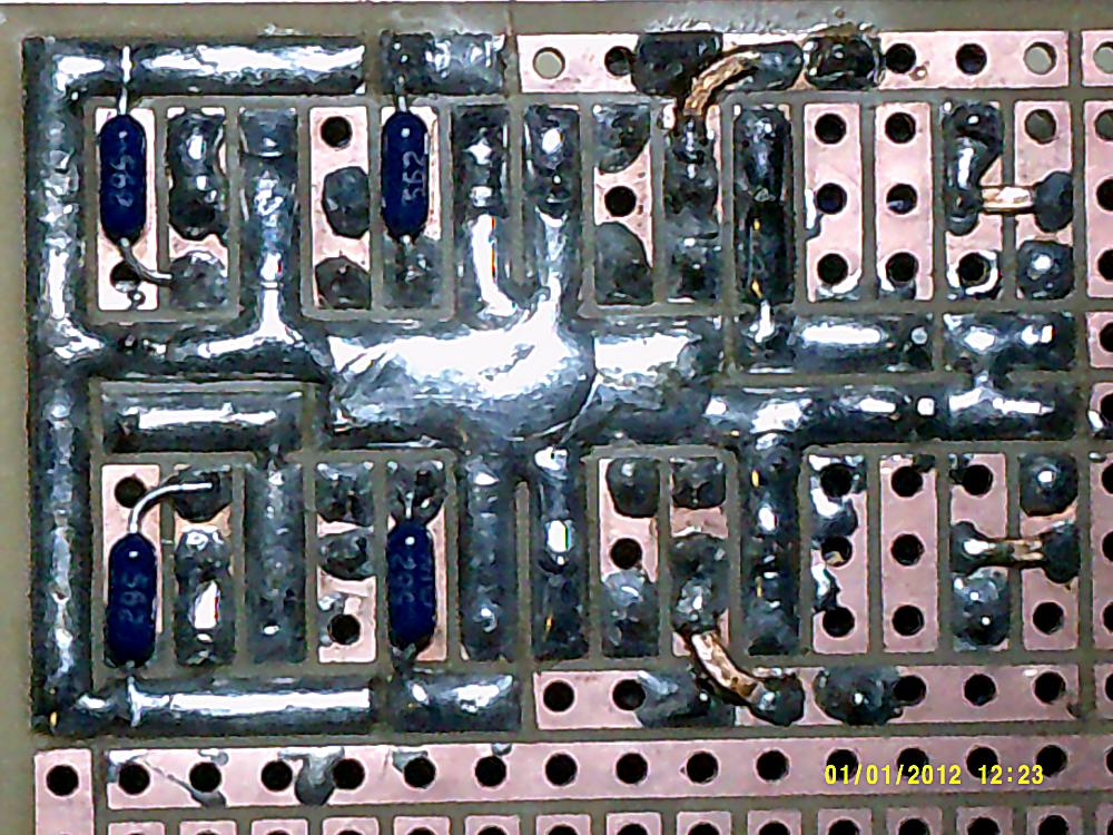

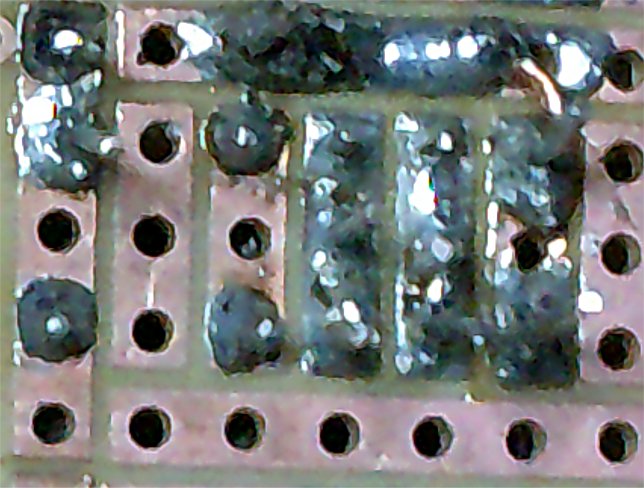

                  Did another rebuild of the noise isolator due to the issue with output and did more tinkering over the hours trying a bit of everything (also got a migraine that could down a giant). Initially tried a double-pi.. being C-L-C-L-C prior to the transistors and it made very little difference. The main reason the output was so low was due to the higher resistance to base. Downing to 1k caused far more noise in the output too.
                  Now initially, because of the noisy ground the capacitors in the CLC's were removing only a small bit of the noise. Lower ESR caps resulted in even less noise filtered through which shows higher ESR general purpose caps caused the noise reduction purely from their inherent resistance. I swapped in the bigger transistor (MJE3055T) without much change at all which shows the base current is too low still *shrug*
                  Went back to square one and started looking more into the transistors and figured that if a 2.2k resistor helped with noise but 1k let more in and provided more current there should be ways around it. Needless to say.. apparently feeding the AC noise from the Emitter output to the base with a Rubycon MBZ 16v1500uf removed a good 80% of the noise and output was higher than before. However, being NPN transistors with a common base ended up causing a small bit of clicking as if a 2 clicks/second pulse was going off.
                  It then hit me.. wait.. the ground is noisy and we're still getting noise feedback from all this so why not just the decouples to ground? I then for the heck of it tried decoupling the output to the transistor base.. and it made quite some difference. I removed the ground altogether from the filter removing the potential for a ground loop in this case and... the noise is drastically reduced now which made every capacitor but the one disconnected. Output is also up and better regulated now bottoming out around the low-end of 8volts rather than 5v on full load. Might end up returning to the idea of a pi filter after the emitter now and using the transistor base as the ground as that's working good for that purpose.
                  Then after might consider adding a third transistor (2SC1213) or try it now with just the one MJE again and see how it goes.
                  Afterthought: This is turning more into a discussion about power supply troubleshooting than anything. Perhaps I should split to another thread or just move this to the appropriate forum?

                              To update, the noise issue has been completely resolved... and took me 3 days to realize I had it right the first time. I also derped and forgot that I changed out sound cards to a different one that was causing additional feedback noise. Apparently the YMF744/754 chips are a lot more noisy than the YMF724 chipsets. The only similarity between the 744.754 I can see that would cause noise is them both using puny 0.2w amplifiers that pick up a lot of background noise. The 724 doesn't and lets you bypass the amplifier so no background noise at all. Switching back removed the extra minor background noise leftover after the noise reducer that it couldn't possibly remove otherwise.
                              The end result is a minor variation of the 'capacitance multiplier' circuit but the ground is the output instead so it is in no way isolated but rather reduces noise through base feedback. There is only a 1.1v dropout with this method as per the saturation voltage on load. Reducing the resistor more results in little to no reduction of the noise due to breaching the saturation gap.
                              May try with a lower saturation voltage transistor at another time to be able to increase voltage output more without using an LDO. it only takes 3 components being a 150ohm 1/8w resistor, 16v/270uf Polymer cap, ST MJE2055T BJT. Will look into replacing the MJE with a 1A+ TO-92 package BJT to reduce size as the 2SC1213 using this method isn't providing enough output unless I double them up.
                              Also, in reference to my previous statement about the PSU overshooting voltage... my multimeter was way off. The 9v battery needed changing as the bios and other sources show the +12v at 11.98v *shrug*

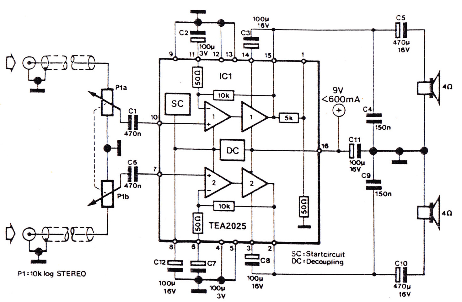

                              This is intended for powering a pair of generic 4ohm 1-way stereo speakers I found on the curb aeons ago. Built one so I won't have to use the one on the soundcard anymore and so I can use it with any other input source. I will eventually rebuild it for dual output bridges down the line however when I salvage another TEA2025B. At that point I may just integrate the noise filter onboard as well with smaller components as well without increasing size. Only so few sources of old soundcards to get them from as the original Malaysia (not China/CHN) made TEA2025's are long out of production. What bothers me though about the idea of using a TEA2025b in bridge mode in that there is no output capacitor specified to prevent flow of DC through the headphones. In this case should I be concerned or would putting a capacitor on the positive output have any negative impact on output while blocking DC?
                              I also found a pair of full -size 'MCS Series' 3-way studio speakers from back in early 80's made by JCPenny that I eventually intend to use with it too. Tested them and they work fine aside from what sounds like one of the braces inside broken off as shifting one of the speakers causes rattle. Chassis is made from particle board while the front mesh is molded to it and not removable. Must have been on of the cheapest bottom line speakers of their series.
                              The output voltage is normally 1/2 VCC but the gain is adjustable with a resistor in RC Series from the feedback pins to ground. I actually cannot understand the math behind figuring out the actual gain after adding a resistor or the cutoff of changing the capacitor. According to specs it shows R=0, C=100uf for 46db/32hz cutoff yet in my case I used R=562, C=220 to reduce gain and lower the cutoff point for low frequency so as to increase the bass response as well. I'd love if anyone can help me figure the gain/cutoff point result.

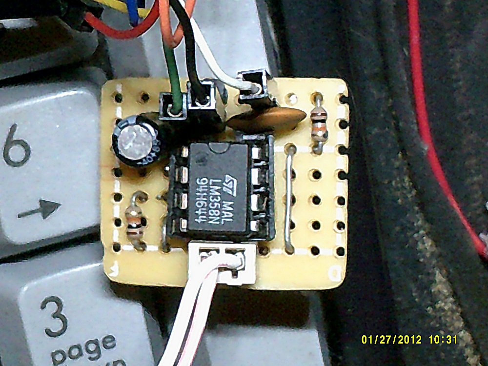

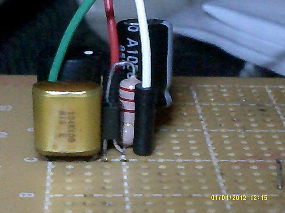

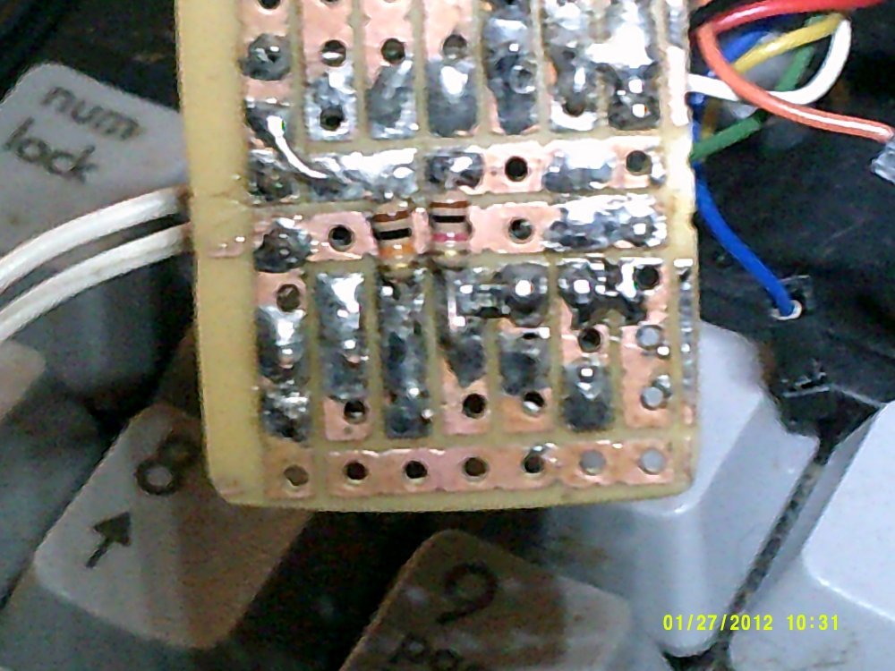

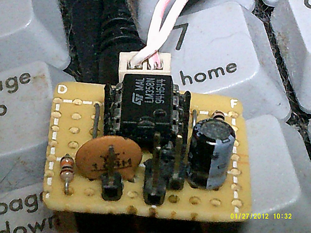

                              I did however build a microphone amp with a tiny footprint based on an ST LM358N that I salvaged from a thermistor based fan speed controller in old power supply years ago. Still does the job quite well.. can't say the same for the controller I salvaged it from though as the transistors on it could burn someone from touch.

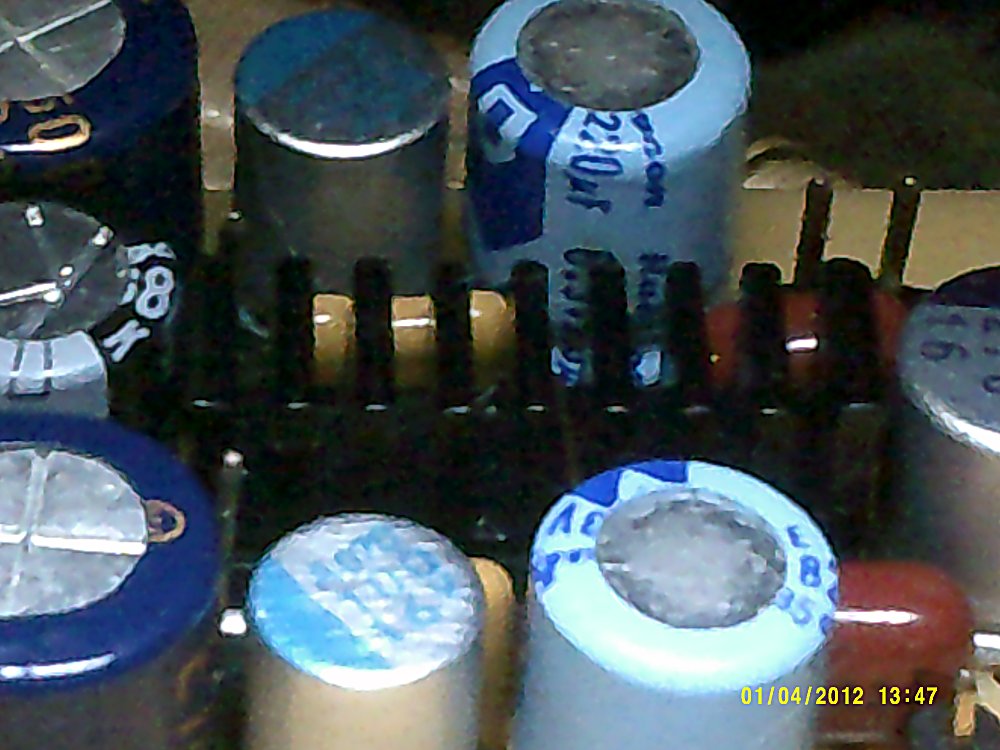

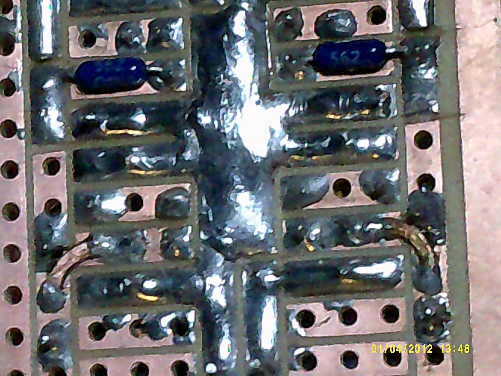

                              Added attachments regarding the MicAmp mentioned. Also showing the final results of the amp with heatsink. Heatsink is mounted with a thin layer of ArcticSilver5 Thermal paste and fastened down tight with copper wire soldered down to the two outward ground traces closest to the resistors. This will also indirectly assist in more effective heatsinking along the ground traces and mounting wire accordingly. Solder work isn't the best considering the generic general purpose PCB from radioshack but the best I can get for the final build on the TEA2025. Had to be extra generous on cleaning up the PCB with 91% Isopropyl Alcohol, Swabs, and a Toothpick considering my flux is Zinc Chloride and made from the early 19th century, using silver bearing solder without a flux/rosin core. Had to use a microfine soldering tip made for a generic 20/25w iron fitted into a 30w and a blunted pencil-tip for the bulk work on flowing the ground traces.
                              EDIT: Interesting side note... I think I've built the smallest over-spec TEA2025b based amp despite far wider capacitors and no SMD's compared to the Chinese made tea2025b amps that meet or underspec the capacitors one finds all over Alibaba/Aliexpress, etc. If one wanted to the whole built with heatsink could be reduced down to 10.5mm height with lower height caps only sacrificing capacitance on the output and power decoupler. *scoff* Watch them steal the build and resell it next...

                              2) [IMG] ST-LM358N MicAmp Top
                              3) [IMG] ST-LM358N MicAmp Quarter
                              4) [IMG] ST-LM358N MicAmp Bottom
                              5) [IMG] ST-TEA2025b Top w/ Wakefield 650b Heatsink
                              6) [IMG] ST-TEA2025b Quarter w/ Wakefield 650b Heatsink
                              7) [IMG] ST-TEA2025b Bottom w/ Wakefield 650b Heatsink
