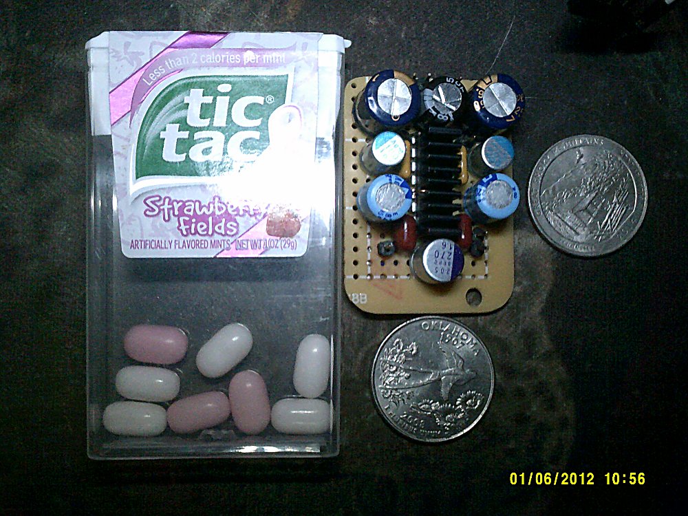

          Edit: Got the bugger cut out and cleaned up. Quarter and TicTac container for scale. Though it's so small one can make a tic-tac amp with it. Heck, it would fit an altoid's smalls tin no prob for that matter while using a couple small superflat capacitors in it for power such as a pair of the Maxwell flat 10F caps or the even smaller 1-2 Farad ones.
            That is neat!
