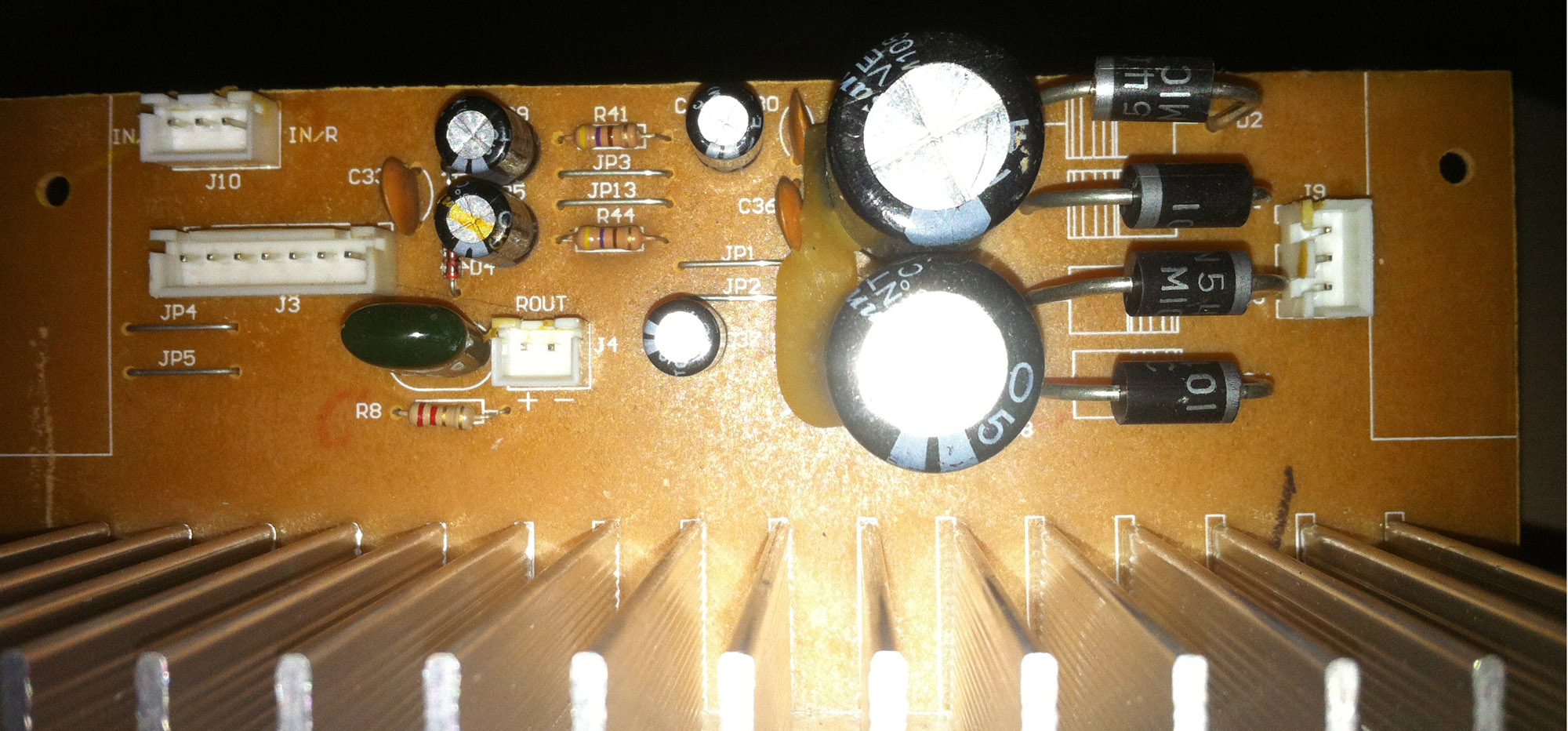

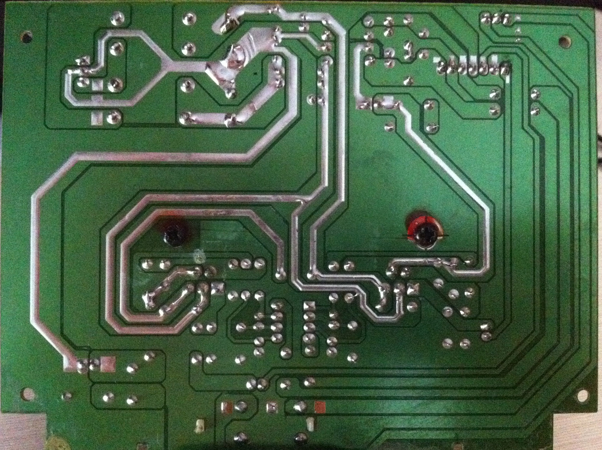

    Hi all. First post in this section
    My home speakers died recently.
    First of all here are the specs from the official website
    What's going on?
    Well, one morning i turned on the speakers and there was a incredibly loud buzzing sound. Constant, deep and vibrating. Almost exactly the same as when you touch metal part of the computer case with the audio jack, but way louder.
    I tried everything... Unplugging speakers from computer, changing cable, unplugging left speaker from the right (problem is in the right and main one), problem stays. As soon as it gets the power it starts with the noise and that's it.
    So... I unscrewed it, and took some photos of the board for starters

    What are mounted on that heat sink? Transistors? need pictures of the whole board, top side.

      Re: Genius SP-HF1250X - 2.0 speakers
      I don't kknow what these are, but here's the pic attached

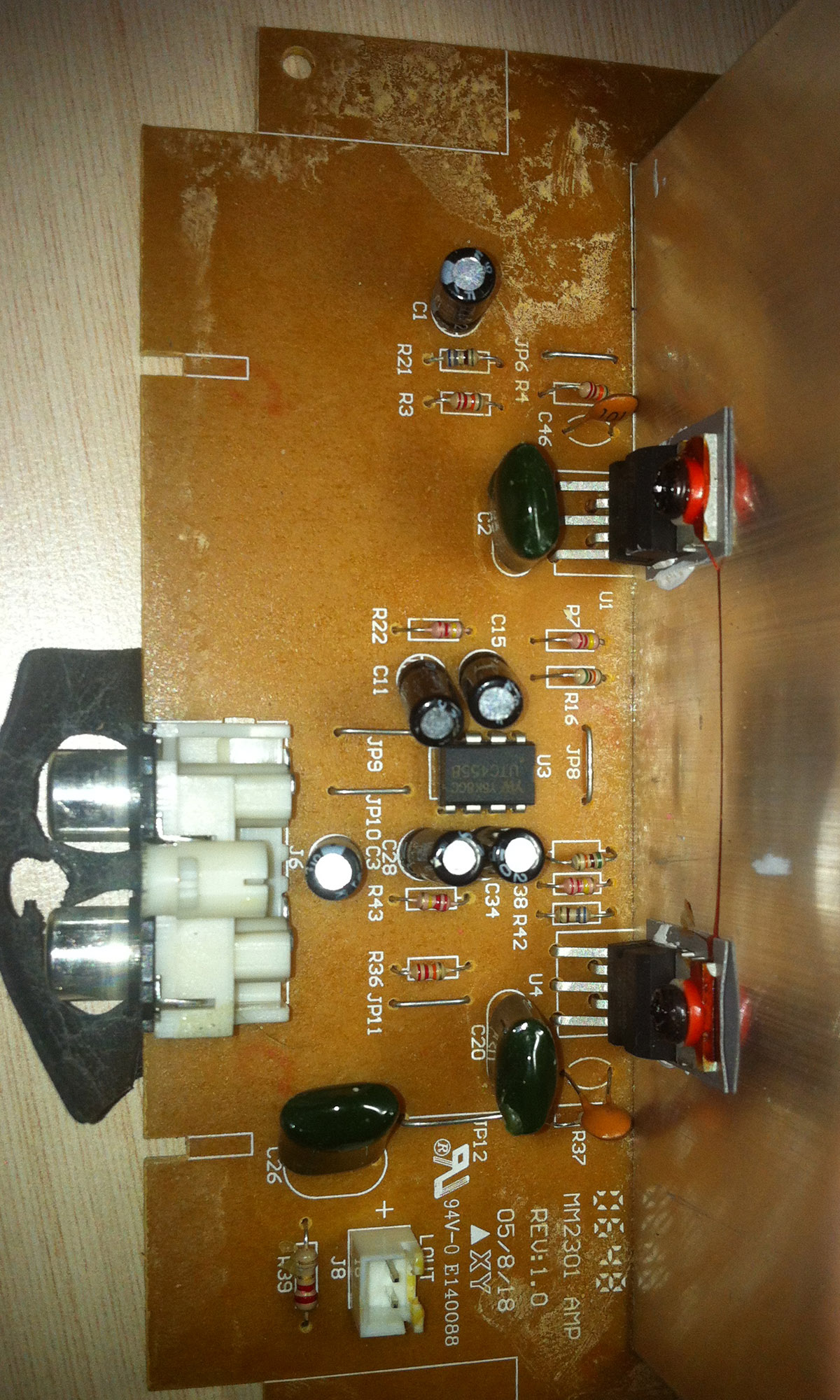

        first two pictures are topside of the board. 1st is above the heatsink, and the second one is below.
        But I'll make one whole, just to get my camera. Iphone camera will not do. Flash messes everything up

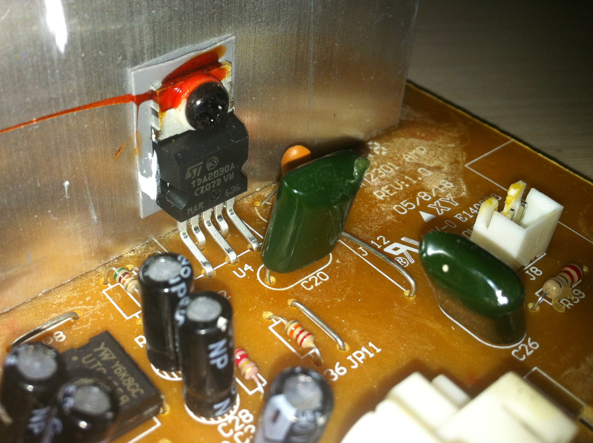

          That is the power amplifier IC TDA2030, there should be two of them for 2 channels.
          The 8-pin IC is more likely to be dual-op amp (generic 4558 IC) for the preamplifiers to drive the power amps which drive the speakers.
          The noise is from both speakers?
            Yes, there is two of them, sharing the same heatsink. 8pin IC indeed is 4558.
                            well, i replaced both power amps, and all the smaller caps (9 of them, 2 types). Results - tonight

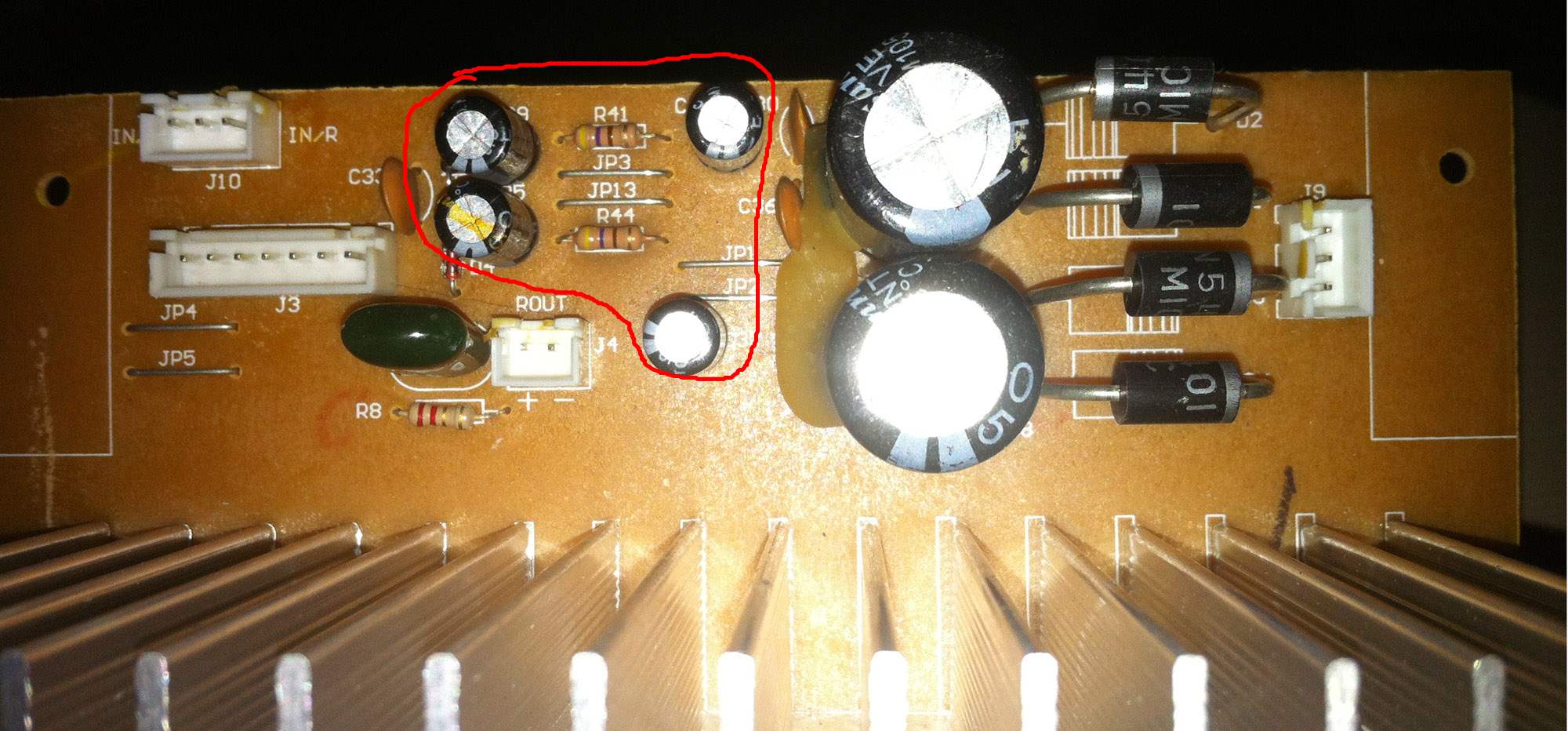

                                    On a side note, did you replace these caps did you?
                                    They are used in the voltage regulator for the LM4558.

                                      As for the second post, yes, I replaced those 4 caps after I changed the LM4558.

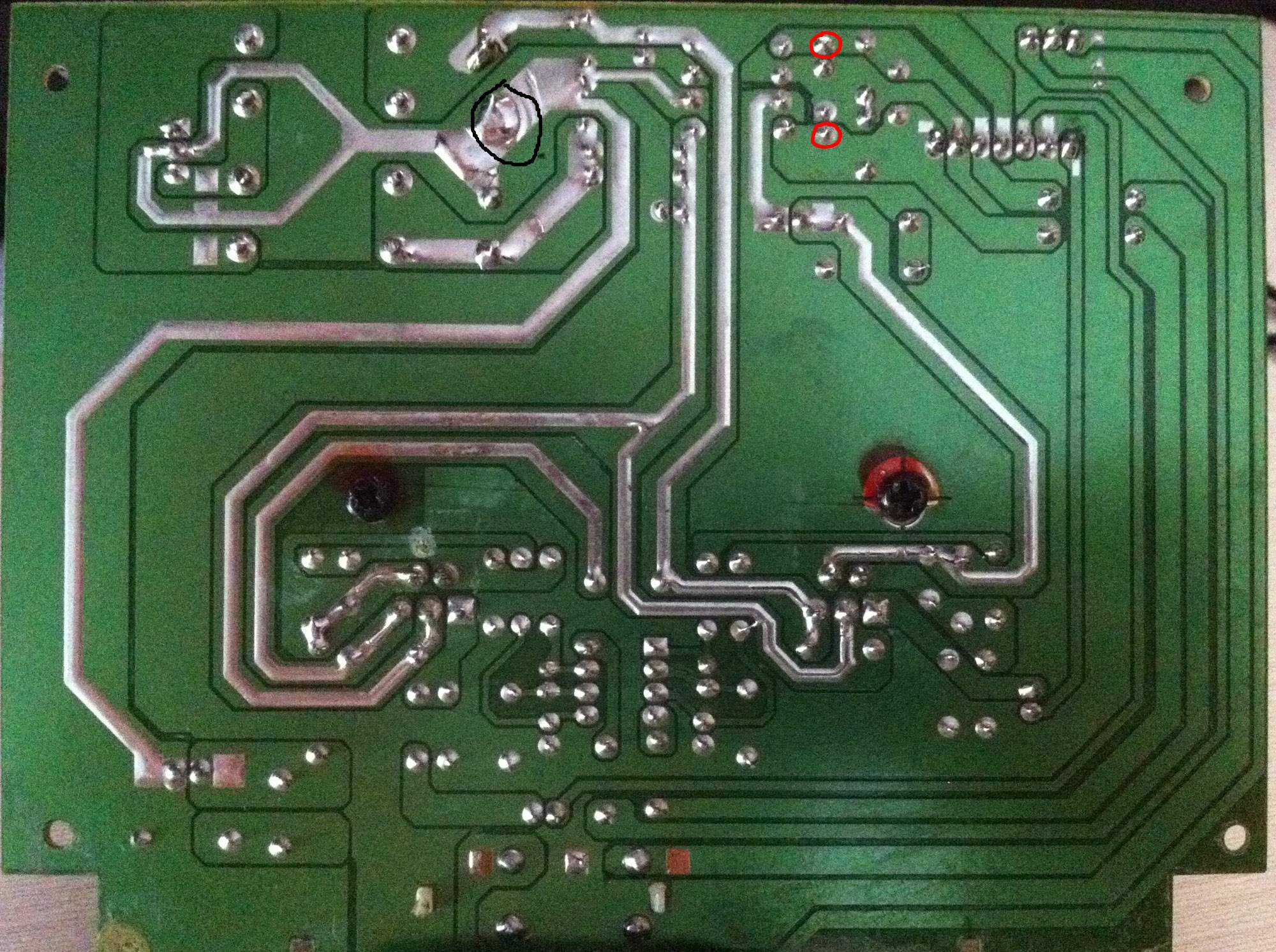

                                        Do you have visual access to the speakers? If so, when you first plug them in, does the speaker cone suck in, and buzz? or does it push out? If they do one of those, unplug them immediately because there is DC voltage being fed to the speakers, and they wont do well with that!
                                        Ok, do you have a multimeter?
                                        If so, put your black probe where the black circle is, and measure each spot marked in red with the red probe. One should measure anywhere from 15v to 5v, and the other should measure anywhere from -15v to -5v. Please report back the readings.
                                        Muh-soggy-knee
