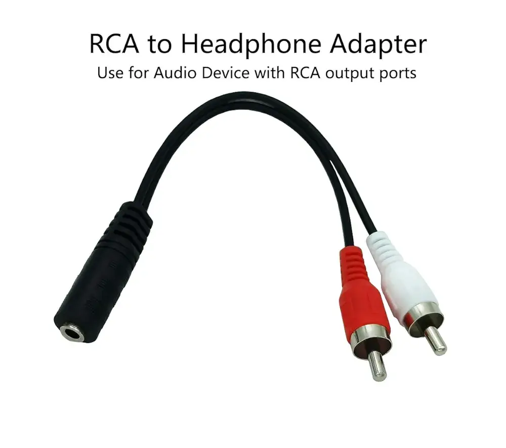

    Currently trying to connect pc speakers to 2015 vizio tv, tv has no 3.5 headphone jack. Does have rca audio out, tried connecting thru a Y rca to 3.5 cable but getting odd results(probably just need a dac for decent audio, not sure?) not too educated on audio. With that hookup I'm getting 2 problems, can't get the speakers to increase in volume so it's very low even when turned up and when using both tv and pc speakers the pc speakers only put out the music part of the broadcast and not the vocals/talk of the program. Have you run into this before or know what it might be, Thanks.

    Sorry bout that, should have mentioned that I'm trying with this adapter, it has the red, white and yellow rca to 3.5. I was probably wrong thinking I could just use the red and white to make it work?: https://www.amazon.com/Auxiliary-Ste...09VK9VP31?th=1
    That depends how your adapter is wired
    It can be either
    Tip - audio L (white)
    Ring1 - audio R (red)
    Ring2 - video (yellow)
    Sleeve - GND
    Or
    Ring2 - GND
    Sleeve - video (yellow)
    Can't trust this type of adapter/cable without measuring with multimeter, same issue with old camcorders and some other devices which use a similar cable (4 pole 3.5mm to 3 RCA), depends on manufacturer which pinout they used...
    You can try thIS, short the tip and sleeve on the yellow RCA plug with a piece of wire , that way you're getting the GND connected
    This type of adapter should work

      Tried with tv speakers set to on and off also with speakers set to both fixed and variable, same results.

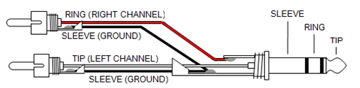

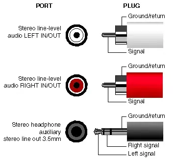

                There's also S/PDIF Digital Optical audio to analog RCA converters, plenty available on Amazon/ebay, if your TV has optical audio output
                Assuming your PC speakers are powered either by USB or mains power (have an internal amplifier, with a volume control) the RCA to 3.5mm adapter should have worked
                You may hear a similar effect to what you describe if for some reason the GND is not making proper contact (only the L and R signals), the wire is internally broken, or when the 3.5mm plug is not fully inserted into the jack
                Check the wiring on your adapter with multimeter, or make your own, like this:

                        I checked continuity, here's what I have, not sure the terms so I'll call the tip 1 and the next 2 and 3 and 4: so tip-inside white: 2-inside yellow: 3-red, white, yellow: 4-inside red. I had red and white thinking that yellow was for video but might be wrong. You think it would blow something if I tried different combos like yellow and red or yellow and white? Thanks.

                          Going to try the short now.

                            To add to the confusion, more pinouts, all incompatible with each other
                            https://pinoutguide.com/Audio-Video-...k_pinout.shtml
                            Assuming tip is 1, then your cable is wired as Sony/Panasonic pinout from that list, so tip is white, 2 is yellow, 3 is GND, 4 is red
                            Use the yellow RCA plug as your right audio channel (red), then short the red RCA plug from that adapter
                            More examples of the confusing non standard pinouts
                            https://pinoutguide.com/Audio-Video-...t_pinout.shtml
                            https://pinoutguide.com/HeadsetsHead...i_pinout.shtml
                            This video explains it: https://www.youtube.com/watch?v=nUcx_RrRS7U
                            Best to make your own adapter with a 3 pole 3.5mm jack, or buy the appropriate one

                              THANK YOU SIR, you are right on, shorting tip and sleeve of yellow/inside to outside did the trick.
