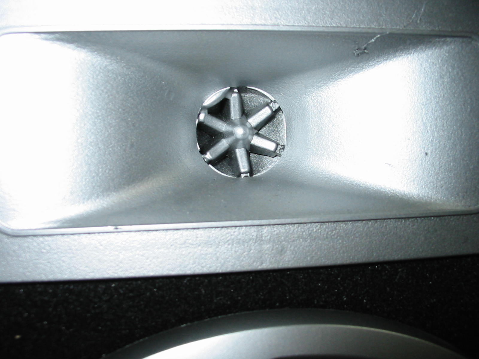

    First, I want to make note of the extremely high quality “horn” driver:
    https://www.badcaps.net/forum/attach...1&d=1552012822
    It's top-notch really. Never mind the paint / hot glue drip.

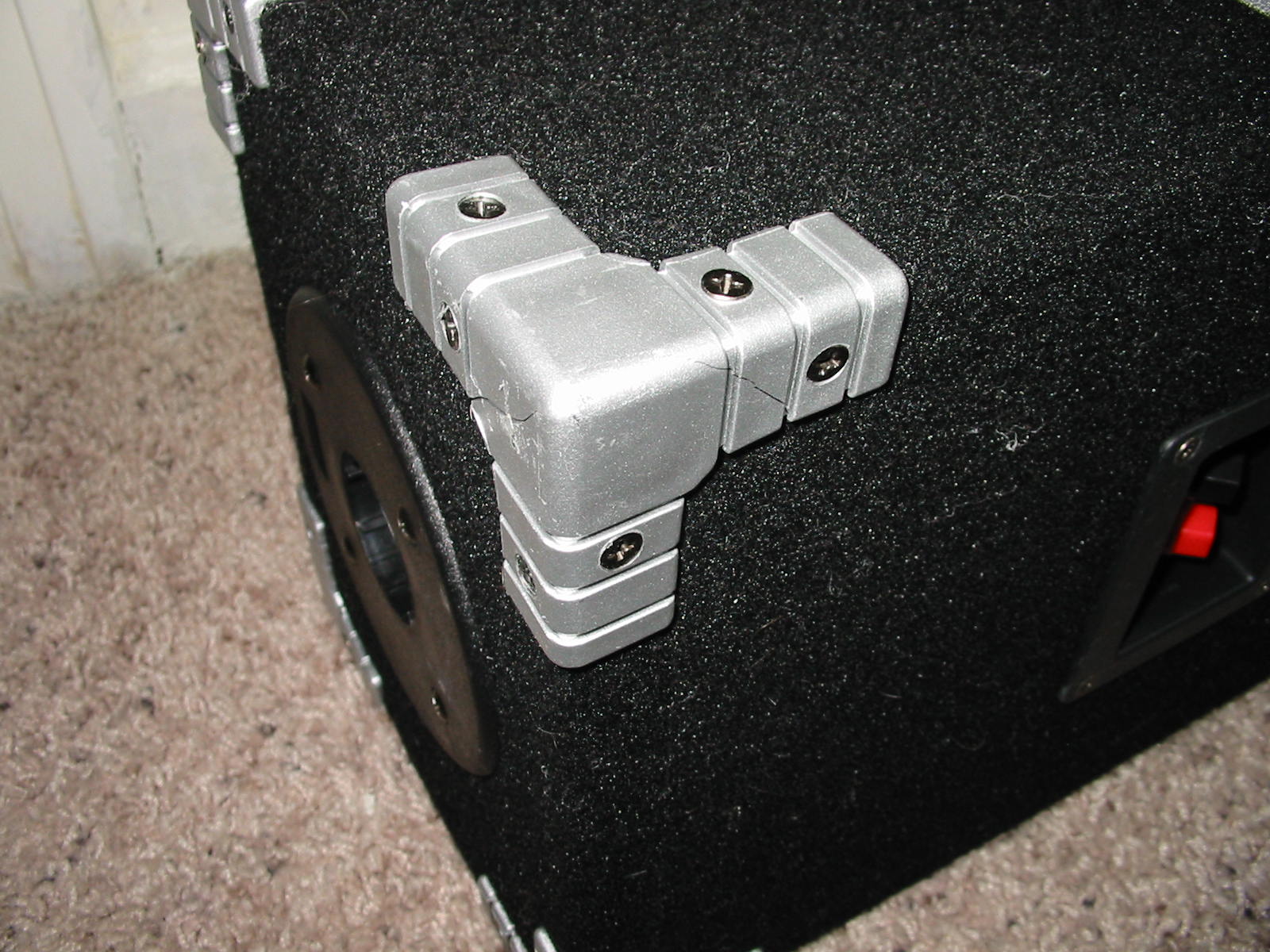

    Those edge protectors also look super-tough…
    … just like the “Powder-Coated Steel Grille” (read: cheap cruddy plastic… probably the same as the edge “protectors”.)

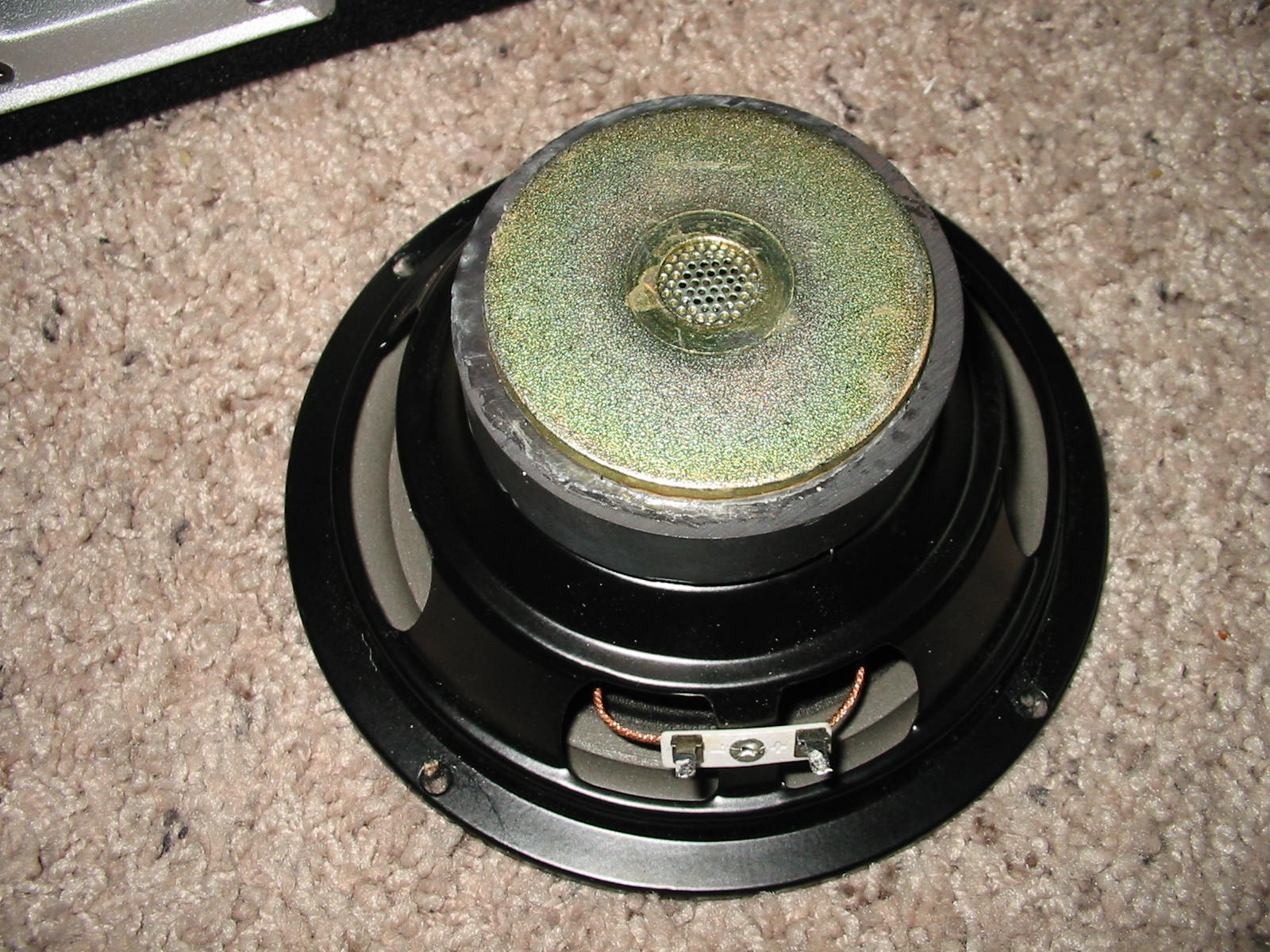

    But let's look at the most important detail: the speaker drivers!
    Oh, what a mighty-big magnet that 6.5” driver has! It's almost 3 & 1/8 inches (8 cm) in diameter and ¾ inches (19 mm) thick (actually, that wouldn't have been so terrible if this was a mid-range driver only.) 300 W RMS? – No problems! Just bring marshmallows too!

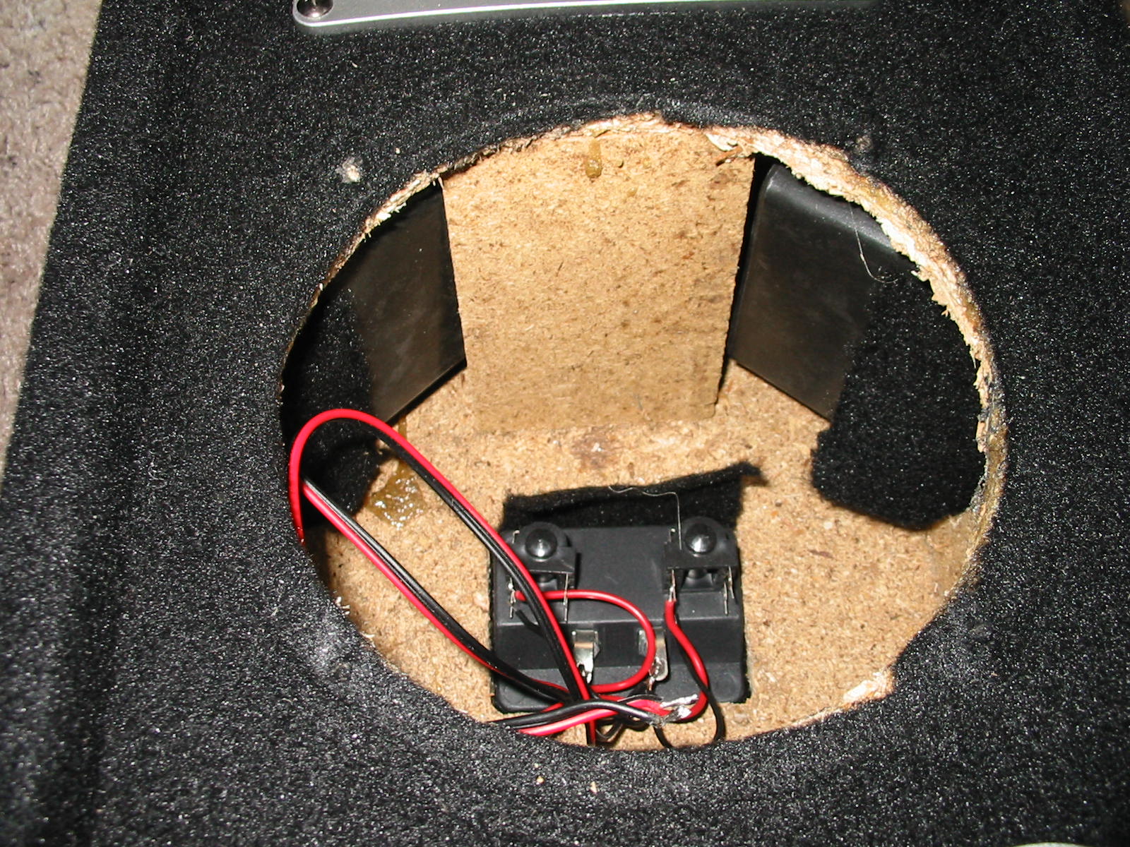

    And of course, such a mighty speaker driver shall only be housed in an equally matching sturdy enclosure – extra reinforced and built from the toughest wood particle board ever manufactured. (Note: give extra emphasis on the word “particle” here. )

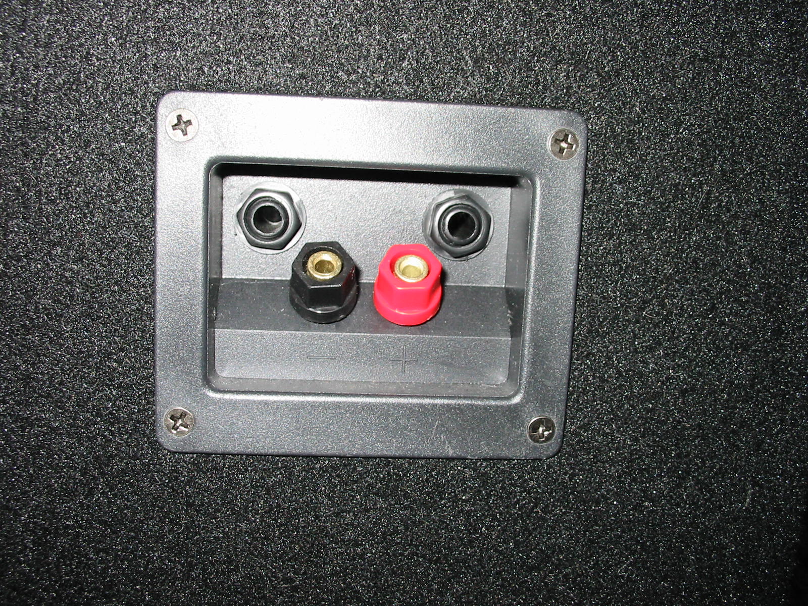

    Even the speaker inputs look very well-made:
    Yes, durable plastic nuts are durable.

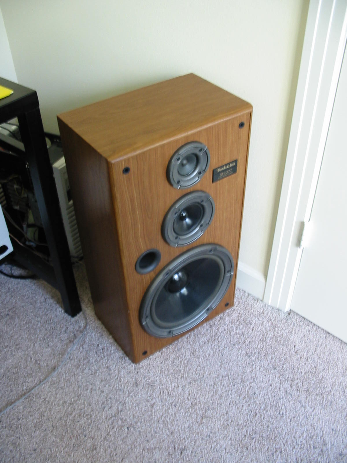

    On a small tangent… the build and sound quality of the SB-CR77 speakers was pretty decent. While my roommate was moving in the summer, he asked me if I could keep them for him for a few weeks, along with a few of his other moving boxes, until he got a key to his new apartment. That's when I had time to test them… and snap a few pictures. So there's that:
    https://www.badcaps.net/forum/attach...1&d=1552014159
    The SB-CR77 is a typical average 3-way system with a 12” woofer. The woofer driver looked a bit cheap (and probably didn't have a very big magnet, much like most average mid-fi speakers), but it managed to pump decent lows, down to 35-40 Hz easily without much roll-off. And compared to the Acoustic Audio speakers… there's not even a comparison possible.

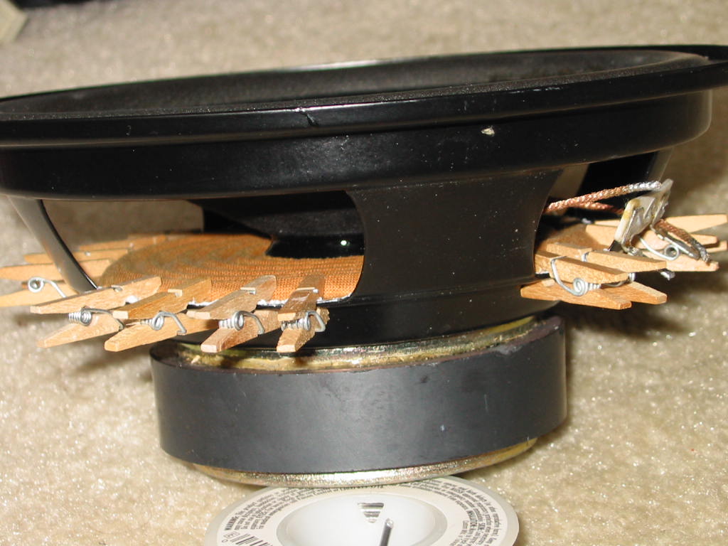

    The first step in that process, as with any VC (voice-coil) driver repair, is removing the cone. One would think these crappy GX-400 drivers would be easy to take apart, because they are cheap - but nooo! If anything, the manufacturer of the drivers used a colorless, rubber-like glue that is actually very similar to the “snotty” adhesive found on some padded mail envelopes. It was impossible to pry/separate it without ripping out the foam edge surround. However, I found out that if I heat the metal parts of the driver basket from underneath to higher than 60-70°C, the glue would soften and come apart – at least until it cooled down again. It was a pain to do all that, though! (Literally, as I burned my hands so many times while heating the basket with my heat gun.) It took a lot of effort to pry the edge surround without damage, and I didn't really want to damage the old surround, because… let's just say there was no way in hell I'd consider investing any more money into new parts (surrounds) for these crappy speakers.

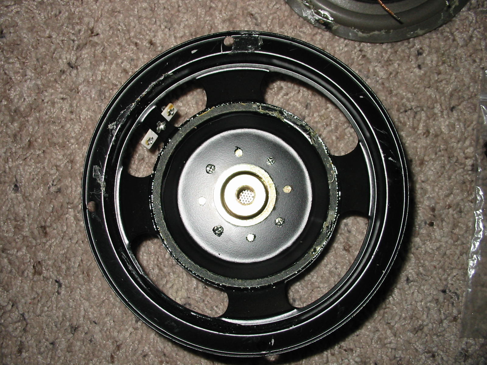

    Anyways, here is what the speaker basket looked like with the cone removed:
    https://www.badcaps.net/forum/attach...1&d=1552014685

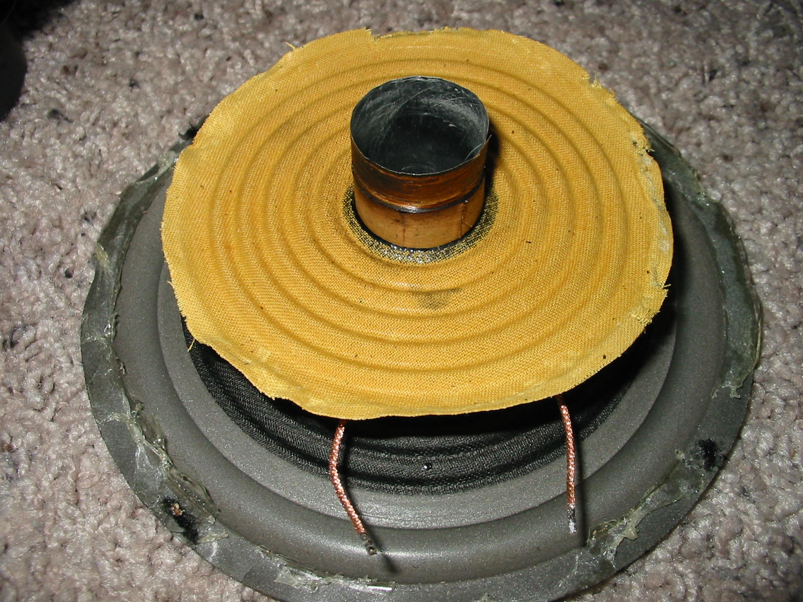

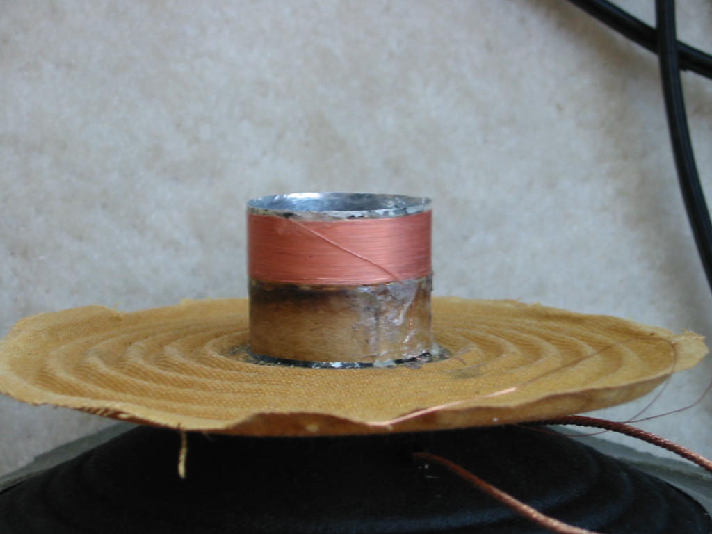

    And here is the cone:
    Wire on the VC is gone because most of it was loose and stuck in the gap. I did manage to get it out and the gap clean, though. As you can see, we are dealing with a 1” (2.54 cm) diameter voice coil speaker here that has… what, 10-12 mm –long coil? The day I see a regular voice coil like that handle 300 Watts RMS without becoming a fire ball , I'd say humans have finally discovered a way to go beyond the physical laws of our universe.
    As I wanted to match the original VC, I looked at the burned wire to get an idea for the thickness. It was quite thin though (not sure what size/gauge, as I didn't have any way to measure it.) Luckily, however, I did have a spool of very thin wire (also of unlabeled size/gauge) that looked similar in thickness. So I rewound the voice coil with that. Here is the first attempt:

    Because I was pretty sure I would eventually need to re-do this VC, I decided to do things “the quick way” and resorted to using hot glue to hold both the spider and the speaker surround to the basket. ( I know.) Surprisingly, it looked OK!
    But as you might imagine, hot glue is NOT a good idea, as it doesn't really stick well to metal surfaces (especially steel). Thus, the speaker ended up making a bit of mechanical noise at “stronger” bass notes. For my testing purposes, however, it still worked OK.

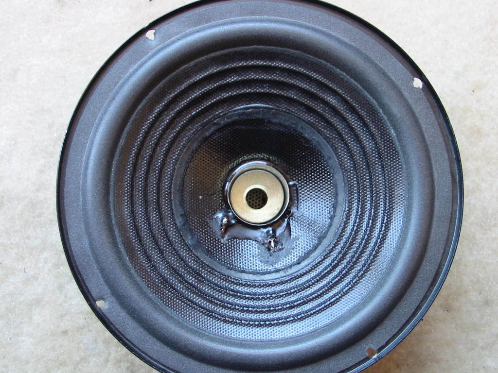

      I proceeded to center the cone in the basket the same way as the first one. But this time, I didn't use hot glue for the spider and surround. Instead I used regular household silicone adhesive. This also isn't the ideal glue for speakers, but it is classes above hot glue.
      https://www.badcaps.net/forum/attach...1&d=1552015356
      Results (after the silicone dried): no mechanical noise with the cone movement at all.
