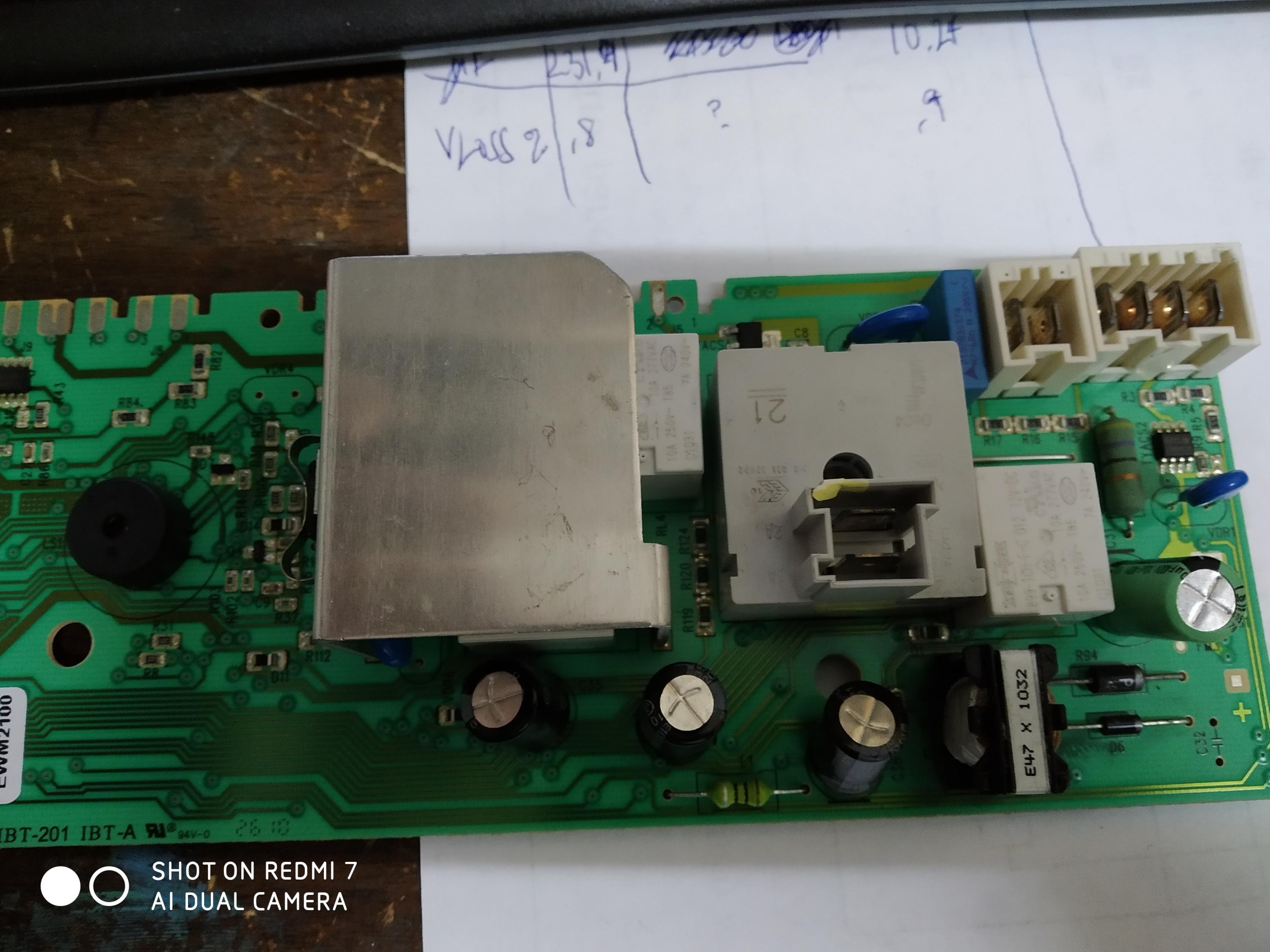

newbie needs help w/Electrolytic caps (washing machine)
  • glutton4punishment
    • May 2013
    • 81
    Re: newbie needs help w/Electrolytic caps (washing machine)
    Originally posted by R_J

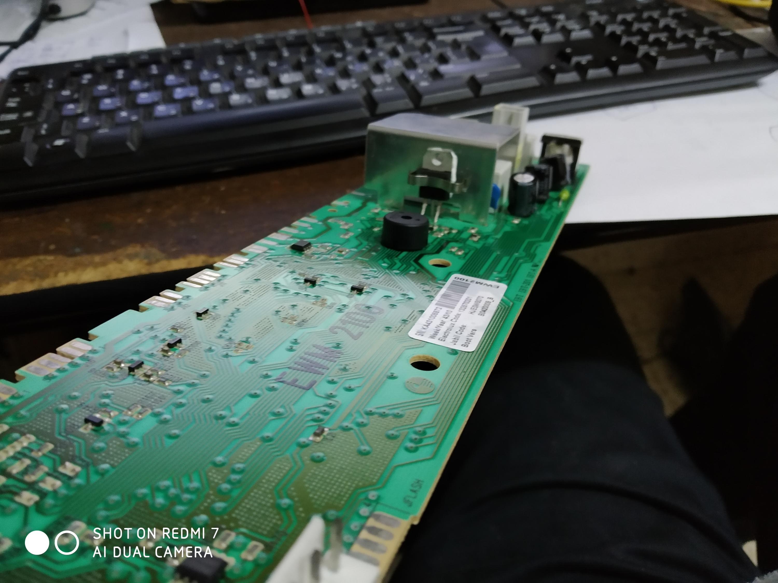

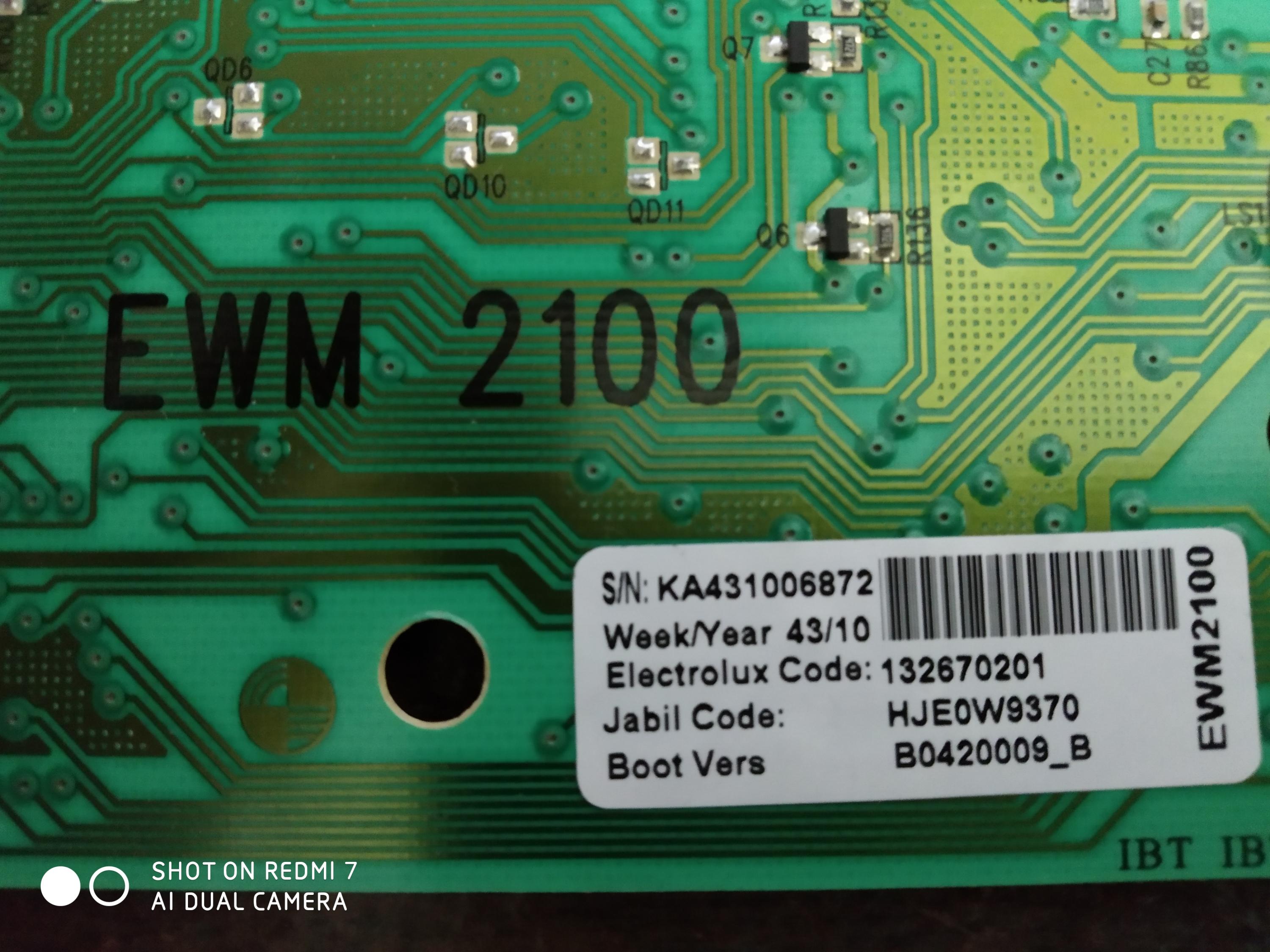

    Does this "washing machine" have a model number? does the board have a part number? attach pictures of the complete board, both sides.
    of course!
    AEG Lavamat L725500
    circuit board is EWM 2100
    I am gettting an "E52" message which means there's a problem with the motor. If you'd like, you can see the problem there. The motor tests good according to those instructions.
    https://www.manualslib.com/manual/73...page=36#manual
    The long story is that we moved apartments. After the move, I got error message E52. I explored and found four wires to the motor and tachometer sensor had been cut in the move. I reconnected the wires, the machine did two loads, and then died.
    Since the motor tested good, I'm assuming there's a circuit board problem.

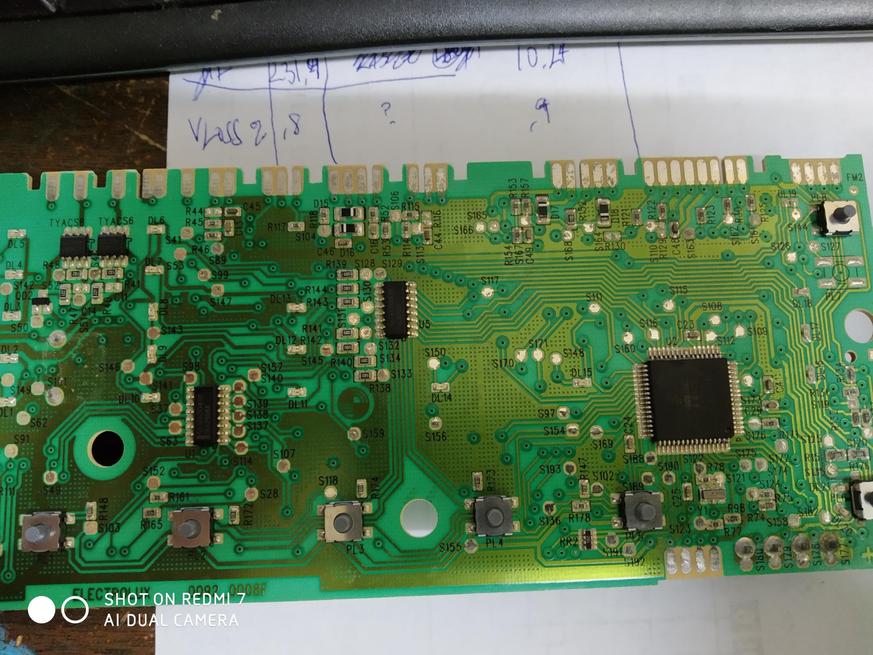

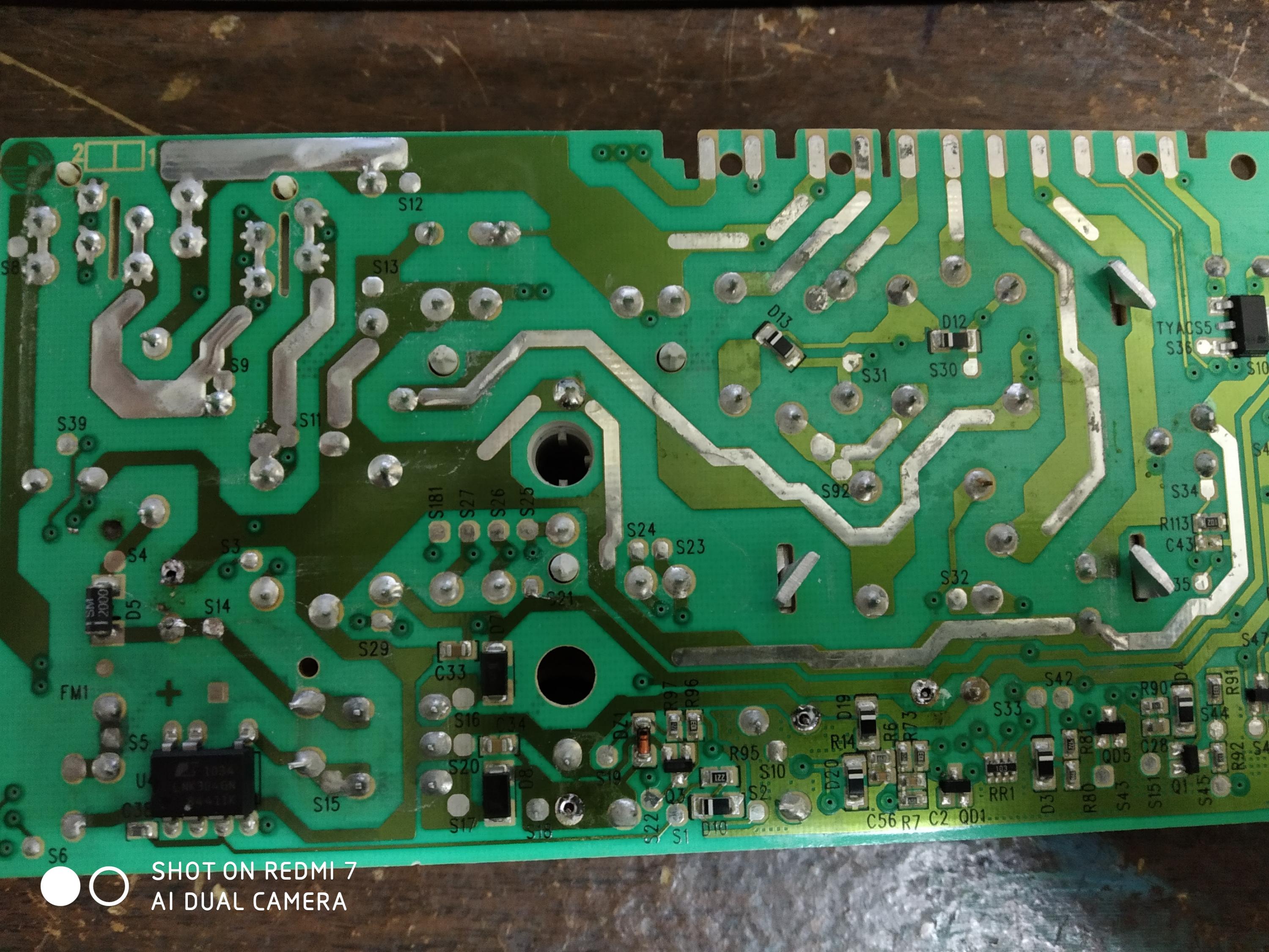

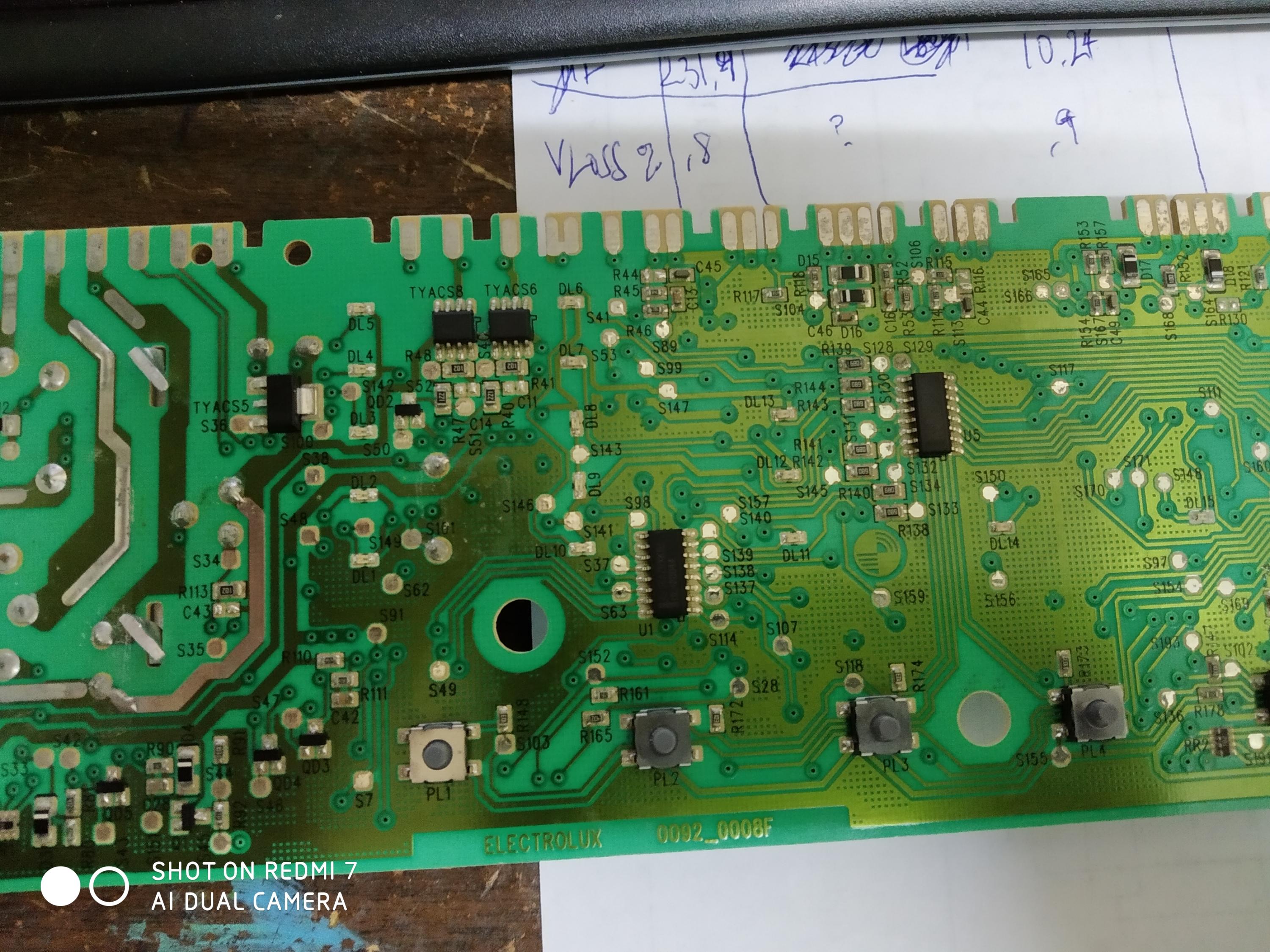

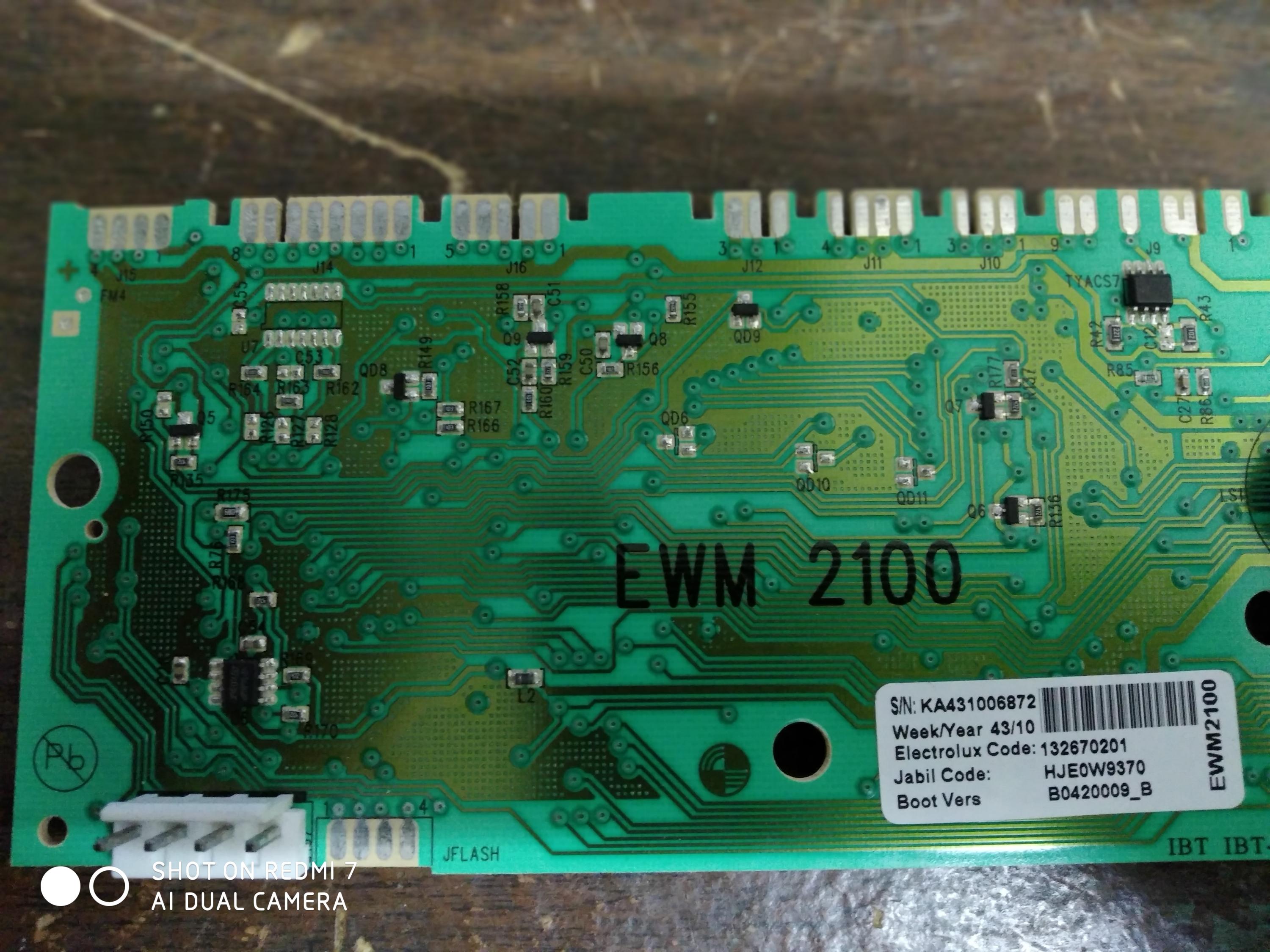

        resolder the white 4pin connector,
        the joints are cracked - i can see the ghost-rings in the foto!
        (s177-s180)
          • May 2013
          • 81
          (s177-s180)
          done
            • May 2013
            • 81

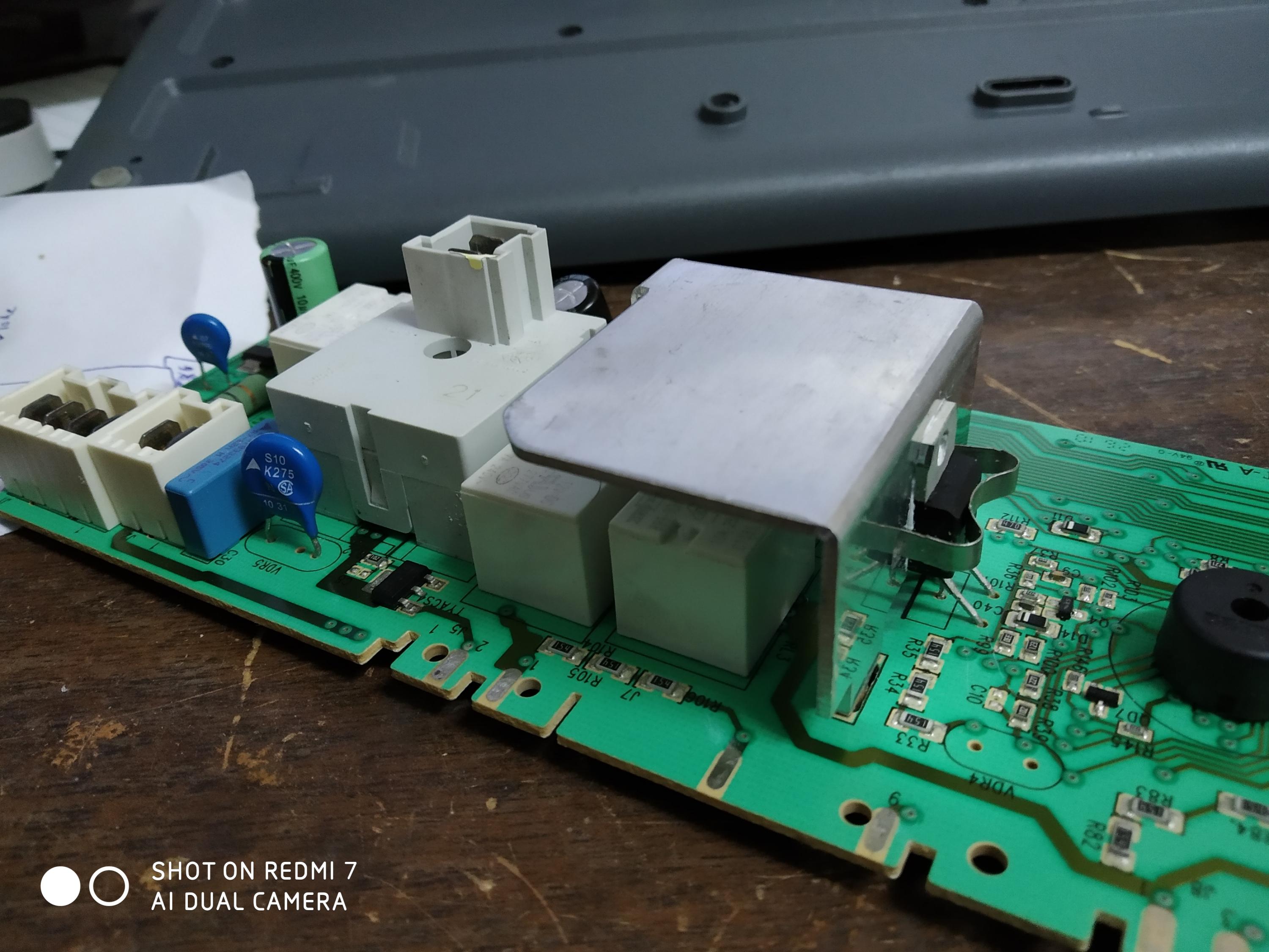

            OK, I took out the large transistor, which I didn't know if it was a transistor, a triac, a mosfet, or whatever else looks like that.
            It tested bad, so I bought a new one.
            I'll report the results later

              what is written on it ?

                  BTB16
                  The store had a BTA16, which they said was interchangeable

                      #30
                      • petehall347
                        • Jan 2015
                        • 4423
                        • United Kingdom
                        #31
                        BTB16 is a triac .

                          You say the part tested bad, In what way was it bad? shorted, open, If it is a BTA16 was either A1 or A2 shorted to the gate?

                            be carefull,
                            i think the difference between those triacs is one has an isolated tab and the other can be live!
                                • May 2013
                                • 81
                                #35
                                After putting in the new triac, I still got the same error code, motor problems.
                                I went back over all my work and retested the motor. It tested fine. But this time I started from the beginning, reading the motor resistances from the connection at the front of the machine, where it plugs into the front panel.
                                There was a problem, inifinite resistance with one of the wires. So I go back to the motor, pull of the wire loom connector to the motor. The motor read fine.
                                So I start testing the wiring loom. Sure enough, one wire read infinite resistance.
                                That ONE wire that must have been hanging by a thread the first time I reconnected the 3 other disconnected wires.
                                The machine ran fine through two loads, and then the wire got disconnected from the loom connector. BUT, it looked fine! I guess that it was held in place by the insulation, so that it looked OK, but the copper wire had been disconnected within the connector.
                                So I kept getting error messages, thought that it must have been the circuit board.
                                Thanks to all who offered their help
