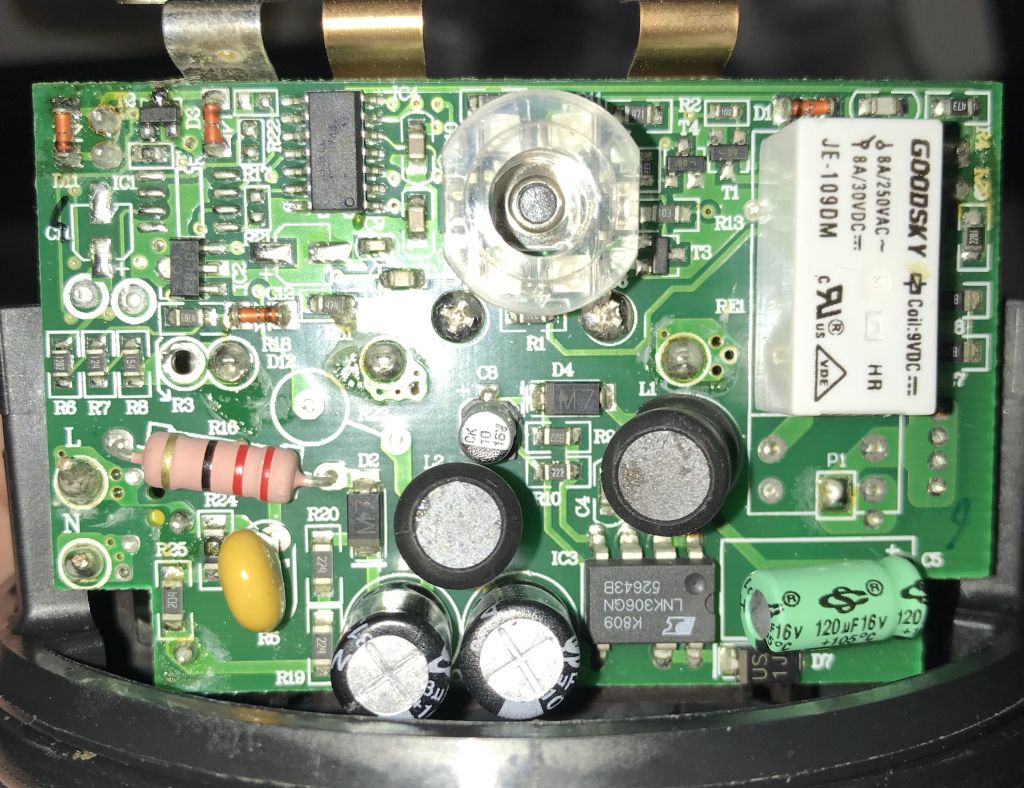

    i am asking for some Help.
    I have one of these Nescafe Aeroccino (Milk Frother) things with a bad motor.
    The Motor didn´t start anymore and internet is full of users just swapping the motor for a Mabuchi RF-500TB-12560.
    So i got a few of these from Banggood.
    I swapped the motor and now i have a new fault condition.
    In a working Frother you would press the start button, it will light red and work for a few minutes.
    If you press longer it will light blue and just mixup the milk.
    With the new Motor it just starts for a second (red blinks) and the stops, same with longer press.
    First i thought, the motor is faulty but with 2 other motors i have the same error.
    With no Motor the device works, with a short (instead of the motor) it works (but burncs BC817-25).
    There is a tiny Atmel, the motor driver is just the BC817-25 some Diodes for Motor and 9V.
    The BC817 is driven by the Atmel.
    I measured the old and new Motor, both are within the specs for a Motor with 0 RPM.
    The Diode and BC817 on the top left have been remove/checked and resoldered for testing.
    Can anyone think of other failure?
    I add a picture of the PCB.
    Thanks in advance
    Jürgen

      Re: Nescafe Aeroccino, still fails with new Motor (red flashes only once)
      Why would you short the motor The BC817 can get damaged.
      It might be the power supply is sagging when the motor starts. Check the voltage holds up, that the electrolytic capacitors are OK.
      You could power the board with a 9VDC bench power supply and see if it works.
      This thing is pretty cheap, the secondary-side caps are small, C5 120uF 16V I would upsize it.
      I don't see a sense-resistor to monitor motor current.

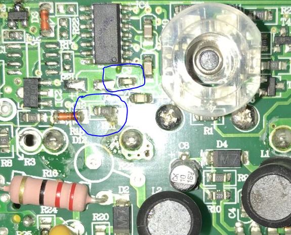

        • 20659
        Can you give the circled cap and resistor a closer inspection

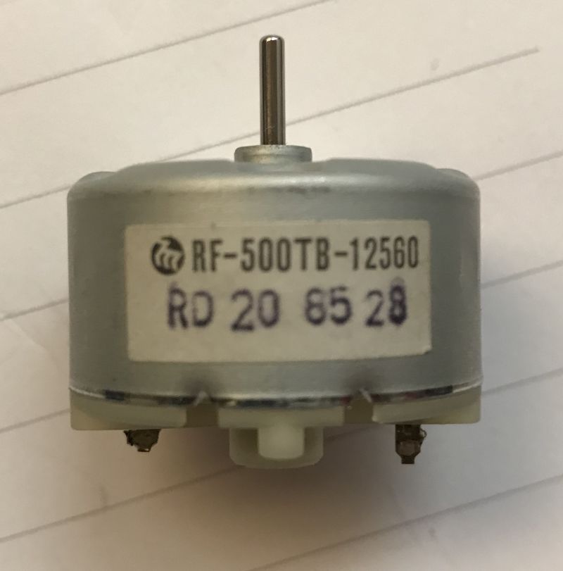

                            • juergenb
                              • 42
                              Thanks for all you help,
                              i replaced the BC817 and i got some NOS Original MABUCHI RF-500TB-12560 DC Motors from Aliexpress for 13$.
                              These Motor Type is working fine and had normal startup current.
                              So the Banggood ones are just fake one...
                              The NOS has even stamped MABUCHI on the plastic cases..
                              Jürgen

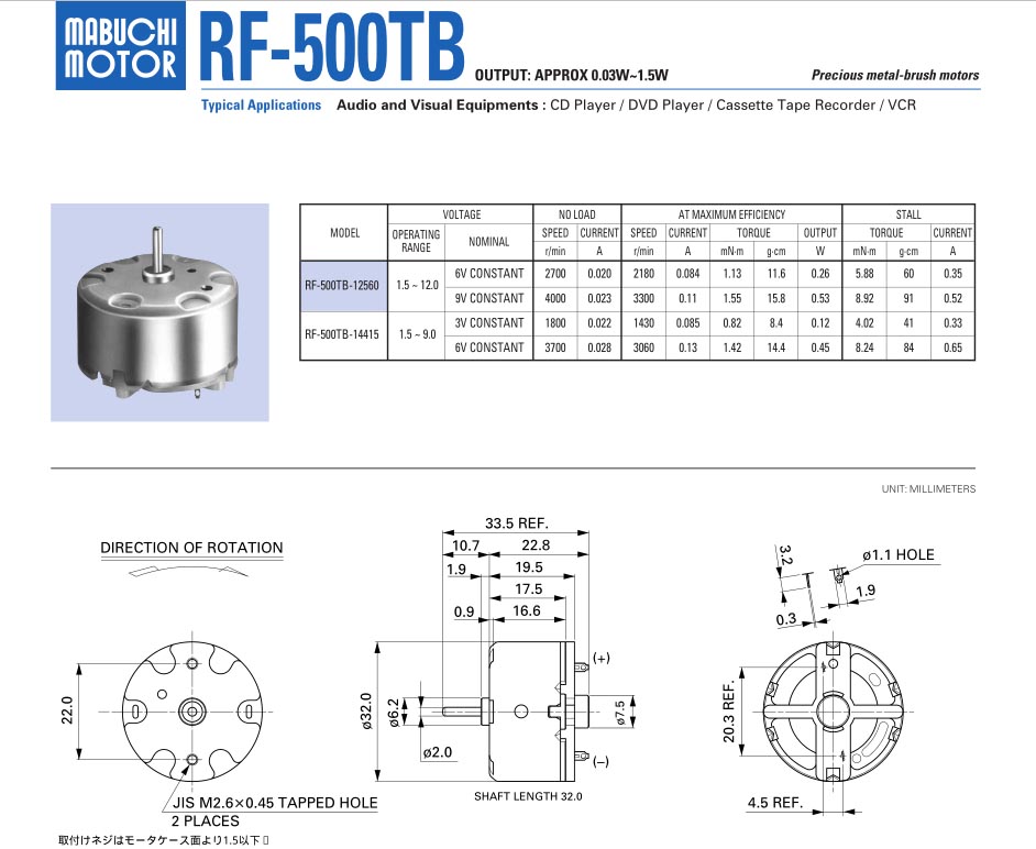

                                    I guess it also goes to show how widespread the issue is with counterfeit parts. From the pictures you posted of the Banggood Mabuchi motor, the logo looked bang-on accurate (sorry for the pun ) for a Mabuchi motor. So I suppose one should always assume parts from Chinamarts (eBay, Aliexp., Amazon, and etc.) are counterfeit unless there is strong evidence to suggest otherwise.
                                    Originally posted by redwire
                                    I'll bet the original motor had no carbon brushes, just some copper leafs because not much air is pumped over the life of the machine.
                                    See attached snapshot of the datasheet (upper-right corner tells the brush type)
                                    Indeed it is a "Precious" metal-brush motor. Not sure what that means exactly, though (perhaps gold-plated copper? or perhaps just regular copper?) Either way, the typical application is listed as CD Player / DVD player / VCR / Cassette Tape Player... which makes sense, since metal brushes tend to be more quiet than Carbon-type brushes. Thus, it should be a fairly durable motor, despite being a metal-brush type. Of course, it also all depends on the application too (i.e. at what voltage speed the motor was ran and how often / duty cycle.) I have had metal brush motors last a very long time in RC cars when I was a kid. One of them, in particular, I used to drive around after school every day for about 1-2 hours... and that went on for about 2 years, if not 2.5. Motor was an RE-280 type with metal brush. Not Mabuchi or other big name either, but probably a good enough Chinese clone (this was back in the early 2000's, so I imagine bad counterfeits weren't as widespread as they are today - at least not in electronics as much.) Eventually the motor's bushings (sleeve bearings) wore out before the metal brushes did, making the rotor harder to turn (or "vibrate" at high speed) and thus the motor ended up eating 2-4x the normal operating current. I remember I wanted to fix that RC really badly by either swapping the motor or cleaning the bearings... but there was a heat-pressed brass pinion gear on the motor shaft, preventing me from taking it apart.
                                    Anyways, point being is that metal brush motors can last a while too. But the best way to do that is to make sure any sparking/arcing on the brushes is minimized - so probably a good idea to install a big ceramic cap right across the motor terminals. It will also minimize RF/EM noise. In the case of the machine in this thread... if that is attempted, hopefully the controller doesn't trip from the low ESR of the ceramic cap (so I suppose don't go to extremes by picking a very large capacity.)
