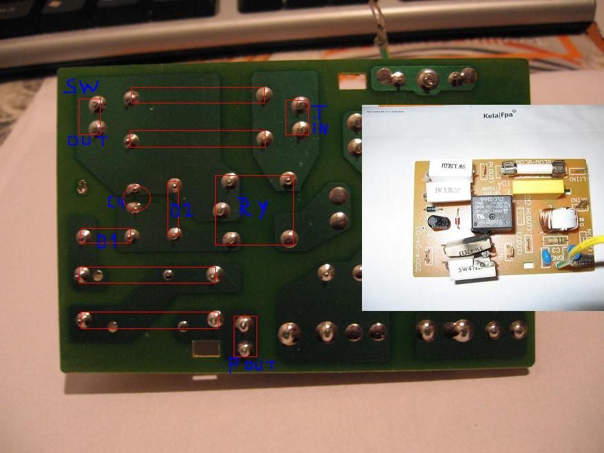

    Topic issue:

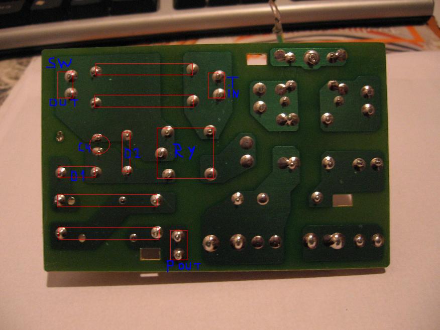

    Microwave oven with burnt Paraller resistors at PCB. A circuit at PCB that controls power cut out, Via Door switches qty:2.
    a lot of good photos and PCB etc Schematics at my Photobucket at the link pasted, just add in front of the link the usual: http://
    s721.photobucket.com/user/Cagiva4ever/library/Consumer%20electronics%20Kitchen%20appliances?sort=3&page=1
    this forum wont allow direct links attached, hence above...
    -Advice info opinions facts wanted, for if there is a so called “Underlining issue” for a reason why these Paraller resistors have burned out.
    i.e if it's a reason because of a possible Over voltage spike at 230Vac household supply
    i.e if it's a just because of low grade resistor components
    or something else issue such as possible ShortCircuit somewhere.
    The Story, what happened:

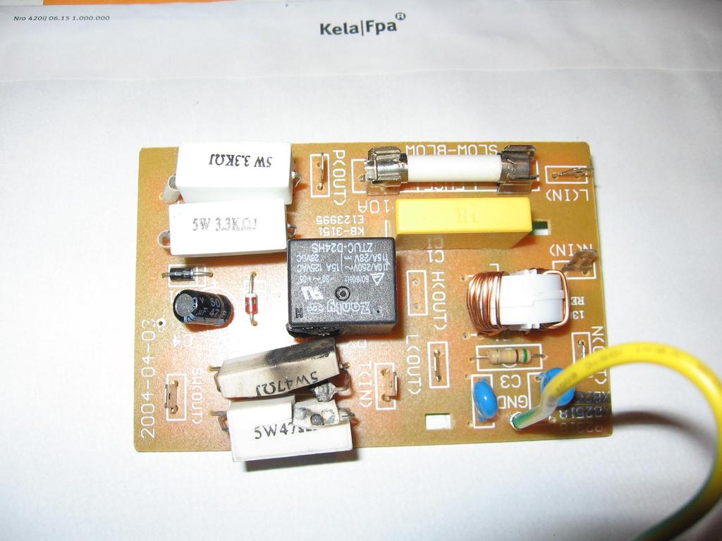

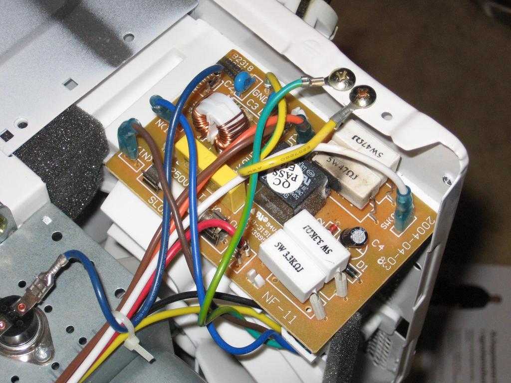

    When the Paraller resistors 5W47ohmJ burned out, I was able to fastly turn of Un-plug the Owen from 230vac in under 5 seconds, as i was standing next to it. While Owen was running it was running functioning normal, no Flickering no pulsing or any other symphtoms.
    So I would atm assume that nothing else got broken expect the Paraller resistors, as I cant see any indications burning marks or anything at anywhere else on the Owen circuitry pcb or wiring or Windings externally.

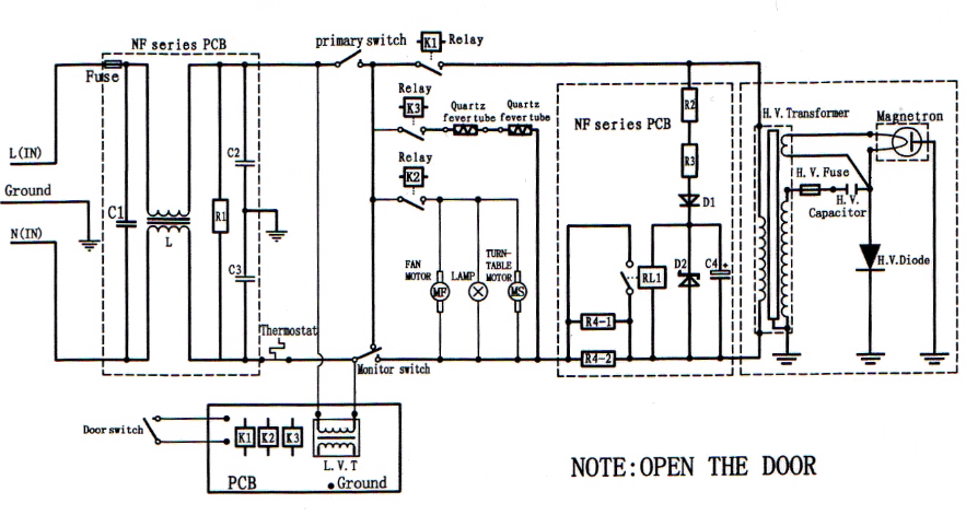

    These paraller resistors get a voltage feed directly from 2-stage winding Transformer power supply ,Via Orange wire.
    As far as I can see understand looking at the PCB, it has 2 separate circuits in it. I have marked components on to the backside of the PCB for the separate circuit that Consists is made from:
    - 1 relay switch
    - 1 electrolyte Capacitor
    - 1 zener diode
    - 1 normal diode
    - 2 resistors connected in Series
    - 2 resistors connected Paraller 5W47ohmJ , the burned ones. If I understand right, this is the INTAKE side for the orange wire, power supply 2-stage winding supplyes feed into PCB via this T(in) , as the other end is Switch out SW(out)
    I haven't yet tested if those Diodes are functioning properly, at least externally they look mint perfect. Afaik burned diode would Cut of the circuitry. And not cause a ShortCircuit to Burn these Paraller resistors or the Relay Ry at PCB.
    Also, as the Microwave was running normally while Paraller resistors smoked burned, Id say that 2-stage winding power supply doesn't have any ShortCircuit burn in it.
    I have bought new components to replace the Paraller resistors. While buying them, clerk “technician” said to me that thye don't usually burn out in generally speaking regarding such resistors, that there could be Underlining issue causing it.
    Im a self educated hobbyist, and I have no degree from electronics, so I don't know all the Basics, which is why I now neep help of a Friendly people.
    Fixing this Owen would save me money for 1 month food supply. So I would much appreciate help. Money is tight, my country is living in 7th year in a row economic depression.
    m
    somebody replys to me saying:
    February 15, 2016, 06:28:50 AM
    it is better to test those diodes for possible leak.it is true that burnt diode would cut the circuitry but leaked one is different.try to analyze the circuit further.thanks.
    ok, so i have now Measured both diodes with a good digital Multimeter.
    Both diodes give good values, they are obviously NOT short cicruited. Leak test i have not done.
    diodes connected into circuit, in their places at PCB "forward biased Ohms" values are:
    D1 801Ohms
    Zener diode 1.078Kohms
    "Reverse biased" measurement gives the .1 for infinity reading value. it doesnt go into 0 zero or act up. with above "forward biased values" this should clarify that circuit isnt jammed OPEN for both direction continuity. Minus leak test.......
    any "paraller" interefeence while at pcb, seems higly unlikely having any effect into values/readings on this exact case...
    so does anybody have any ideas what could the fault be. Lotsa good photos at my Photobucket all is very visible, the schematics etc etc.

      Re: Microwave oven with burnt Paraller resistors at PCB
      Try testing some of the parts that are connected to the resistors with a multimeter and see if you can find any parts that may have gone short circuit because that's probably the reason those resistors burned up.
      Also i recommend looking into replacing that relay [at least i think it's a relay] since the side of it was melted by the resistor.
        I cannot download pictures from your Photobucket to look at the boards in details.
        The resistors may have burnt up due to the relay is not turned on (or it does turn on but the contacts are bad) to bypass the resistors (you can see how the resistors are connected to the relay contacts), the resistors look to be for softstart circuit.
          hi !
          is there summink else that i could do, for you to be able to download them photos ? or is it just your situation location atm that makes it unpossible ?
          are you maybe later able with time to download them into your own computer, and have your time in a no horry to look at them ?
          i shall start to look for the relay, to source a seller for new1, just in hand source available if needed then later.
          yes, the paraller resistors burned the side of the relay. relay didnt seem to have any of its own burning action. resistors only burned its outside surface, not through it, cant thow 100% verify that Relays internals arent now touching relay plastic casing for sure... anyway if relay is faulty this is matterless detail what i just said.
          thanks very much for details regarding possible "soft start puspose" . i appriciate very much that kinda details for to Learn.
          -"Try testing some of the parts that are connected to the resistors with a multimeter and see if you can find any parts that may have gone short circuit because that's probably the reason those resistors burned up."
          PCB has 2 separate circuits in it, which from i have measured other1, as detailled in post #1, diodes.
          i might find out new learn new, which is based on if "budm" is later able to see my photobucket PCB photos etc...
            I had a lurk at that link and it worked fine for me, but I had to wait like 20 seconds for the page to pop up. I guess it is slow. I hear ya on living on a stretch, plus recycling something is always fun, money savings and keeping the landfill clean.
            As far as these soft start resistors go, they can fail for various reasons. So when they blew up, the microwave should have been dead. Those two resistors act as a inrush current limiter / fuse (soft start). So when the device is turned on, the full current doesn't come in like a bang. I've seen resistors like that blown and usually they fail because something is shorted and there is too much current drawn, low quality, old age, and moisture.
            In your case, i'd check that relay if that is still working correctly. I wonder if it arced inside, burnt off the contacts or welded shut. Also check that diode on the secondary (High Voltage side) of the big transformer. Does the display still work?
              I can see pictures but there is no way to download them to my computer. I store lots of pictures in my photobucket too.
              You need to setup to allow people to download pictures, my has 'Download media' icon.
              The relay contacts should close seconds after the power is applied to bypass the softstart resistors, if they are not bypassed then resistors will burn up., relay contacts are connected in parallel with the resistors for that purpose. You have lots of inruch current with that big power transformer.

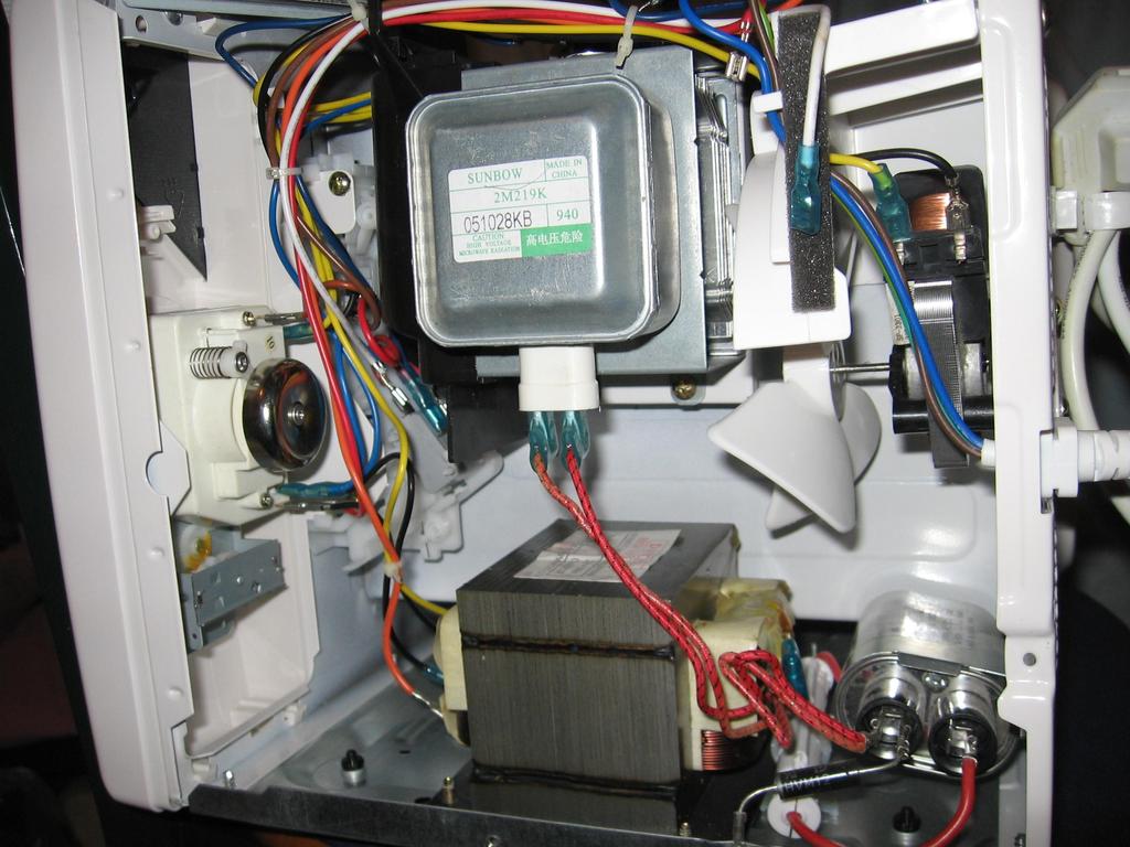

                the M-oven is only 700Watt's nominal power on datatag. it is oldschool "analog" type, no digital LCD or digital selectors. bought new for my self 6years ago but very little usage, maybe less than 10hours.
                always kept dry and clean etc. it is those cheaper Brands modern Chinese production, so to speak.

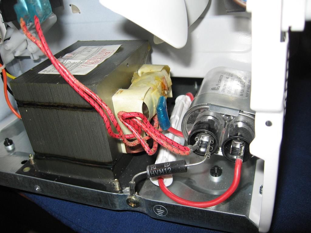

                i shall also measure the diode on the secondary (High Voltage side) of the big transformer.
                silly question, but we are talking about the big diode (summink 8~15+amp) at the BIG hv-capacitor, where Diode's Kathode connects into Oven metalbody ground.
                iirc i have tested this mentioned diode and it was showing good values, same principals as in them smaller diodes on PCB tested.
                but i will measure this HV side diode again, as i have no notes from it saved. i have my Multimeter at mothers home...

                  My bet is a faulty relay being the cause, like I said in my previous post. Replace the resistors and that relay and give it a try.
                  The story on what happened to the microwave, you should have now a relay that doesn't make make proper contact. Check it out.

                          Here are the pictures. It seems that resistor/relay is for changing the power level maybe for a defrost or low power function? If the relay contacts burnt open they won't short the resistor during normal operation so with the constant current through it, it burnt it up.
                          I found this schematic that shows a similar circuit for the NF series
                          Here are the relay specs. This panasonic relay JS-B-24V-F (Digikey 255-176-nd) looks similar

                              Did you verify the relay coil resistance to make sure the new one is not going to draw too much current?
                              • cagiva4ever
                                • Sep 2011
                                • 22
                                hi ! ^^
                                i havent done anything yet to the relay (CHP11-A240S) or with the Relay, ive been waiting to hear what i should do 1st Regarding its suitability.
                                i have thow opened the relay boxcasing to have a look of its visible condition.
                                i havent ever before measured any "relay coil resistance", its totally new thing to me. may i ask how to do it ? if its anything special procedure related into it...
                                at this relay CHP11-A240S
                                Multimeter into Pin's no#1 and no#2 gives Ohms: 14,53 or 14,71 depending of my 2 Multimeters, when selector @ 20K

                                Today i took loose of the BIG diode from the HV-capacitor/mwo chassy Ground.
                                its marked:
                                HVM12
                                350
                                is there something special i should know about it, in its construction or is it just a ordinary diode but with big Amps rating.
                                i measured the diode with both of my 2 Multimeters, and:
                                i get absolutely nothing for "forward biased Ohms" value.
                                "Reverse biased" measurement gives/keeps at the .1 for infinity reading value.

                                  data sheet for the HVM12 diode
                                  • R_J
                                    • Jun 2012
                                    • 9607
                                    You can't measure the high voltage diode with a regular meter, it is basically a bunch of diodes in series.
                                    You should be able to short that resistor (relay contacts) and the microwave oven should operate at full power, that way you can make sure the rest of the microwave oven works.

                                        i now Multimeter resistance measured the "Burned" power relay while it is IN at pcb.
                                        zener diode and the normal diode "orientation" Block any other component to interefere with measurement, so id say its ok to measure while it is IN at pcb.
                                        only the small capacitor is "actively" in same circuit, conencted inseries.
                                        Multimeter gives readings that jump walk allover, start from ~1300 and go down into zero, flickering....
