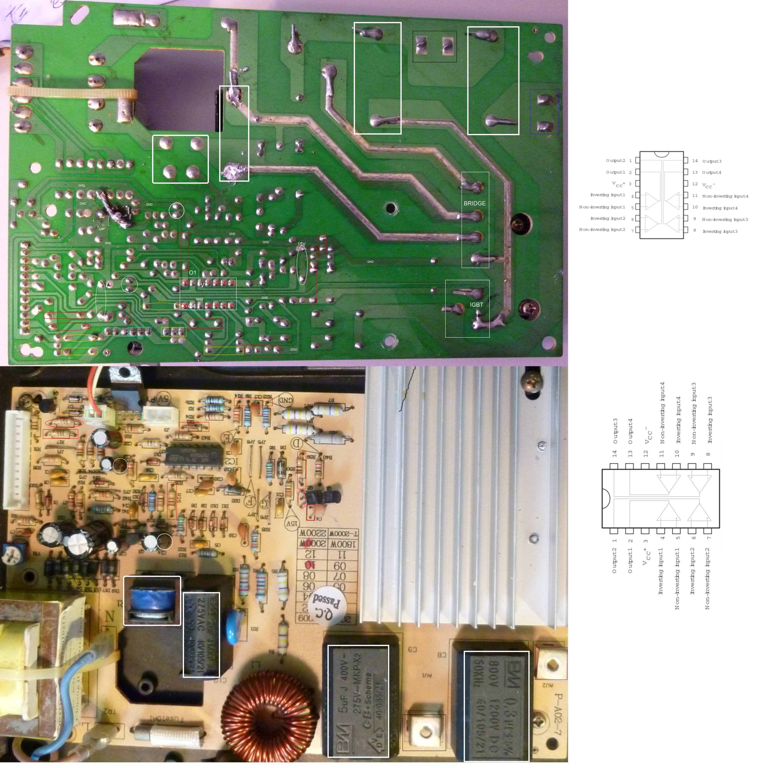

    Re: Farfalla Induction Cooker FEC-20SD6 Error E6

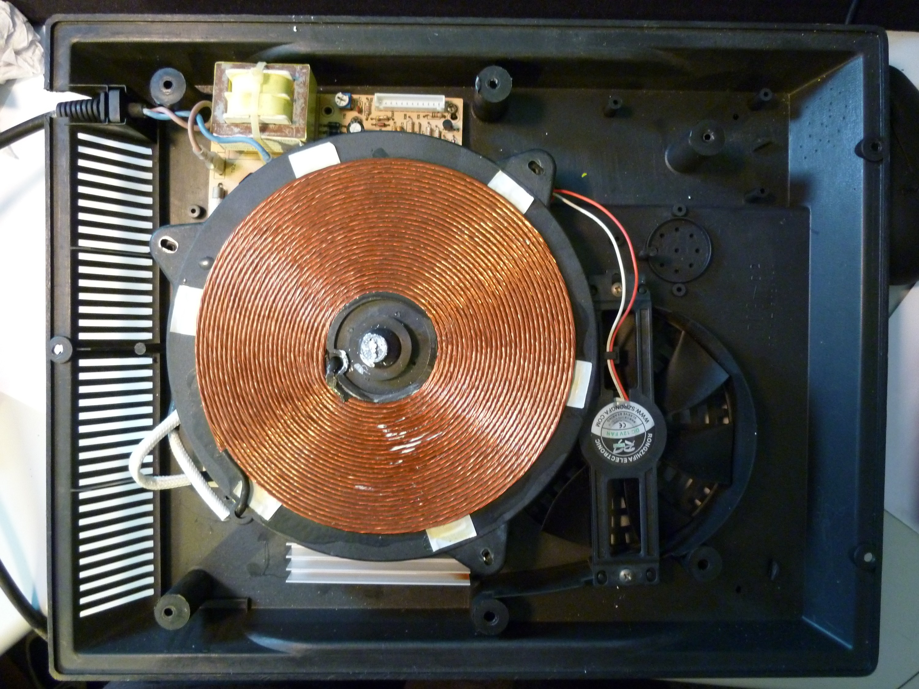

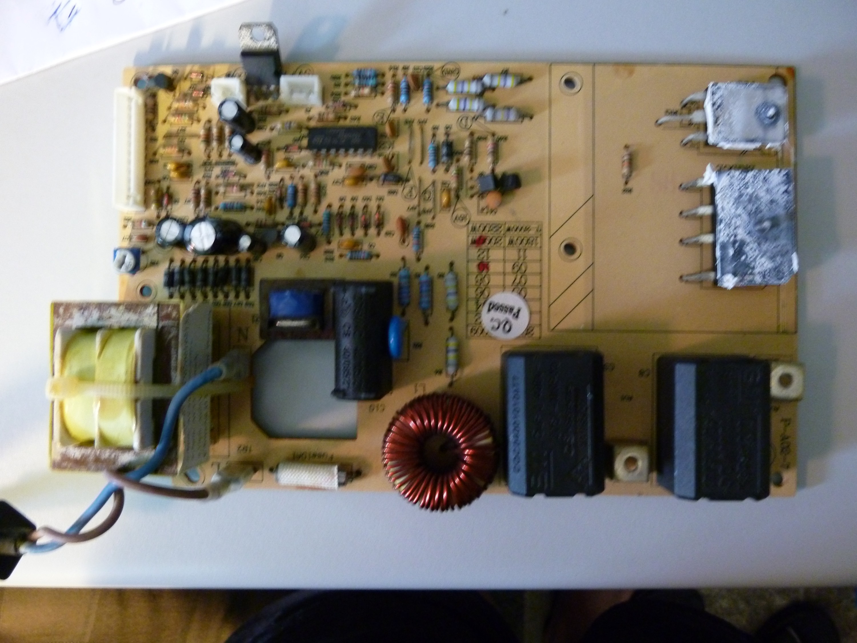

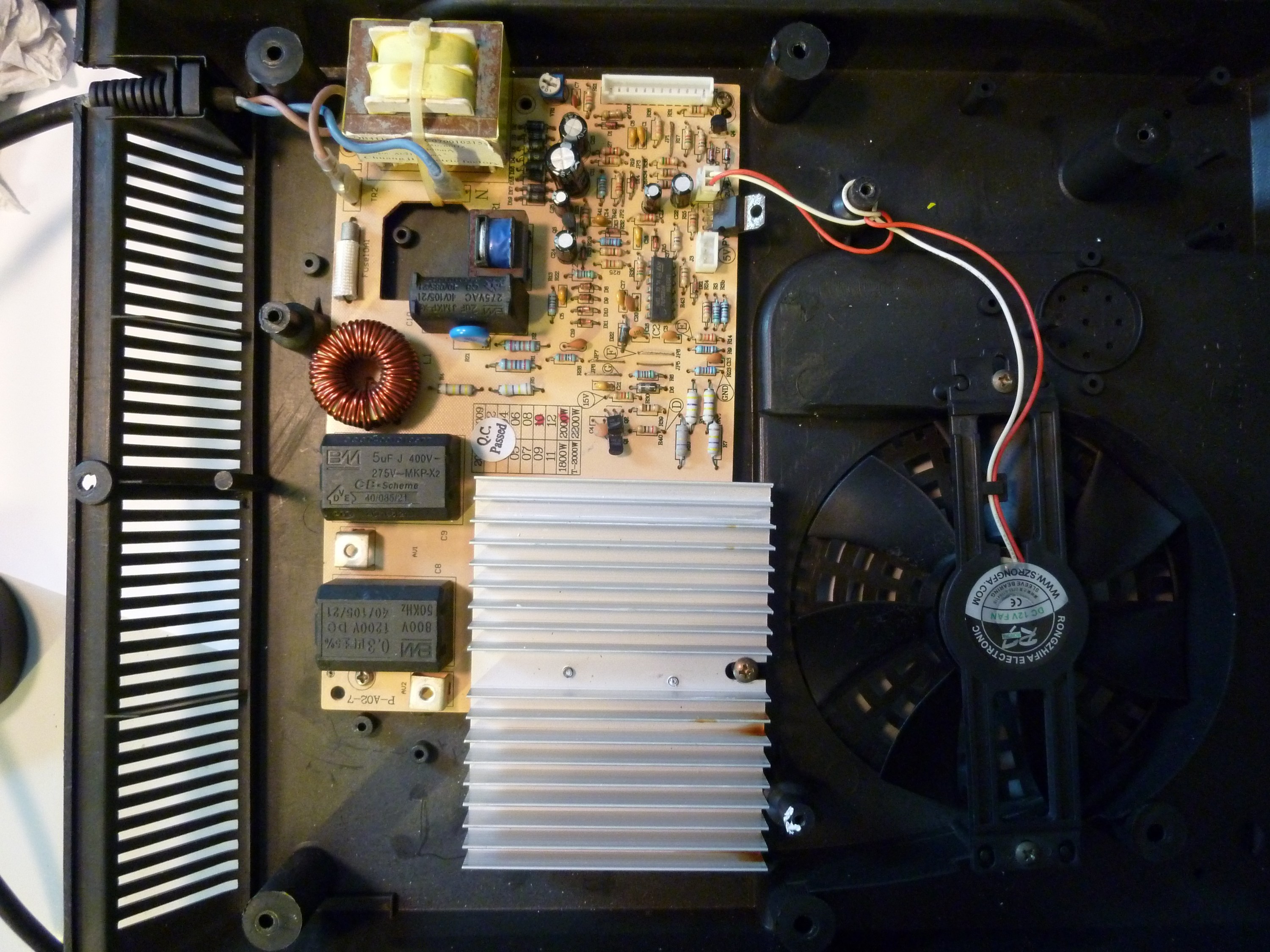

    Dear all,
    Attached are pictures for the induction cooker. I am trying to locate temperature sensor on the PCB, but in vain. I know there is one at the center of the coil. Anyone knows which component on the PCB acts as temperature sensor?
    Thanks in advance
      Probably a shorted thermal sensor. (If it's the usual sensor type used)

        That's what I suspect, but unable to find the thermal sensor on the PCB. Don't know which one is thermal sensor

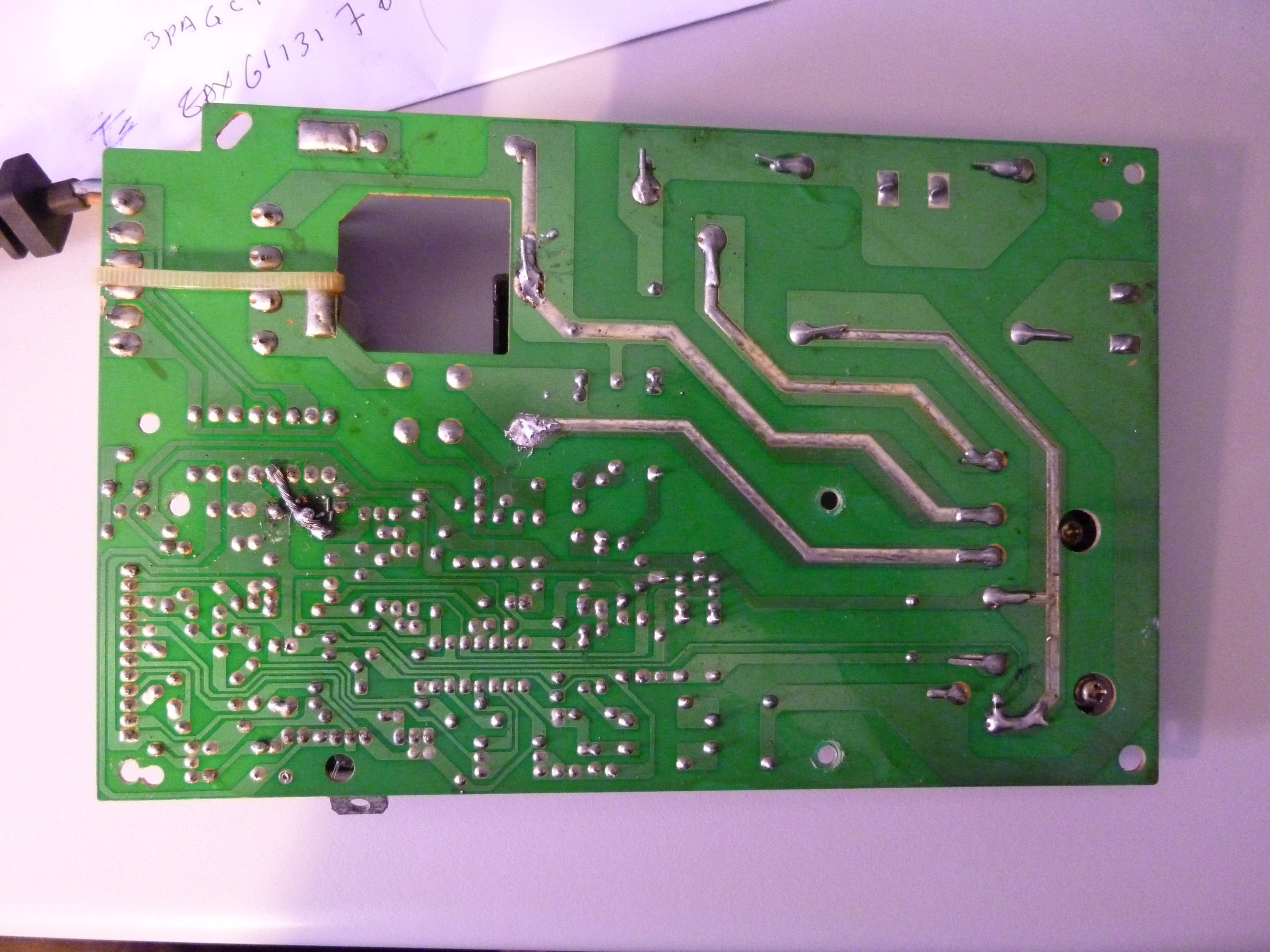

            Dear budm,
            Thanks for reply.
            Initially, I suspected a capacitor was the problem, so I unsoldered the capacitor to do a testing on it. But it seems to be ok. Later I soldered it back and it looked like the electrical connection was damaged, so I soldered a wire across the connection
              i have a feeling it on the top panel, can we get a look at the back of that too.

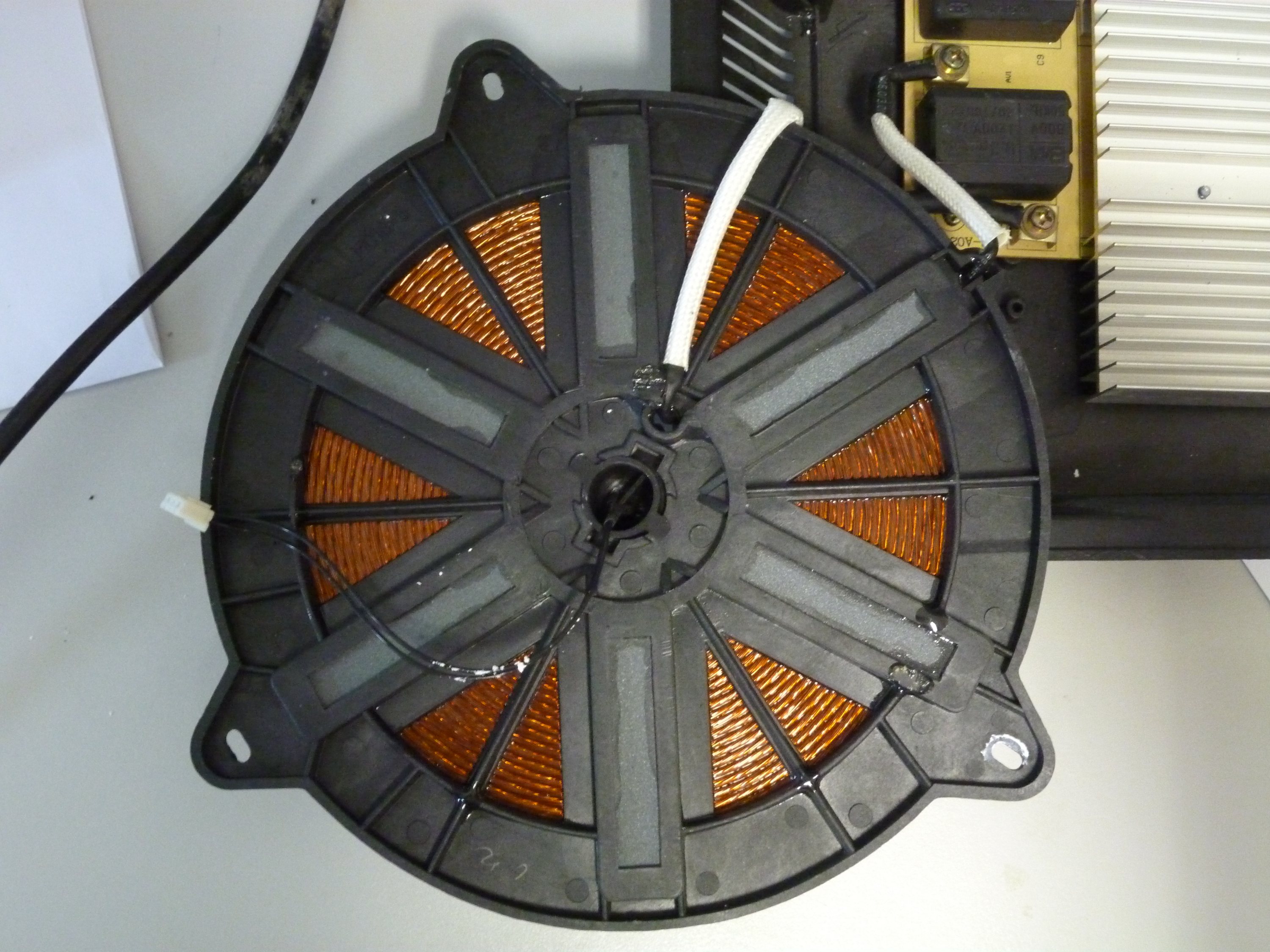

                  ok, its not on the front panel. there are 3 wires going to the coil, two big ones and a small one with two or three individual conductors?
                    Dear goontron,
                    I got what you mean.

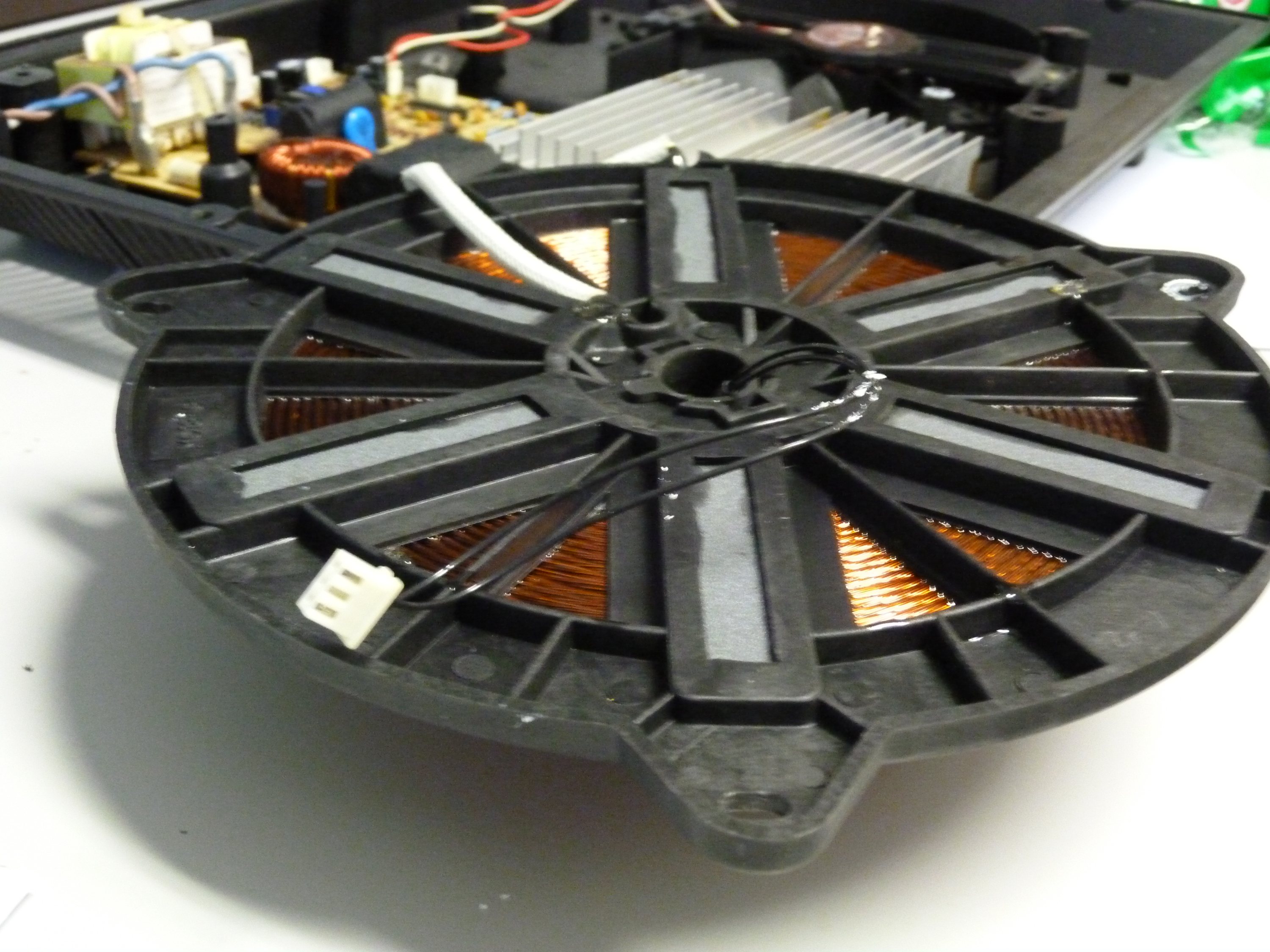

                    Attached are the pictures. The small one with 3 conductors are the temperature sensor for the coil.
                    There are two black wires. I measured the resistance across these wires both ways. The reading is 111.6 Kilo Ohm
                    • goontron
                      5000!
                      • Dec 2011
                      • 4108
                      • US
                      111k? thats definitely suspicious, seeming how most thermistors are only 10k. i think thats whats bad.

                        • goontron
                          5000!
                          • Dec 2011
                          • 4108
                          • US
                          looks like the thermistor is OK. they have 110k thermistors, they are just uncommon. if the room was ~27c when measured it is fine. which leads to bad solder or a bad IC.

                            • maxchong2898
                              • Aug 2014
                              • 17
                              • Singapore
                              Dear all,
                              I have put the main board front and back side by side to make it easier to check the connection. I also tried to start with the IC LM339N to see if what input that has triggered the error E6
                              Is this the right way?
