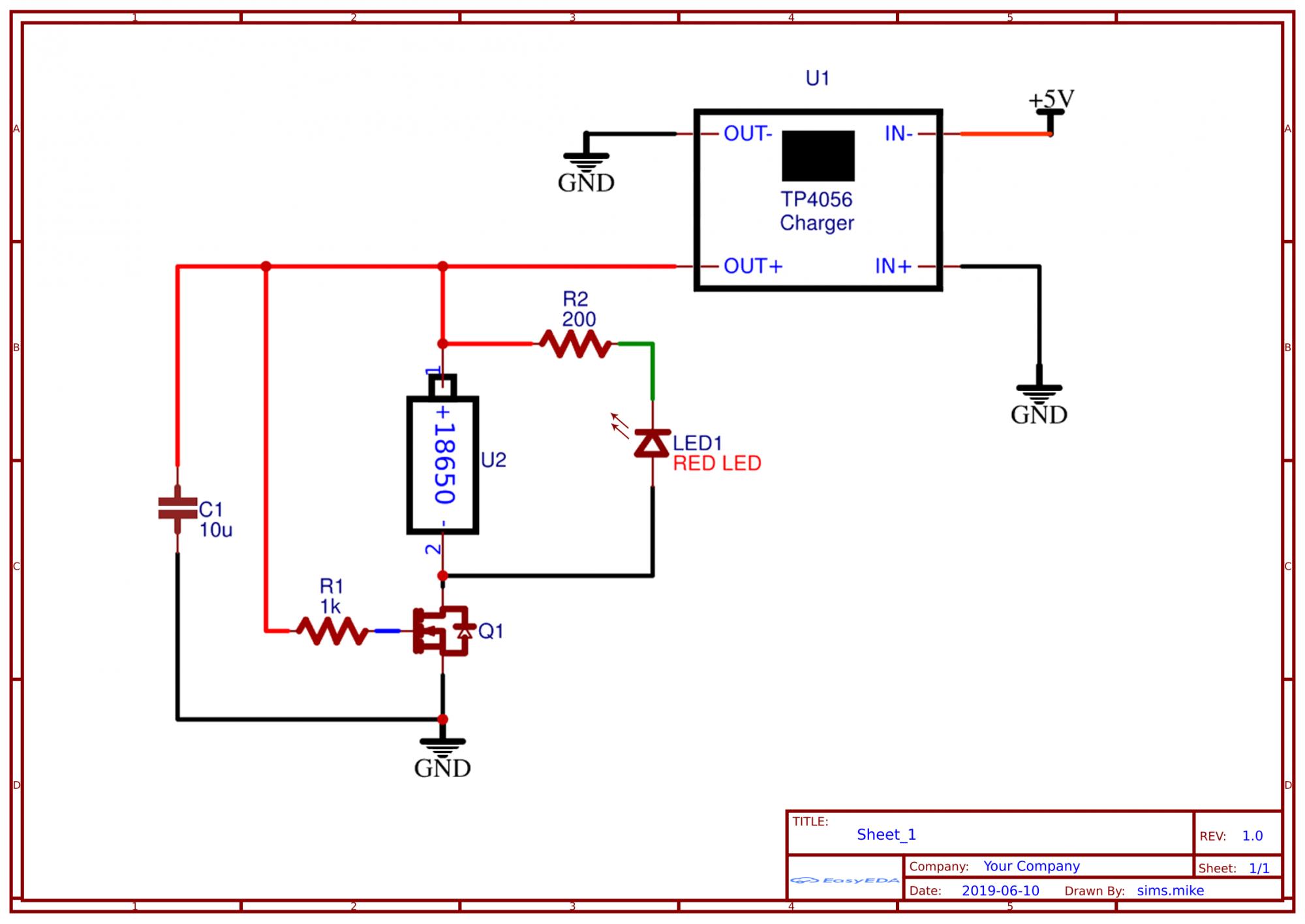

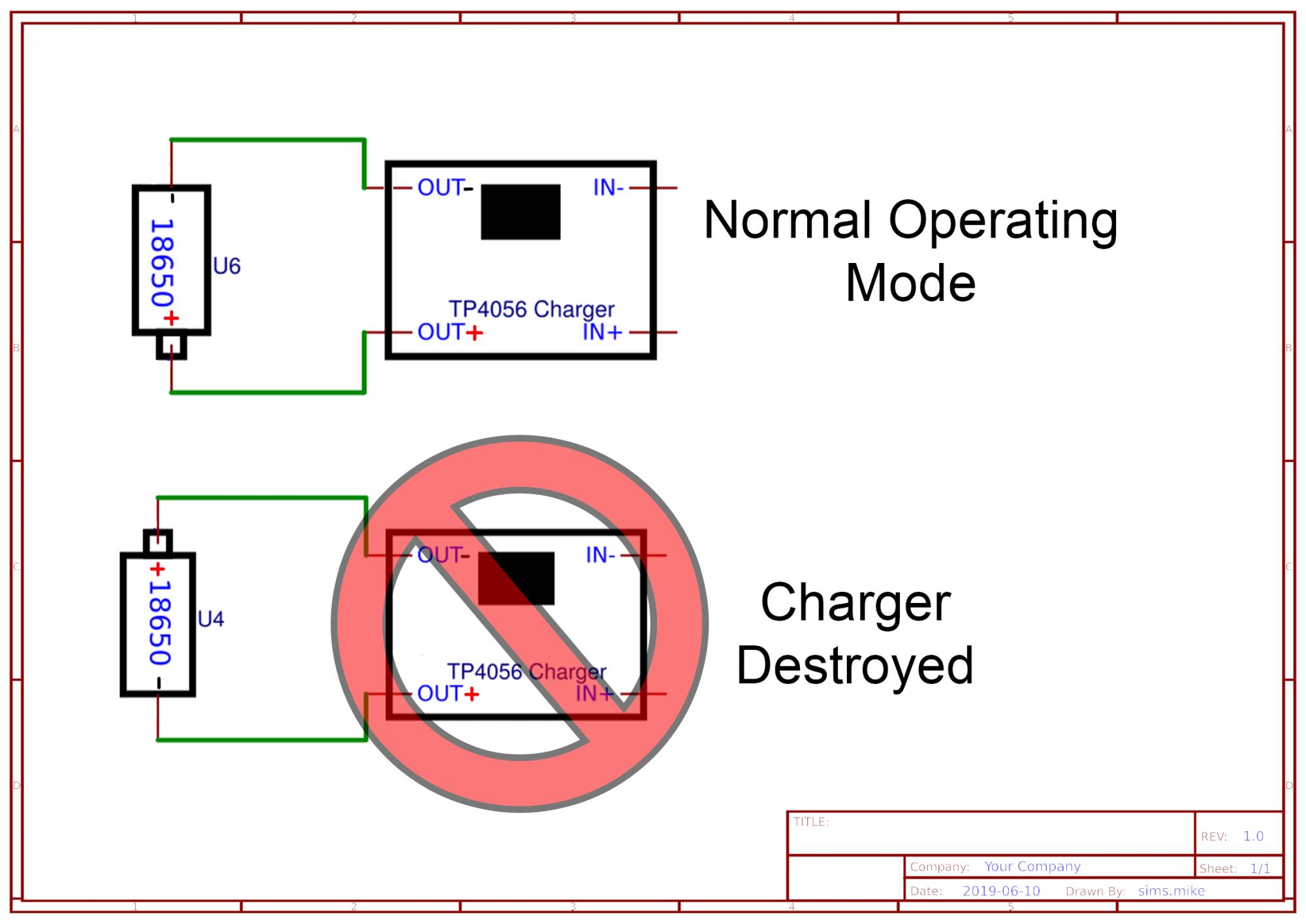

    Will This Work?
    I want to use these inexpensive 18650 battery chargers but if you accidentally connect the battery in reverse polarity, the charger fries in less than a second. Picture 1 shows the normal operating mode of the charger and the reverse connection NO NO and picture 2 shows what I am thinking might protect the charger from reverse bias damage while still allowing enough current to flow when the batter is connected properly for normal charging.
    Will it work?

    Re: Will This Work?
    I would check the cut out voltage to the 18650 and make sure that it does not go any higher than 4.2 volts
    Other than that you should be ok
      • 30978

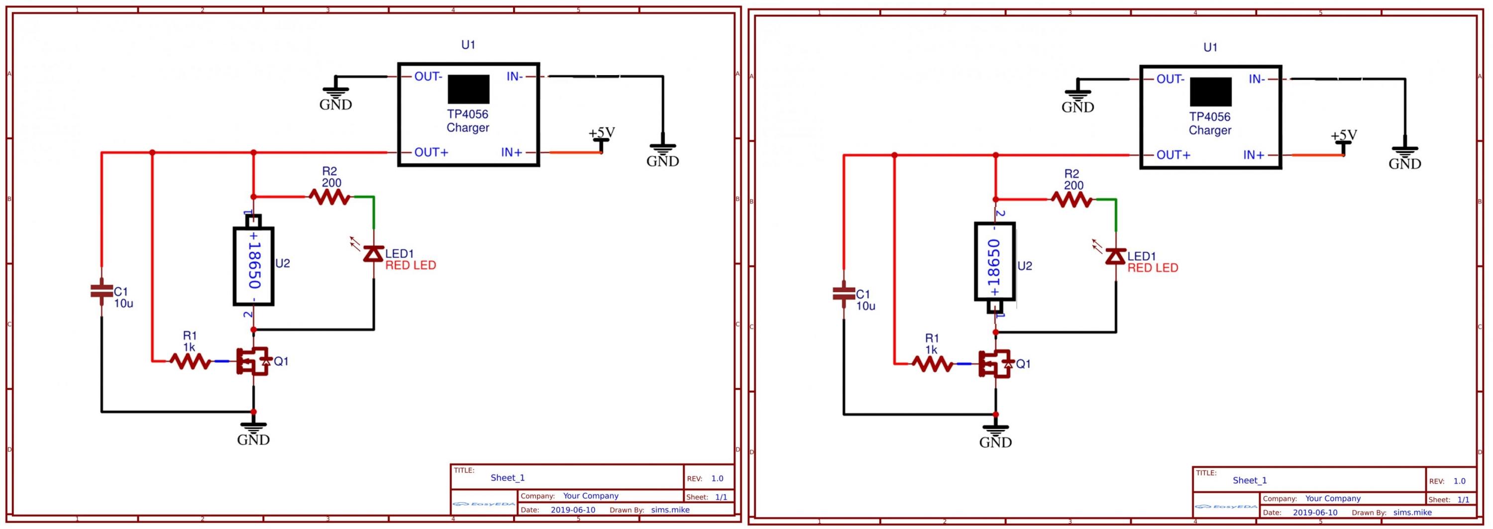

      Re: Will This Work?
      you may want to look at the input polarity on your diagram!

        Re: Will This Work?
        btw:
        Yeah, that was a diagram mistake I saw it after I posted.

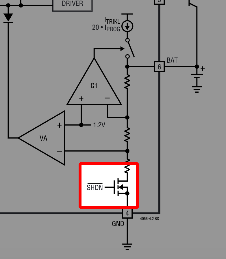

          If you look at the internal circuit of the 4056, you will see what gets damaged when battery is connected in reverse.
          https://cdn.badcaps-static.com/pdfs/...47c5c03bfe.pdf

                Re: Will This Work?
                might be easier to adapt a battery holder that is foolproof .
                    Are you thinking this MOSFET that appears to be directly in the line of fire in a reverse polarity scenario? I'm thinking those series resistors probably put on a nice light show as well ... ???

                      Re: Will This Work?
                      I'd LOVE to see a picture of such a battery holder for 18650's .. I can 3D print whatever I need, but I can't imagine any mechanical way to prevent someone from accidentally plugging the batterys in backwards unless it had some kind of mechanical means like a contact that breaks loose when the lid is up then maybe an LED indicating incorrect insertion ... where the contact cant be made until the lid it closed but beyond that Ive tried to think of a way to do it mechanically and I just cant think of a way that is also simple to implement.

                          Re: Will This Work?
                          https://www.thingiverse.com/thing:3531895
